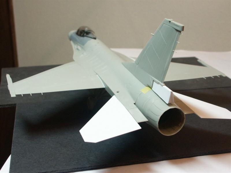

Closer view of the extended parachute housing. This gets putty troweled all over it for final shaping.

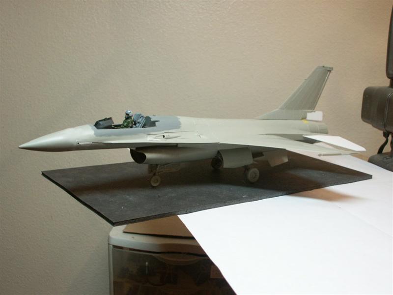

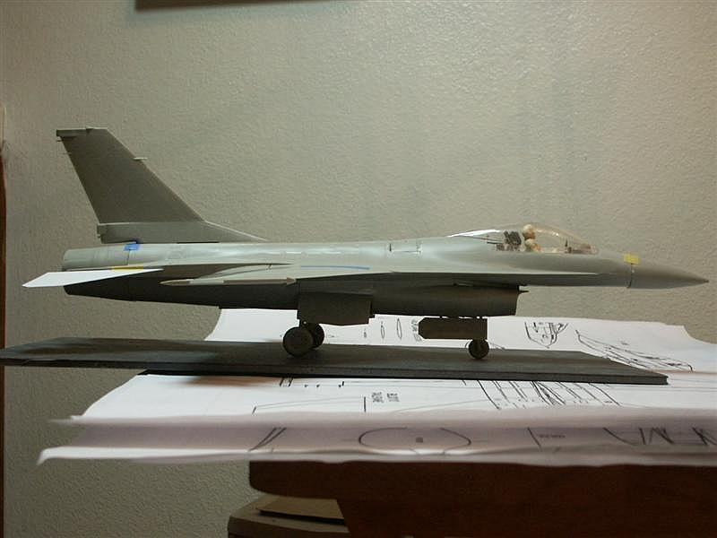

Gone about as far as I can with the kit supplied pieces, and it's basically looking somewhat like an F-16A now. Time to start doing some mods to bring things up to snuff and figure out what changes I need to make this look more like I have envisioned. I'm planning on having this knocked out before the end of next week, so it's time to get moving. More pics as things progress! Later, Russ
Geeez, see how the canopy distorts the pilot? Looks like an egg-head from that angle. I'm always mentioning the poor fit and how I have to massage every piece; here's an example. Look at the gap at the trailing edge of the left wing,.....and the corresponding gap at the LEADING edge of the right wing. I'll get it all whupped into shape eventually. I'm even starting to enjoy my little forays into carving on things,.....the plastic on this kit is soft as soap, and whittles/glues nicely.

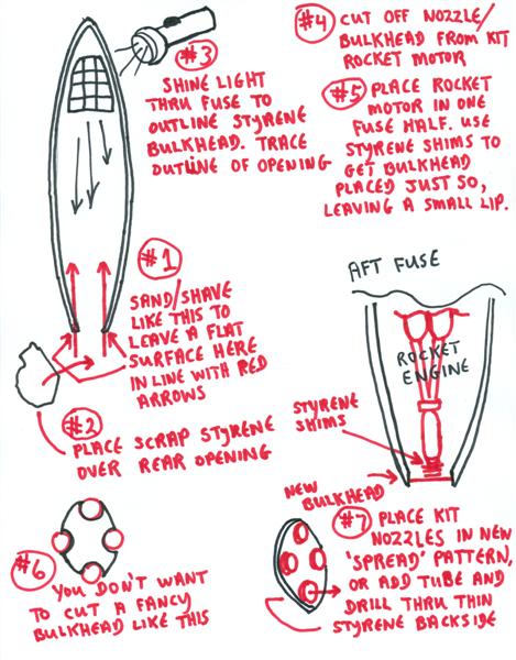

Wheehuweee! Lotsa great ideas here for sure! Did some drawing tonight to put my dollar-two-ninety five into the collective think tank going on here. Doesn't require adding a lip, or beveling a bulkhead to conform to a tapering inside shape, or even cutting a fancy bulkhead to fit 4 tubes. Uses the kit rocket motor to hold the bulkhead in place and prevent it from 'pushing thru' while trying to glue it in place. Uses a light to trace around whatever size/shape opening happens to be at the nozzle end of the fuse, and if you don't have any styrene tubing the correct diameter laying around.....lets you use the kit nozzles in a wider 'spread' to fit the larger new bulkhead.(after cutting them off the kit rear bulkhead of course) Some xtra notes for sketch #'s; #1-Killing 2 birds with one stone here. Creating a lip while thinning the edges of the rear opening. If sanded/shaved at this angle,....the thicker the plastic is, the more of a flat area for that bulkhead to glue to....so no need to bevel the new piece. #2-Might add a few whisps of glue to hold the styrene in place while tracing around the opening. #5-You can see how the new rear opening would be flat. Using the kit engine to attach the bulkhead eases handling/positioning/ and keeps it from 'pushing in' once installed. Allows you to use a fuse half to position things easier. Because I'm lazy, and in a hurry,...here's how I'd do this operation; A piece of PVC tubing with a scrap sheet of styrene tacked onto it held up to a light to show how easy it would be to trace around any irregularly shaped opening. Hope this helps Kevin, good luck!
Aaaaaaah-haaaah. I got a simple slick way of doing this that doesn't require any special talents or a lot of fancy cutting Kev! One more question; Is the rocket motor already glued inside the fuse? What I'm wondering,... is there a bulkhead in front of it that which wouldn't allow you to shine a light (or held up to a light source) to shine thru the fuse from the cockpit opening aft? It would be easier for me to draw a pic, scan it, then post it here on how to do this. You could even use your original rocket nozzles(but not the bulkhead) if you don't have any styrene tubing the correct size. A very simple inexpensive 'farm boy fix' to get your rear bulkhead with a lip around the edge using your existing pieces. Except one small scrap piece of sheet styrene (the thinner the better) that's a wee bit bigger than your rear opening. I'll post it tomorrow when I get back on. Later dude!

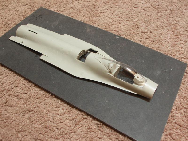

I needed to get a start on my pilot for fit purposes because the fuse will be zipped up tomorrow. Check out those snazzy side consoles! When I first got this kit, and I built up the ejection seat....I couldn't make heads or tails outta which way most of the parts fit. Some of them might be upside down? dunno. This will probably progress no further than 'squint-scale' from 2 feet away. The canopy is so thick, it makes everything distorted like some kind of 'funhouse mirrors' anyway. I'll make a vain attempt. I'm in 'get er done mode' and just want this model to go away like a bad habit. Updates tomorrow should see this with the fuse glued together and the wings on. AND hopefully sitting on it's gear. Whoohoo! More pics as things progress;

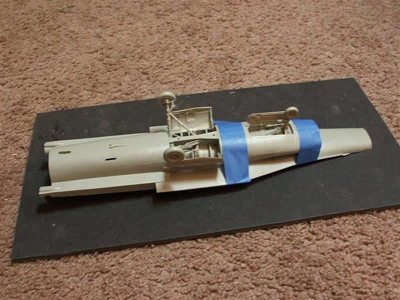

Dunno how 'correct' the gear is. There were no locater pins/marks/depressions or nuthin. I just let everything fall where it did and glued it. Used my enlarged plans to get the gear door angles as close to right as I could. I'll be closing up the fuse tomorrow, which will entail a ton of tape and clamps to get everything to warp to shape. Wanted to see if the canopy was even 1/2 way close, and after some creative carving (I don't think it's designed to be closed) got it within putty range. Unfortunately the clear parts weren't in a plastic baggy, so they're scratched and abraded badly. I started some preliminary polishing to get it presentable for these pics. I'm going to break down and get some Future to dip these in (I've never used it before ) and try to salvage what I have.

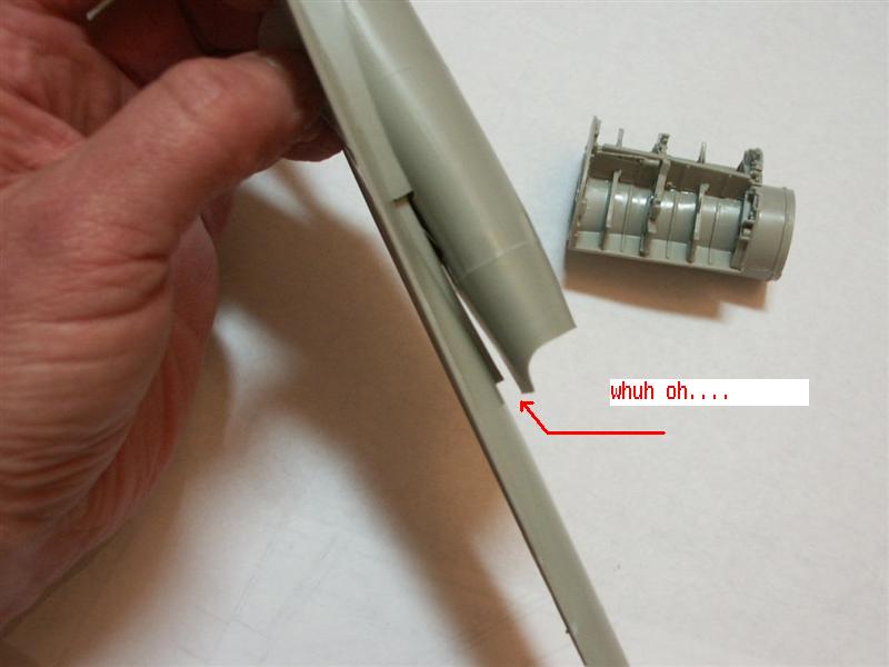

Now that the mounting points for the landing gear are lined up, I decided to mock the gear itself up to see how it was even going to attach at those points. Whuh oh,....maybe not. It's going to take awhile to get all the parts cleaned up for assembly. Here's an example of what most of the parts look like before carving and whittling,.....the others are worse. Got out the sprues with the ordnance and drop tanks 'n such to see what I could do with those.

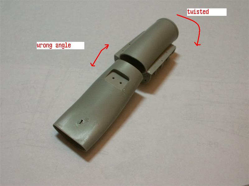

After much hacking and Cuban slang words,....I got the main landing gear bay lined up to where the wheels would also be level with the ground. Flipped over to show that the intake trunk was twisted and at the wrong angle swooping down into the front scoop. At least my landing gear won't be at some wonky angles now. Damage control on the intake won't be too awful bad, but my trust in how this kit is going to go together is now about as far as I can throw a '57 Chevy.

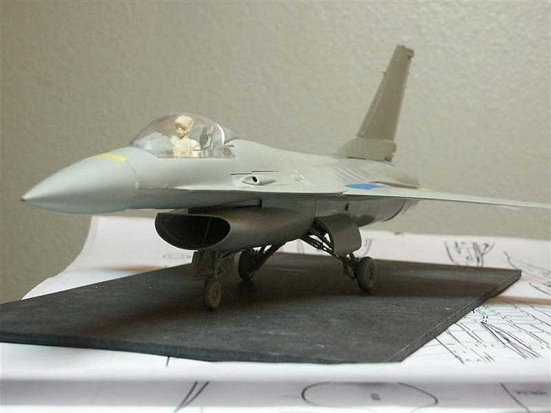

Taking 2-3mm's section out of the intake, along with some careful carving and shaping allowed me to actually slide the intake mouth over the end of the intake trunk finally without any protruding lips or unsightly huge gaps. I'm within a small amount of putty, and pouring white latex housepaint to smooth things out to have a smooth intake now. Whuf, I cannot believe the original Hasegawa boxing of this kit was this far off,.....but the original kit is pretty old and maybe that's just how it was? Dunno. OK, major accomplishment getting the intake lip in place, and actually being able to fit that circular compressor face onto the back of this assembly! Landing gear bay actually fits inside the fuse now,...sooo it's time to glue all this together and start smoothing things out. Wait until you see how this assembly slides into the fuse, and the rest of the outside intake housing go together. After many dry-fits and twisting with my needle-nose pliers....I think I have a 'sequence of events' for assembling this conglomeration with a minimal of filler? More pics as things progress!
