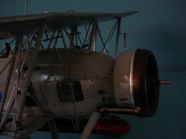

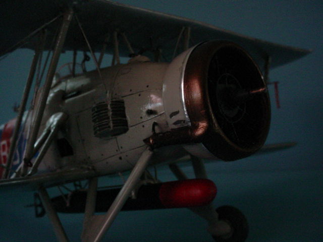

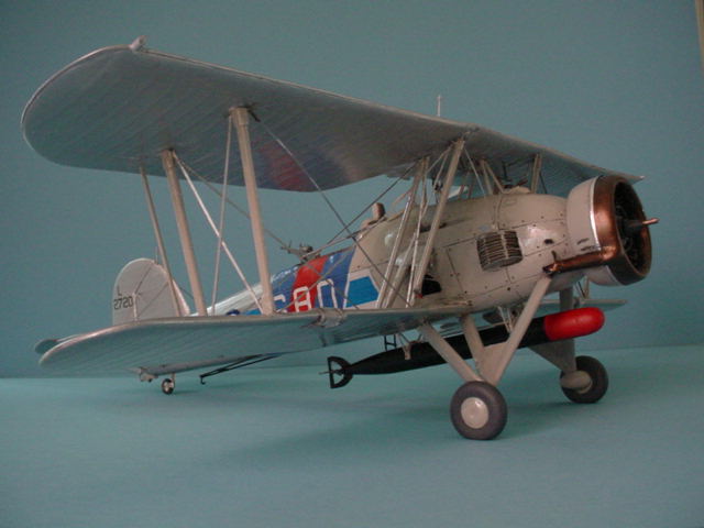

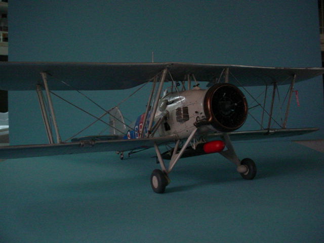

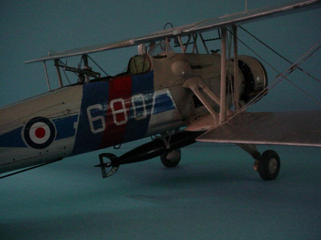

  8. Well guys n gals, a bit more work done. Been a bit slow again coz the work has been fiddly detaily bits. The torpedo sight, gunsight, wingtip lights, landing lights, wingtop navigation lights, rigging wires, torpedo shackle are all on. The torpedo and Vickers gun are now in permant situ, plus other small detailing. I would have liked the decals professionally made but, finances prevented that. So, another small arc in the learning curve and I've produced my own. All decals apart from the f/large strip ( blue decal sheet) have been printed on my h/p printer. A spray over with varnish and then a coat of Klear to stop the ink from coming off. The '608' were yet another problem to overcome. Initially, I thought about making stencils and spraying them. But after cutting out god knows how many, I didnt find any of them satisfactory. Next idea was to print the 608 in black on white decal paper which I did. The idea was to cut around the number and then when the decal was dipped in water, the ink would come off leaving a white number. Worked great except when I tried to slide it from the backing, it curled, bent, folded and was useless. Problem was just the number wasn't strong enough to slide from the backing. Then the night after last, after a couple of beers, an idea came to mind- RAF font printed on white deacla paper. Paint in the white middles of the number withe the background colour and cut out the number as a square, When dipped in water, the black ink came off and the white number with its coloured background still there and strong enough to slide from the backing. It worked! Today, the decals applied and a coat of Klear to seal them in (quick!) Anyways, enough of my rambling, heres some pictures, sorry they're dark, was hammering down with rain. Hope you like! Pez
