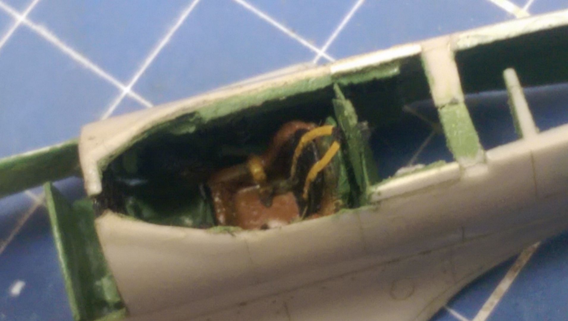

Per Dodgem37's request I tried to take a few pictures of my baby 1/72 Spitfire XIVc project that will be done in a 322 (Dutch) squadron livery with D-Day stripes, however the cockpit could not be captured in a way that provided for good pictures as there was too much shade inside of it plus the camera's zoom function was maxed out (no macro feature).
Rest assured though everything is in there down to a 7 (yes SEVEN) part throttle quadrant, seat belts and a few nifty little details that will be a feast to a modeler's eyes.
Aftermarket radio hatch + framework

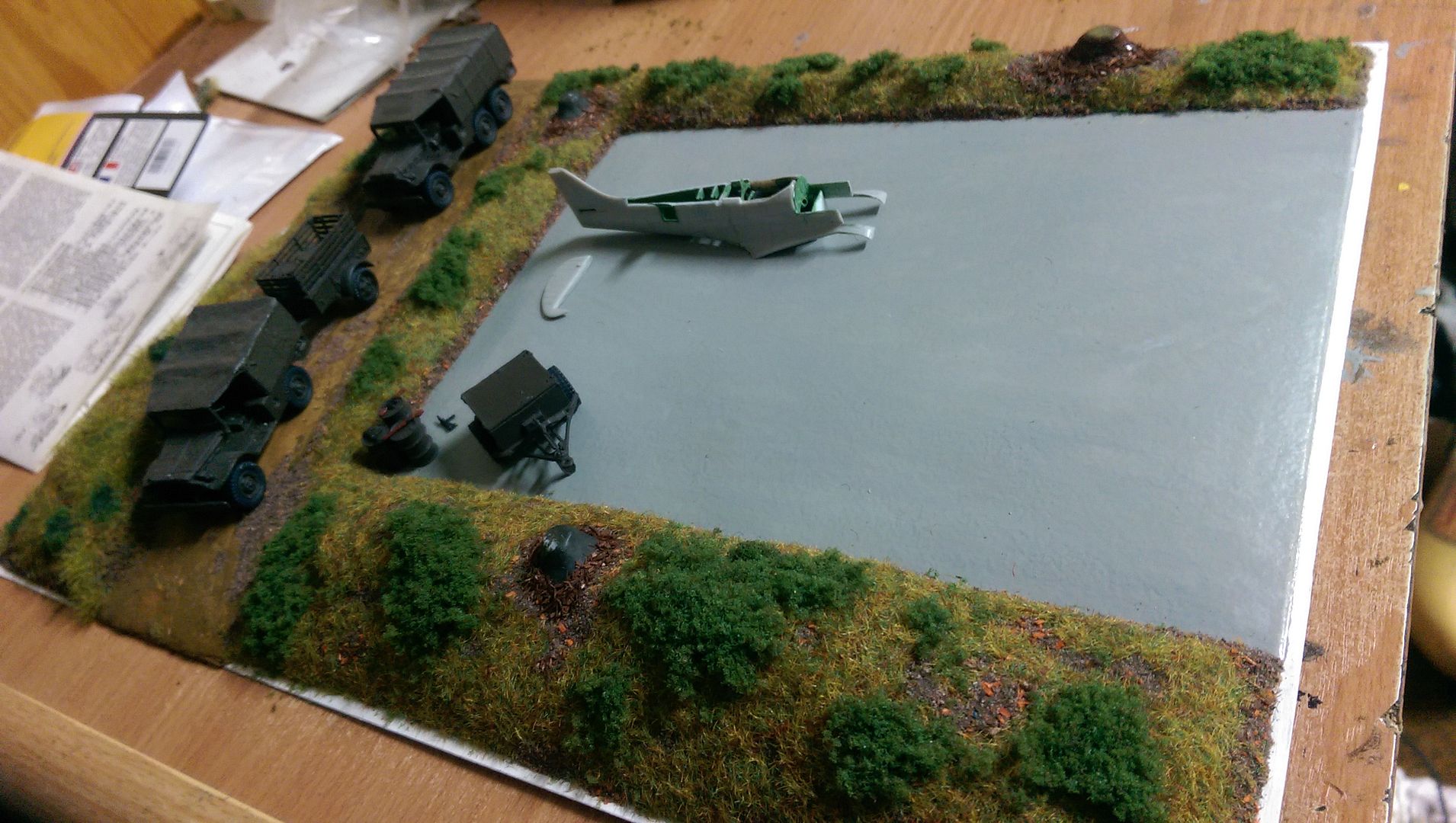

Working on a nice diorama at the same time, trying to get my head around finishing the planting
The seatbelts did come out reasonably

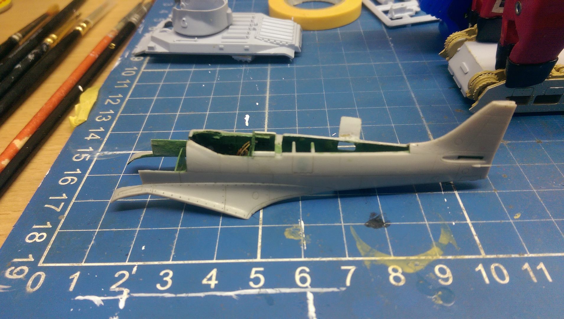

Fuselage as it sits right now. Tail rudder was cut off with a sharp knife and will be re-attached at an angle.
Reason the front section is not present is that an engine set will be added after completing work on the fuselage itself and the wings.
