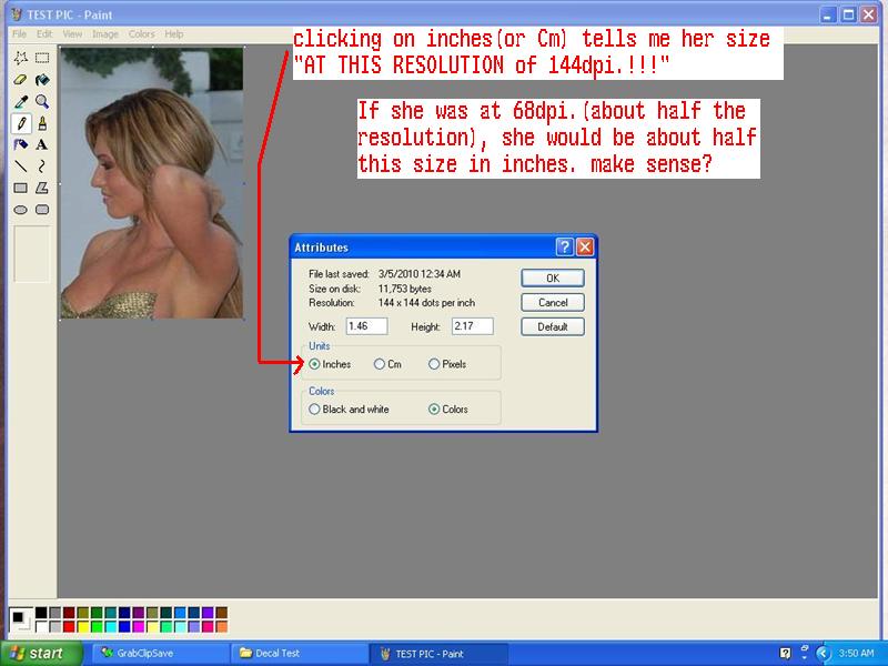

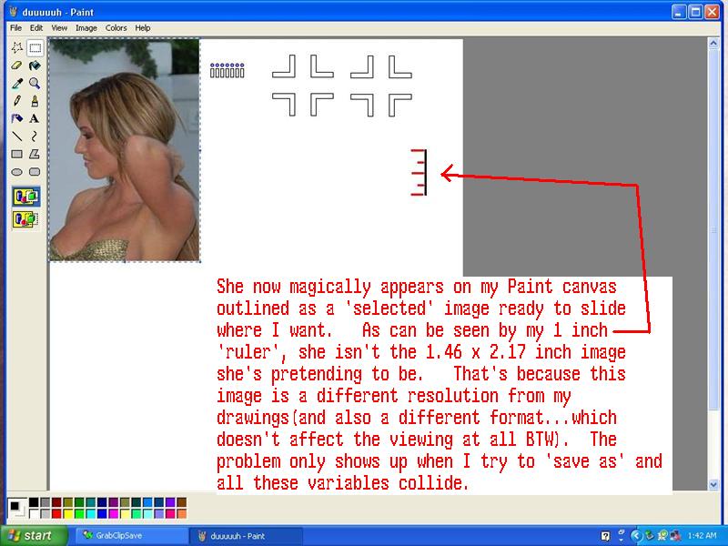

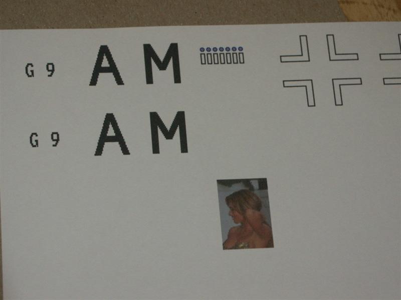

  2. All this is a mute point anyway. I just wanted to show that any image can be imported into Paint no problem, but if you want scaled decals(by not importing a larger image than your canvas), and crisp images(Ididn't even show what would happen to your images after you did the 'saved as' thing with different formats) you've got to follow a few simple steps......using your free paint program to get these variables to lock together. Illustrator and Photoshop don't have these limitations, and that's what you're paying the big bucks for when buying them. BUT! Paint is fully capable of overcoming these limitations with a few easy steps, and a few more clicks of the mouse than the big bucks stuff. Here is a pic of a print-out I did on regular paper of Phil's beauty at about 1 inch(25mm) tall. If I had used glossy photo paper, or decal paper with the printer set on glossy photo paper with decent light this image would be literally a miniature photo. Not too shabby from a 68dpi Paint program, eh?! Let me set stuff up on how to explain to do this, it isn't hard. A background on what NOT to do was necessary to help explain why I'm going to be doing what I do without bogging it down in so much detail as to be confusing. If ya'll want to practice importing pics of your model planes into paint, and drawing lines/touching details up and stuff....go for it! The sizing thing doesn't matter then, this is only if you want your decals properly scaled out and don't want your images mushed looking. Any digital image can be imported, but you may want to size it around 800x600 or it will look huge and require scrolling around to see the edges. You can then draw and scribble on it to your hearts content! Gotta go now, so I'll continue this thru-out the weekend. later All! Russ

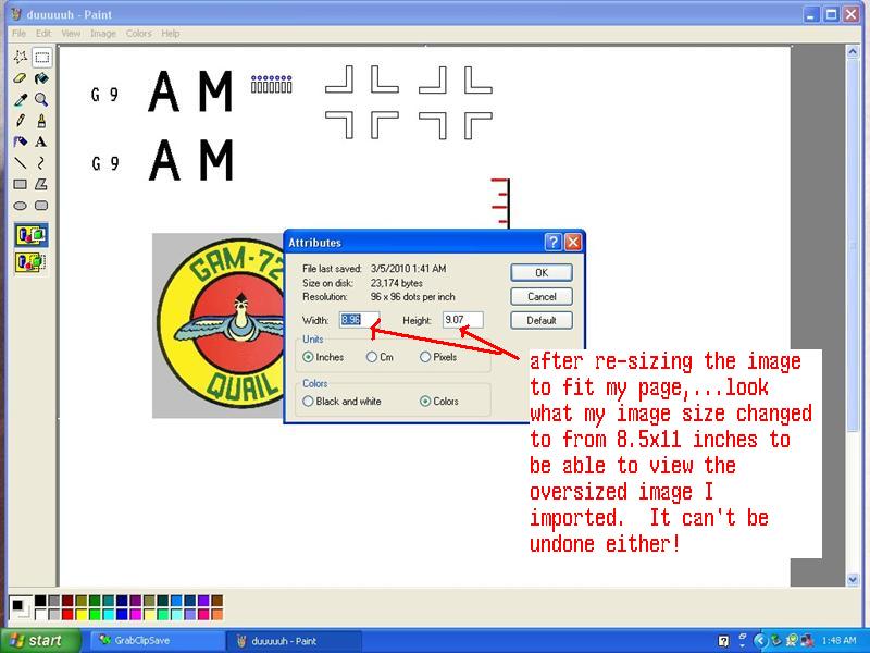

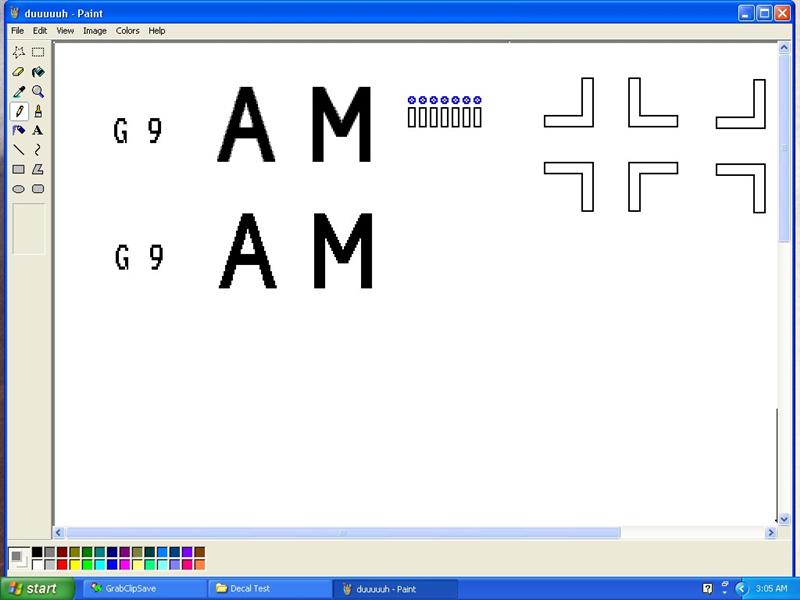

  3. I re-sized the image to be smaller, then went up to the 'image' button....scrolled down to 'attributes'.....and look what it did to my original 8.5x11 inch image. My canvas is now the size of the image I imported before reducing it. Even if I type in 8.5 and 11 in those boxes,....it won't go back!
  4. Image slid down to show my drawings underneath, and how it re-sized my canvas. Compare the white area with previous views above.

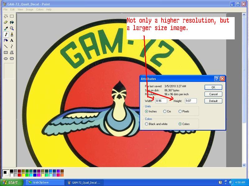

  5. Now i click on that 'inches' box(or Cm if you're looking for metric size) to see what this image is sized at it's 96dpi resolution.
  6. It's so big, my drawing is completely covered up.....and Paint has re-sized the canvas to be able to view the entire image. Gaaaaaah! While it's up....let's do the 'image' scroll down 'attributes' thing to see what the pixel size and resolution are for this pic.

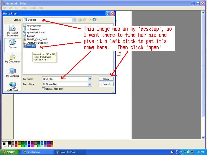

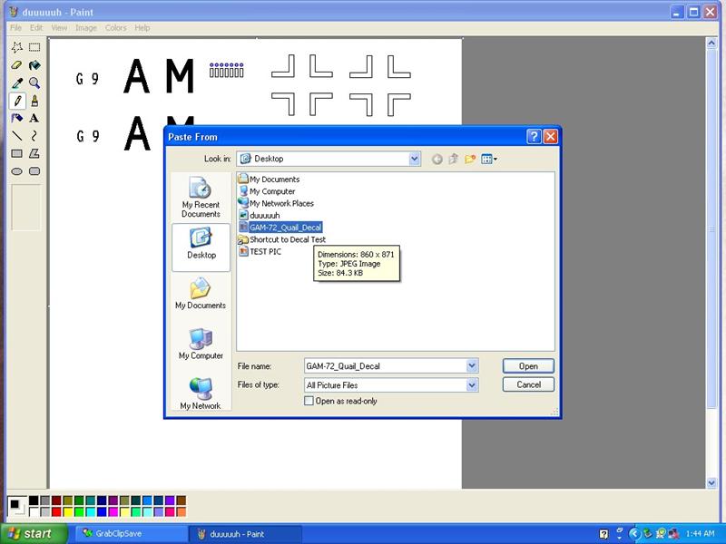

  7. Open up my decal canvas in Paint again.....go to 'edit' then 'paste from' remember? Then find my image on the desktop and click on it to get the name to show in the box and hit OK.

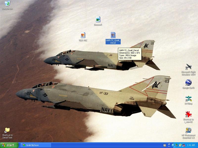

  8. Now back to importing an image into Paint that has MORE pixels size-wise than your image. Remember my original is 581x752 pixels, and when I run my mouse over this image I created(it's my avatar) it shows 860x871 pixels. A bit bigger.

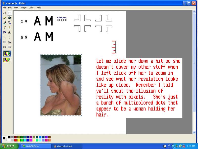

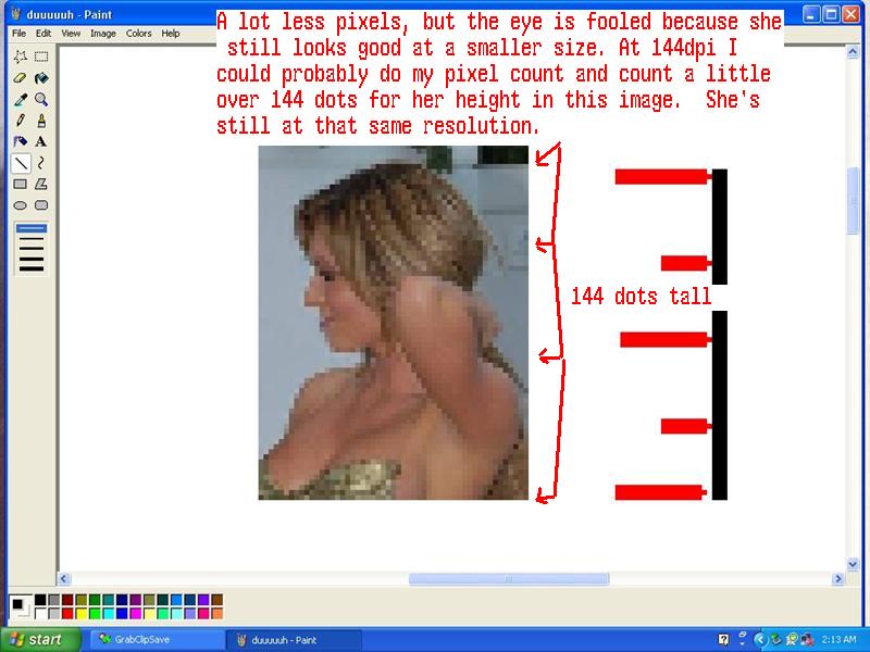

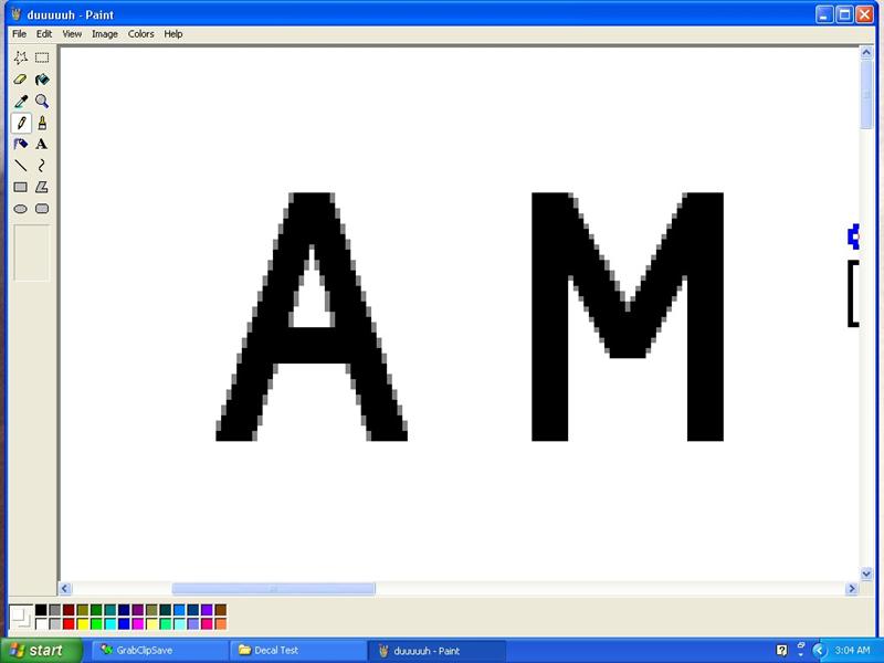

  9. Code letters on the bottom are untouched, and this is zoomed out a bit more. See how the eye 'blurs' them into looking less jagged? Now, zoomed out to 1x magnification. See how it 'smooths' things out? Cool, huh? You'd be amazed at what a few pixels of color will do to make an image look almost perfectly 'photographic'.

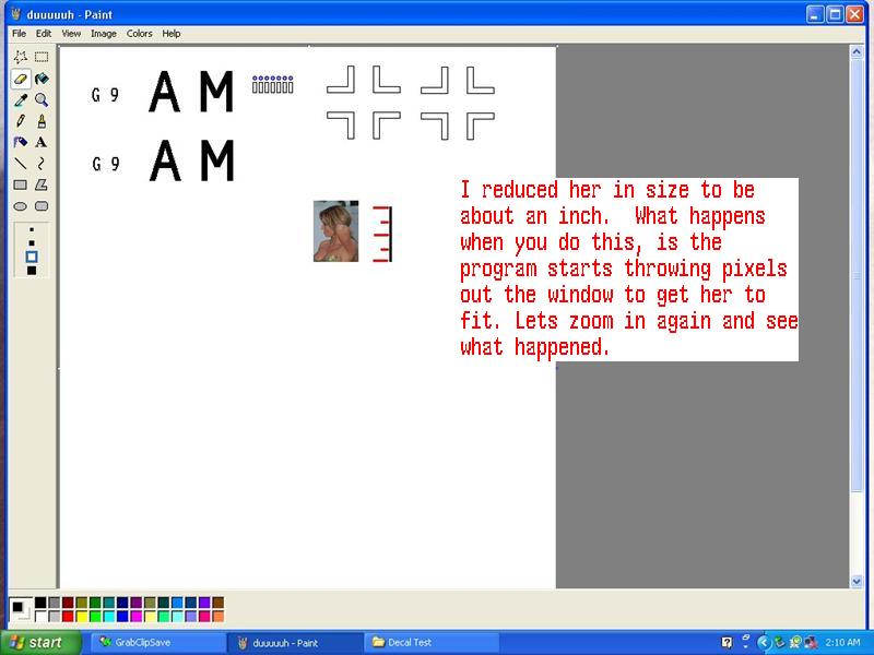

  10. Alright, now as ya'll can see....it's possible to import an image from a different format and view it/size it/move it around even at a different resolution. My original image is 581 x 782 pixels, and she was 210 x 312, so the image fit onto my canvas OK. I'm going to show what happens when I try to import an image that has MORE pixels (not per inch....that's resolution) than my original image. But first, while ya'll have her pixellated image above fresh in your minds.....I want to show how I can fool your eyes with making a lower resolution image 'appear' higher with a bit of color. See how she's just a bunch of multi-colored dots that blend together to give photo-realistic illusion even at 1 inch tall? I'm going to 'blur' your eyes with a few spots of color on my original 68dpi black code letters to make them appear less jagged or pixellated. Check out the grey color I applied to the 'steps' in my 'M' and 'A'. These letters are 3/4 inch or 20(?)mm tall, and this is highly zoomed.

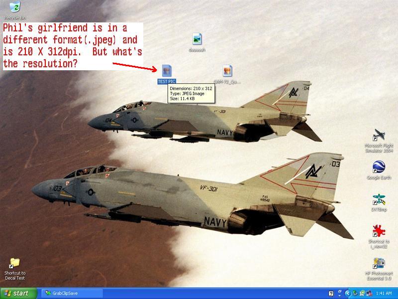

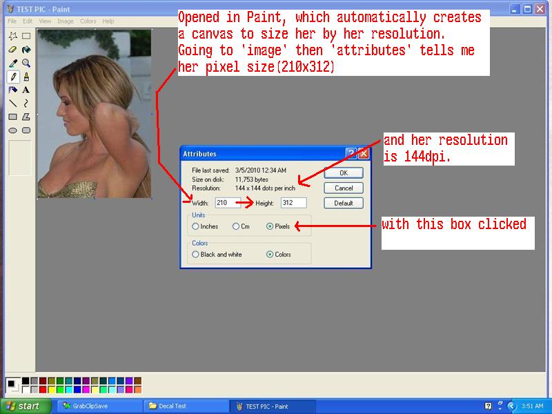

  11. So she's a different resolution, and a different format from my original image. Let me show you how to bring an image onto your canvas from anywhere on your computer. First i open up my drawing that I've already 'saved as' an 8.5x11 inch 68dpi image in .tiff format.
  12. Alright, abbreviated lesson today is how to import an image into Paint. I'm leery of doing this, because there are so many ways to mess up it would make a very confusing and long discussion. I'm going show ya'll how to do this during this weekend after I get my slide-show organized and put together. This is just an overview of how to do it, and some of the pitfalls. Again dudes, it's real easy to do,....it's just hard to explain why you're doing what I tell you, and not do things another way. Here's some examples. We're going to use that pic of Phil's new girlfriend, and another original that I have to demonstrate this. I've been trying to use original art work so far, because I'm sure that everybody is aware of the legalities and copyrights involved with using somebody else's stuff and I don't have the time or inclination to get into that. %99.9999999 of anything we use is going to be used for a 'template' of sorts to get a sizing and general idea of what we're trying to draw and will be edited beyond recognition from what it was originally.....but please be careful of the images you use. No matter how careful you are, even with original art,.....there are those that will you accuse you of copying. Be for-warned! Nuff said. OK, so I've got 2 images to show how to import. Both are .jpeg files(remember I saved mine as a .tiff and it's a different format?) and different sizes and resolutions. This will have no effect on how it views or gets edited in Paint, BUT all hell will break loose when you try to 'save as' and wonder what happened to your images that looked so good on your canvas. Both of these images can be made to print well, I only have time to show how to get them onto Paint for now. I saved Phil's (.jpeg)image to my desktop and called it 'TEST PIC'. Then, I take my file(which is a .tiff) and open it in Paint. When I put my mouse over my icon, it tells me what size this image is in pixels....not the resolution(remember my Paint had a 68dpi resolution?)

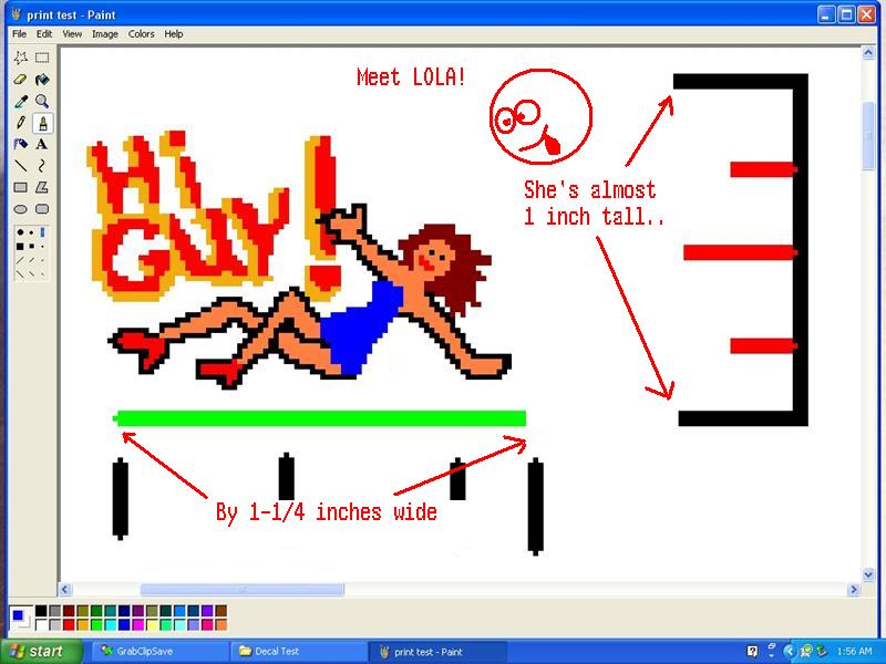

  14. OK, I printed her out on a piece of 'crack and peel' paper to be able to cut her out and stick her to the side of the 110. This concludes my demonstration of how to use your printer and a piece of paper to create a ruler on your paint canvas that matches the ruler in your hand. Excuse the crude drawing, this was just an exercise in sizing not image quality. I'm going to go pass out now. These lessons really take it out of me, sheesh. If anybody has a better idea for universally sizing every type of monitor to a ruler......wake me up tomorrow as I'd love to hear it. I'll take any questions also when I get coherent. Time for a pudding cup and a spot of sleep. Later all, Russ
  15. I wanted to call it "Hi Sailor", but I'm too tired and in a big hurry. DRAT! Not in a big enough hurry to give her a few more enhancements first.

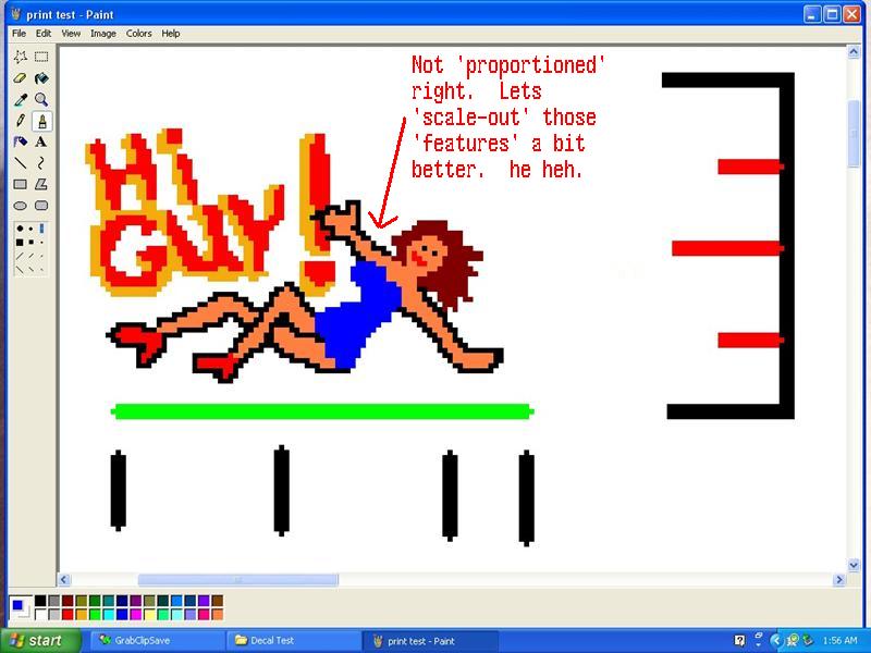

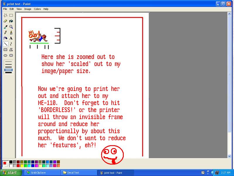

  16. Aaaaaand, after 5 minutes of scribbling I got this. An image that will print out borderless at 1-1/4 inches long by just a little under an inch tall, and I know it will size correctly no matter what size my monitor is. SWEEET!
