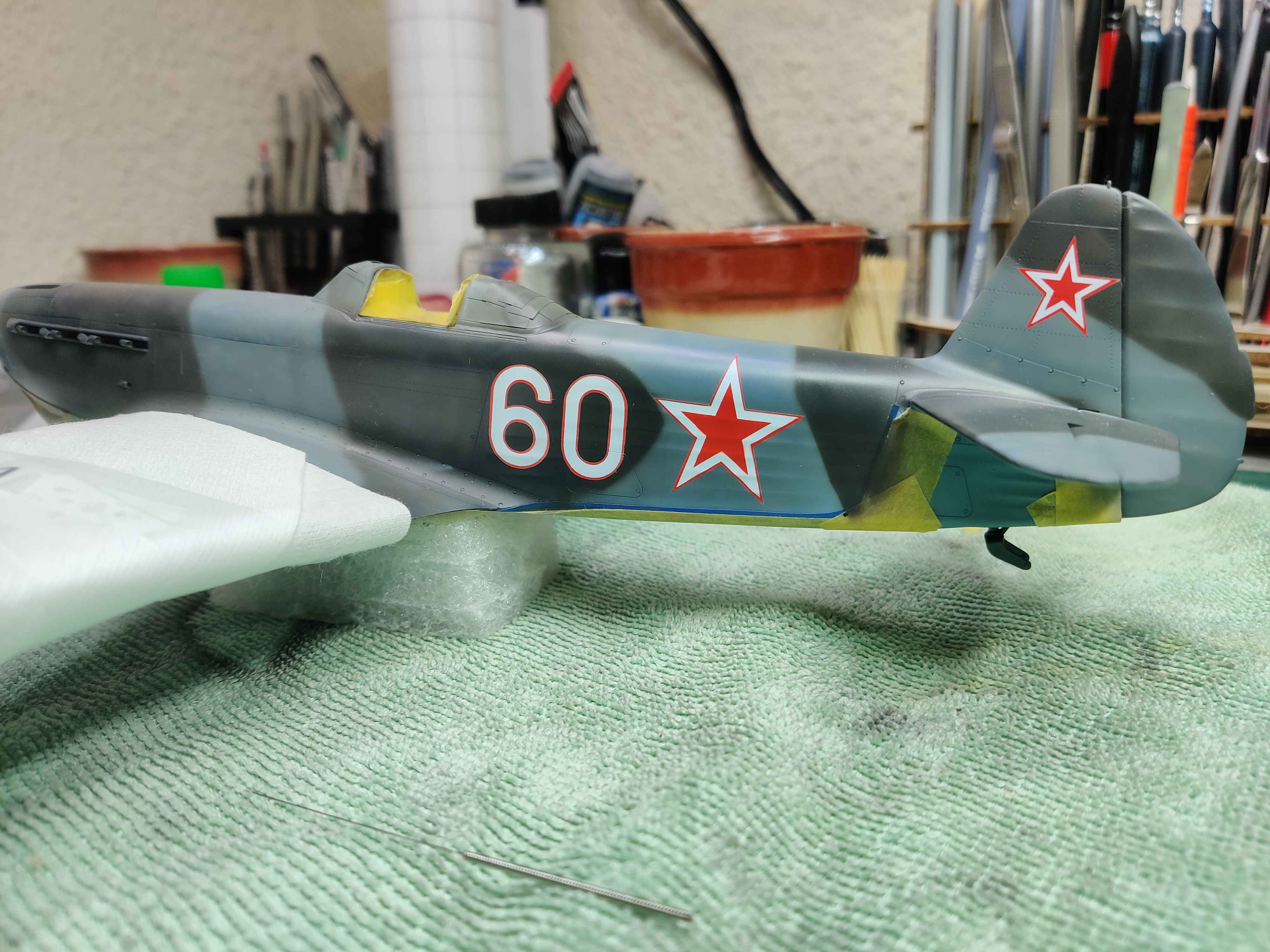

Furie Posted April 18, 2024 Author Posted April 18, 2024 Thank you all for your messages. Today I took care of the two "60s". If you look at the photos, you can see a thin border around the 6 and the 0 : I decided, in agreement with myself, that this border was red like the star's border. With this in mind, I placed the masks and painted them white, placed the internal masks and painted them red: Unfortunately, the "60" on the right-hand side was completely wrong: the "60" was leaning backwards and the "60" was squinting between the white and red parts: I had no choice but to redo it entirely (You can see it clearly in the photo above.). The right "60" completely redone: Rocat, TankBuster, monthebiff and 21 others 24

Furie Posted April 19, 2024 Author Posted April 19, 2024 Thanks Mat, Mike, Biggles (we're almost neighbors, so we'll have to meet up!), Richard, Max, Håkan (your first name reminds me of a Swede I admired: Håkan CARLQVIST) and Paul. I'm starting to gain confidence with these masks, but it's still a perilous exercise: I'm not allowed to make a mistake, but I made one anyway! Fortunately, the repair on the right "60" is invisible. Need I remind you that every time I have to set up concentric masks, I think fondly of Portland? Azgaron and Biggles87 2

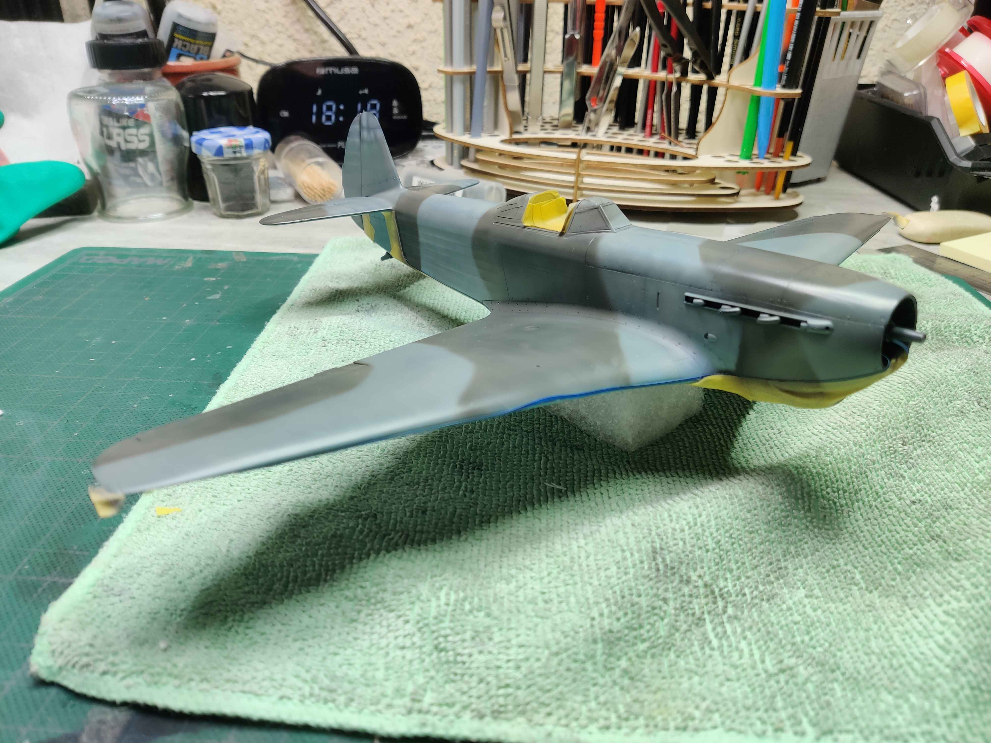

Furie Posted April 19, 2024 Author Posted April 19, 2024 (edited) Thanks Håkan for your message! Today was mostly touching up and a bit of chipping under the plane. As I had put tape on the front and back of the fuselage, it had made very sharp edges between the light blue and the 2 grays on the fuselage. So I redid these delimitations with these 2 grays using the airbrush buse/needle 0.2mm, but without the mask. Before : After : One detail can be seen in the photos at the rear of the fuselage: a maintenance hole that is lighter than the light blue tint : Under the wings and radiator I did a little chipping with blue MRP tint and white (50/50) and colored pencil. I represented dirt with exhaust soot. And I gloss varnished the underside of the wings, fuselage and horizontal stab. Edited April 19, 2024 by Furie Alain Gadbois, Dpgsbody55, MikeMaben and 15 others 18

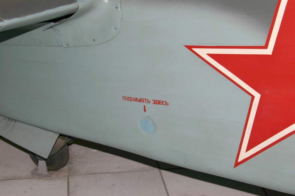

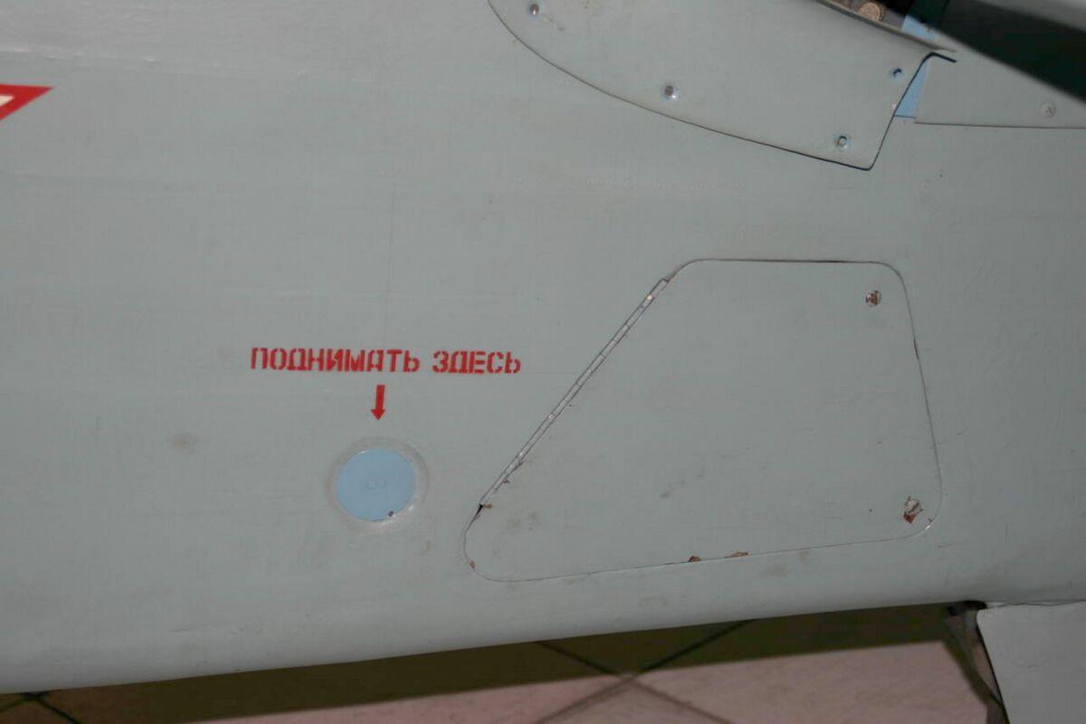

MikeMaben Posted April 21, 2024 Posted April 21, 2024 On 4/19/2024 at 11:04 AM, Furie said: One detail can be seen in the photos at the rear of the fuselage: a maintenance hole that is lighter than the light blue tint : Hi Denis , that hole is likely a lift jack tube. A tube on the bottom of the frame that they slide a rod thru and use the ends of the rod to hold the tail up during gun sighting. Not that it matters. They may have sealed them. Furie 1
Furie Posted April 21, 2024 Author Posted April 21, 2024 Hi Mike, and you're absolutely right. This lifting hole was plugged on my photo, and this is confirmed by these 2 photos taken on a Yak 9 in a museum: I placed some acrylic putty in these 2 holes and "closed" them. Azgaron, MikeMaben, Dany Boy and 3 others 6
