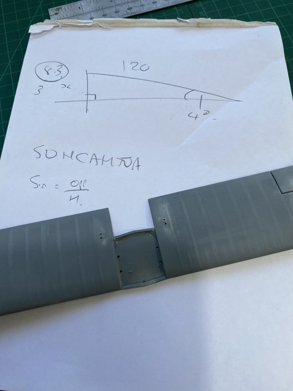

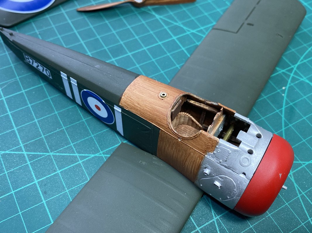

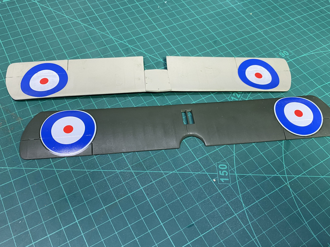

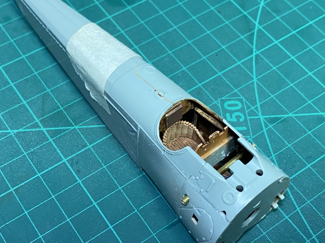

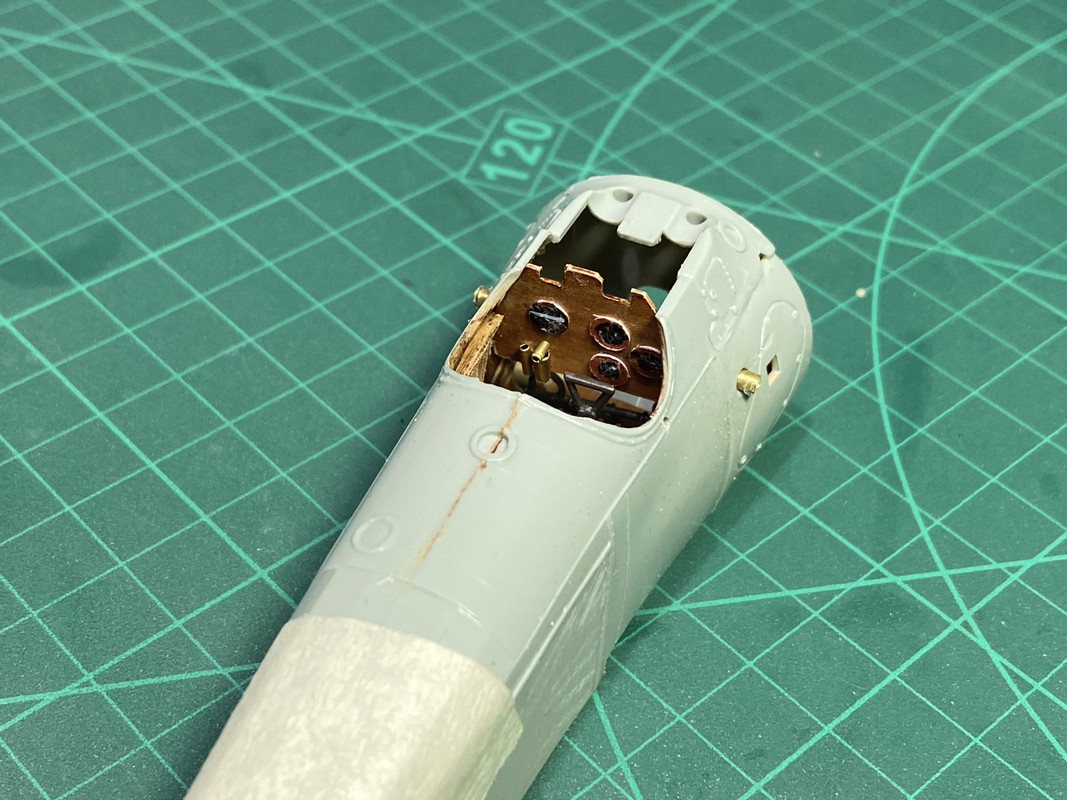

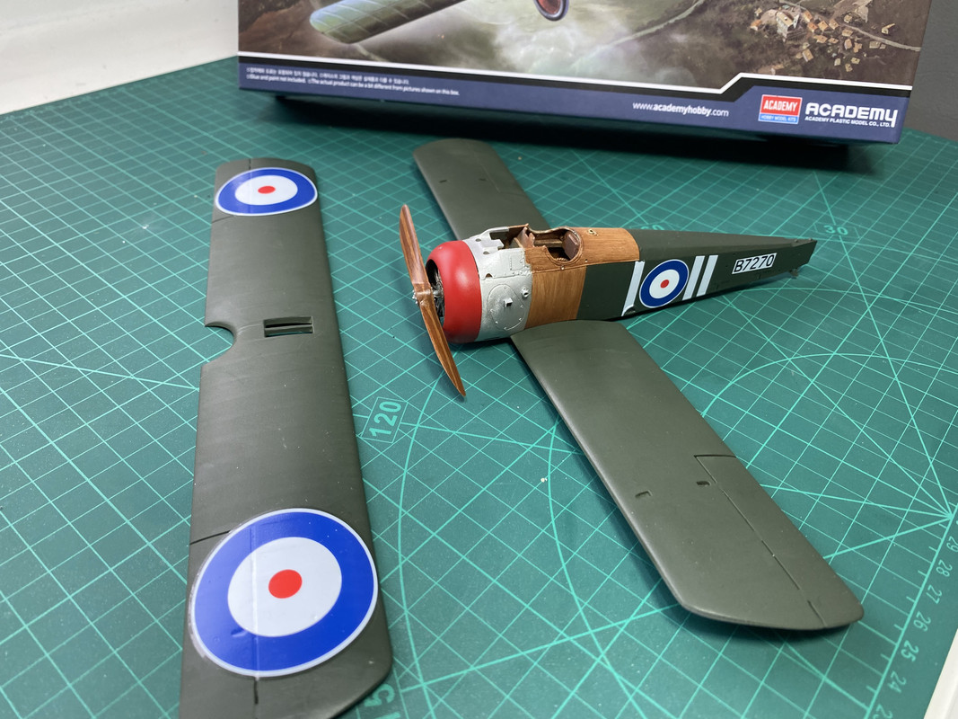

Panzerwomble Posted November 19, 2023 Author Posted November 19, 2023 (edited) More progress ...O-Level Maths at play to work out the amount to correct the dihedral angle .....altogether SOHCAHTOA.....8 mm high at the wingtip is the answer . Wings mostly done 100% spurious re made IP .... Nice Barracuda seat. ... Paining...masking ...painting Getting there slowly ... Next up - turn it into a biplane , and rig it all . ..... ..will this become a lawn dart ?? Will there be another post ........showing rigging .....who knows. ..? I think it was at this point I abandoned it before .hmm, PW Edited November 19, 2023 by Panzerwomble Dekon, geedubelyer, R Palimaka and 16 others 19
Alex Posted November 19, 2023 Posted November 19, 2023 Nice wood look there. I need to try and get something like that for the prop on my Bristol... Panzerwomble 1
Dpgsbody55 Posted November 20, 2023 Posted November 20, 2023 Looks good so far. Hope you can persist with the rigging. Cheers, Michael Panzerwomble 1
Gazzas Posted November 20, 2023 Posted November 20, 2023 Looking like a WNW kit now! If you ever wanna make a nice brown stain/varnish, Tamiya Clear orange mixed with the tiniest amount of Tamiya clear blue makes a nice brown... Hafta play with it though. Blue is way more potent and easily turns the orange into green. If you have tamiya clear red, you can even play with it a bit more. Keep em' coming! er... I mean keep up the good work. Rick Griewski, Alain Gadbois and Panzerwomble 2 1

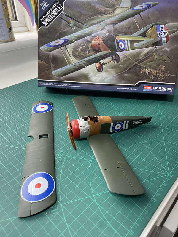

Panzerwomble Posted December 14, 2023 Author Posted December 14, 2023 Is it done? ....yes .....did I enjoy it? ...not really ...would I ever do another Academy Camel ? .... nope . Although that's 2 biplanes for me in 2023 - The Glad was far more fun . I was miffed to find out way into the build that the eyelets I built wouldn't fit into the brass tube turnbuckles I cut. Took it, that this was because I hadn't drilled out the tubing after cutting , but finally measured again and the wire was more like 0.2mm . TBH at that stage although I could have waited for more materials I just wanted to finish this otherwise it ran the risk of never getting completed Arthur Browns Camel with a bunch of liberties taken . "Panzerwomble's Cack Camel V2" ...my first (unfinished) build log on this kit on LSP was in Feb 2012 Feel it's more a par with .... Laterz PW mozart, Alain Gadbois, DugyB and 13 others 16
