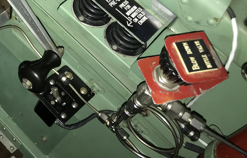

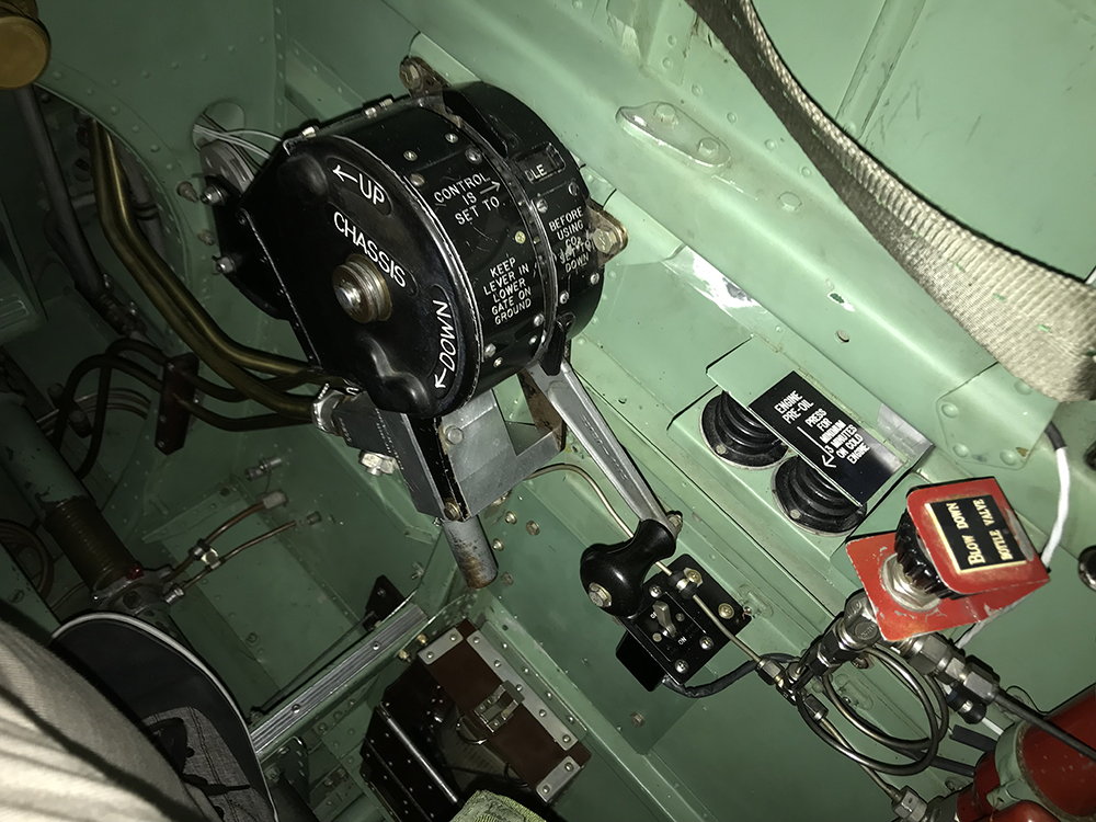

Bill Bunting Posted March 13 Author Share Posted March 13 Right sidewall detail added include a small storage box above and behind the canopy crank and a simple canvas strap below the crank with the paper checklist. The holes in the former were drilled to a greater depth. Lines added to the botyom of the undercart control. AU-J has a modern VHF radio and a transponder. In order to fit them a box was built just below the trim wheel on the left side. I used plastic card to build out the box. Wires were added to the electric coils. Seat and harness next. Isar 30/07, LSP_Kevin, geedubelyer and 4 others 7 Link to comment Share on other sites More sharing options...

Bill Bunting Posted March 23 Author Share Posted March 23 (edited) I have a few photos of AU-J when it was in Canada. The cockpit photos show a small control on the right sidewall beside the seat. It's a small valve control knob within a red bracket. I have no idea what it is and I have never seen it in cockpit photos of other Spitfires. It is located behind the undercart control and forward of the red cylinder. Anyone know what it is? Here it with the red cover turned around. I built one from wire, sheet plastic and a punched disc. I then lost it and built another. This is the first, the second is similar. So now it's time to see how it all fits together... A couple more details to add. Cheers. Edited March 23 by Bill Bunting scvrobeson, Landrotten Highlander, Shoggz and 10 others 13 Link to comment Share on other sites More sharing options...
MikeMaben Posted March 23 Share Posted March 23 This ? RBrown and Derek B 2 Link to comment Share on other sites More sharing options...
Bill Bunting Posted March 23 Author Share Posted March 23 5 hours ago, MikeMaben said: This ? It could be.... But a different design. Maybe a valve but without the plunger. Perhaps the system was pressurised? I'm meeting the pilot and owner next month, I'm sure he will confirm. This is a closer view of the one I'm doing. Thanks! scvrobeson, Paul in Napier and Derek B 3 Link to comment Share on other sites More sharing options...
MikeMaben Posted March 24 Share Posted March 24 17 hours ago, Bill Bunting said: It could be.... But a different design. Maybe a valve but without the plunger. Perhaps the system was pressurised? I think that's the case Bill. The red C shaped bracket looks like it pivots acting as a safety. Curious to find out. Bill Bunting 1 Link to comment Share on other sites More sharing options...
fastterry Posted March 24 Share Posted March 24 Well it's obviously the self destruct button. No, ok I'll get my coat. TRF Bill Bunting, MikeMaben and KiwiZac 3 Link to comment Share on other sites More sharing options...
red Dog Posted March 24 Share Posted March 24 (edited) If that helps here's a blowup of a picture with that part and the labelling : the original picture I had saved - sorry I can't remember the origin of the picture Edited March 24 by red Dog geedubelyer, KiwiZac, Derek B and 2 others 3 2 Link to comment Share on other sites More sharing options...
Bill Bunting Posted March 24 Author Share Posted March 24 9 hours ago, red Dog said: If that helps here's a blowup of a picture with that part and the labelling : the original picture I had saved - sorry I can't remember the origin of the picture red Dog - That's fantastic. Now I know what it is for. It looks very much like OO-XVI / C-GVZB since the drop tank control is missing and the added strap on the framework. Cheers! Link to comment Share on other sites More sharing options...

MikeMaben Posted March 25 Share Posted March 25 So that's the valve for the emergency LG down air bottle ? Replaced the hand pump. ? Link to comment Share on other sites More sharing options...
