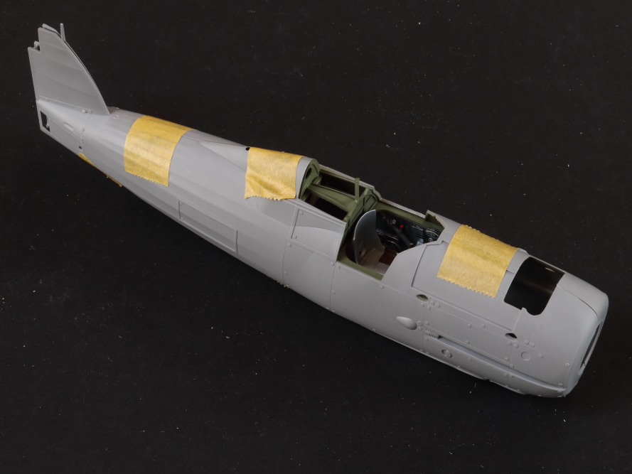

Iain Posted September 8, 2024 Author Posted September 8, 2024 Finally had a chance this weekend to play with the CAD model for the Radio set and mountings in Fusion 360. Test print: Now - I was going to add a lot of the 'twiddly' bits - mountings etc. - but a test fit showed they really won't be seen: As I'd painted it black you can't see much at this stage - but it *is* there - and fits perfectly... Better quality prints being run off as I type... Item the next was to address some of the rather stark/overly prominent surface detail on the ICM fuselage mouldings - these arewhere there are removeable panels on the real aeroplane - but I felt they really needed toning down - especially for a silver finish. Here you can see the difference between the port side, which has been done, and the starboard side, which hasn't: That's about it - a couple of steps forward and I *may* just get the fuselage closed up this week. Blue skies, Iain Phantom2, Landrotten Highlander, scvrobeson and 14 others 17
