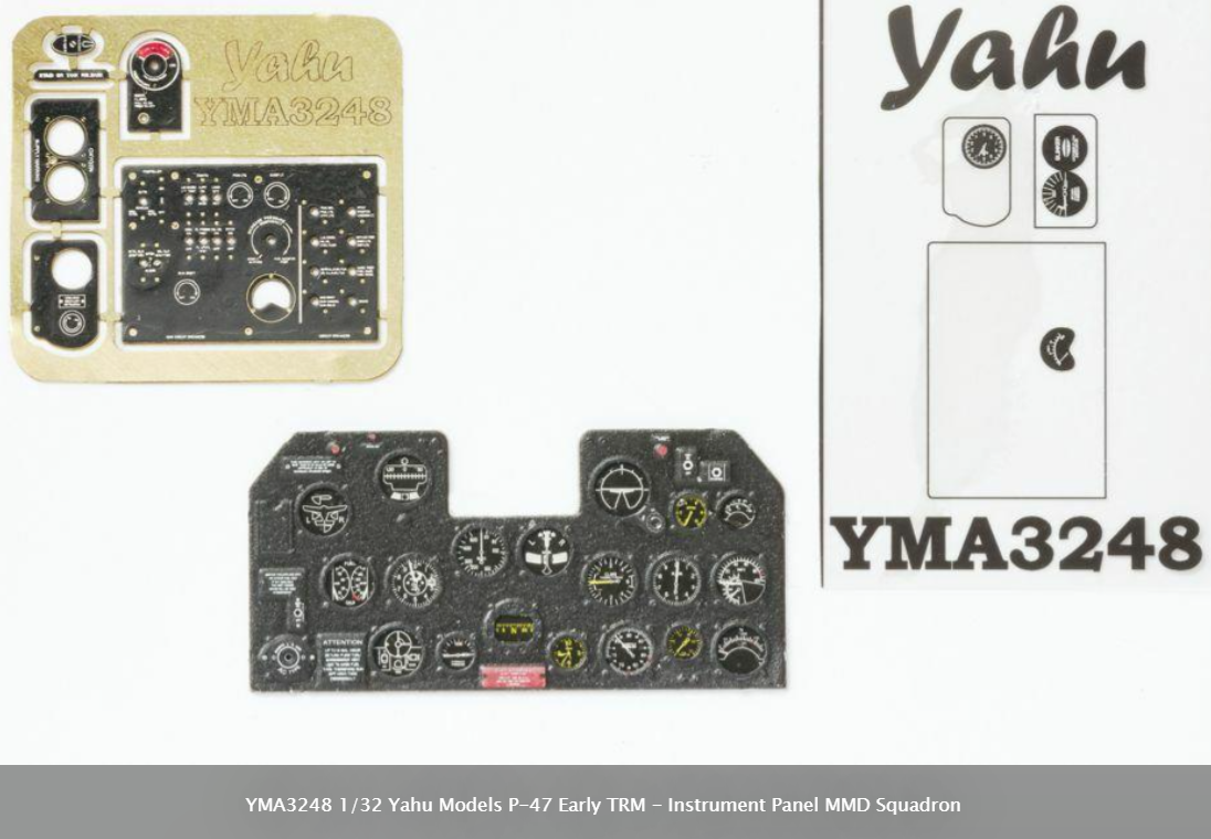

Antonio Argudo Posted November 21, 2022 Posted November 21, 2022 5 hours ago, Thunnus said: Yeah, I think this is worth a look... got a Yahu Panel ordered! John, the Yahu IP you need for the razorback is the early type, the one you posted in that picture is the late one in bubbletops Thunnus, HB252, Rockie Yarwood and 1 other 4

Thunnus Posted November 21, 2022 Author Posted November 21, 2022 Thanks guys! 8 hours ago, Antonio Argudo said: John, the Yahu IP you need for the razorback is the early type, the one you posted in that picture is the late one in bubbletops Thanks Antonio! As you can tell, I'm not able to differentiate between the early and late instrument panels. The photo was of someone else's build to illustrate the great resolution of the Yahu panel. When I ordered mine, I made sure that it was the EARLY version. 2 hours ago, scvrobeson said: Great fix John! The wheels and legs look better now. Looking forward to what comes next. It looks like if you want to replace the tail wheel, you've got the option of Eduard, Master Details, or True Details. They're the only sets that include a tail wheel Matt Thanks for the sharp eye, Matt! I'll probably stick with the vinyl tire since I already have resin replacements for the main wheels. Antonio Argudo and scvrobeson 2
