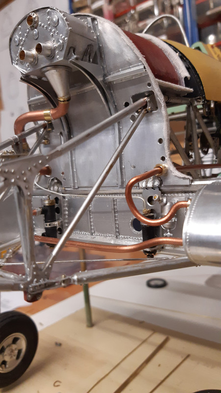

hurribomber Posted June 29 Author Posted June 29 After doing some research, I found out that this is the British-made Vickers fuel filter. Thanks, Steven and Julian. 👍 LSP_Kevin, Landrotten Highlander, CODY and 10 others 12 1
hurribomber Posted June 29 Author Posted June 29 Next to the oil/water trap: The fuel filter installed. JayW, LSP_Kevin, GMK and 13 others 16

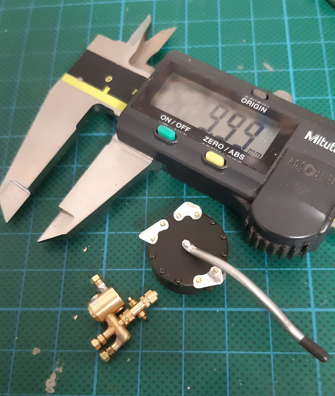

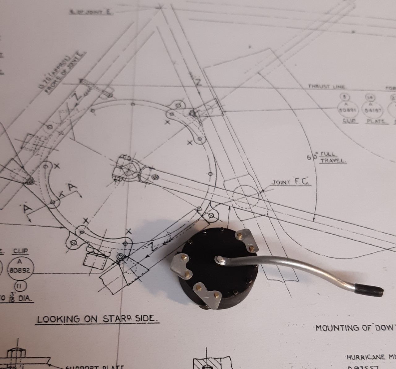

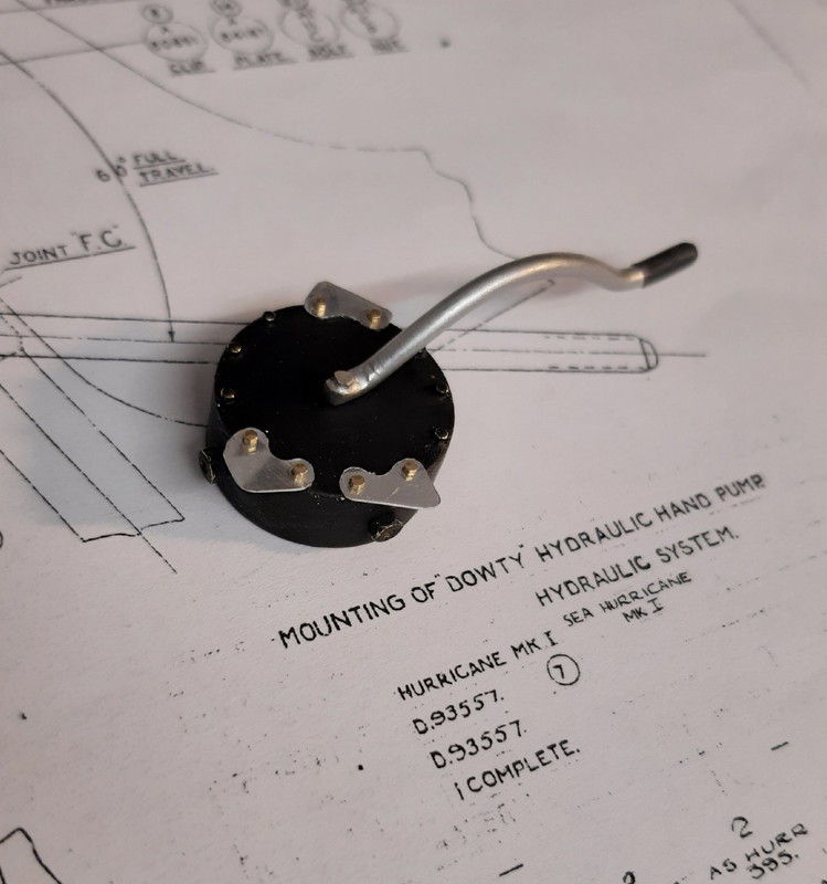

hurribomber Posted July 11 Author Posted July 11 Here's the hydraulic hand pump. Turned from brass. Brackets fixed with 0.6 mm screws. Shoggz, LSP_Kevin, Polecadt and 5 others 8
hurribomber Posted July 11 Author Posted July 11 The non-return-valve was fiddly to make. Landrotten Highlander, Shoggz, LSP_Kevin and 10 others 13

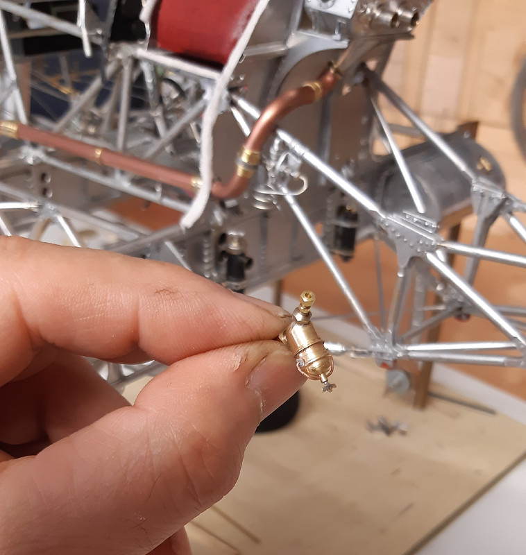

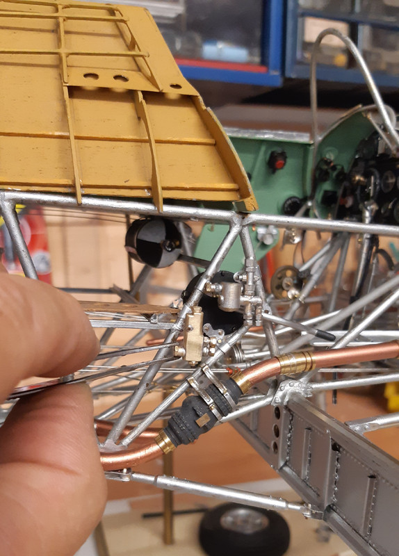

hurribomber Posted July 11 Author Posted July 11 Mounting the parts to the fuselage struts also required patience and nerves of steel... The automatic-cutoff-valve is also ready for installation. After that, I can install the various hydraulic lines. ..until later. Hubert Boillot, repeatplease, RCPlym and 14 others 16 1
