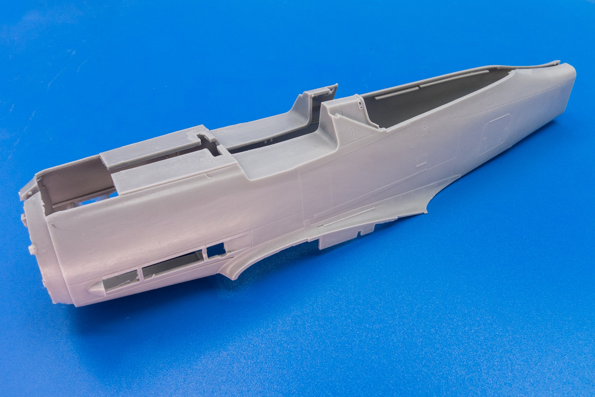

Thunnus Posted March 8, 2021 Author Share Posted March 8, 2021 Some seam clean up on the D-13... The main issue with the wing roots is to eradicate the seam line that runs right through the cannon cover. Primer on the resin center wing part revealed a rough surface so I need to smooth that out as well as clean up the glue seams and possibly rivet the area. F-4Phanwell, 109, D.B. Andrus and 11 others 14 Link to comment Share on other sites More sharing options...
