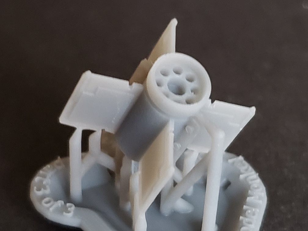

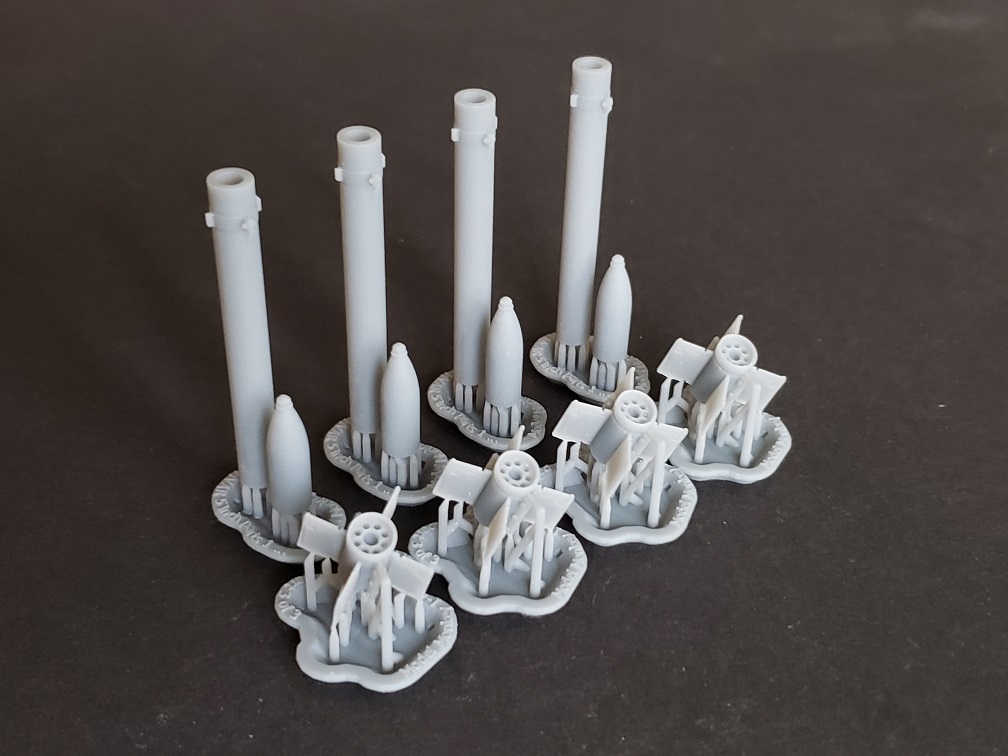

Model Monkey is happy to announce a set of four 1/24 scale 5-inch HVAR rockets has been added to the catalog.
This accurately scaled and detailed set of models represents fully fused 5-inch High Velocity Aircraft Rockets (HVAR) carried by US Army Air Force, US Navy and US Marine Corps aircraft during World War Two and the Korean War. These rockets were also fit to aircraft flown by allied forces including the RAF, RCAF, RAAF, RNZAF and RSAAF, etc.
HVAR rockets were typically fit to many USAAF, USN and USMC single-engine fighter aircraft such as the F6F Hellcat, F4U Corsair, P-51 Mustang, P-47 Thunderbolt, the TBF/TBM Avenger, and later the F-80C Shooting Star, F-84E Thunderjet, F9F Panther, and F-86 Sabre. It was also used by some multi-engined aircraft such the PV-1 Ventura and PV-2 Harpoon.
