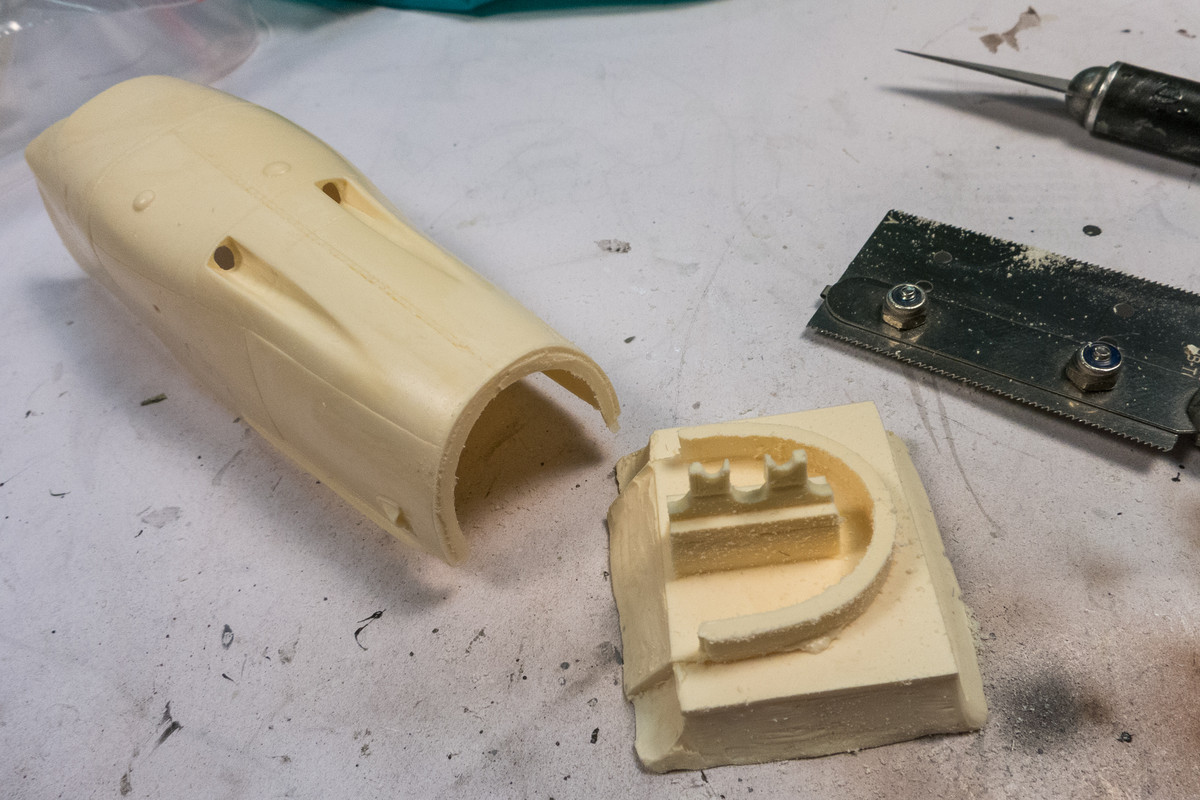

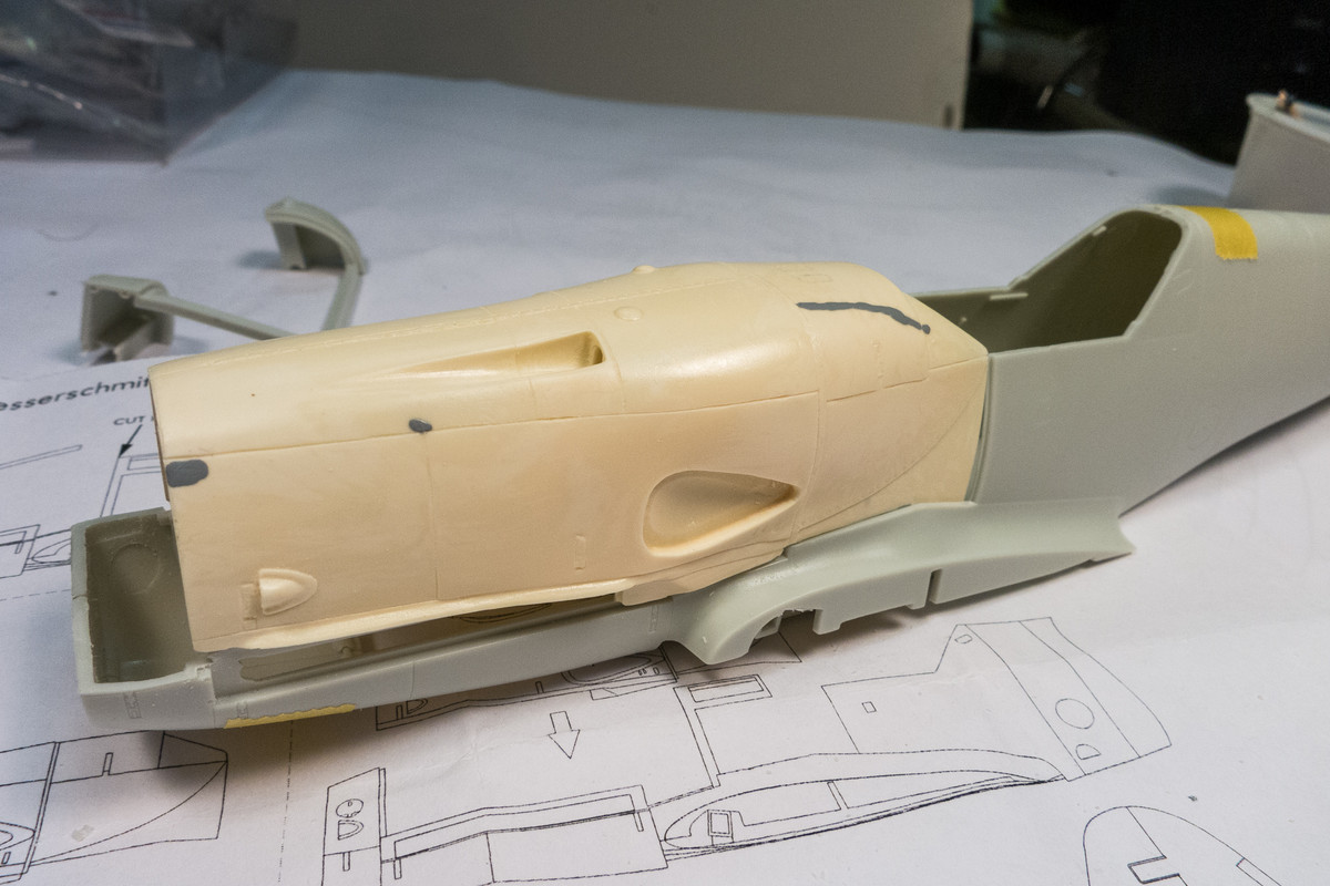

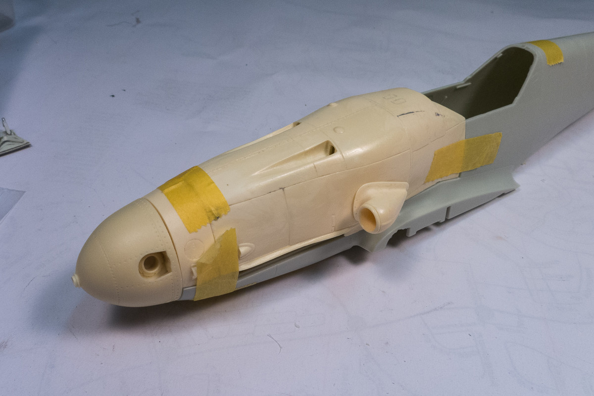

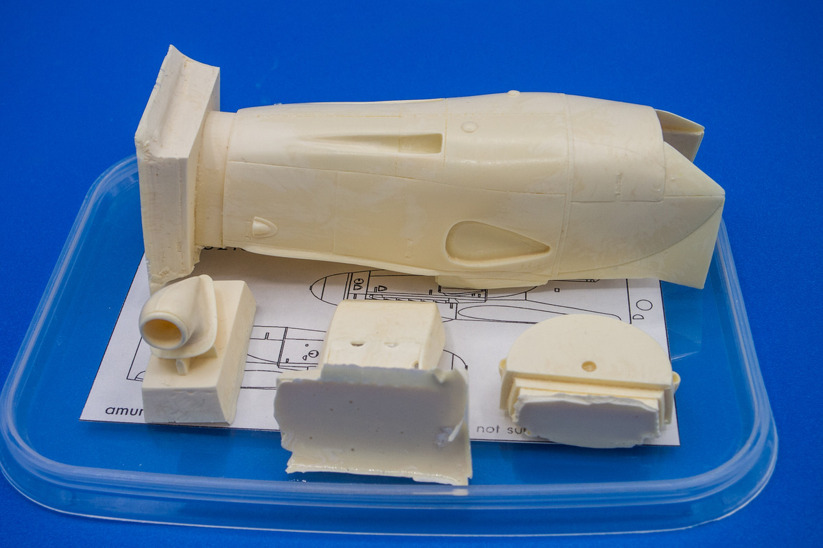

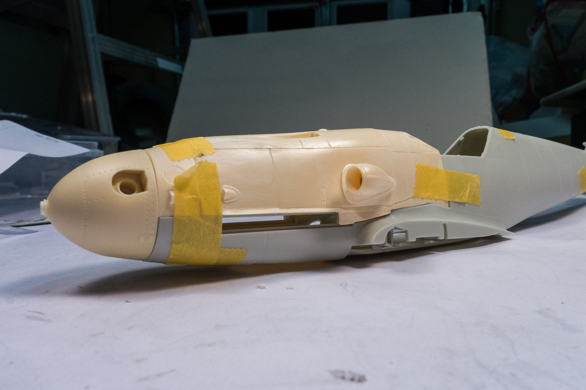

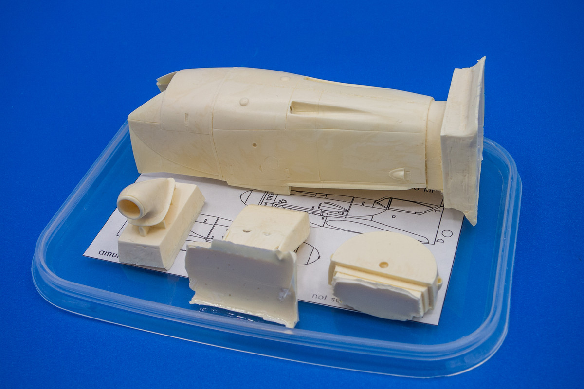

Thunnus Posted January 22, 2020 Author Posted January 22, 2020 Wanting to take a brief break from the Corsair and Ta152H builds, I took a look at the AMUR Reaver resin cowling for the Bf109G-6/AS conversion. I removed the casting blocks from the parts with a razor saw. Interestingly, the casting block for the cowling piece had a nested set of small fairings which needed to protected. Fortunately the saw cut line did not put the small parts in harm's way. The panel lines were of irregular depth and consistency so I reinforced them with the scriber. Of course, my blade skipped a few times, which required some minor putty work. The required surgery on the kit fuselage parts is quite easy compared to the AMUR Reaver cowling replacement for the G-10 Erla. A few strategic cuts through relatively thin areas made it an easy exercise. A preliminary fitting of the resin engine cowling onto the fuselage. I had left some excess plastic on the top edge of the forward fuselage cut so I was able to square off that joint. Preliminary fit of the AMUR Reaver cowling is very encouraging. BiggTim, MikeMaben, TorbenD and 22 others 25

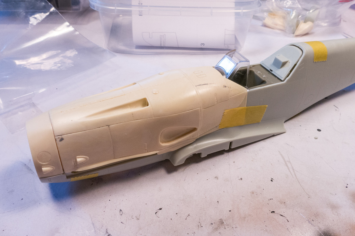

Thunnus Posted January 23, 2020 Author Posted January 23, 2020 Thanks for all of the comments! Establishing the preliminary fit of the AMUR Reaver cowling to the kit fuselage, I prepared the Barracuda resin spinner, added a prop shaft using a piece of plastic rod and mounted it to the cowling to check the fit. It looks ok at this point but things can change as parts are glued into place permanently. Since I was at this stage, I wanted to check the fit of the windscreen and canopy as well. The windscreen actually slides UNDER the cowling piece so the little bulges on the fuselage fairing in front of the windshield need to be trimmed away. The exterior fuselage components seem to be lining up fairly well. Next I'll have to see how the Aires resin cockpit factors into the fit equation. TenSeven, jgrease, Greg W and 17 others 20

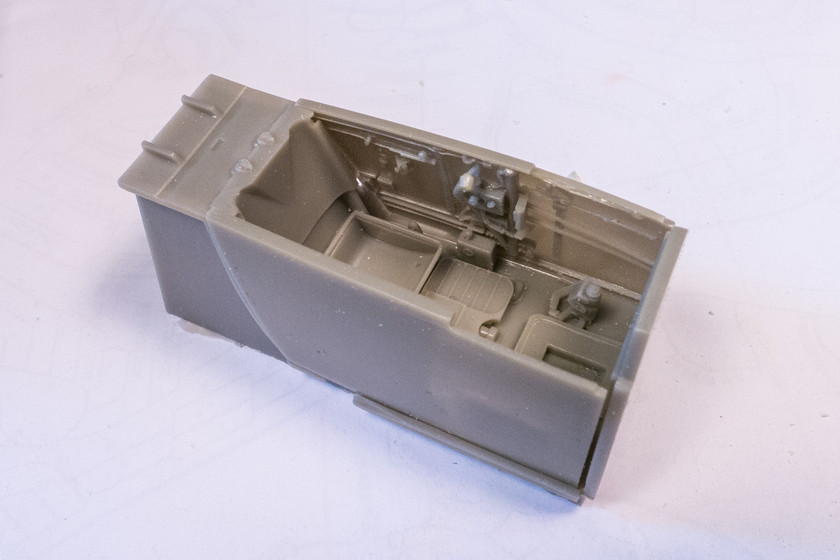

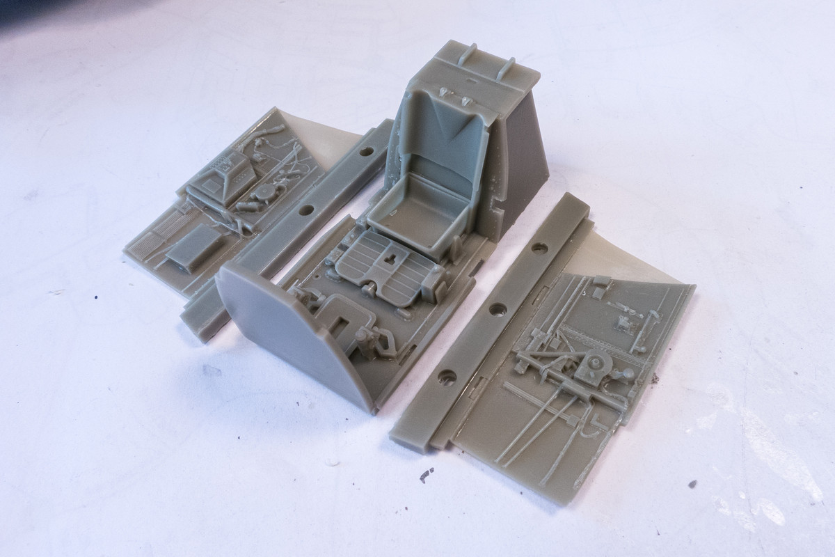

Thunnus Posted January 24, 2020 Author Posted January 24, 2020 After fitting the Barracuda spinner onto the AMUR Reaver cowling, I thought I'd pack the build back up and concentrate on the Corsair. But John1's comment about the Aires resin cockpit made me very curious. Without diving into the details of the resin set, I thought I'd at least check the fit of the main components: cockpit tub + the two sidewalls. I removed the sidewalls from their casting blocks, making sure to retain the mounting tabs on the bottom edge. Based on my experience with the Aires G-10 cockpit, I left the humongous casting black on the tub untouched for now. There are some gaps at the joints but overall the fit of the three components was relatively positive. There are no rock solid attachment points between the cockpit tub and insides of the fuselage so I'll have to make final placement relative to other components, such as the rear cockpit sill. Still, this should give me an idea of the kind of adjustments I'll need to make in order to make the resin fit. To my pleasant surprise and just like my experience with the G-10 cockpit, the Aires pit seems to fit ok even with the casting block of the tub in place. The gap in the fuselage framing above the forward cockpit section is easily closed with light finger pressure. There would be no reason why the AMUR Reaver cowling would NOT fit over this but I wanted to verify it with my own eyes. I recognize that glued parts have much less give than taped components so this is not a final result but I'm not encountering any significant fit issues between the resin cockpit parts, kit fuselage and AMUR Reaver cowling. I even slipped on the canopy for good measure. If my G-10 experiences hold true with this build, I'll have some conflict between the casting block and the wing spar but that should be an easy hack job with the results hidden from view. Mekon, TenSeven, Kahunaminor and 20 others 23
