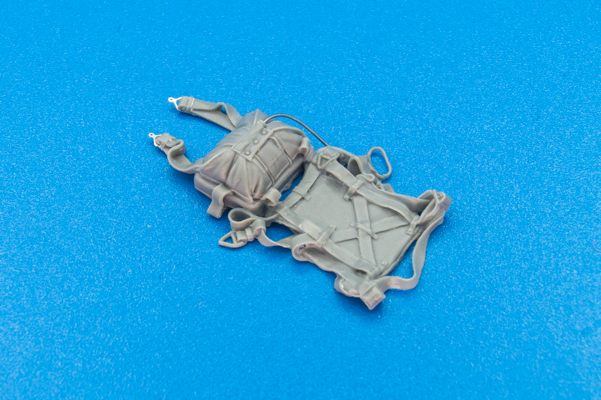

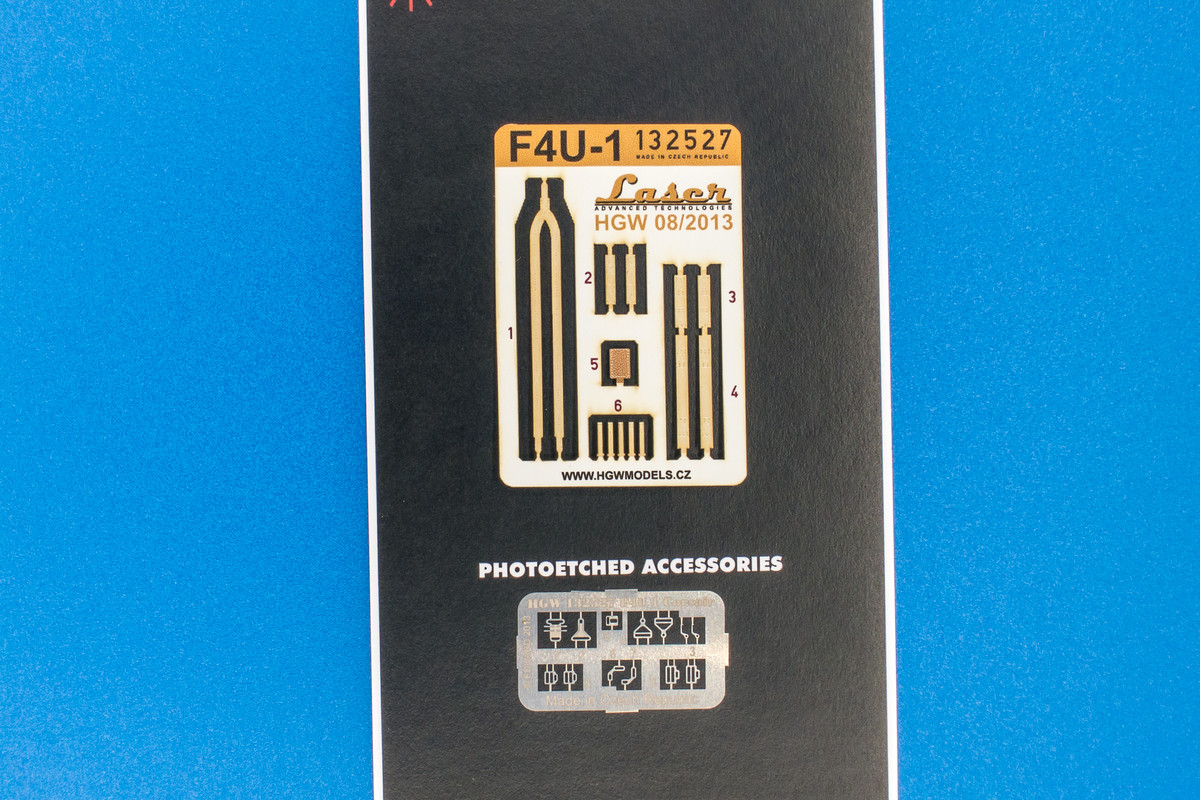

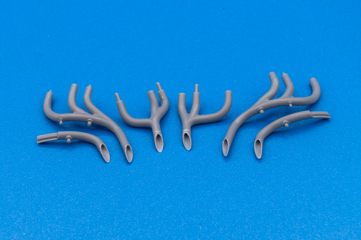

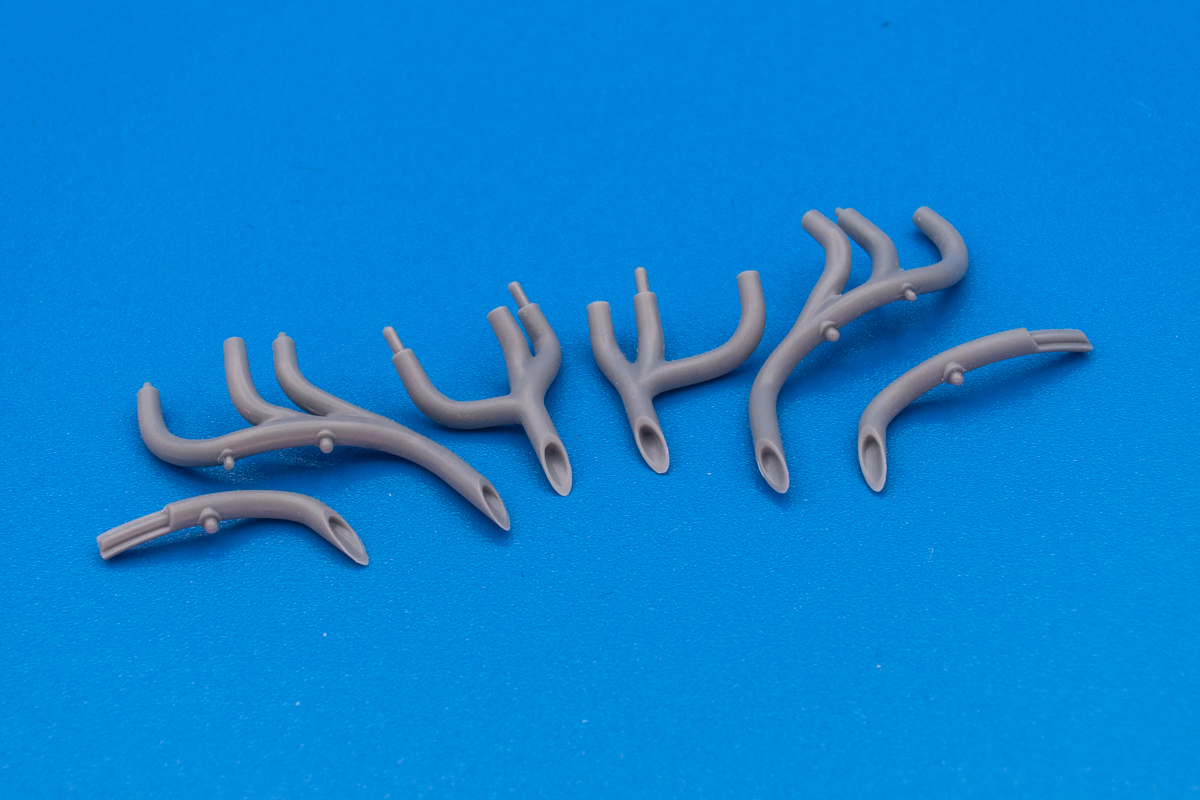

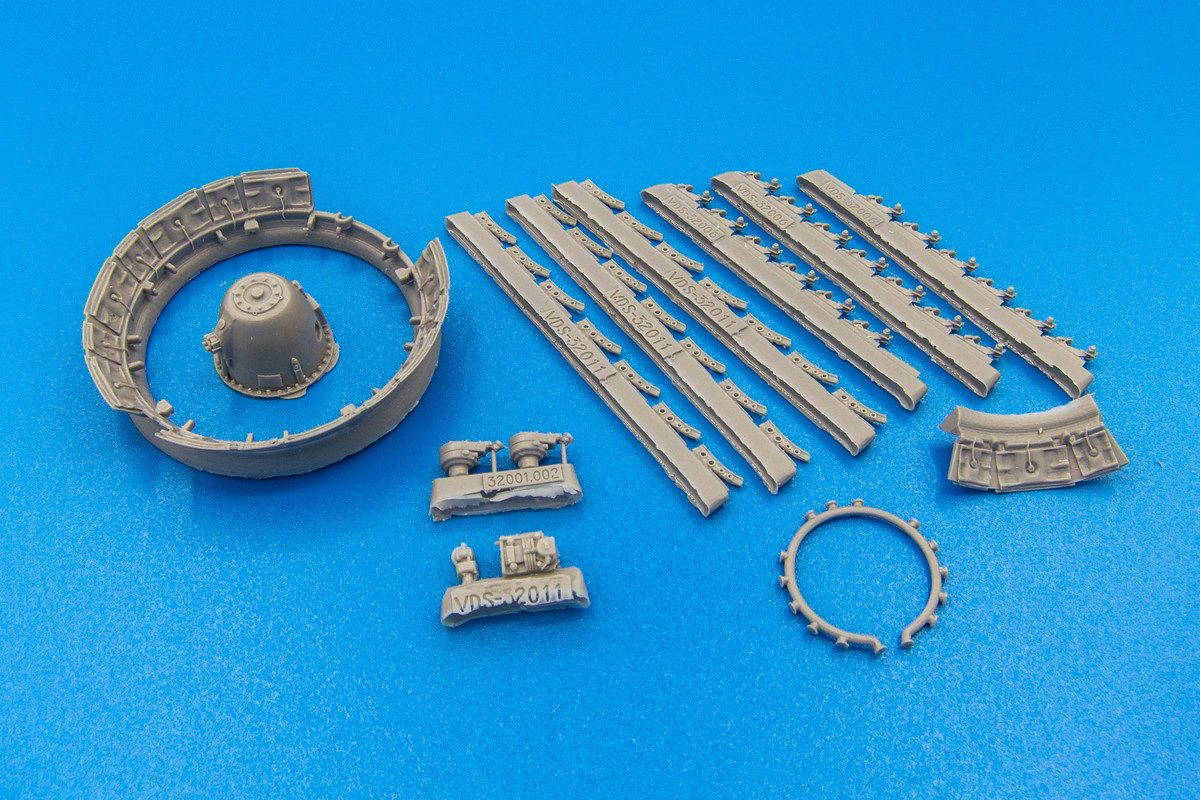

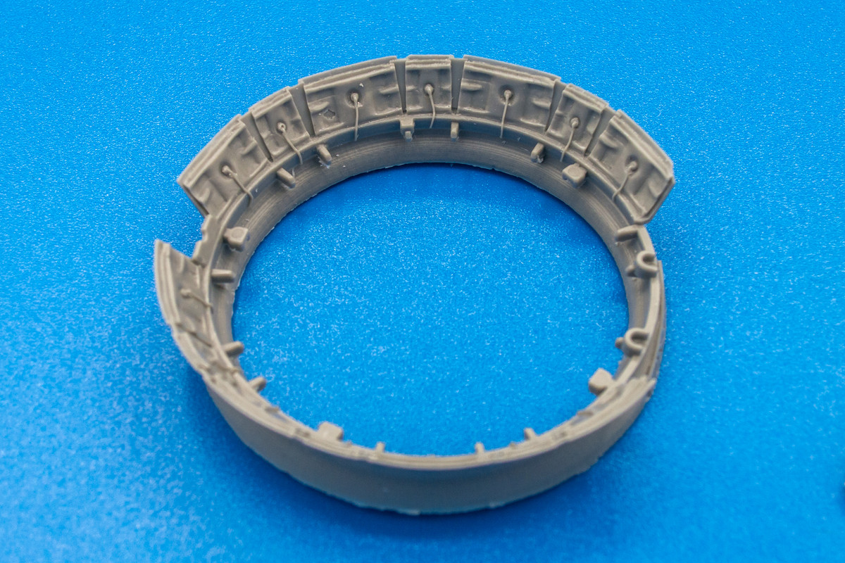

Thunnus Posted February 28, 2019 Author Posted February 28, 2019 Instead of showing all of the sprues, maybe I'll just cover the extras since I took the time to take photos of them in my light box. The Vector cowl flaps are the biggest addition. The set comes with a crankcase assembly but it might be too much of a bother to incorporate since it is a solid piece and some precise surgery would be needed to center the prop shaft hole, which is not something I am particularly good at. I'll compare it with the kit parts before I make a final decision. Photos of 740 indicate that it had smooth tires so I've picked up a set of Barracuda resin wheels as replacements for the kit's vinyl tires, which are treaded. The cockpit will feature fabric belts from HGW. Not as many buckles as a typical Luftwaffe set so this should be easy. I'm also going to be using the Barracuda cockpit stencils. Lots of tiny decals, many of them color-separated, which should make for lots of fiddly placement, I imagine. Montex masks will be used for the large markings. Masks are ideal for US markings since they cover so much real estate. And here's the True Details parachute that lots of people have used on their Corsair builds. There was one little thing that I wanted to take a look at before the build begins in earnest... the exhaust stubs. They are semi-hollowed out but are on the thickish side. Using a dremel and some metal bits, I thinned the exhausts a bit and deepened the openings. Something that caught my eye when reviewing the kit parts. I'll probably be doing little odds and ends like this for a few weeks as I clear off my work bench of recently finished builds. Jeff, florin13, Martinnfb and 11 others 14

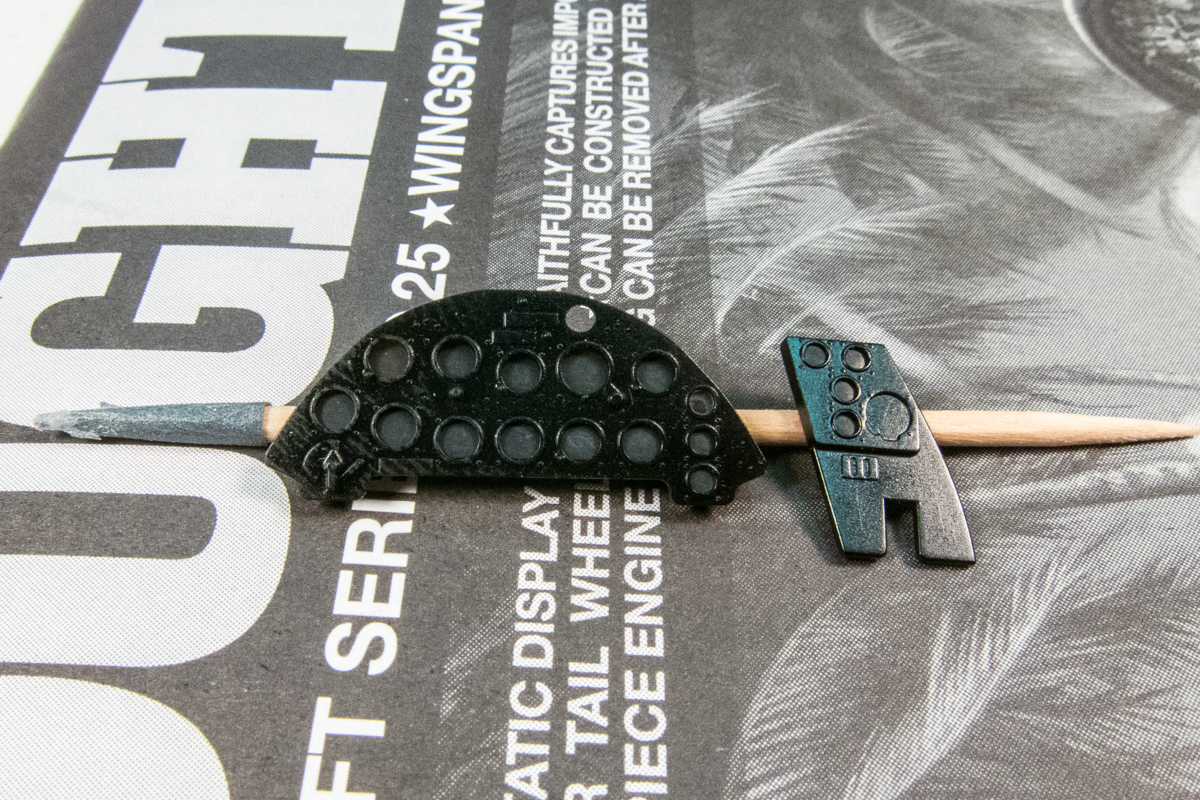

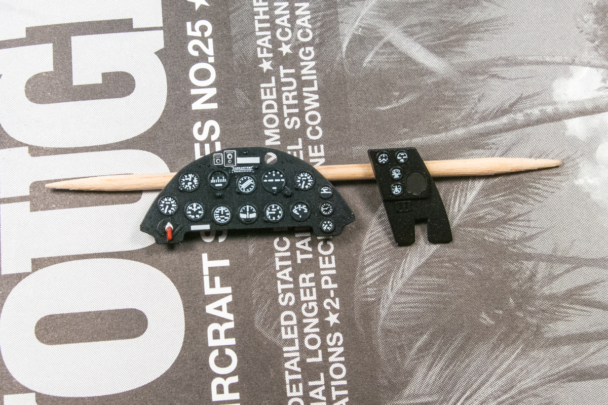

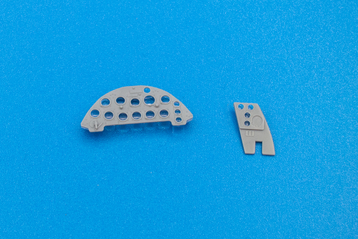

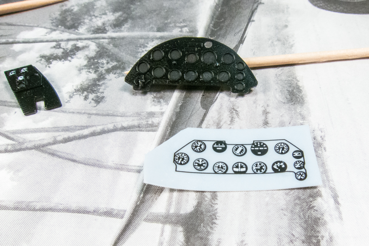

Thunnus Posted March 2, 2019 Author Posted March 2, 2019 Thanks guys! Another little thing that I wanted to take a look at was the instrument panel. Tamiya does something a little bit different here. They provide a clear backing piece to the solid plastic instrument panel face. The gauges are supplied as decals that you apply to the BACK of the clear parts. So the you have a clear lens in front of the gauges without having to mask. Neat eh? The clear plastic is domed for each gauge, giving a weird magnifying effect to whatever is behind it. Since there would be so much clear plastic between the decal and the front of the panel, I didn't think it would look good. So I decided to apply the decals to the FRONT of the clear parts and do the clear glass in a different way. I flattened the domed surfaces on the clear parts. Since I didn't need the clear parts to be clear anymore, I glued the backing to the instrument panel and painted it black. Starting with the smaller side panel, I punched out the instruments one by one and started applying them to the side panel. If you remember, the decal is printed reversed so I can't see any of the gauge details. I noticed that my punched gauges were not centered. Not wanting to mess up the main instrument panel, I wet the decal, removed it and put it back on the wet backing reversed so that I could see the gauge details. You can see that the white gauges are not perfectly centered within their black backgrounds. I'm going to let this dry and punch them out properly tomorrow. LSP_Kevin, ShotMagnet, Martinnfb and 4 others 7
dodgem37 Posted March 2, 2019 Posted March 2, 2019 Reverse engineering is tricky. I think I did that with the Tamiya P-51D IP I worked on, for some reason. Sincerely, Mark Thunnus and Martinnfb 2

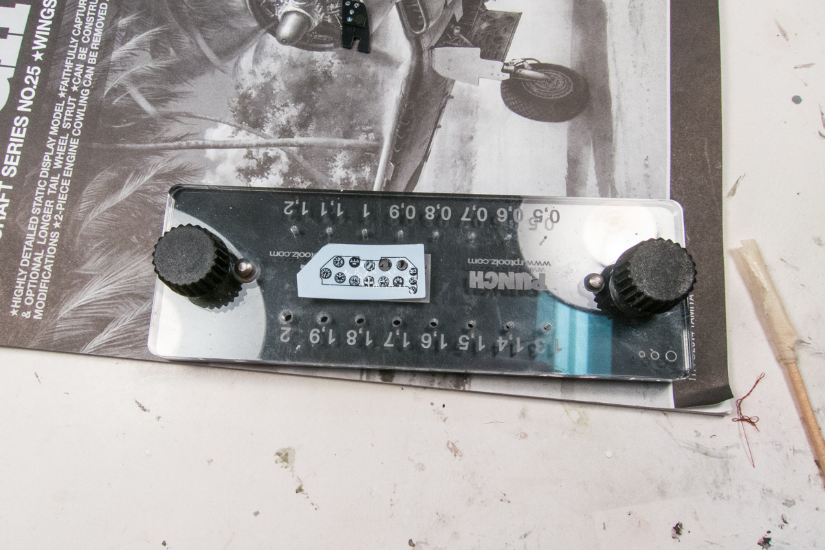

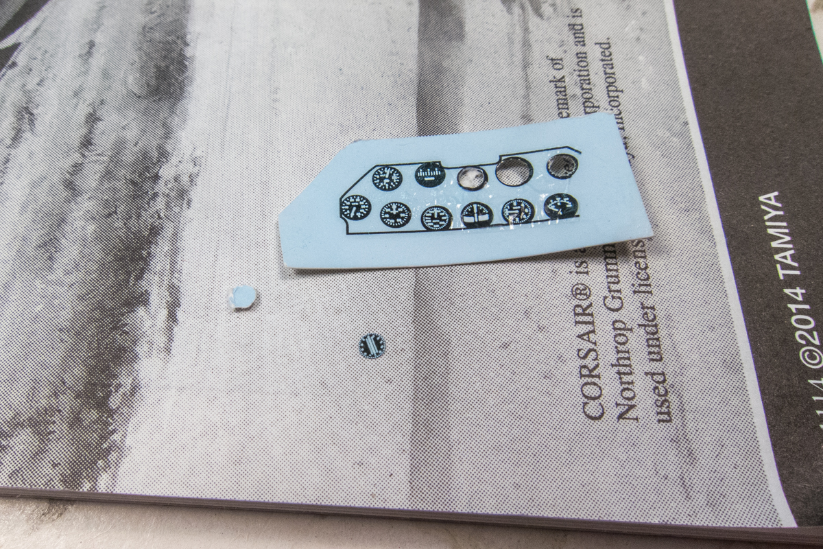

Thunnus Posted March 2, 2019 Author Posted March 2, 2019 I am going to continue with the instrument panel. Here is the punch set that I am using. I also have RP Toolz larger punch set if I need bigger circles. The outer plate of the punch set is clear, so you can use the view outside of the punch hole you are using as well trying to look down the barrel of the punch to center it. Once the target is fixed into place, I usually flip the punch set around and take a look from another perspective to ensure that my punch is centered. Since the decal adhesive is on the detail side of the decal, the decal paper and decal weren't connected that solidly. In fact, during this punch and others, the decal came off of its backing paper. Not a big deal as long as the free floating dry decal is treated carefully. No sneezing! Using a small drop of water in each dial, the punched instruments were placed into each dial and positioned before dabbing into permanent position using a cotton-tipped swab. Once positioned, Solvaset was used to seal the deal. One by one, the instrument panel is fully populated with instruments. The other markings are from the kit decal sheet and the Barracuda cockpit stencil sheet. I'm going to cover this with a semi-gloss coat and let it dry for the next step. ShotMagnet, Fanes, Fvdm and 14 others 17

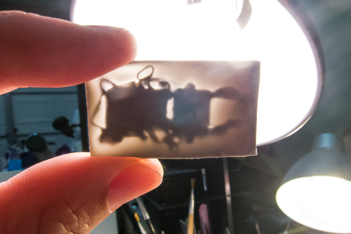

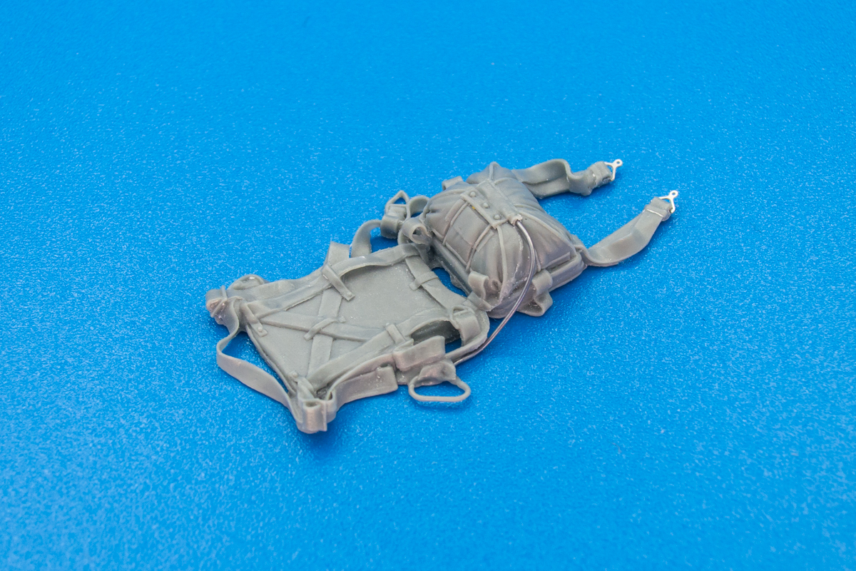

Thunnus Posted March 3, 2019 Author Posted March 3, 2019 Thanks guys! Since the punch set was already out, I decided to use it to make clear dial covers for each instrument. These little clear discs were secured into place using a drop of Alclad Aqua Gloss as an adhesive. One step up from simply using a drop of clear gloss to replicate the glass covers. It's hard to tell unless the glare reflects off the glass. I put the instrument panel parts in a little plastic baggy for safe keeping. I jumped over to the resin parachute to see how easy/difficult it would be to remove the casting block from the resin parachute. I was especially concerned about the delicate loops and buckles. Holding up the resin to the light, I can see that the resin is quite thin around alot of the parachute. These areas would be fairly easy to poke through with a single swipe of a sharp knife. But there are other parts that have some thicker resin underneath. Instead of trying to extract the piece in this state and risk a broken buckle, I sanded down the casting block until the excess resin was paper thin around the entire part. After that, tracing lightly around the parachute was enough to free it from the excess. But even with my precautions, I had some casualties. You can see that the release cord has broken. In the end, those delicate parts I had tried so hard to protect ended up breaking anyway. So I had to craft some replacements. The release cord is a piece of 0.15mm lead wire and the harness clips are from some Luftwaffe belts I had in the spare box. MikeMaben, LSP_Kevin, Durangokid and 18 others 21
