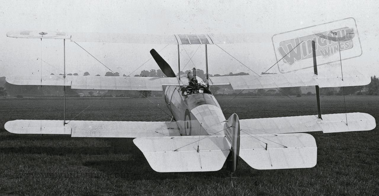

RLWP Posted April 8, 2018 Posted April 8, 2018 I think one aspect that gets missed is aeroplanes are often quite shiny. A semi-gloss finish is easier to maintain so that's how they were built. In your first image you can see the light reflected on the wing in the top right hand corner WW1 'planes could be very shiny indeed, like the Sopwith Triplane prototype: http://www.wingnutwings.com/ww/productdetail?productid=3039&cat=1 Richard MikeC, monthebiff, Jeff and 2 others 5
