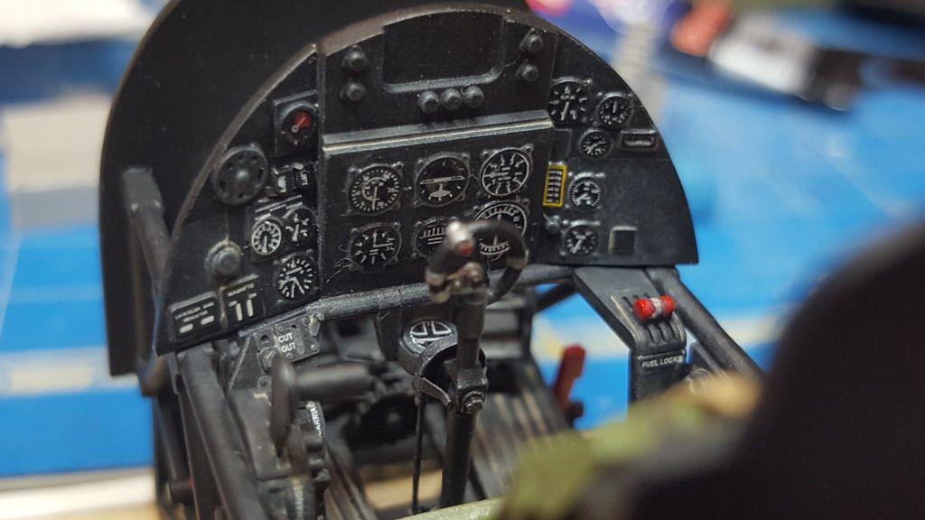

Zero77 Posted March 23, 2017 Share Posted March 23, 2017 Hello guys !!!! I'm working on this Special Hobby kit for a few weeks. The details are great, but the kit is definitely not easy to build. Yep, it's Special Hobby ! It will be a post-war Tempest, and i will use the Xtra-decals decals to make the J5*H : Here are my first pictures of the cockpit. It's a kit in the kit, and the rate of detail is very impressive OOB. The cockpit is all black, which is not very fun to paint, but i found a few tricks to ehance it and highlight the details. I painted it with black primer first, and then over sprayed some dark grey over it, from above. Then a heavy drybrush with a lighter grey, and finally a "dust deposit" wash, which looks pretty nice and realistic on this otherwise plain cockpit. The fuselage interior sides : Whitey, Kagemusha, mark31 and 7 others 10 Link to comment Share on other sites More sharing options...

Zero77 Posted March 25, 2017 Author Share Posted March 25, 2017 Thanks Shawn ! Here is were i am now (the Tempest is defenitely big ! i put a picture of it besides my BAe Hawk to show the size). But now i'm stuck with the gunsight. As i'm buidling a post war Tempest, i think i should use the gyro gunsight Mk.II, but it's been 3 weeks that i'm deperately looking for detail pictures of how it's mounted in the cockpit. Finally, i got another idea today, i looked in the Tempest Mk.II instruction manual, and indeed, everything is explained ! There is a part supplied in the kit. Ok. But that answer brought another question ! In the Tempest Mk.II instructions, the instrument panel used is different than the part i used in my cockpit. I dont know if this difference is because of the Mk.II version vs the Mk.V version, or if it is because of the different gunsight? If it's only due to the aircraft version, that's not a problem, i'd adapt my own instrument panel to use the supplied support part to fix the gyro gunsight. But if the difference is due to the gunsight, now i cannot change the IP anymore, so i'd have to use the former reflector gunsight. And i dont know if it would be accurate on a post war Tempest (i guess not). Any idea about that? Jan_G, MikeC, Joel_W and 3 others 6 Link to comment Share on other sites More sharing options...

Joel_W Posted March 26, 2017 Share Posted March 26, 2017 A most impressive build so far. I'm particularly impressed with how you went about improving the look of an all flat black cockpit. The end result is astonishing. Joel Zero77 1 Link to comment Share on other sites More sharing options...
Dpgsbody55 Posted March 26, 2017 Share Posted March 26, 2017 Very nice!!. I like your technique for the otherwise dull as ditchwater black cockpit. That really brings it to life. Cheers, Mike Zero77 1 Link to comment Share on other sites More sharing options...

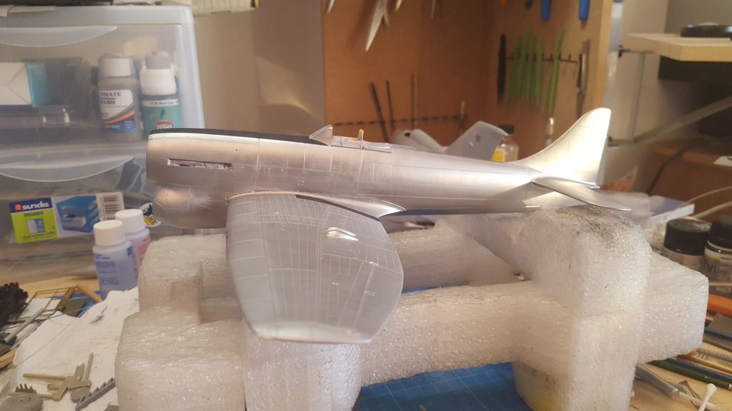

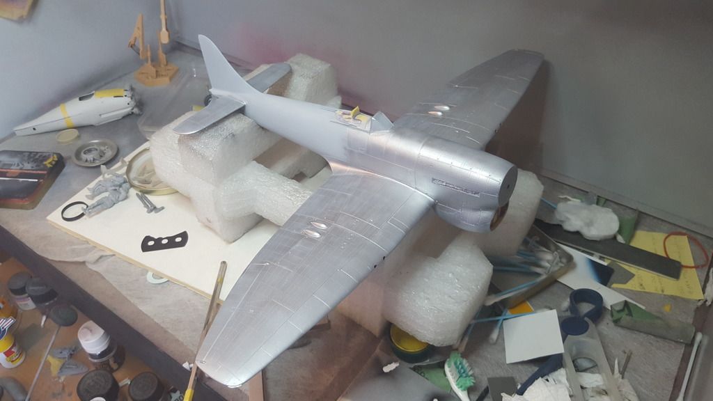

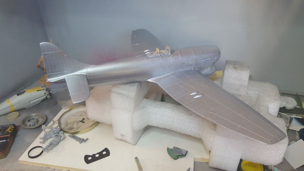

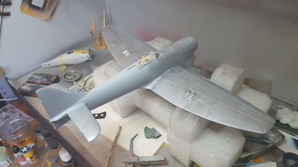

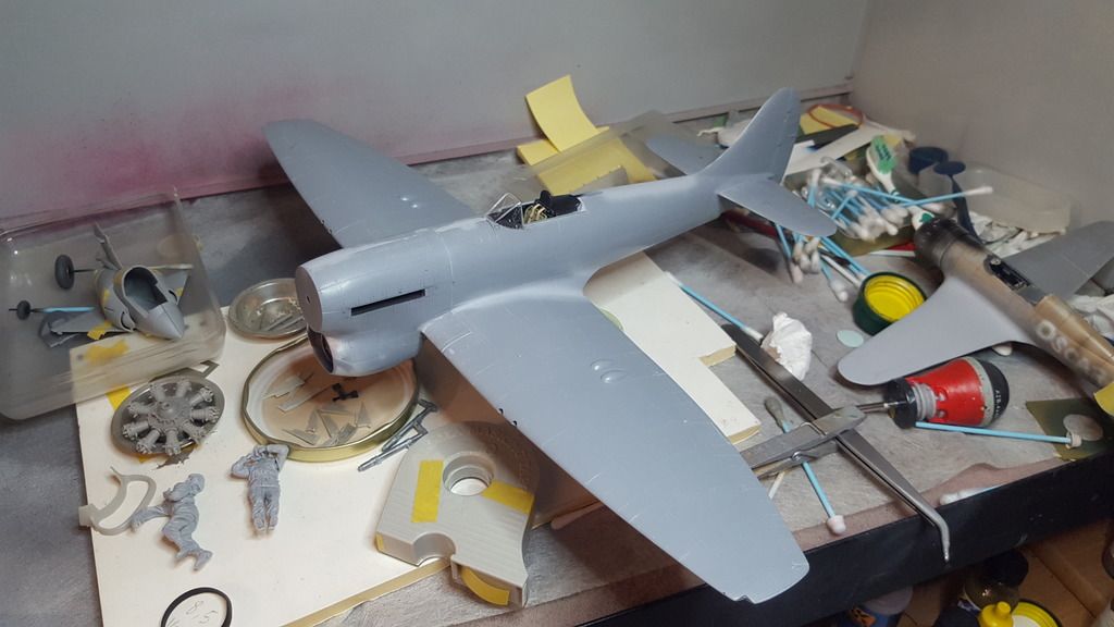

Zero77 Posted April 10, 2017 Author Share Posted April 10, 2017 As for my gunsight dilemma, i finally chose the reflector gunsight, and too bad if it's not accurate for a post war tempest. (Anyway i will build a Mk.II and a Mk.VI later, so i will have models with the gyro gunsight) After a very long masking of the inside areas this week, and a long preparation of the surface (sanding, filling, a lot of putty, sanding again, rescribing, rerivetting....) i was able today to spray a coat of primer. As the finish will be the british High Speed Silver but i did not want it to be too much plain, i tried to make some variations in the primer. I painted the panels one by one, from various direction, and also marbled the surface. Sorry but it's absolutely not visible on the pictures ! Then i applied some alclad High Speed Silver. At first i thought i was a bit too shiny, but finally it's not too bad. The marbled and uneven undercoat looks pretty good and acts as a kind of pre-weathering. In some areas it even looks like a kind of stressed skin in trompe l'oeil. I'm quite satisfied with it and will use the technique for further british silver aircraft. The aircraft is very big and the Alclad HSS doesnt cover very well, so i used almost 2/3 of the bottle. (and i still have to paint the landing gear doors). MikeC, tucohoward, Rick K and 3 others 6 Link to comment Share on other sites More sharing options...

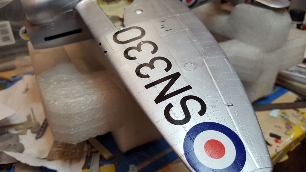

Zero77 Posted April 10, 2017 Author Share Posted April 10, 2017 Then i painted the anti-slip strips on the wing roots and the anti-glare panel. I really love the Tempest in the Silver livery. And this evening i applied the decals. It was quite fast they are not a lot. The Xtra-decals (printed by Microscale) are very good. With 2 or 3 coats of microsol, the film is not anymore visible. Now i can start the weathering, which i need to make pretty subtle. Rick K, Jeff, Jan_G and 5 others 8 Link to comment Share on other sites More sharing options...
Joel_W Posted April 10, 2017 Share Posted April 10, 2017 The Tempest in the NMF in Alcad Silver definitely has a brighter finish then their Aluminum I always end up using. I would expect a post war aircraft to be much better maintained then during the war, so a shinier NMF would be in order. You decaling sure looks like they were painted on with masks. Very nicely done. Looking forward to your next update. Joel Zero77 1 Link to comment Share on other sites More sharing options...
Cees Broere Posted April 10, 2017 Share Posted April 10, 2017 Very nice finish. How did you eliminate the step between the fuselage and the nosesection (topside)? Zero77 1 Link to comment Share on other sites More sharing options...
Miloslav1956 Posted April 10, 2017 Share Posted April 10, 2017 Very nice finish. How did you eliminate the step between the fuselage and the nosesection (topside)? This step is correct, a transition plate is mounted on the wing surface. Therefore, there is this step. Zero77 1 Link to comment Share on other sites More sharing options...
Miloslav1956 Posted April 10, 2017 Share Posted April 10, 2017 Zero77 1 Link to comment Share on other sites More sharing options...
Breaker Posted April 10, 2017 Share Posted April 10, 2017 Zero, try a black primer next time your going for a HSS finish. You'll find it's easier to get decent coverage with the Alclad. Zero77 1 Link to comment Share on other sites More sharing options...
