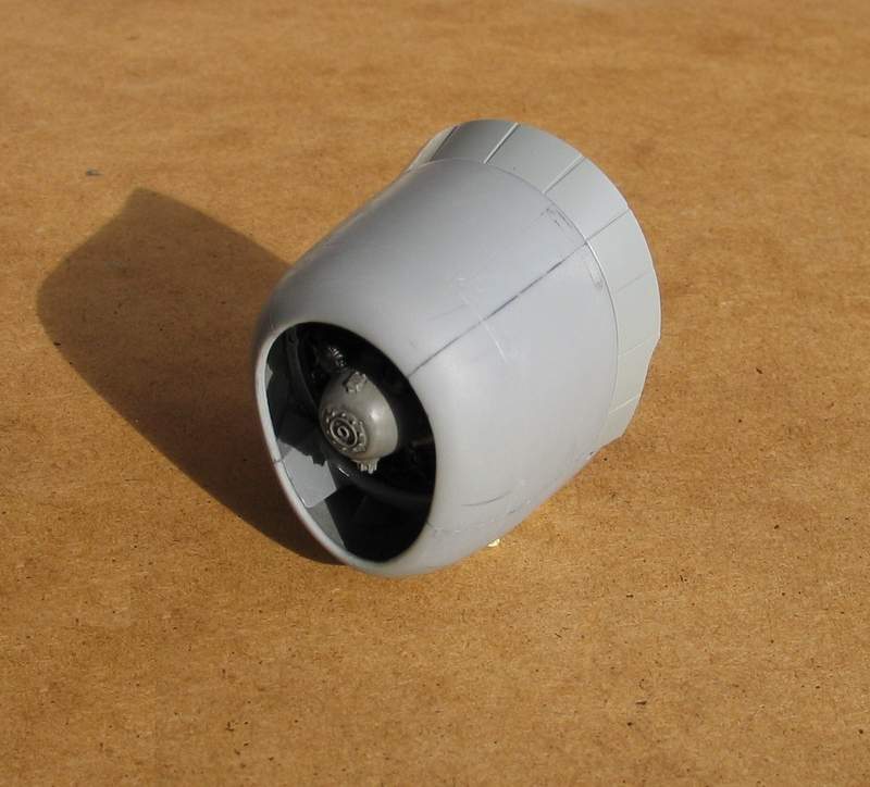

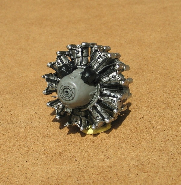

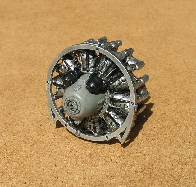

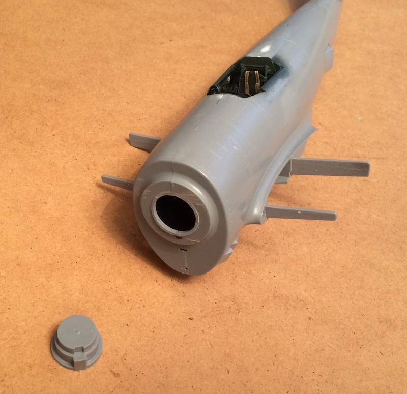

Tolga ULGUR Posted November 12, 2016 Author Posted November 12, 2016 Ready for installation into the cowling Shaka HI, 109, MikeMaben and 3 others 6

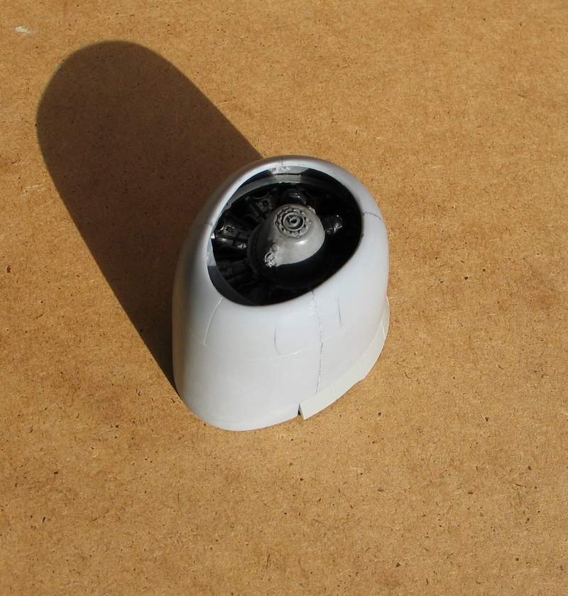

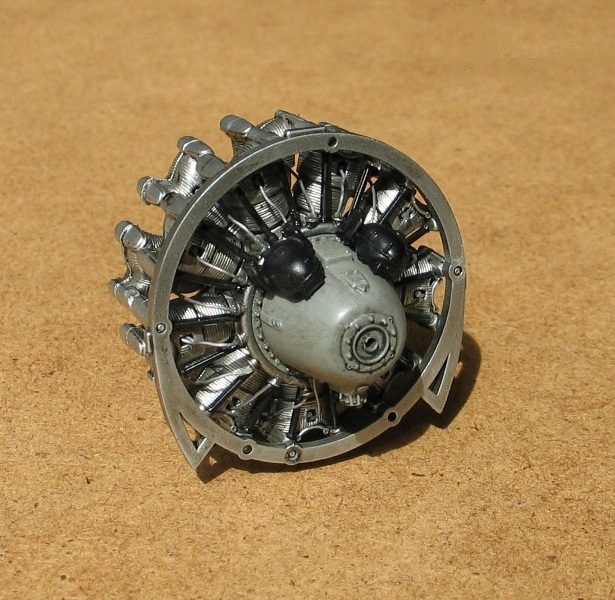

Tolga ULGUR Posted January 3, 2017 Author Posted January 3, 2017 After a short! break: Engine installed into the cowling parts. mpk and Whitey 2
alaninaustria Posted January 3, 2017 Posted January 3, 2017 (edited) Great job so far!! Don't forget to fill in the seam on the four engine cowling latches that are right up at the front end of the cowling leading edge! Cheers Alan Edited January 3, 2017 by alaninaustria mpk 1

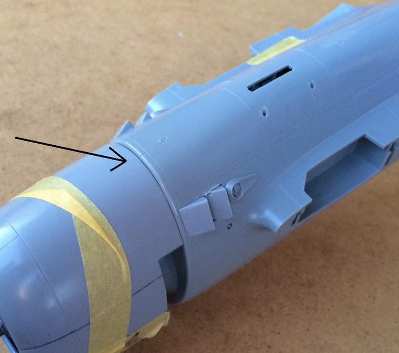

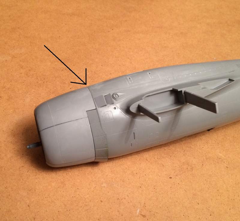

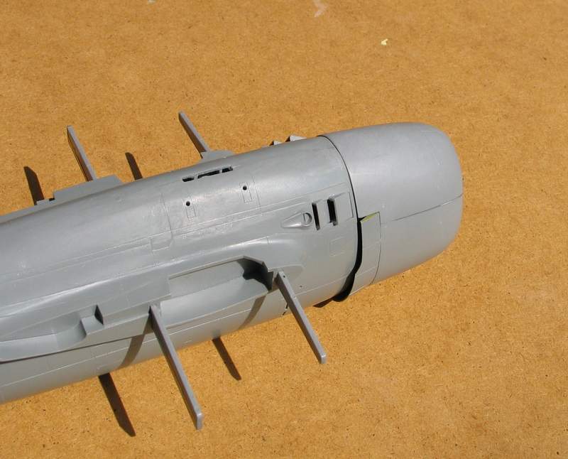

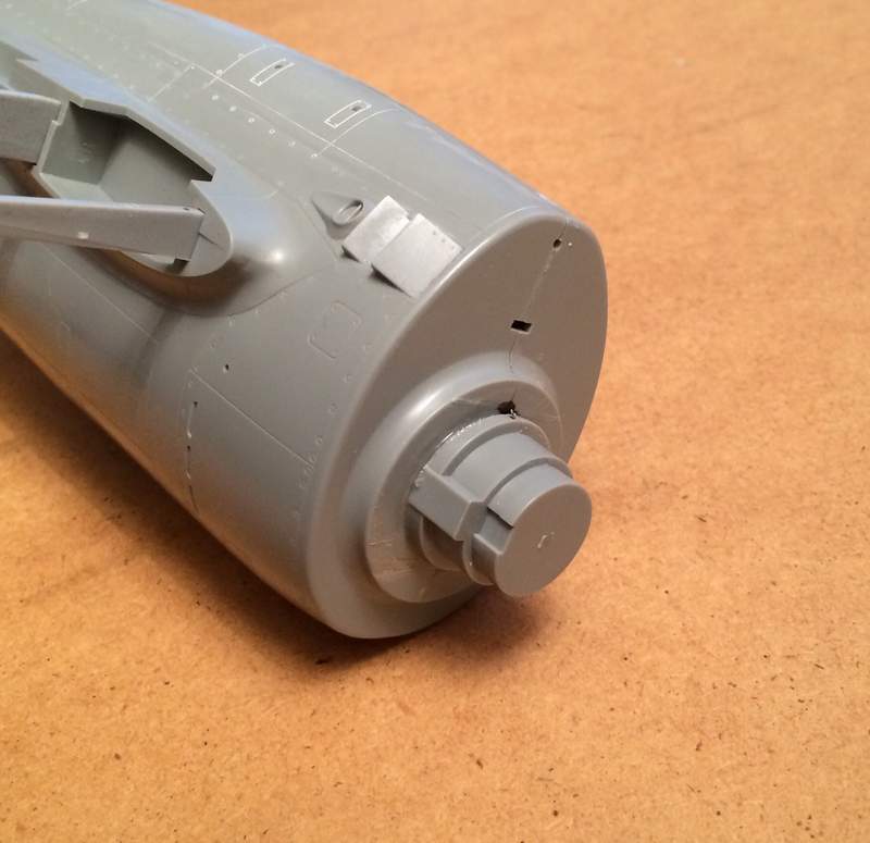

Tolga ULGUR Posted January 3, 2017 Author Posted January 3, 2017 There is a level difference between the fuselage and cowling at the bottom. As you can see alignment is not good. So it needs some surgery to solve this problem. Cutting the front section protrusion of the fuselage and re-install it 1 or 2 mm down is enough. MikeMaben, Joel_W, Shaka HI and 3 others 6
Tolga ULGUR Posted January 3, 2017 Author Posted January 3, 2017 Great job so far!! Don't forget to fill in the seam on the four engine cowling latches that are right up at the front end of the cowling leading edge! Cheers Alan Thanks Alan, Sorry but I did not understand exactly where you are talking about. Regards mpk 1

AdamR Posted January 3, 2017 Posted January 3, 2017 There is a level difference between the fuselage and cowling at the bottom. As you can see alignment is not good. So it needs some surgery to solve this problem. Cutting the front section protrusion of the fuselage and re-install it 1 or 2 mm down is enough.Yes, it's an easy fix that everyone who builds this kit should know about. Since they are apparently never going to correct the tooling, Hasegawa really should put something in the instructions about it — not everyone reads LSP! Nice work so far. Makes me want to build another! LSP_K2 and mpk 2

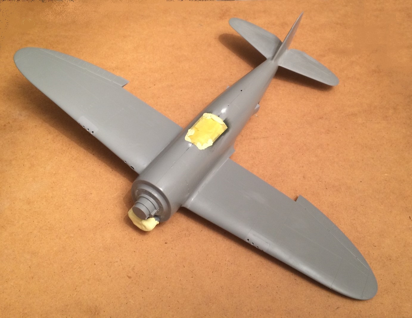

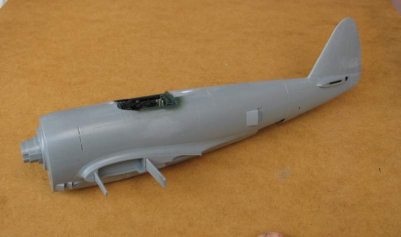

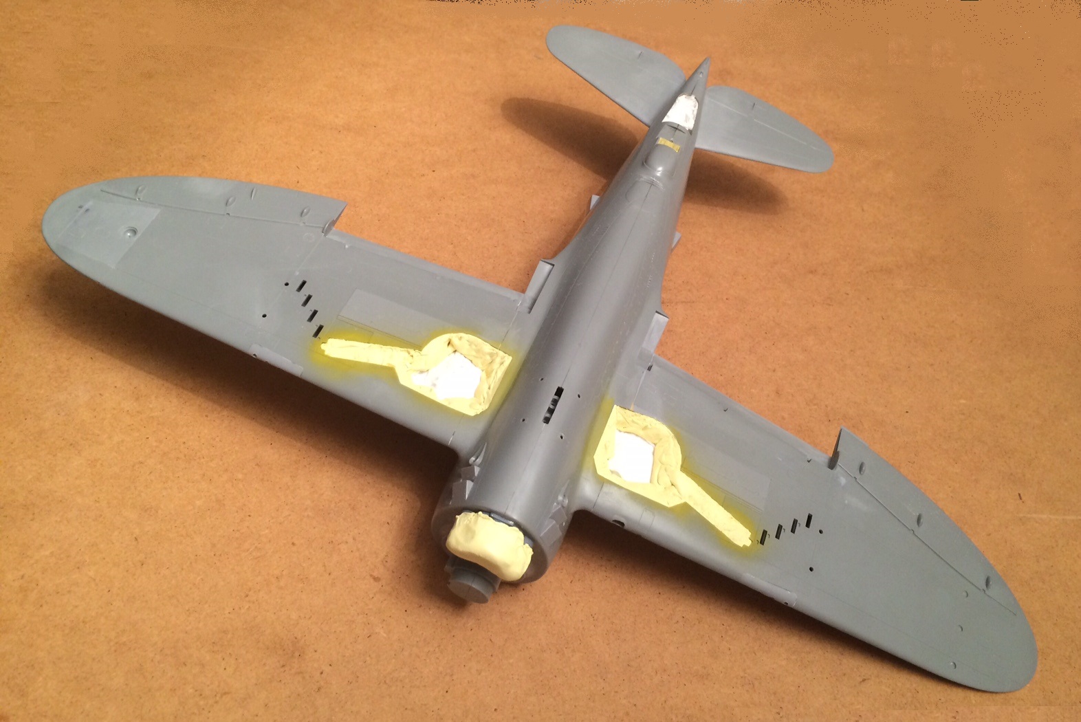

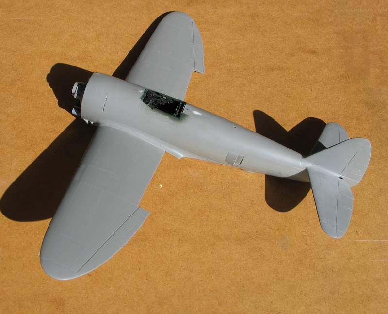

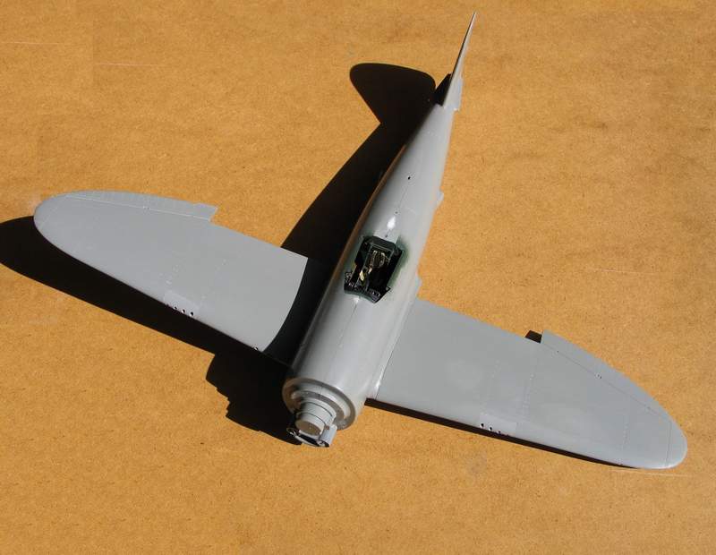

Tolga ULGUR Posted January 4, 2017 Author Posted January 4, 2017 Wings and horizontal tails installed Ready for painting Whitey, LSP_K2, Shaka HI and 1 other 4
alaninaustria Posted January 4, 2017 Posted January 4, 2017 Thanks Alan, Sorry but I did not understand exactly where you are talking about. Regards Have a look at the front of the yellow cowling - you will see the four latches at the front of the cowling: http://www.largescaleplanes.com/articles/article.php?aid=591 Cheers Alan mpk, LSP_K2 and Shaka HI 3
AdamR Posted January 6, 2017 Posted January 6, 2017 Wings and horizontal tails installed Ready for painting That kit goes together so nicely. Looking good, Tolga. mpk 1

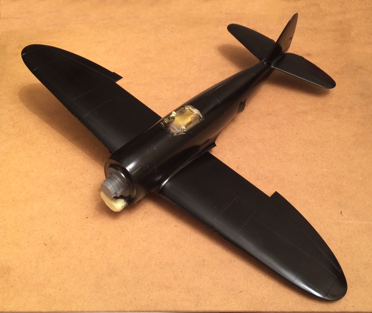

Tolga ULGUR Posted January 8, 2017 Author Posted January 8, 2017 After masking needed areas, black base coat from Tamiya applied for Alclad. ShotMagnet, Whitey and mpk 3
alaninaustria Posted January 8, 2017 Posted January 8, 2017 Looking really nice so far!! Can't wait to see more! Cheers Alan mpk 1
Bomber_County Posted January 8, 2017 Posted January 8, 2017 (edited) That's looking really really clean, never built any Hasegawa 32nd so watching with interest......... Your engine is sublime, you can almost feel the metal.. Edited January 8, 2017 by Bomber_County mpk 1
