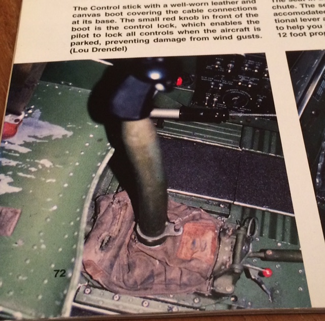

waroff Posted September 25, 2016 Posted September 25, 2016 to be exact, the canvas at the stick control base was olive drab mpk 1
Tolga ULGUR Posted September 26, 2016 Author Posted September 26, 2016 to be exact, the canvas at the stick control base was olive drab I do not think that this is general rule Here are two differents examples from Lou Drendel s P-47 Walk Around and Bert Kinzey s P-47 Detail & scale. mpk 1

waroff Posted September 27, 2016 Posted September 27, 2016 this part was common on all P47, from B model to D30 & up.Perhaps on your pic this part was not original and/or the OD color faded after 50 years?In any case, the brown color give a few color in the monotony of the cockpit. mpk 1
MikeMaben Posted September 27, 2016 Posted September 27, 2016 Hi Waroff, the asterisk preceeding the color fabric callout indicates a notation seen at the left of the drawing. It's not particularly clear when blown up but it looks to me like the color fabric is an option to the leather, and not compulsory. mpk 1

Juggernut Posted October 1, 2016 Posted October 1, 2016 (edited) Hi Waroff, the asterisk preceeding the color fabric callout indicates a notation seen at the left of the drawing. It's not particularly clear when blown up but it looks to me like the color fabric is an option to the leather, and not compulsory. Also too add to what mmaben said: Waroff, define the exact shade of Olive Drab as applied to the cloth boot...and then define what waterproofing did to that shade of OD. The fabric part (Item 1 in the blueprint) is the major part of the boot. The reinforcing part (Item 2 in the blueprint) was to be leather; clearly shown in the photos Tulgar posted. I'd say his shade of OD is equally as good as anything else that leans toward OD. The dull dark green in the cockpit looks great! H302 eh? I'll have to do some looking and get some of that color. Uh oh Tulgar... Those distributor's on the 2800 should be the GE ignition system, not the Bendix dual magneto with the distributors (your prop governor is correctly positioned). Not many will know the difference but in case you are interested, see below: Instructions from the Hasegawa P-47M kit: And instructions from the P-47D kit: Edited October 1, 2016 by Juggernut mpk and Tolga ULGUR 2
waroff Posted October 1, 2016 Posted October 1, 2016 Hi Waroff, the asterisk preceeding the color fabric callout indicates a notation seen at the left of the drawing. It's not particularly clear when blown up but it looks to me like the color fabric is an option to the leather, and not compulsory. " * compliance with paragraph D-10 of spe AAF...on resistance to mildew is not compulsory; balance of the specification still applies." mpk 1

MikeMaben Posted October 1, 2016 Posted October 1, 2016 " * compliance with paragraph D-10 of spe AAF...on resistance to mildew is not compulsory; balance of the specification still applies." Ah, I see. Now all we need is the applicable spec. I'm not trying to argue, but drawings can be revised for any number of reasons so relying on them as absolute proof is not necessarily a good idea. mpk 1
