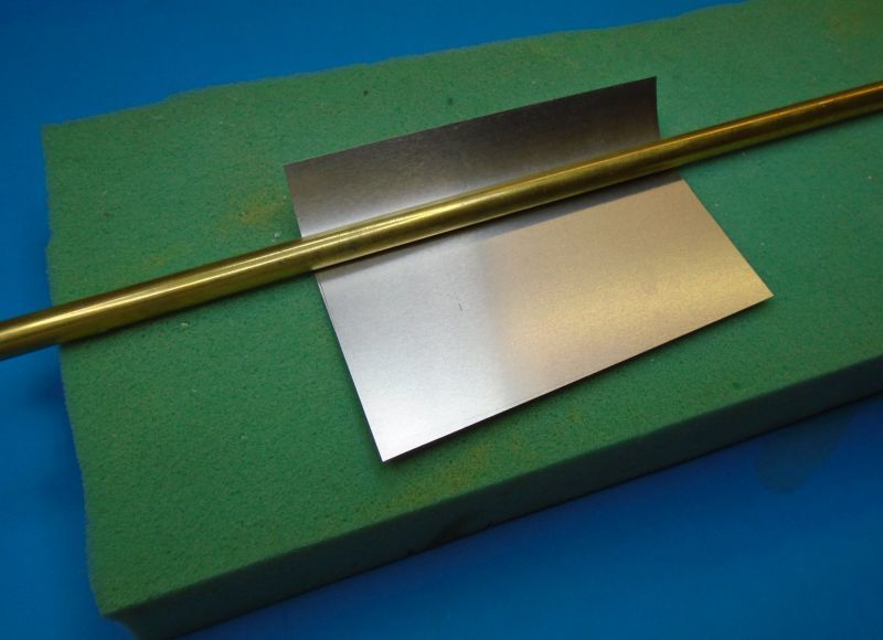

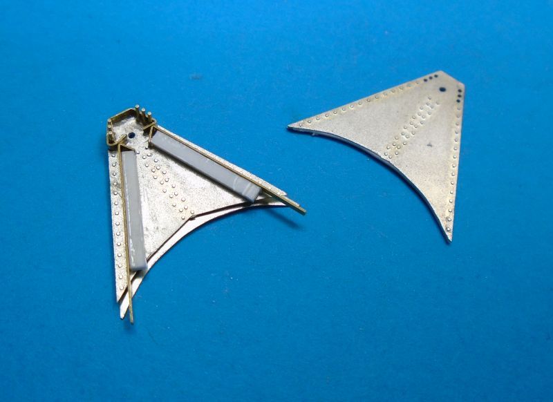

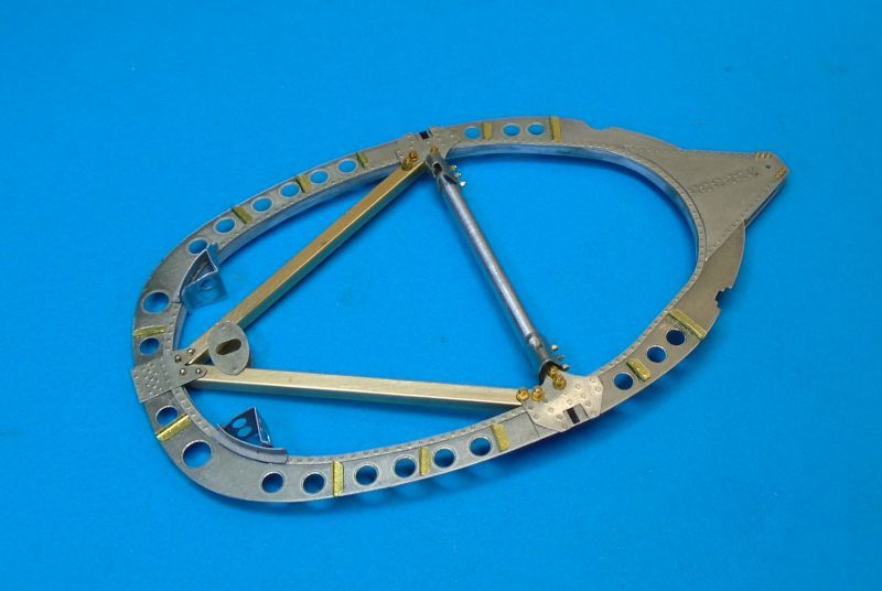

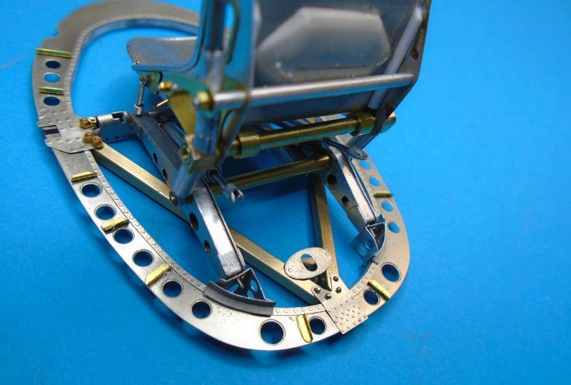

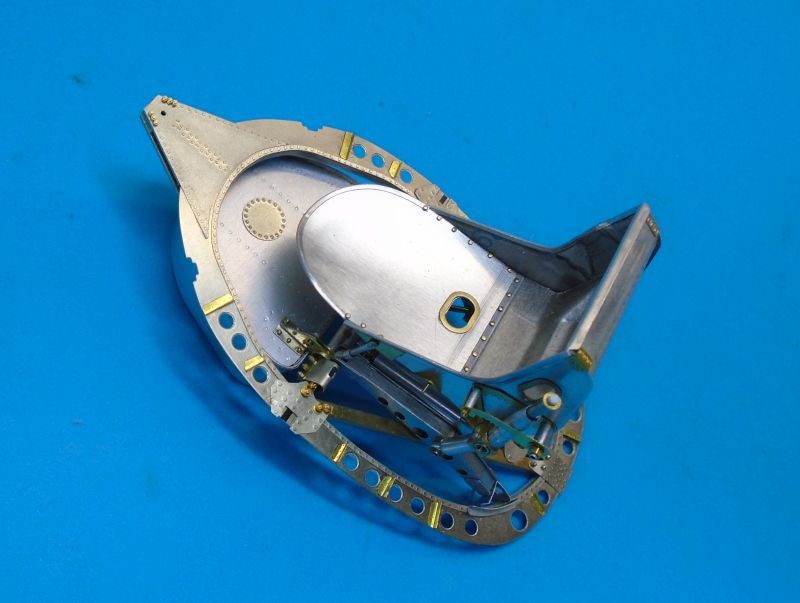

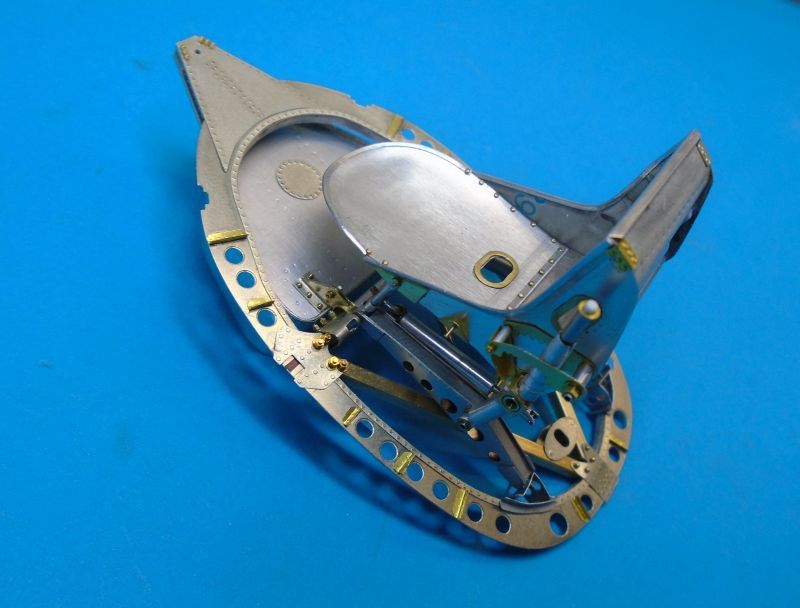

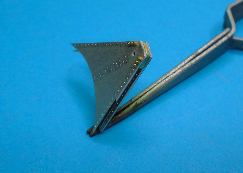

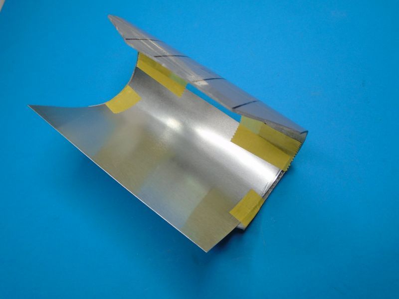

airscale Posted April 5, 2016 Author Posted April 5, 2016 evening folks thanks for stopping by and checking in - there are some incredible builds going on at the moment so motivation is high so what's been going on in Spitfireland for the last few days... I pretty much finished up Frame 11 - this is the main bulkhead the seat mounts to.. I started with the seat mounts themselves at the bottom of the bulkhead, these are just folded & punched plates with holes in that the seat assembly sit in just like the real one... on the upper crossmember the triagular widgetty things are the upper seat mounts and a sprung pin locates the whole thing each side.. and with the seat in place.. ..next the rollover/headrest - these were laminated from PE parts and some card to make two of them. Then between them there are some parts to space them apart - it took me a while to figure out the best way to do it as I wanted the bolts to go through both... the one on the left has been cut about a bit at the bottom so it slides over the frame 11 bulkhead for a seamless fit.. ..and fixed in place on the bulkhead.. ..a dry fit of all the frame 11 parts.. ..next, I need a cockpit to put it in, so cut some sheet to fit the cockpit 'pod' I hacked out of the airframe and rolled it to give it some shape.. ..I will basically build on this and fit it when complete - then slide the pod into place (in theory..) ..I built a card jig to hold it in shape and protect the fragile sheet and marked out key structural elements - this is the canvas for a few weeks work... hope you are having fun TTFN Peter KUROK, Wurzacher, Starfighter and 9 others 12
