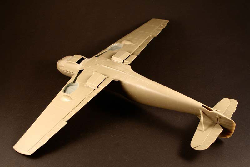

This was started yesterday afternoon - and uses some parts from the old Eduard etch set for the old Hasegawa kit - but shows some good progess for only a few hours work.

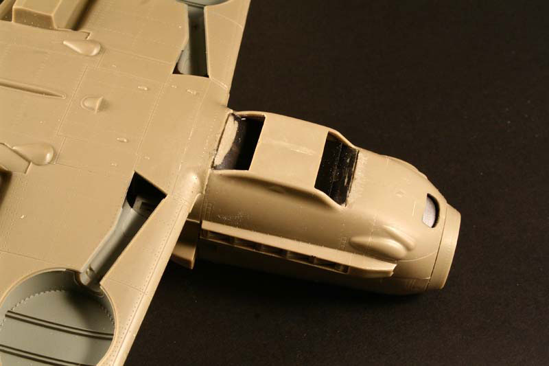

One of the areas that was a common bugbear reported by previous builders was the under-nose radiator area. A look at the parts appeared to confirm that the radiator assembly could be added after the fuselage was joined and the area cleaned up.
So far she's going together really well - will try and get the exhausts and cowls done later today so she can go sit in the airing cupboard whilst I take some review photos for the site, and work on my Spits and Lightning parts.

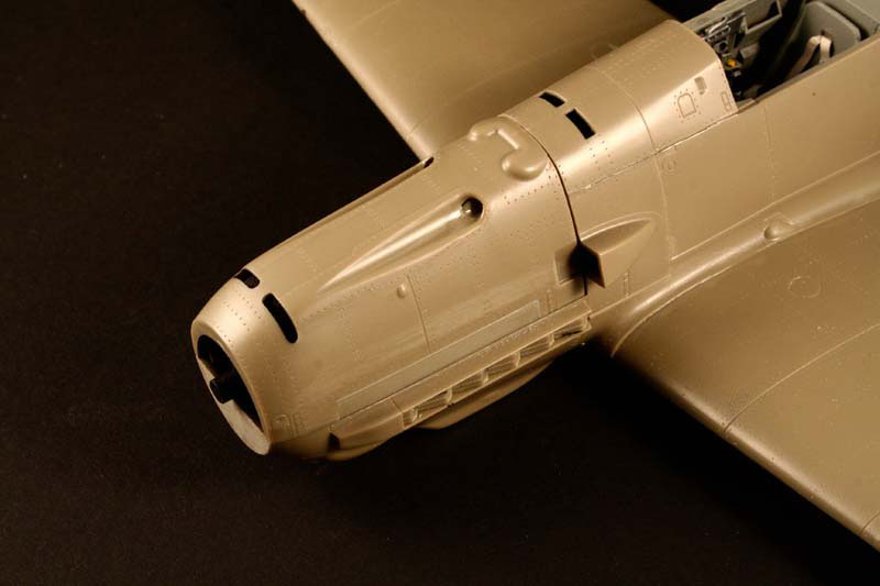

Have spent another couple of hours on her this evening.

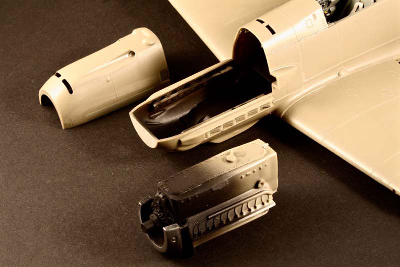

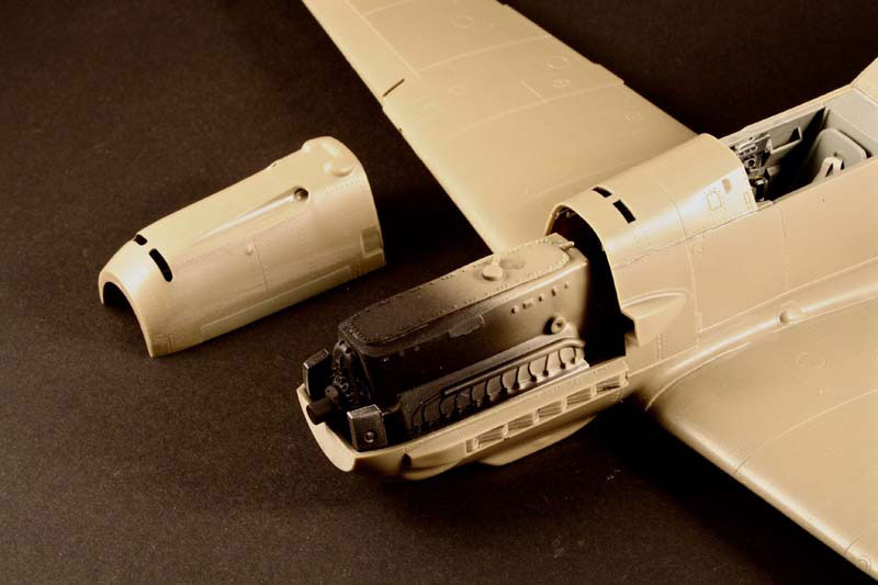

Yes - the cowls won't fit over the engine and cowling guns. Eduard, quite rightly IMHO, have moulded the engine and armament full size so, with the thickness of plastic for the cowl covers they are never going to fit over the engine and guns as kitted.
Now, I was going to go with the engineless/gunless configuration shown in the instructions and started by assembling and fitting the exhaust stacks. When I came to remove the cowl parts from the sprues it dawned on me that, of course, the 109E has a number of open slots in various areas of the cowling and that, if you leave out all the gubbins, it will look a little empty behind these slots - and you'll probably get a bizarre see through effect from certain angles.
Guns - these can be installed so that the top cover panel be fitted it a little trimming to both the guns themselves as well as the ammo chutes.

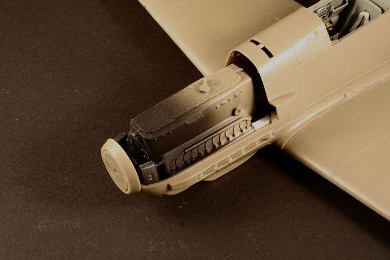

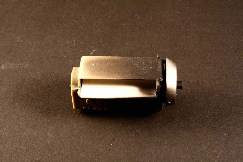

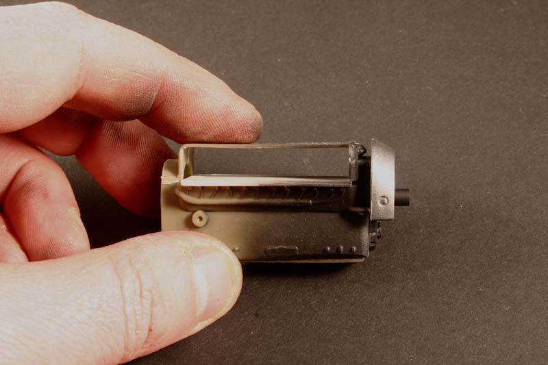

Engine. How to fit after I've already fitted the exhausts? Simple - cut sections out of the engine with a horizontal razor saw along a line just above the exhaust and back to the engine block. Then a vertical cut up from the base to meet. Once these sections were removed a 'raft' was made from two thicknesses of 20 thou plastic sheet that, when passed through the hole in the engine block, would act as a solid mount that could be glued to the upper side of the already fitted exhaust mounts.
Engine fitted - and you can see the only physical thing I've done to help align the main cowling - two sections of 60 thou sheet used as locating/widening shims. These are the two white sections bonded to the upper rear of the exhaust mounting bracket.
The other area to be altered was the top of the block where material has been removed from the front (it now slopes).
The position of the engine was adjusted with the spinner backplate dry fitted to ensure everything centred and as it should be.

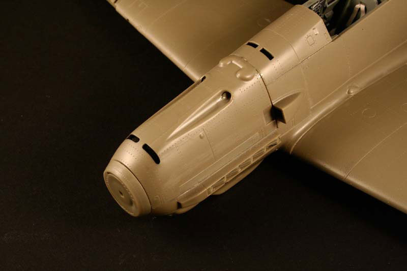

Main cowl placed in situ - no glue. Appalling fit as you can see!  ;)

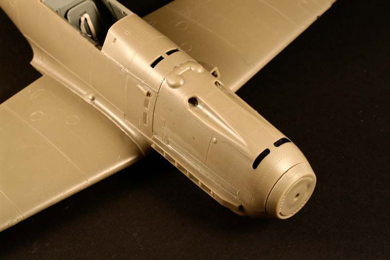

And bonded in place.
I'm really impressed with this kit! Perhaps a little over engineered, but then Eduard were trying to pull out all the stops for the detailers out there. The quality of moulding, and fit of parts in the main, has been superb. Only real area that's needed filling has been the underside rear wing to fuselage interface. Fit of the cowling panels - with careful prep and dry fitting - has been exceptional for an area where so many separate panels are coming together.

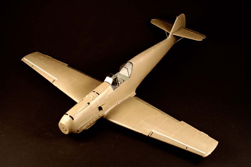

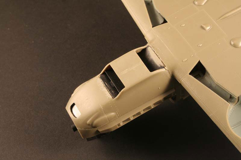

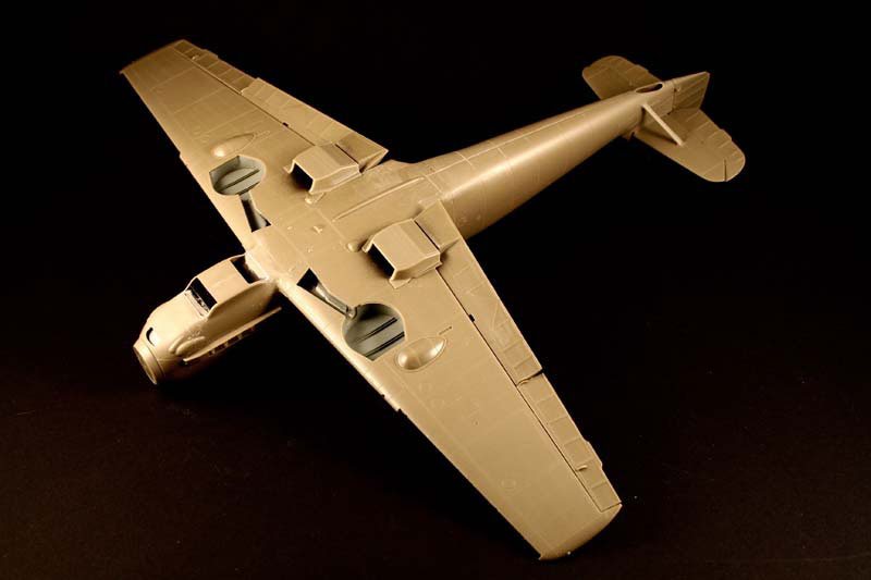

Another couple of hours work - and we're almost ready to mask and prime!
Canopy glazings loosely placed for photos - still need to fit main panel and gunsight before I bond the clear parts in place - maybe before bed.
A little epoxy filler used - not much - and sheet plastic (roughly 1mm thick) used to make the leading edge slat slot opening thinner. Slats will be
trimmed accordingly prior to fitting.
Rudder is just placed in position and will be painted separately.
