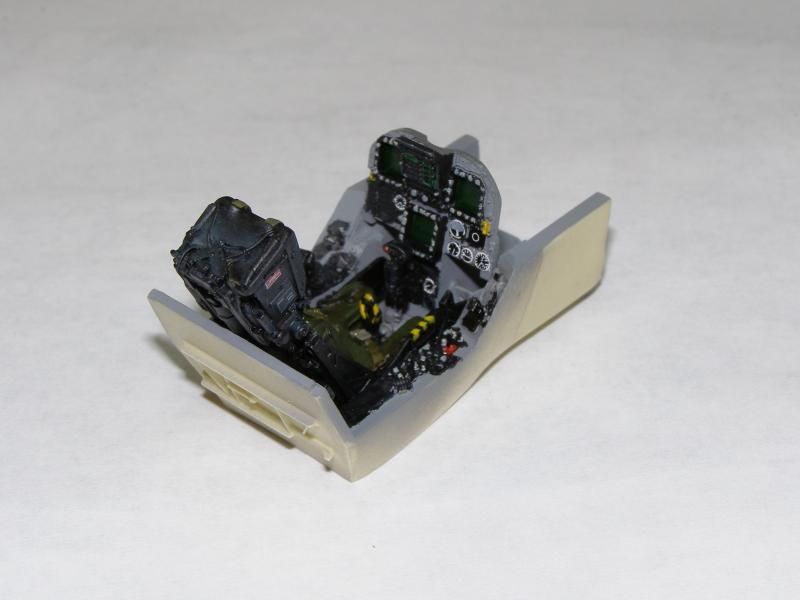

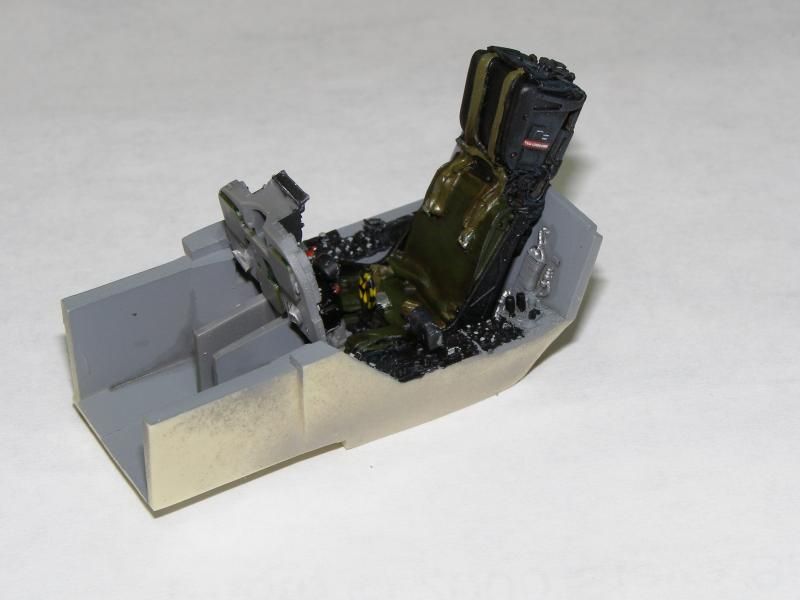

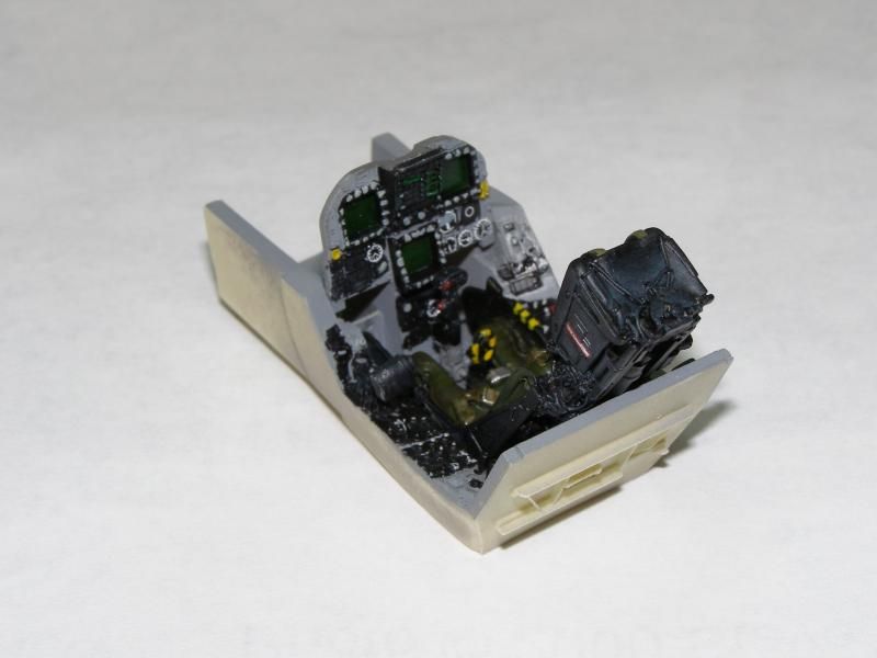

LSP_Ron Posted April 13, 2014 Author Posted April 13, 2014 I managed to get a little building in this week. Painting this pit has taught me two things, my eyesight isn't what it used to be and my hand isn't as steady as it was in my 30's. Certainly not up to the standards I've seen posted here lately but still fun. Still some more painting and shading to do on the belts and a little chipping it the tube. Thanks for looking Uilleann 1

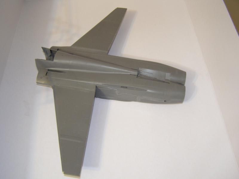

ColinR Posted April 14, 2014 Posted April 14, 2014 Nice work so far on the model .. Can I pass on some words of advice having built a few of these beasts Ignore the build order, and install the intake trunking and from ent of the intakes to the lower fuselage BEFORE you install the top of it , it'll give you more of a chance to get their alignment right , it'll save a lot of filling and sanding!
LSP_Ron Posted April 14, 2014 Author Posted April 14, 2014 Nice work so far on the model .. Can I pass on some words of advice having built a few of these beasts Ignore the build order, and install the intake trunking and from ent of the intakes to the lower fuselage BEFORE you install the top of it , it'll give you more of a chance to get their alignment right , it'll save a lot of filling and sanding! Thanks but unfortunately to late, I have the rear fuse/wing assembly completed last night as per the instructions build order. So far the fit has been exceptional but I have not installed the intakes yet.

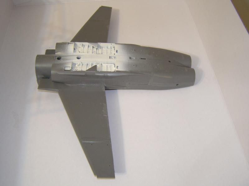

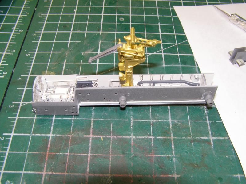

LSP_Ron Posted April 14, 2014 Author Posted April 14, 2014 Thanks As you can see, I have the rear fuse main assembly already built. So far the fit has been spectacular. I am now working on the forward fuse. One thing I don't like it the fact you have to mount the nose gear into the fuse as one of the first steps of the build. That's going to be a huge pain in assembling and painting the fuse.

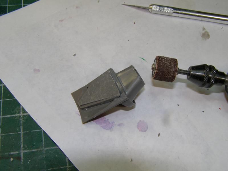

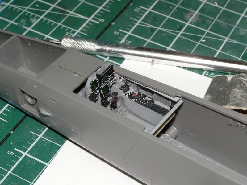

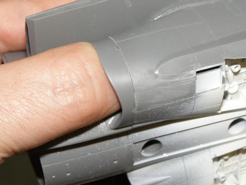

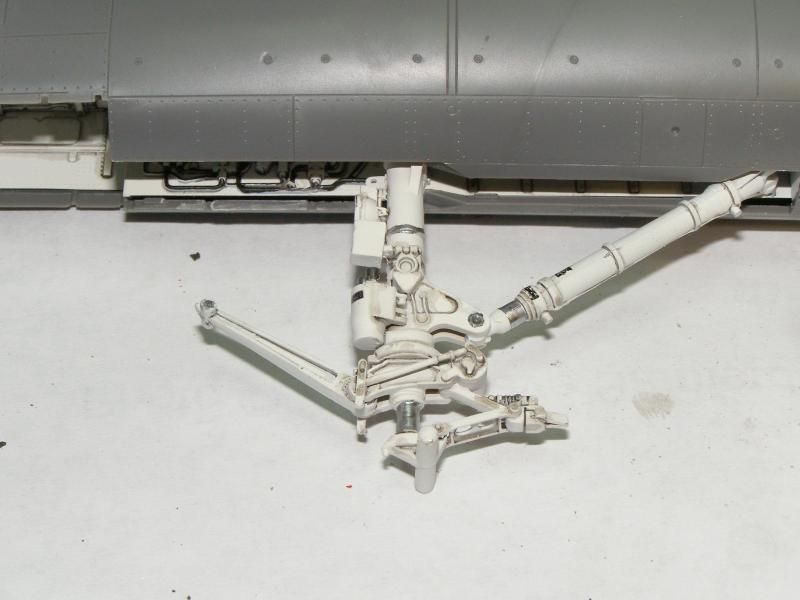

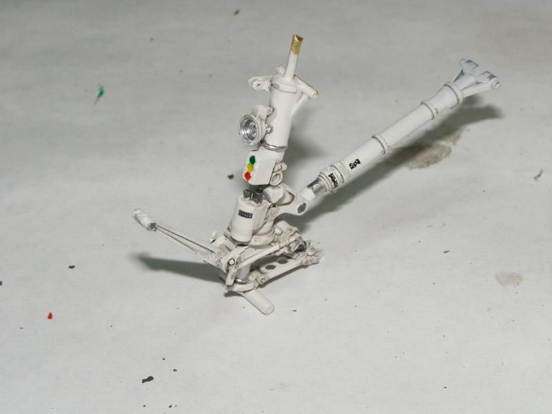

LSP_Ron Posted April 16, 2014 Author Posted April 16, 2014 Thanks James Well the intakes fit like crap but it's because they are to thick. A lot of sanding on the backside with the dremel has them fitting pretty good now Started painting and decaling the nose gear And fitting the pit which needs a dry brush still after a wash that went to far. Whitey and Uilleann 2
Whitey Posted April 17, 2014 Posted April 17, 2014 (edited) A little tweak of the lugs for the nose gear allows you to leave it off until after the rest of the model is painted. I'm not a fan of those SAC legs, they look to bendy. The main gear legs are strong enough - if you bond the metal rods inside them properly. Don't just insert the metal rod. I used epoxy to make sure that there is a solid grip to the inside of the legs. No air in there at all. They are effectively solid. My Hornet has been on the shelf for a while, been to a couple of shows and still sits properly on its legs. Looking forward to seeing this one completed. It looks like a great scheme. Edited April 17, 2014 by Whitey
LSP_Ron Posted April 17, 2014 Author Posted April 17, 2014 I'm not a fan of those SAC legs, they look to bendy. The main gear legs are strong enough - if you bond the metal rods inside them properly. Don't just insert the metal rod. I used epoxy to make sure that there is a solid grip to the inside of the legs. No air in there at all. They are effectively solid. My Hornet has been on the shelf for a while, been to a couple of shows and still sits properly on its legs. Looking forward to seeing this one completed. It looks like a great scheme. Thanks, Actually they are G-Factor not SAC and they are very, very nice. Not bendy at all like the SAC stuff. The only way to get them off their casing sprue is a cut off wheel in a dremel. Side cutters won't even put a dent in them. Very strong stuff and very fine detail Cheers Ron stusbke and Whitey 2
