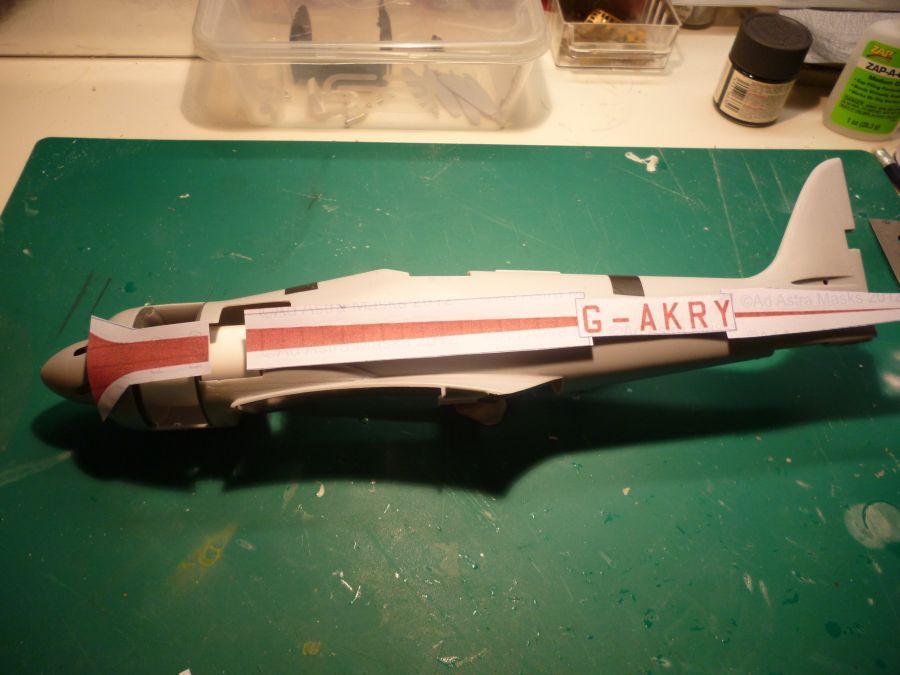

airscale Posted July 17, 2012 Author Posted July 17, 2012 Many thanks Cees & Grant Woohoo the draft masks came on email from Ian at Ad Astra masks so a little check was in order to make sure all is well. I don't know how they do it but they are perfect - all I supplied was a photo of the aircraft and the scale I wanted and Ian did the rest. Quite how he does this without one of every kit to measure up against I will never know but the results are spot on. Nice to see what the bird is going to look like... Peter Landrotten Highlander 1
Out2gtcha Posted July 17, 2012 Posted July 17, 2012 Many thanks Cees & Grant Woohoo the draft masks came on email from Ian at Ad Astra masks so a little check was in order to make sure all is well. I don't know how they do it but they are perfect - all I supplied was a photo of the aircraft and the scale I wanted and Ian did the rest. Quite how he does this without one of every kit to measure up against I will never know but the results are spot on. Nice to see what the bird is going to look like... Peter NICE! I really like it. Ian is fantastic and the material he uses for his masks, as well as supplying a "cover sheet" mask for lifting, is fantastic and very forgiving. Looking forward to more progress here.
A.Wolf Grant Posted July 17, 2012 Posted July 17, 2012 I REALLY need to try one his masks soon - I've not seen one negative comment whatsoever which, to me, shows extraordinary production quality and attention to detail. Grant.

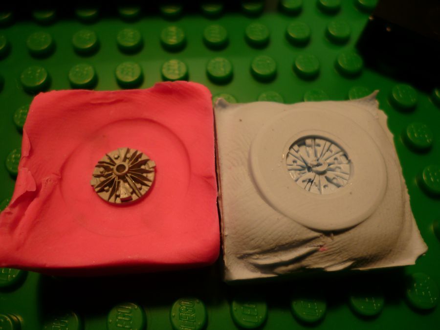

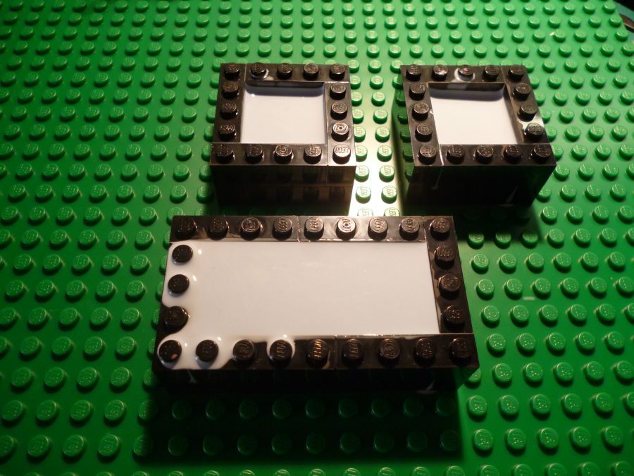

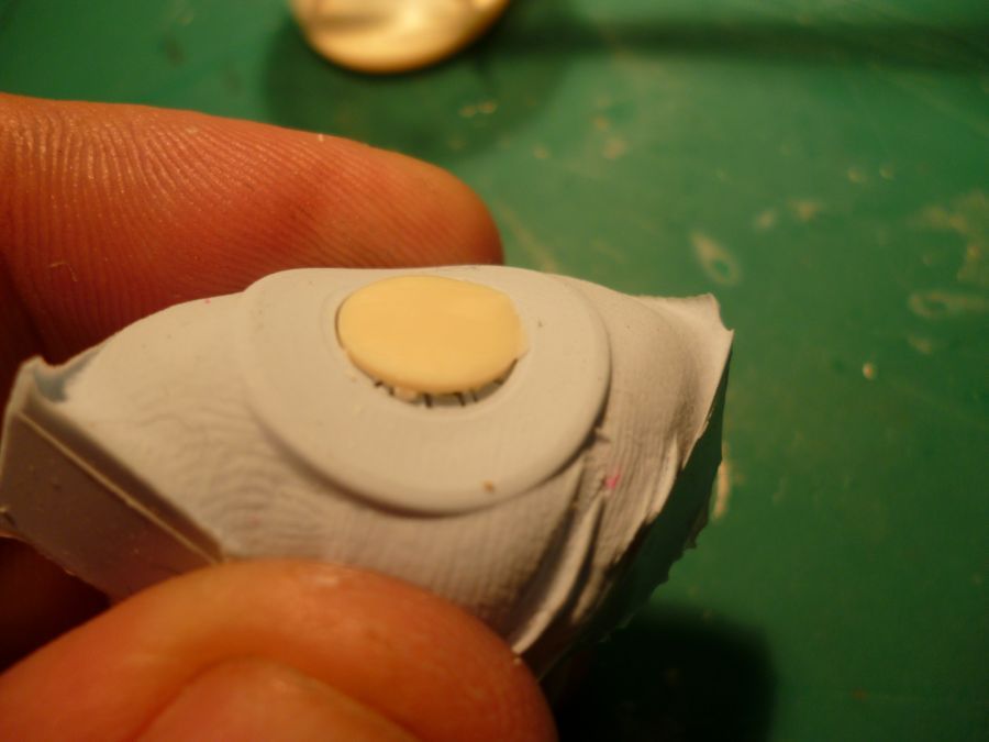

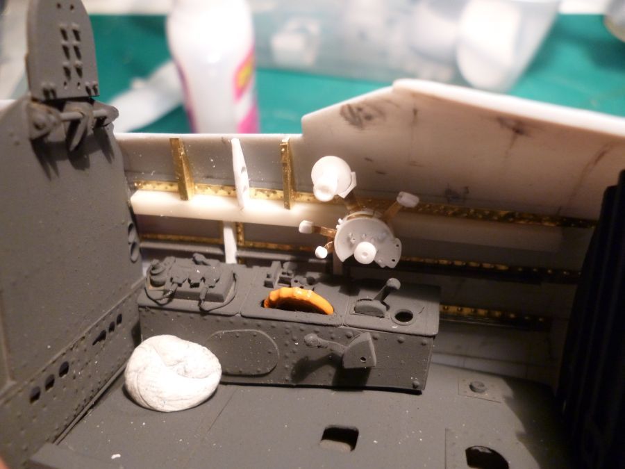

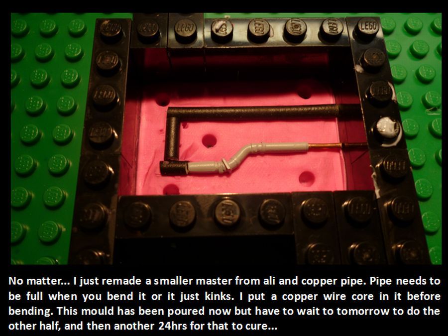

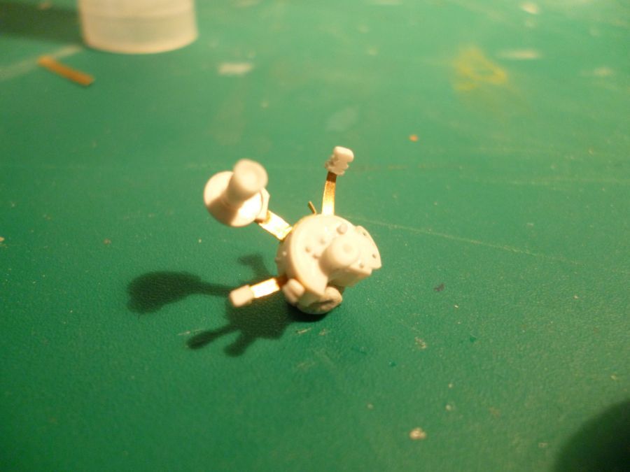

airscale Posted July 19, 2012 Author Posted July 19, 2012 just a little update... I made up the Throttle and prop control unit - should have painted the inside before I closed it up as the slots are really narrow and I don't want the white construction to show through... Not such a good pic because it is freakin tiny.. ..and what it looks like dry fitted in place... also got the resin casting stuff and buried in here are the cylinder head parts and exhast pipe masters. couple of schoolboy errors - no mould release agent on one of them and forgot to add locating pegs to the two part mould for the exhaust pipe - still you live and learn I have to wait until 2pm before 24hrs is up so will see what I end up with - otherwise I will just do it all again (properly...) until the next fun packed instalment... Peter Landrotten Highlander and red baron 2

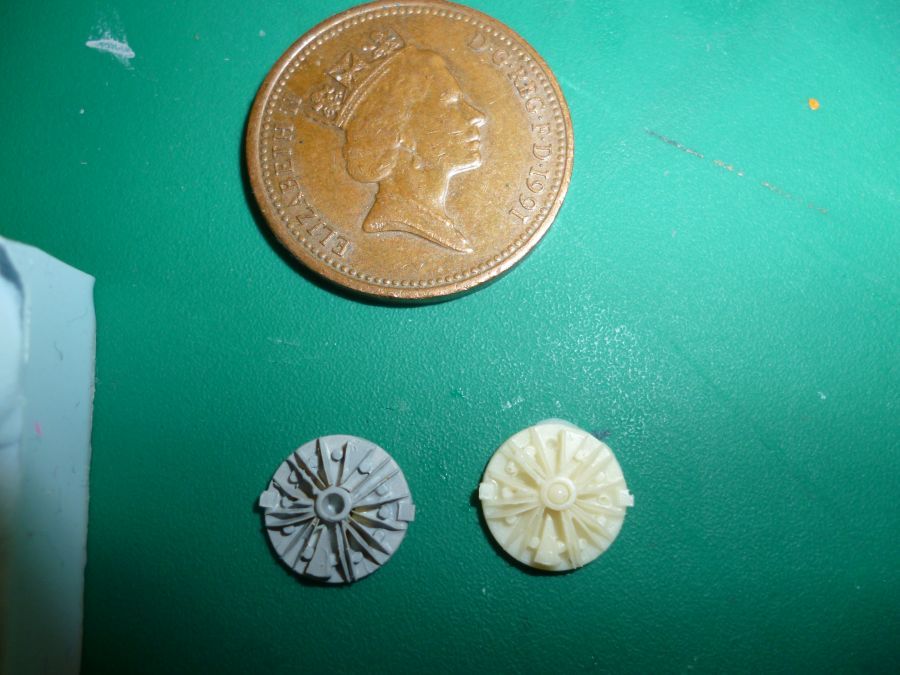

airscale Posted July 19, 2012 Author Posted July 19, 2012 woohoo - it worked!! Landrotten Highlander 1
geedubelyer Posted July 19, 2012 Posted July 19, 2012 Hi Peter, glad to see your resin casting worked out....good job Your detail work is exemplary. This is a pleasure to watch. Cheers.
A.Wolf Grant Posted July 20, 2012 Posted July 20, 2012 Wow. You're certainly motoring along its this - excellent casting too, great job. Grant.

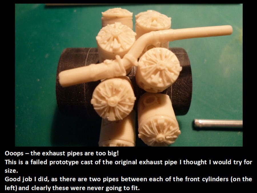

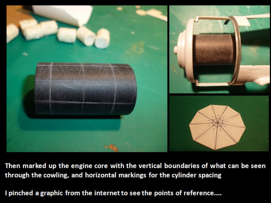

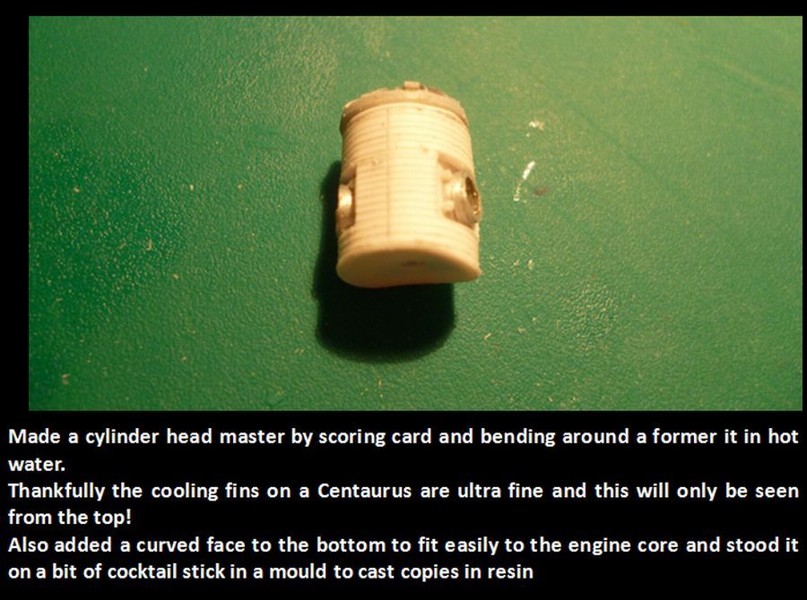

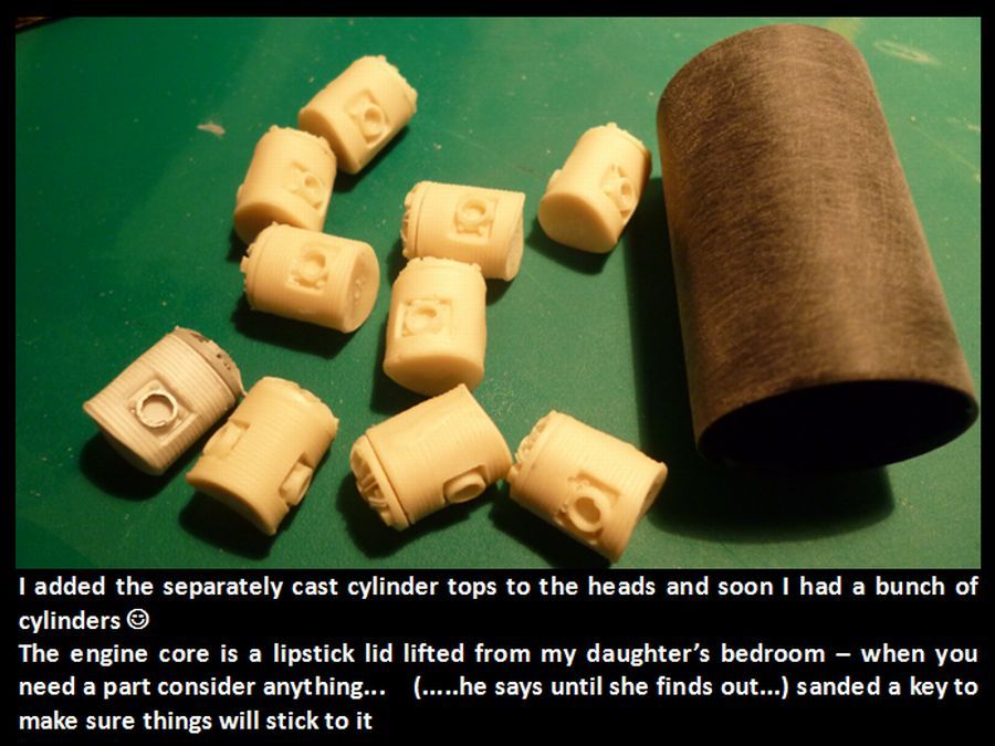

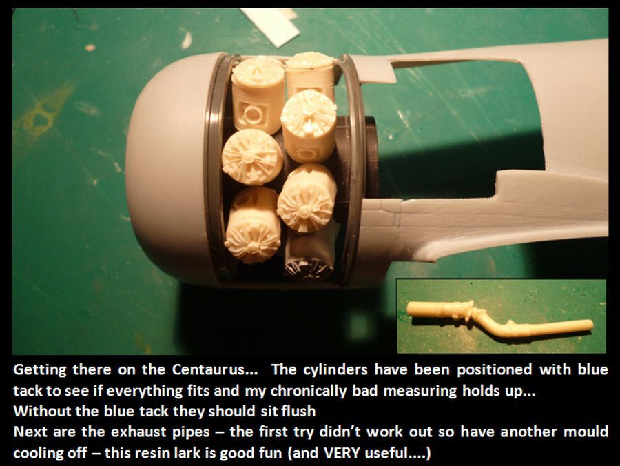

airscale Posted July 20, 2012 Author Posted July 20, 2012 Hey thanks all - geedubelyer I have seen your F14 - you are THE man for detail so high praise indeed Have been playing around today with my new toy - casting parts for the Fury's Centaurus engine. One failure and a few successes later I am learning all the time. For the price of a good kit it seems you can get all you need to turn out common shapes when kitbashing where I used to burn my life away making duplicates of the same part so it has to be a winner! I figure get the engine & cockpit done, sort the fuselage exhaust panels, chop the tail down to the much lower profile the prototype had and then I can close her up .. (sigh, that won't be a month of sundays then..) anyways I hope you like how it's coming along... until next time Peter Landrotten Highlander 1
LSP_Kevin Posted July 20, 2012 Posted July 20, 2012 Great work as always Peter! Glad to see the resin casting has worked out so well for you. You're going down the same track that I had set for myself, only I didn't have as much luck as you. Whenever I try all this cool stuff, it never goes as well as it's supposed to, or as easily as it seems to for others! Kev
airscale Posted July 20, 2012 Author Posted July 20, 2012 Thanks Kev I am definately not doing anything special - I think the only real key is measuring ingredients just went to the chemist and asked for a load of 5ml syringes and medicine pots (ooooer) and use those to make sure the rubber mix is 20/1 and the resin 50/50 can't say buying syringes and Lego has done what little street cred I had any good, but hey, I get an engine out of it...
