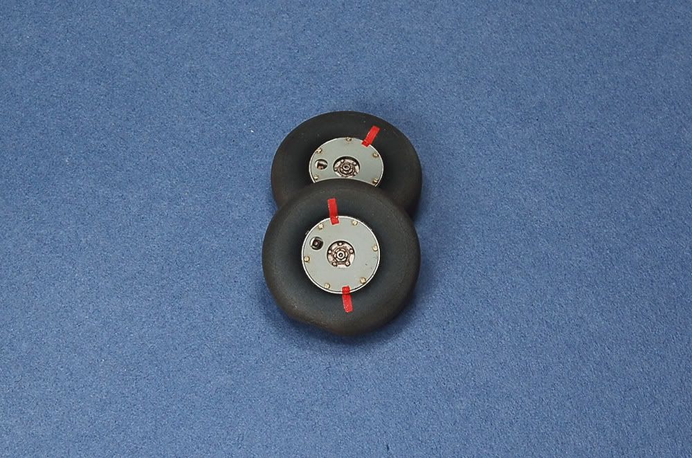

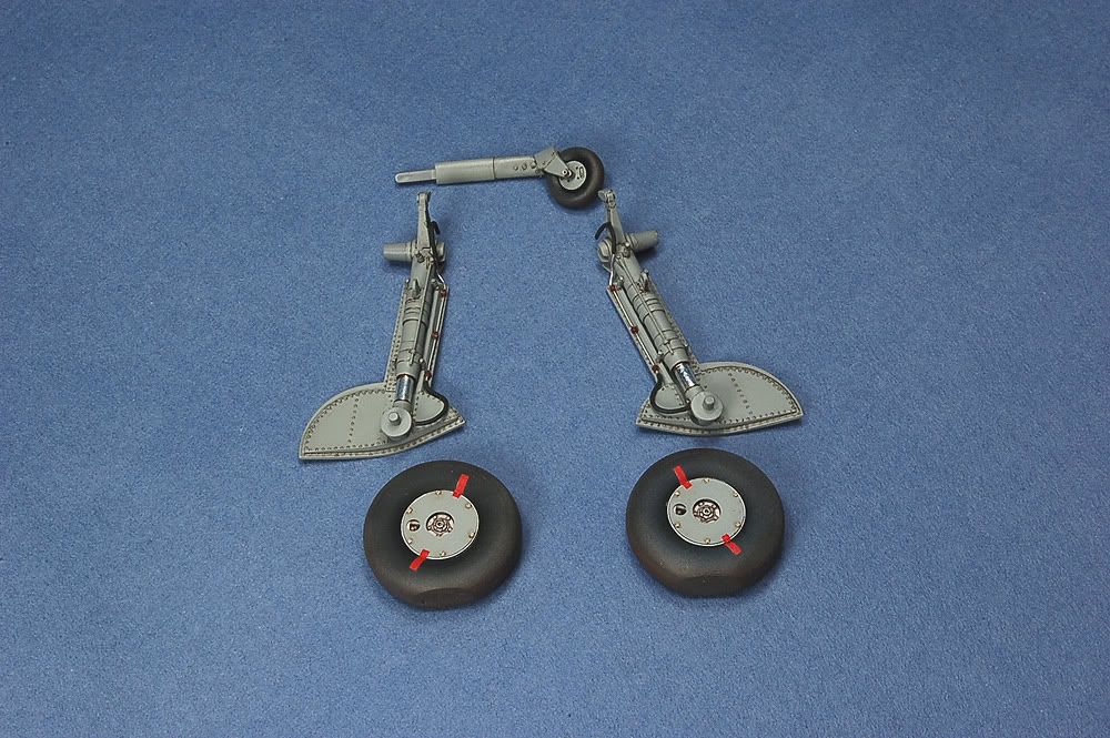

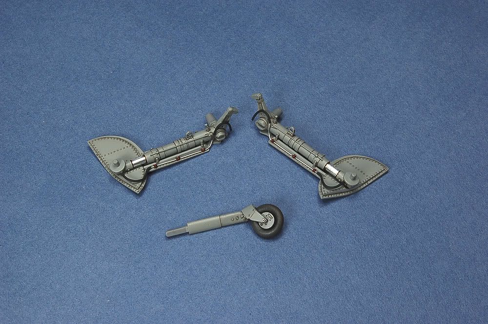

Wolf Buddee Posted March 11, 2011 Author Posted March 11, 2011 (edited) Another small step forward. I've finally gotten the landing gear finished and dry-fitting has revealed that it all fits within the gear bays as it should. Whew! The brake lines were made from Model Car Garage 1/24th scale ignition wire and the clamps to hold them in place were made from styrene card stock. The clamps are positively tiny and making them was quite a challenge but I finally managed to produce six all the same size and they worked perfectly. The bottom end of the brake line is secured to a styrene "nut" fiitting glued to the back of the brake backing plate. The polished portion of the oleo struts are covered with Bare Metal "chrome" foil. Washes were done with "The Detailer" washes using a 50/50 mix of black and brown, thinned with distilled water and a small drop of dishwashing liquid. The wheels are from Roy Sutherland's BarracudaCast Resin and the covers are from the kit. The covers had small dimples around their circumference to represent fasteners but I used the dimples as alignment reference and added the smallest photo-etch slotted screw heads I could find, again from Model Car Garage. They were held in place by small drops of acrylic clear flat paint and then permanently affixed with a final spray of flat clear coat. The creep marks were added from scrap Microscale decal material but they started to break up badly as soon as I added the Micro-sol. I kept shovin' them back together so they don't look quite as uniform as I would have liked but I'm callin' it wear and tear, LOL. The tires themselves have a lot more brown and grey tones to them but for some reason they don't show it well in the photos. I'm also happy to report that after having cut apart the tailwheel assembly, I've managed to get it to castor nicely. I think it'll add a little visual interest to the finished model. The next step will be to scratch-build the actuators and linkage for the shutters for the underwing radiator housings and then I'll be back to the engine! Comments and critique always welcome! Cheers, Wolf Edited March 11, 2011 by Wolf Buddee geedubelyer and Model_Monkey 2

nmayhew Posted March 11, 2011 Posted March 11, 2011 hi Wolf, As Kev said, jealous! Fantastic work question: what are the red tabs / tags that straddle the wheel cover on to the tire itself? are these the creep marks you refer to - i wasn't sure what that meant. thanks as ever for sharing your inspirational work. Nick
LSP_Kevin Posted March 11, 2011 Posted March 11, 2011 question: what are the red tabs / tags that straddle the wheel cover on to the tire itself? are these the creep marks you refer to - i wasn't sure what that meant. They are indeed creep marks. Mechanics use them to check if the tyre has rotated at all. Kev
