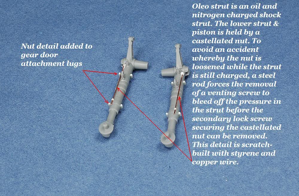

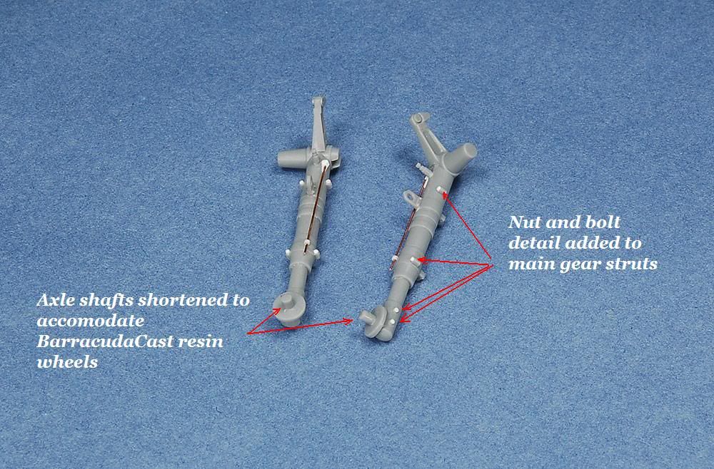

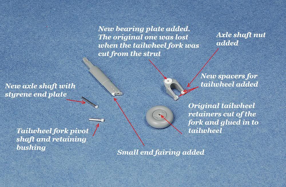

Wolf Buddee Posted February 24, 2011 Author Posted February 24, 2011 Another small update on the Big Spit. I've momentarily set aside the engine assembly and started in on the landing gear assemblies. The accompanying photos will show what I've done to detail the struts and hopefully the notes will explain everything clearly. Not shown in the photos are the modifications I've made to the main gear doors. I closed all the holes for the attachment of the kit supplied brake lines. New brake lines will be scratch-built and added after the gear doors have been painted and attached and the BarracudaCast resin wheels have been glued in place and aligned. The tailwheel strut and fork have been modified so that I could paint the tailwheel separately, add it later, and so that I could make the tailwheel fork fully castor like on the real plane. Thanks for having a look! Cheers, Wolf Model_Monkey 1
