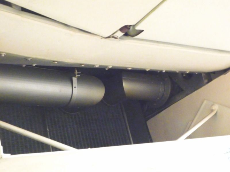

Guest KingK_series Posted October 21, 2012 Posted October 21, 2012 (edited) One last pic of the starboard heating duct. The duct has been painted and weathered and I've removed the radiator housing flap to show the duct in place. Nothing's been glued yet, everything's just drop fitted in to place so the duct positioning will be tweaked slightly. I was worried about the Archer Fine Transfer rivet decals being too big but in the end I was worried about nothin' as they look awesome under a coat of paint. They're visible enough to show they're there but not overly conspicuous so I'm very happy with the end result. I definitely give 'em a 10 out of 10 for what it's worth. The weathering was done using the Pro-Modeler Dark Dirt wash. It's the first time I've used this stuff and I really like it. Now it's time to get back to the bench and get the other side done. I'd like to acknowledge and thank two gentlemen for helping with this little detail. Edgar Brooks, thank-you for the drawings, they helped immensely and Derek Pennington, thank-you for the photo of the actual duct. Both are very much appreciated! Cheers, Wolf Love the paint work on your build - just looking at this though - it's one of the faults of the Tamiya Spit that the rad cores are not deep enough - not least so the heater ducting can pass into the wing take a look at this pic of an unrestored Spit - where the ducting at the rear of the rad follows only above the rad, leaving the sides open into the wing structure. You then see the ducts passing into the wing. Edited October 21, 2012 by KingK_series

Wolf Buddee Posted October 23, 2012 Author Posted October 23, 2012 Love the paint work on your build - just looking at this though - it's one of the faults of the Tamiya Spit that the rad cores are not deep enough - not least so the heater ducting can pass into the wing take a look at this pic of an unrestored Spit - where the ducting at the rear of the rad follows only above the rad, leaving the sides open into the wing structure. You then see the ducts passing into the wing. Hey KingK, to be honest it could quite possibly be a combination of my scratch-built duct being slightly oversized and the Tamiya rad trough could be a bit shallow but it's not really noticeable once the plane is wheel side down. In fact it's almost impossible to see the gun heating ducts without a light. Glad you like it though. One thing to note from your pic, it looks like the set up used on a Mk V or earlier airframe. Cheers, Wolf
