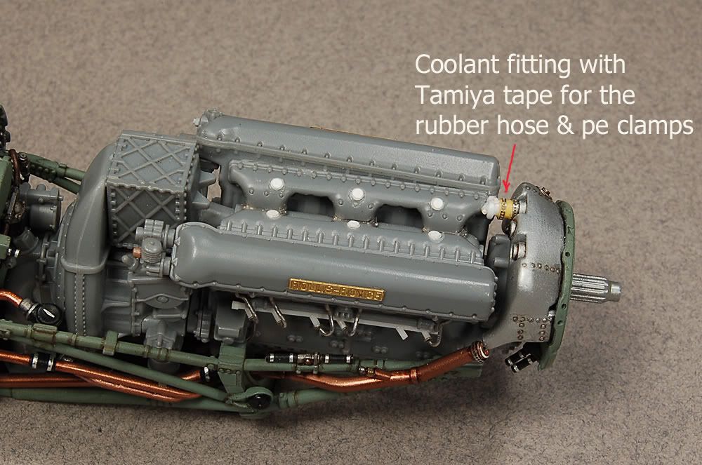

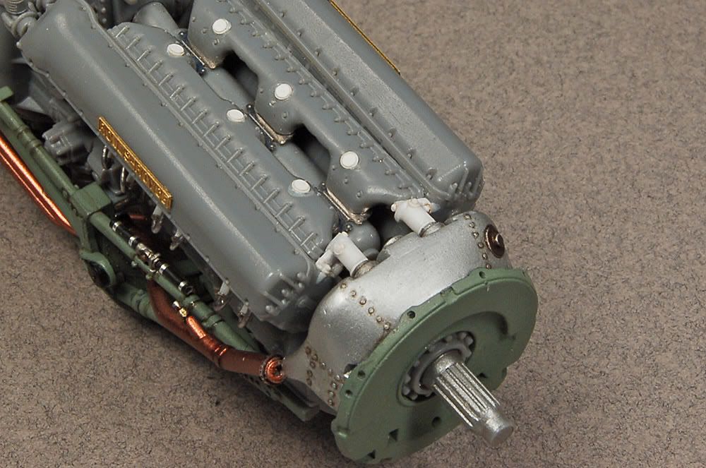

Guest Posted March 1, 2012 Posted March 1, 2012 The beginning of the end! After a couple of months away from the bench it was high time to get back at 'er and finish off the Merlin for the big Spit! The first order of business was to scratch-build the missing coolant connector pipes that go from the cylinder heads to the coolant header tank at the front of the engine. Using drawings supplied by Edgar Brooks (thank-you Edgar) I cobbled together the connectors from styrene card stock, evergreen rod, and various sized discs punched out with my trusty Waldron Model Products punch and die set. I can't begin to tell you how invaluable that tool has become! I tried to match the level of detail on these parts to what Tamiya supplies in the kit but it's a little hard to see from the pics because they're all white and really small. The rubber hose is represented with a thin strip of Tamiya masking tape and the clamps come from a Model Car Garage set of vintage hose clamps. The starboard side will be glued in to place shortly and then I'm on to the next bit. The white discs on top of the intake manifolds are the beginnings of the cylinder fuel priming lines. Your intake gaskets are too thick ! Really, this is scrumdillielishis ! Great scratch work and oh so detailed!......Harv

Wolf Buddee Posted March 1, 2012 Author Posted March 1, 2012 Your intake gaskets are too thick ! Really, this is scrumdillielishis ! Great scratch work and oh so detailed!......Harv LOL, Thanks Harvey! The intake gaskets are kit supplied, what can I say? Cheers, Wolf
