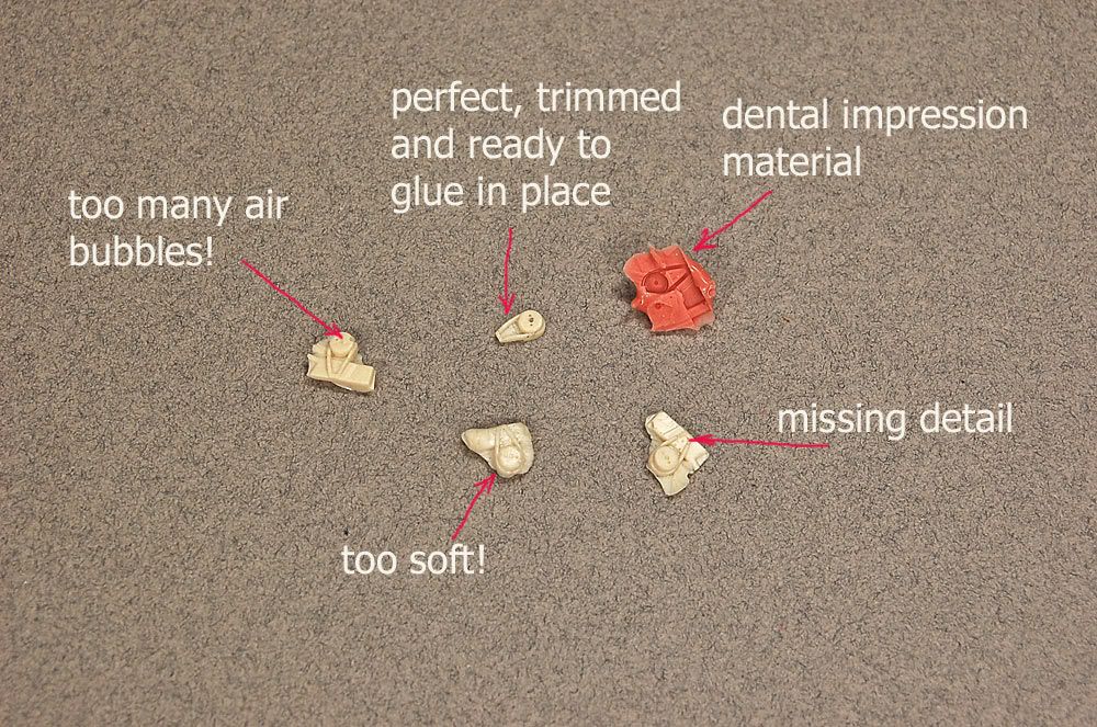

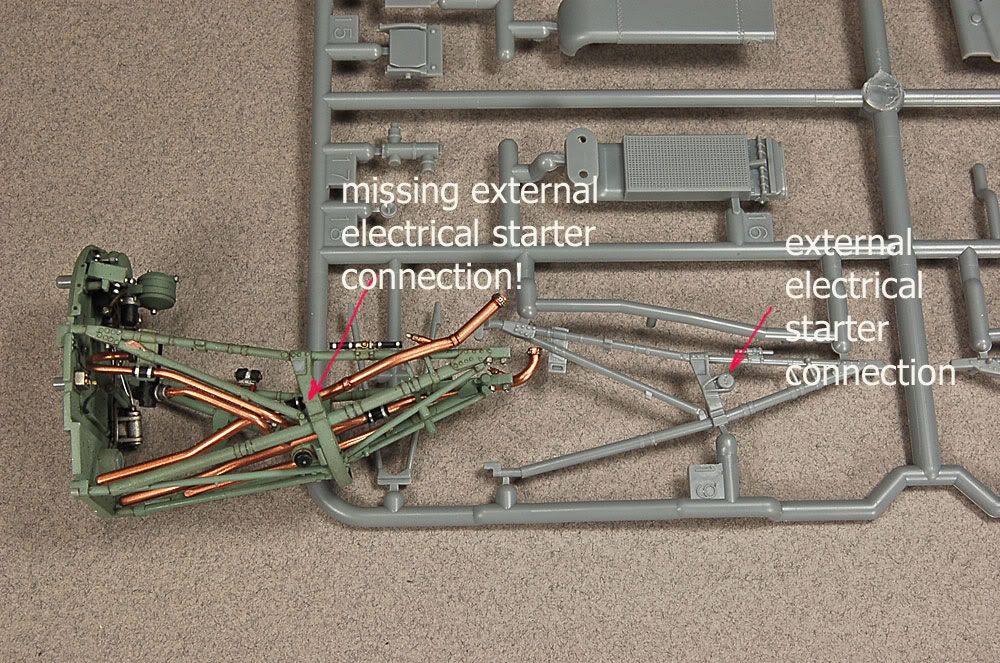

Wolf Buddee Posted November 20, 2011 Author Posted November 20, 2011 (edited) A couple of steps backward to move one step forward! When I started this model the research material I had suggested the aircraft I was building had the small carburettor air intake. This, according to the instructions meant that I had to remove the electric starter connection from it's location on the stbd engine bearer frame which I dutifully did. I then installed the kit supplied replacement connection to it's new location on the lower "U" frame member as shown in the instructions. I also filled the access cover on the stbd engine cowl panel for the connector as noted. So far so good right? I then discovered a pic that showed the aircraft I was modelling had the larger universal air intake. No problem......., except that the installation of the larger air intake moved the starter connection........you guessed it,.......to the side of the engine bearer with the access hatch on the stbd engine cowling. Re-scribing the access cover was easy. Figuring out how I was going to replace the starter connection was a little more involved. When I'd originally removed it I shaved it off one little bit at a time and threw the scrap away. I now needed a copy of the engine bearer to cast a new starter connection and replace it on the engine frame. Fellow modeller extraordinaire Dave Pratt to the rescue! Dave had an un-started kit and he kindly lent me the sprue that carried the detail I needed to cast a replacement piece. My wife, a certified dental assistant, was able to supply me with some impression material, the kind that makes you gag,.... you know....., and this stuff allowed me to make a mould of the detail I needed to restore. Once I had a good impression, which took about 3 or 4 tries, I was able to use a liquid two part resin casting material called Alumilite to cast a new piece that will be glued to it's rightful spot and restore what I shouldn't have done in the first place! All I have to do now is remove the lower starter connection and she's done. The following pics show the rest of the story. Mission accomplished but it could've been easier, Cheers, Wolf Edited November 20, 2011 by Wolf Buddee Model_Monkey and geedubelyer 2
