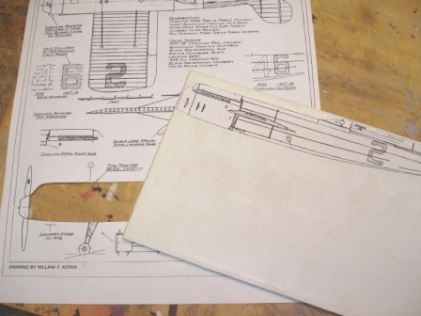

Marcin_Matejko Posted September 18, 2010 Author Posted September 18, 2010 Drawing model glued to plastic (HIPS) the plate with a thickness of 4mm. Then it cut the first element of the solid hull of the futur.

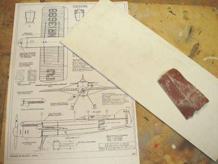

Marcin_Matejko Posted September 19, 2010 Author Posted September 19, 2010 layers glued tiles shook so that everything is well glued. I used CA glue Loctite 454 gel

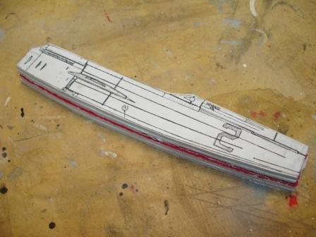

Marcin_Matejko Posted September 19, 2010 Author Posted September 19, 2010 OK.the next step, block sized hull thickness 16mm. The red color is the future axis of symmetry

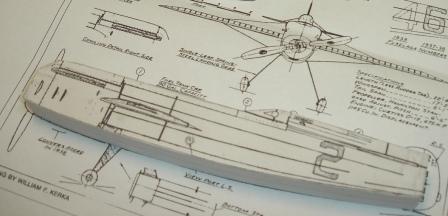

Marcin_Matejko Posted September 19, 2010 Author Posted September 19, 2010 Trimmed and roughly the shape of the hull in a side view
