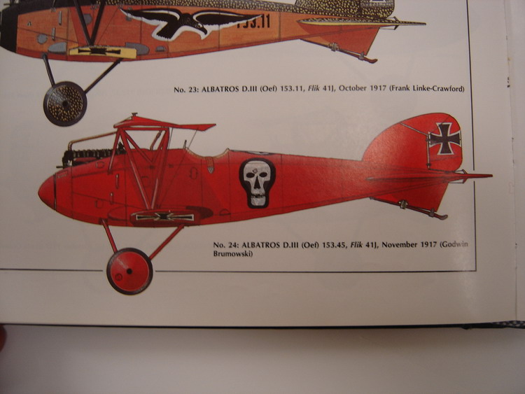

blackbetty Posted October 1, 2009 Author Posted October 1, 2009 doing the A-7 in the 10th aniversary GB and this will be quite a challenge. i hope to finish the corsair until the end of december and the pull off a russ with this one in the remainig three months. problem is: its not a matter of assembling and slapping some paint on. the austrian license built albatrosses had many modifications done by OEFFAG in wiener neustadt. they didnt suffer the structural problems their german counterparts had with the wings. they used austrian schwarzlose machineguns (thank god completely buried in the fuselage, not on top like the spandaus) with blasttubes under the intake/exhaust. furthermore they had the excellent austro daimler engine, whos differences to the german engine can be clearly seen, but in winter they used a cowling that left only the exhaust poking out. spinners were often removed (the later series 253 didnt have a spinner in the first place, but a completely different nose) as for the paint sheme there were pretty striking examples on these planes on the italian front too. brumowsky flew an all red plane, an idea he got from richthofen during his study trip to the western front i will do 153.45 that looks like this: (photo of a drawing out of martin o´connors excellent book "air aces of the austr-hungarian empire")
blackbetty Posted October 1, 2009 Author Posted October 1, 2009 or i will do 153.52, in which he was shot down (and survived) in february 1918 this plane is all red too, with a different skull, but has brown dots all over it (pics from Petrer Schiemers also excellent albatros book) stay tuned

ruzlkampf Posted October 1, 2009 Posted October 1, 2009 Hurray! Blackbetty has arrived! Wow, what a cool camo scheme dude. Skulls are always in fashion. Hey, it's easy to 'do a Russ',...just leave out half the pieces, guess at the colors, and throw the PE away, and use lots of putty. Details? Pesky little things to be ignored. Naw, you'll do this in your own style, and at your own speed...as it should be. Can't wait to see this one come together buddy, it looks like a great kit. Hope you get a chance to share some info on this pilot, and what was going on with Austria (guess that'd have been the Austro-Hungarians at that time in history?) and this front as you progress with your build. Interesting stuff, I'm sure. Looking forward to seeing any update pics on this as it progresses, and I'm glad you're here with another Central Powers entry, the Allied forces are starting to multiply on this GB and threatening to take over! Later, Russ

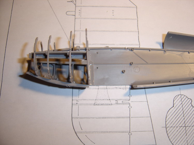

blackbetty Posted January 7, 2010 Author Posted January 7, 2010 one of the main differences to the german plane is the location of the guns: the schwarzlose MGs are buried deep in the fuselage, firing through blast tubes beneath the exhaust, so the fuselage upper deck is closed. the starboard side front of the fuse also does not have the depression for the exhaust pipes. so i first made some cuts to remove the middle and front part of the kit, refitting the wedge further upward
blackbetty Posted January 7, 2010 Author Posted January 7, 2010 the rear part has been closed with some bent .5mm sheet, the ammo feed of the german guns has been removed the refitted wedge is visible
blackbetty Posted January 7, 2010 Author Posted January 7, 2010 some more sheet to close the gap the the engine cutout in the background the upscaled windsock datafile plans with the cowling stay tuned
