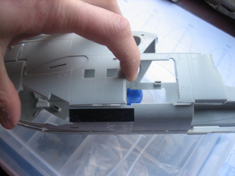

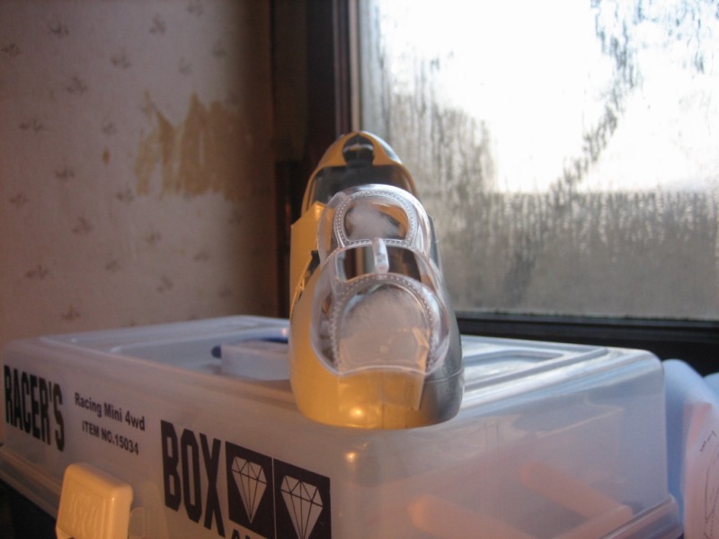

misha71 Posted January 25, 2009 Posted January 25, 2009 Hello mates. Here i'm begining long project of the Mi-24 with deep surgery. I think pictures will tell more. I have to say that this model besides fuselage asimetric has shape problem of the back side and tale. But it is possible to correct them and than the result will be nice.

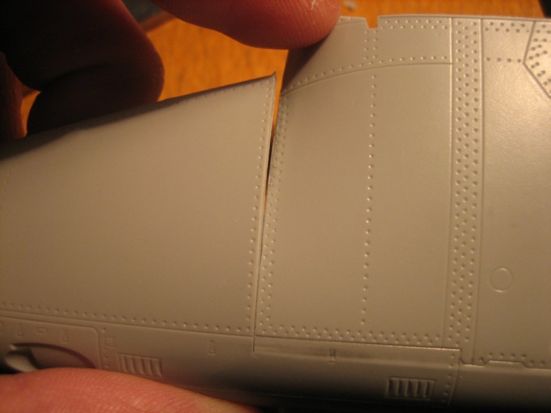

misha71 Posted January 25, 2009 Author Posted January 25, 2009 firs picture. all comments, critiques, sugestions are welcome.

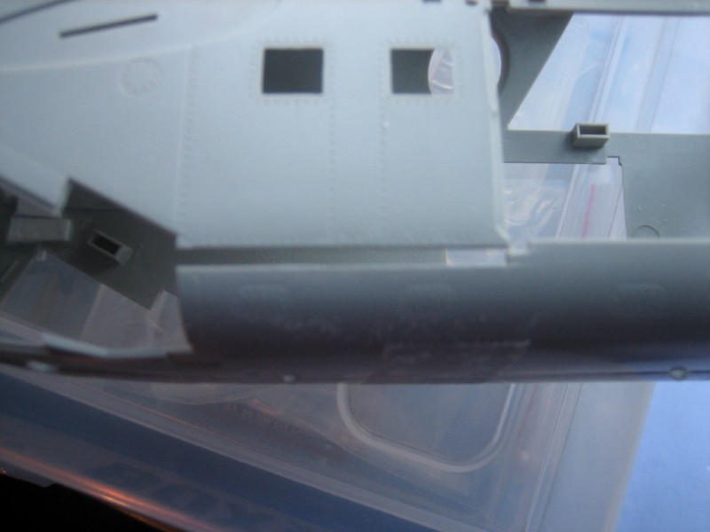

misha71 Posted January 25, 2009 Author Posted January 25, 2009 This plase was cut because of tention of the plastic and then here shape is a little tricky.
mgbooyv8 Posted January 25, 2009 Posted January 25, 2009 Hi Micha, Â That's a good start! I see that you already have made the fuselage asymmetrial. I'm interested to see what needs to be done to correct the rear fuselage and the tail. Â Cheers, Â Peter

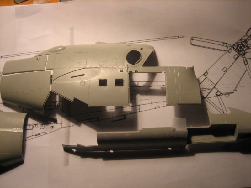

misha71 Posted January 25, 2009 Author Posted January 25, 2009 Thank you peter for kind words. I will try to show my desigion how to make fuselage tilted. here is first step

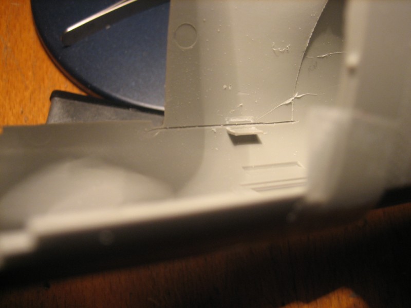

misha71 Posted January 25, 2009 Author Posted January 25, 2009 Then inside of the left side i rescribed guide line to help plastic bending

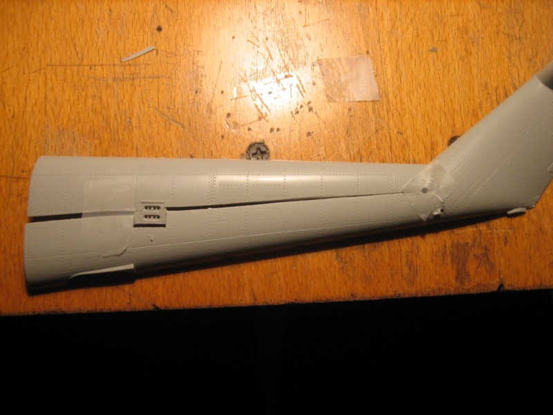

misha71 Posted January 25, 2009 Author Posted January 25, 2009 For right side there is a small problem with armament bay door location.
