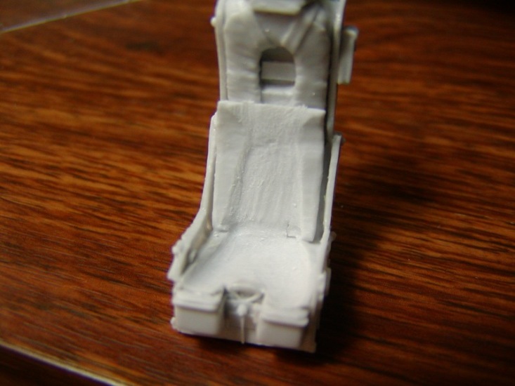

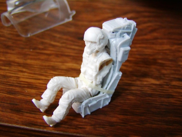

Barry Posted June 3, 2009 Author Share Posted June 3, 2009 It always perplexes me when fitting a scale figure to a scale ejection seat. “Never Works” When I first placed the seat into the cockpit it looked a little high so I removed material from the bottom of the seat until I got it where I think a pilot would position himself while maneuvering to accomplish aerial refueling. Seat set high for good forward and over the side visibility. When I place the figure in the seat his head was above the top of the ejection seat and would have been several inches outside the canopy. I first adjusted the figure like I want it to look then I removed material for the seat cushion and seat back as well as the figure. I did not have to cut any body parts so all in all the figure is very accurately scaled. The following photos show the area of the seat where I removed material and how the pilot looks position in the aircraft. sandokan 1 Link to comment Share on other sites More sharing options...
Barry Posted June 3, 2009 Author Share Posted June 3, 2009 Pilot fitted to seat. Derek B and sandokan 2 Link to comment Share on other sites More sharing options...
