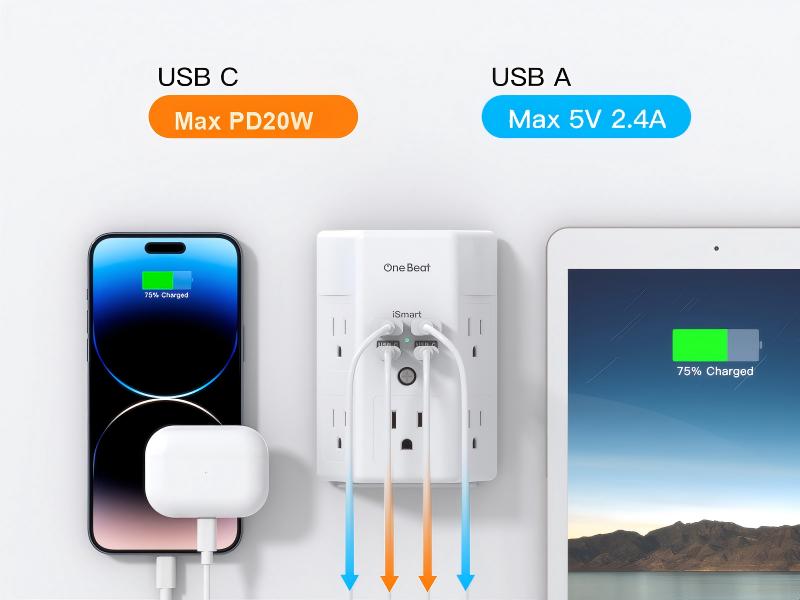

Thunnus Posted August 20 Author Posted August 20 Hold the presses! Maybe I should've tested the re-charging on a different outlet at home but I used the one that works with every other appliance that I have. Here at work, charge percentage is at 28% and when I unplug it and power it on, it shows a battery charge of 28%. Looks like it is holding a charge like it is supposed to. A case of operator error it seems. Will report back after the Hanboost is fully charged. alaninaustria, mattlow, D.B. Andrus and 2 others 5

Thunnus Posted August 20 Author Posted August 20 All good with my Hanboost C1. After charging to 100%, the unit diplays 100% charge after it is unplugged and turned on. Reminder to self that all electrical outlets/USB outlets are not the same. Not sure why the one I was using at home didn't work. It was plugged into one of these... JayW 1
SwissFighters Posted August 20 Posted August 20 2 hours ago, Thunnus said: All good with my Hanboost C1. After charging to 100%, the unit diplays 100% charge after it is unplugged and turned on. Reminder to self that all electrical outlets/USB outlets are not the same. Not sure why the one I was using at home didn't work. It was plugged into one of these... Glad to hear you resolved it! Tech - both a blessing and curse. Tony mattlow and Thunnus 2
