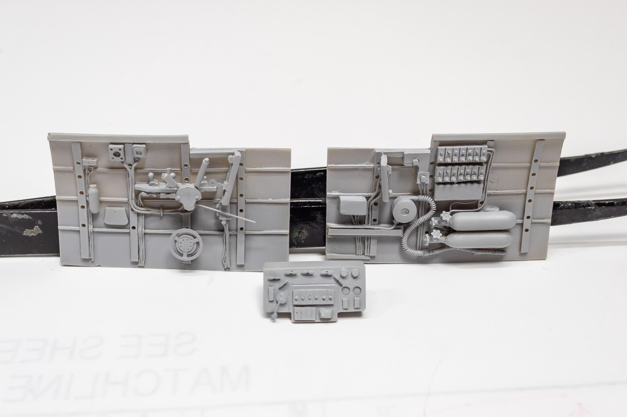

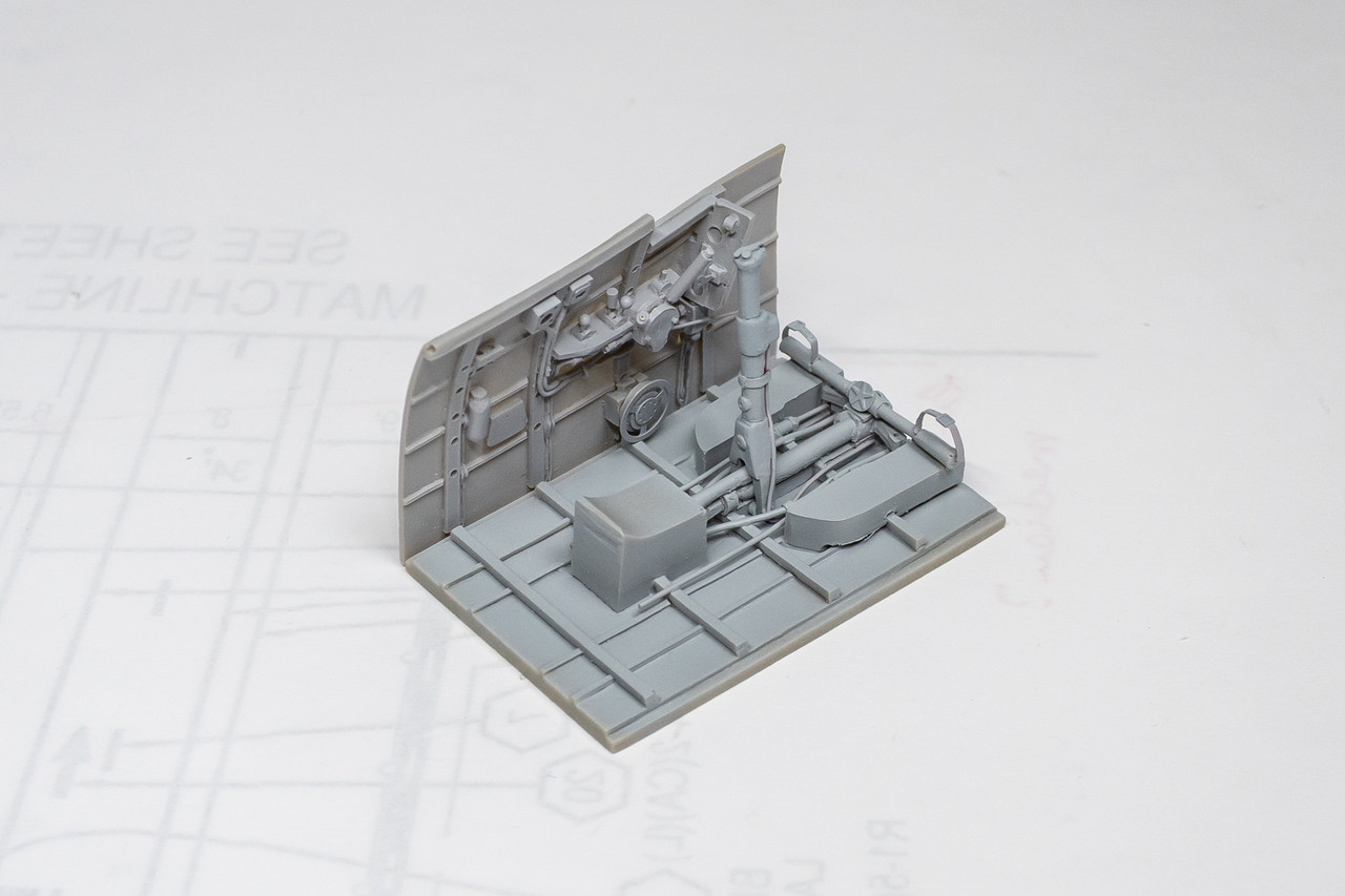

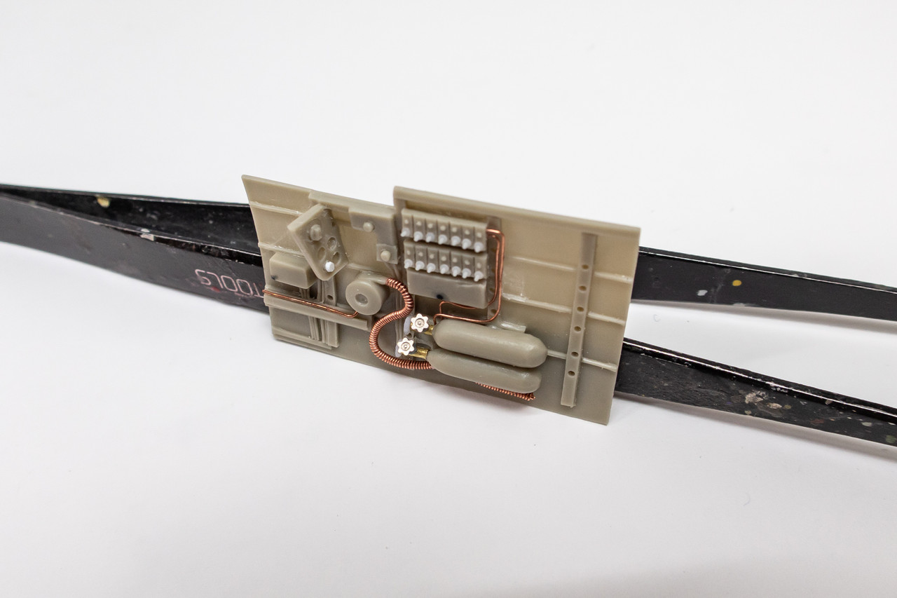

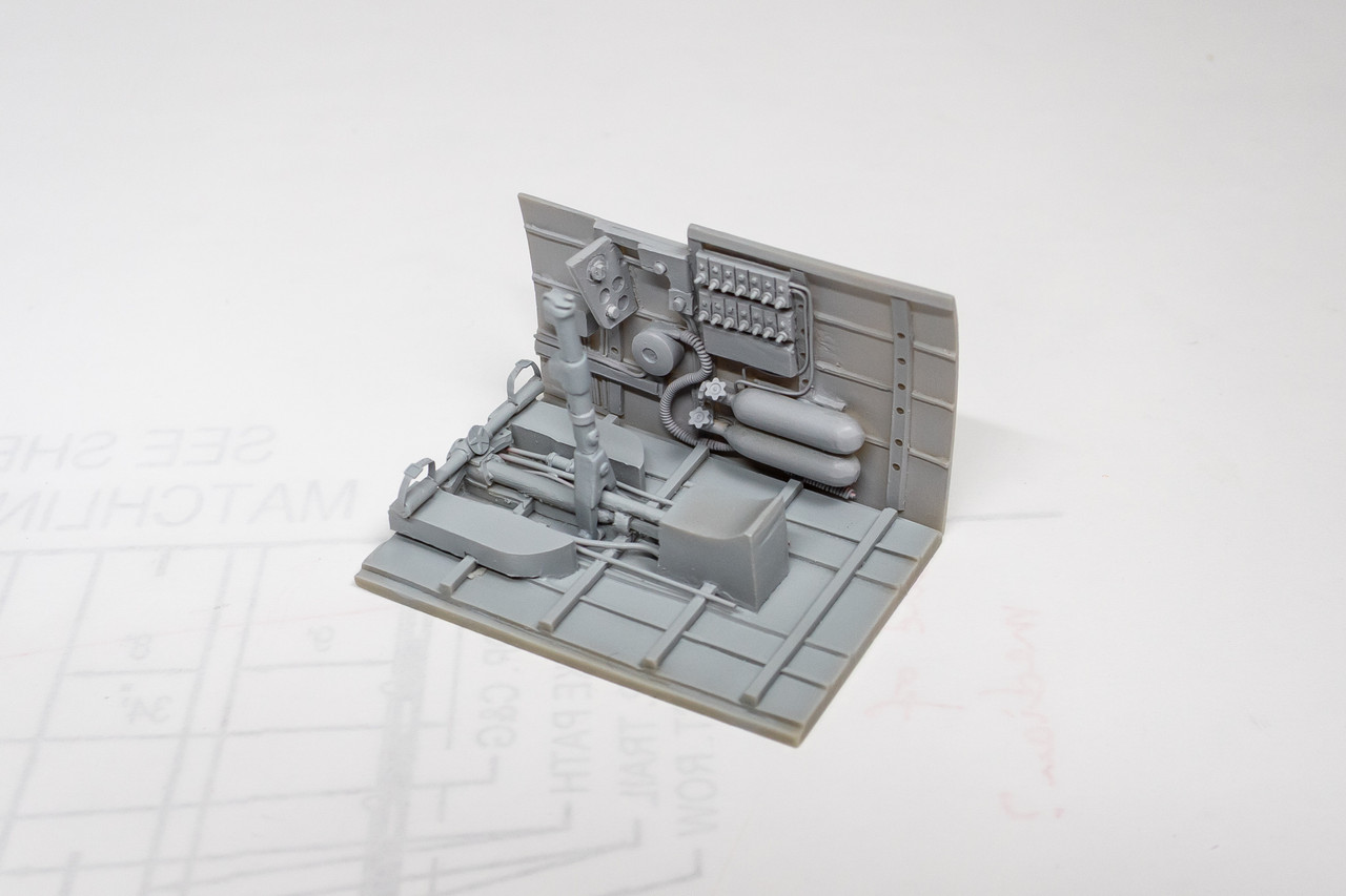

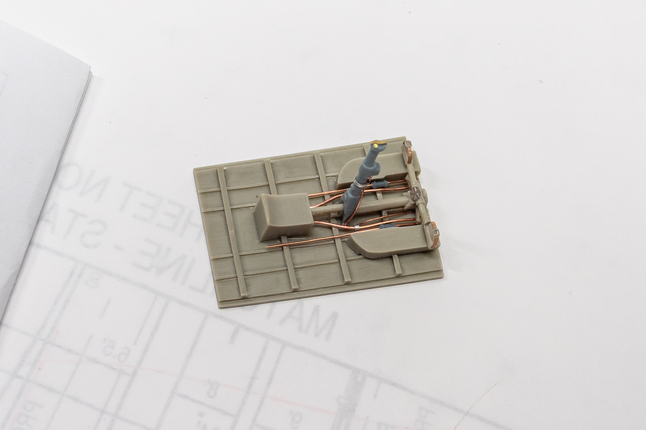

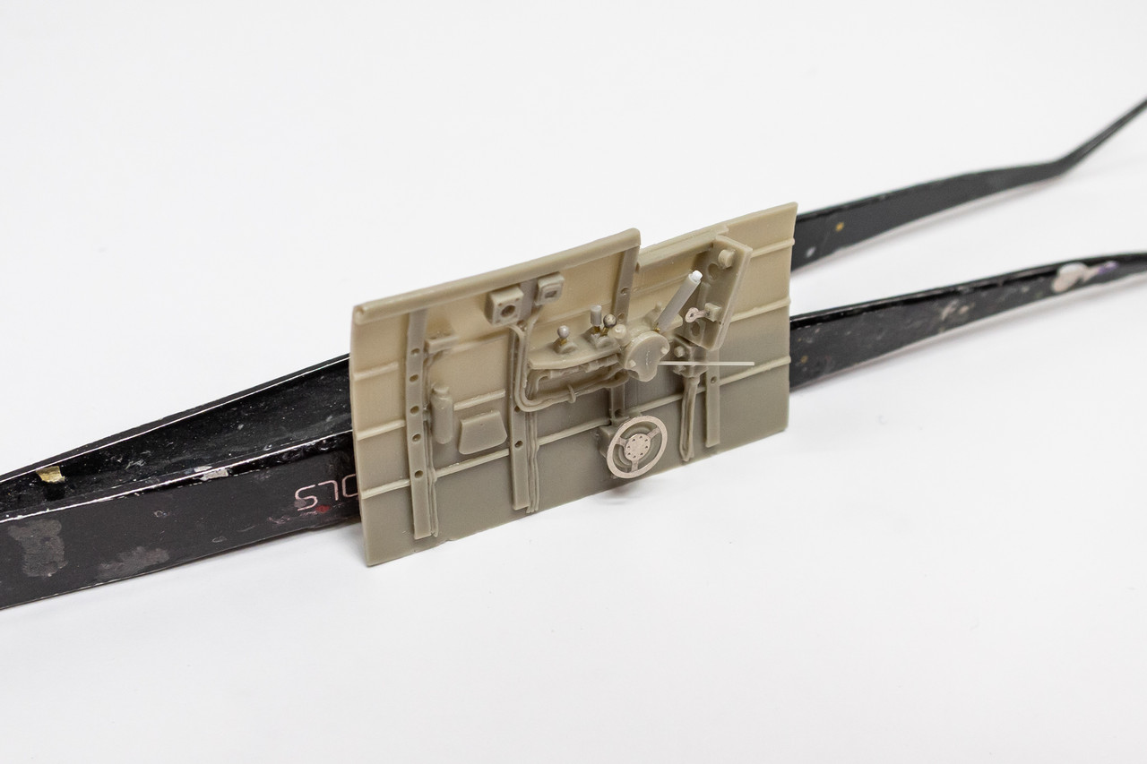

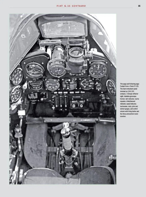

Thunnus Posted June 22 Author Posted June 22 Thanks guys! Appreciate the dialogue! I'm terrible at locating holes on plastic so marking by spraying through the holes gives me a better chance at the pins actually lining up correctly! Moving from the instrument panel to the sidewalls... I've added a little bit of detailing to the resin parts. On the starboard side, the inconsistently cast buttons on the large panel were cut off and replaced with toggle switches from ANYZ. I fashioned an oxygen hose from copper wire and added it to the oxygen regulator. On the port side, the levers were cut off and replaced. I also added a throttle linkage rod to the throttle quadrant. The sidewalls and the central switchbox were given a coat of primer (Mr Primer Surfacer 1000). I wanted to spice up the cockpit floor a bit but was at a loss of what to do given a lack of references. But I stumbled onto this photo while trolling the internet... That gave a couple of ideas to work with: adding wiring to the floor and putting some small details on the top of the control stick, including a firing button. Here are the cockpit parts primed and posed together prior to painting. SwissFighters, RCPlym, TankBuster and 21 others 24
