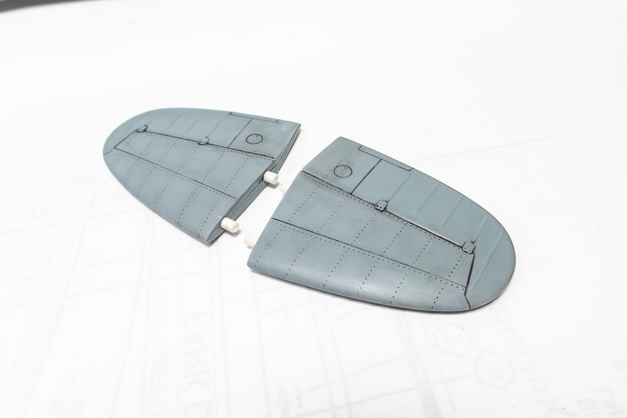

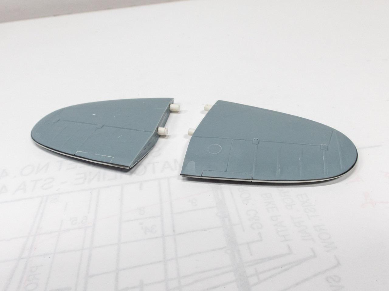

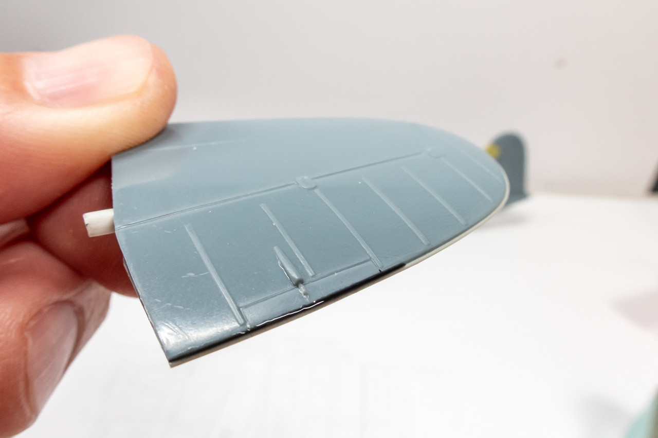

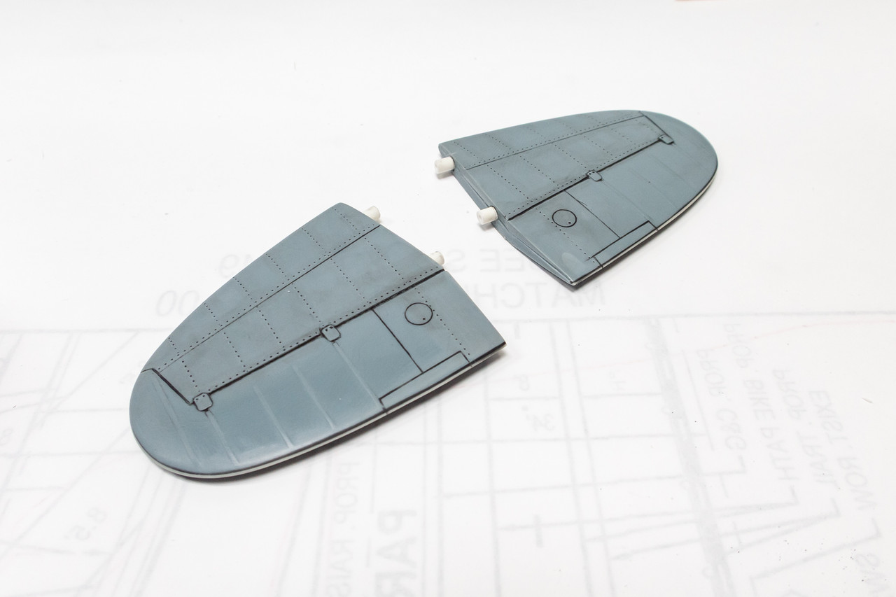

Troy Molitor Posted June 19 Posted June 19 Great start. Looking forward to the rework on the trailing edges on the elevators. Do you have a scheme already in mind you can share with us? There are so many with the G.55. Thunnus 1

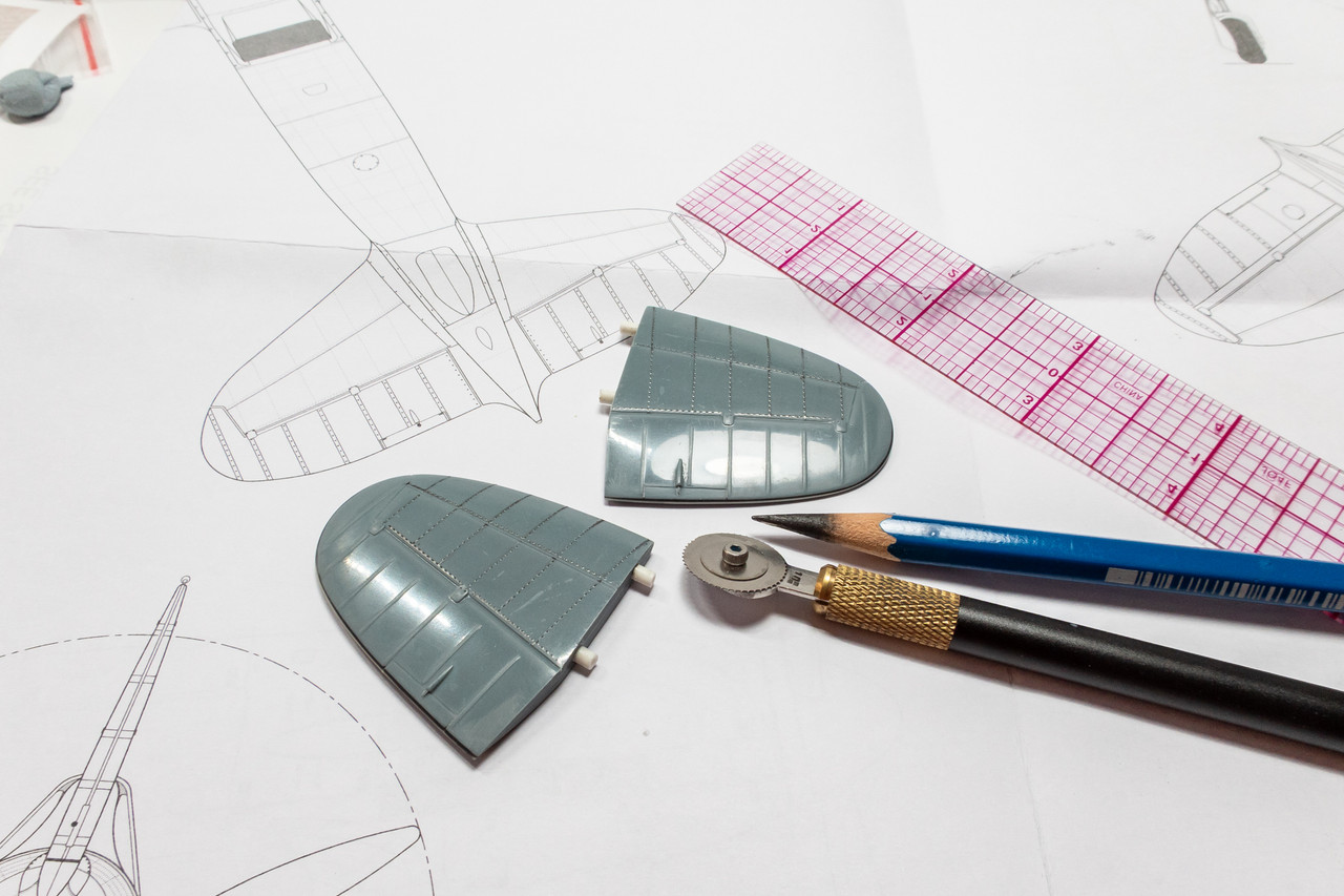

scvrobeson Posted June 19 Posted June 19 So that's how we figure out where to add pins. I need to squirrel that away for the next build I need to reinforce. Thanks for the informative tip John Matt JayW, mattlow, Thunnus and 1 other 4
Dpgsbody55 Posted June 20 Posted June 20 Great start on the new Fiat. I like your method of placing pins on the tail plane joint. Some good improvements here already, too. Cheers, Michael Thunnus 1

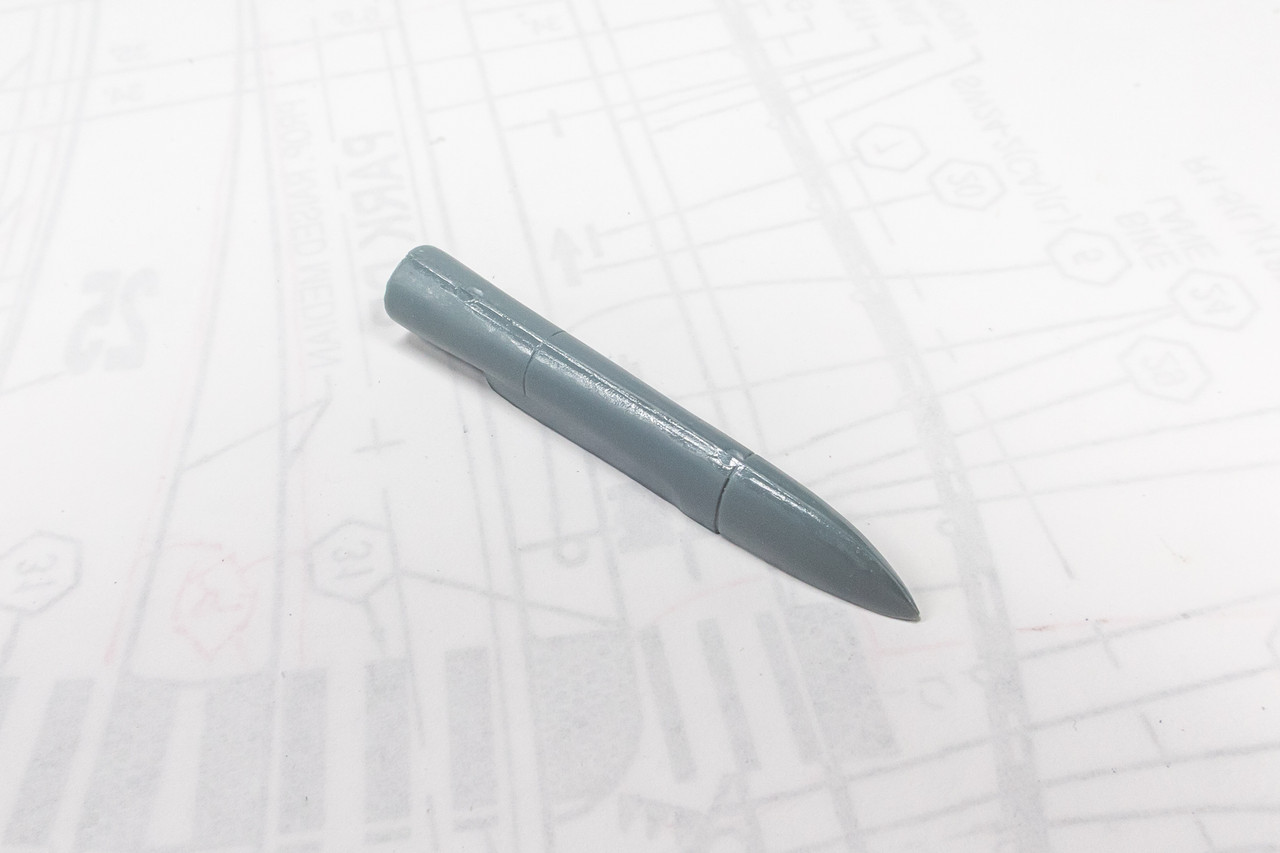

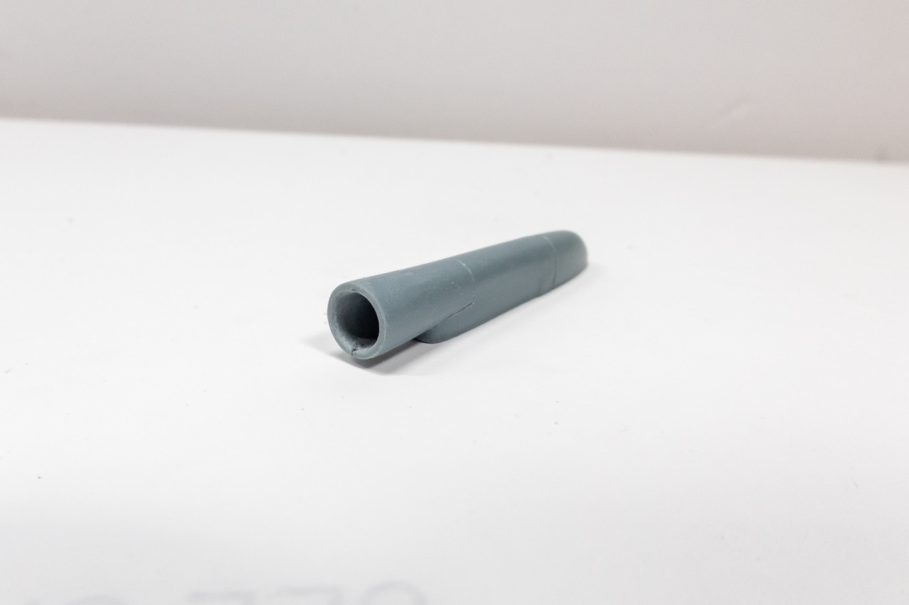

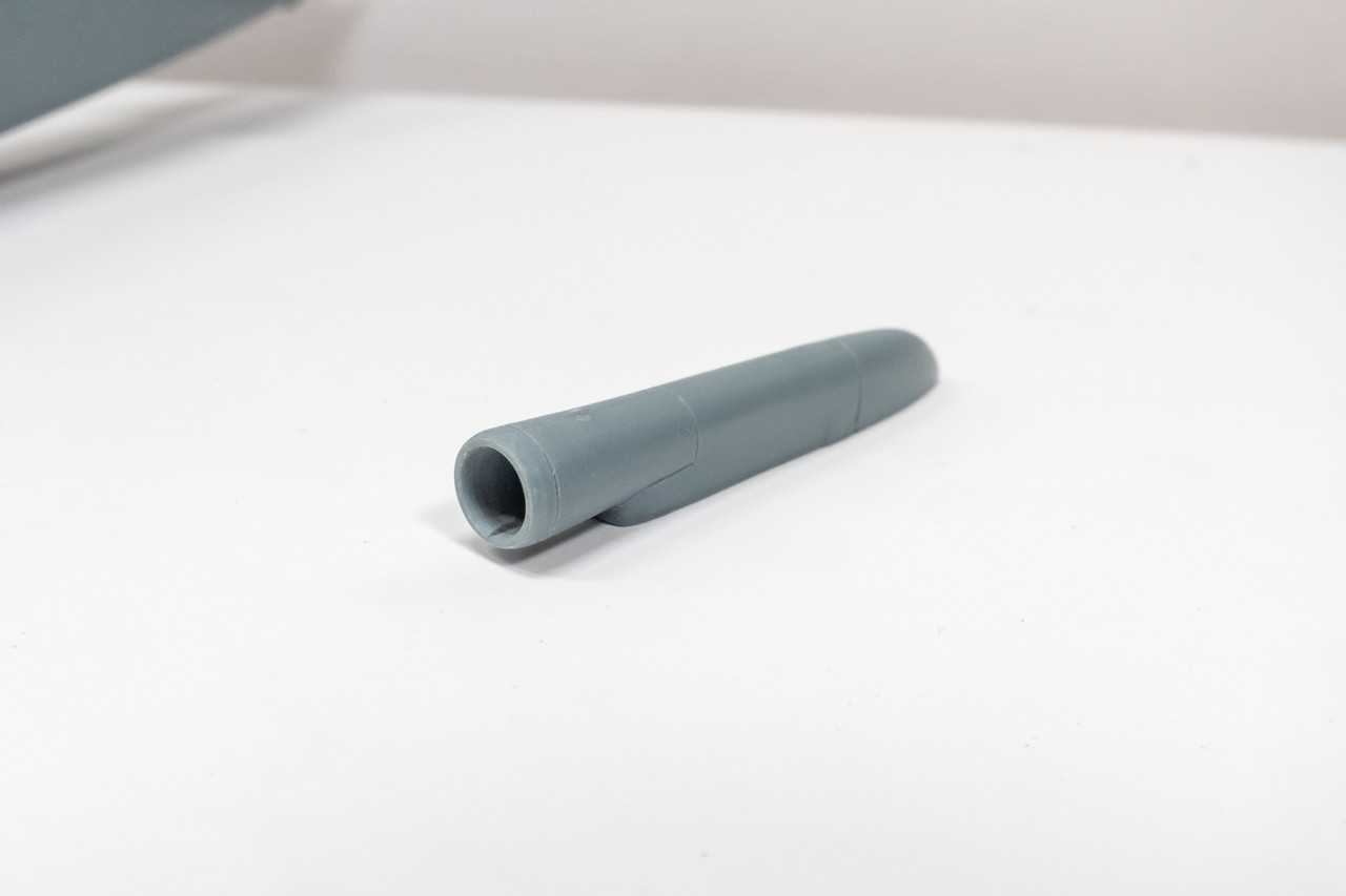

amurray Posted June 22 Posted June 22 On 6/19/2026 at 1:49 AM, Thunnus said: Thanks for the comment! As usual at the beginning of a build, I am jumping on different things randomly as they grab my attention so sorry for any confusion. The molding ridges on the landing gear bothered me so I decided to clean them up. Typically, I will use an x-acto blade to scrape off the molding ridge but I'll use a scriber at the junctions. I also use a razor saw to lightly score around the junctions to give definition at the edges. This removes remnants of the molding ridge and also help hold a pastel wash when it comes to that point of the build. Next I took a look at the gun barrels. This aircraft was very well armed with five guns: one 20mm MG151 cannon firing through the spinner, two 20mm MG151 in the wings and two 12.7mm Breda-SAFAT machine guns above the engine. The engine cowling has the gun troughs molded in but no opening for the gun barrels. The shallow depth of the troughs limited the size of the drill bit. I used as large a drill bit I could without blowing through the top of the cowling. The trough ideally needs to be deepened but that is beyond the scope of this particular project so I'm just going to glue in short sections of brass tube into the drilled openings to represent the gun barrels. Oh... and that raised circular port between the gun troughs was bothering me so I shaved it down in height. The wing gun barrels are enclosed within an aerodynamic fairing. The sink marks need to be filled and the molding ridges cleaned off. I used black CA glue to fill the sink marks. The spinner has a hole to accommodate the cannon blast tube. I drilled a hole within the hole and placed a short section of brass tubing for the blast tube. The plastic barrel tips for the wing guns were cut off and replaced with brass tubing. Jumping over to the horizontal stabilizers, I've glued them together. I want a more positive connection for the stabilizers to the fuselage so I thought I'd use plastic rod (actually plastic tube) for this. First, holes were drilled into the fuselage parts, two for each stabilizer. The stabilizers were then attached using tape, making sure they were in the correct position and perfectly square. I then sprayed black paint through the holes on the interior side. This will mark the exact locations where the plastic tube will go. Little sections of plastic tubing were glued into the holes to serve as mounting pins. Now, I have a much more positive connection for the stabilizers. A quick check to see if the stabilizers are perpedicular to the tail. I noticed that the trailing edges of the stabilizers were very thick and I want to thin them down a bit, without destroying the fabric detail on the control surfaces. The first step is to glue stretched sprue along the trailing edges. This needs to completely cure before I move on to the next step. You wrote: "I then sprayed black paint through the holes on the interior side. This will mark the exact locations where the plastic tube will go." Genius! I have struggled for years with learning a simple alignment method for this and you now provide it! My struggles understanding simple concepts were summarized by my mother: "Son, you are not the brightest of my sons but you make up for it by not being very smart." I'm still trying to discern the meaning of her comment. Thunnus, scvrobeson and RCPlym 1 2
