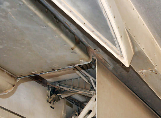

Hubert Boillot Posted July 7 Posted July 7 (edited) Good that your could rein in your printers, Dan. Just be careful about the under- and over-wing fairings for the main undercarriage bays: they had sharp edges and right angles to the wing surface, and their surface was « flat » (or more rightly, parallel to the wing surface), not rounded as per the design you are using … Hubert Edited July 7 by Hubert Boillot Rainer Hoffmann 1
Rainer Hoffmann Posted July 7 Posted July 7 3 hours ago, Hubert Boillot said: Good that your could rein in your printers, Dan. Just be careful about the under- and over-wing fairings for the main undercarriage bays: they had sharp edges and right angles to the wing surface, and their surface was « flat » (or more rightly, parallel to the wing surface), not rounded as per the design you are using … Hubert Yes, Hubert is correct. I don't have a photo of the upper fairing, but here is a pic of the lower fairing that shows nicely what Hubert said: I hope this helps. Cheers Rainer Hubert Boillot 1
Dandiego Posted July 7 Author Posted July 7 Thanks guys. Yes the kit as designed has a soft rounded edge to the fairing. Have to see what I can do to get a sharp edge. Dan Rainer Hoffmann 1
