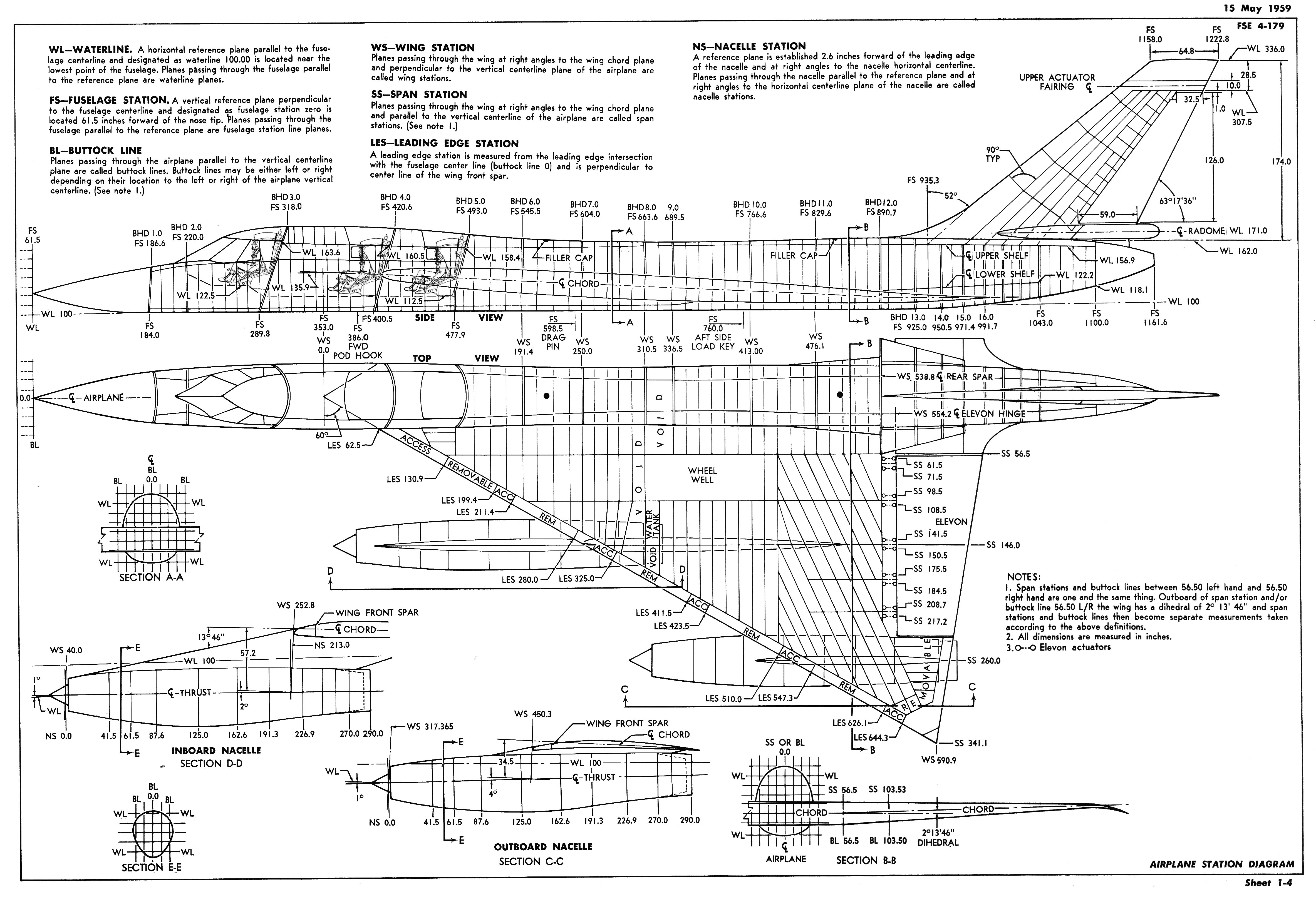

Rainer Hoffmann Posted June 10 Posted June 10 12 hours ago, Hubert Boillot said: Great undertaking, Dan ! And of my favorite jet ever ! There is a paper model in 1/32. I bought it to use it as a template for a scratchbuilt plastic one. Then I chickened out when trying to convert the ejection seats from paper to plastic … That was before 3D-printing was largely available for modellers … I was thinking not long ago of reviving this project … Now you give me ideas … Hubert Well, I even contemplated a 1:24 scale Hustler ... But to build three (almost) identical ejection seats AND four J-79 afterburner cans ... But with 3D printing this seems doable. Anyway, maybe this heips: Cheers Rainer Polecadt, Dandiego, Kaeone57 and 6 others 8 1
Dandiego Posted June 10 Author Posted June 10 (edited) Rainer, even in 1:32nd scale the model will be 36 inches long, can't imagine 1:24th. Ejection seats....When I built Chads F-108 he provided a very similar looking seat. I will print them out and see how they look in the Hustler. J-79 exhaust nozzles shouldn't be that hard to get. Although I haven't looked there are probably some digital files that can be printed out. Cockpits will be another matter. There are 1:48th cockpits out there but they seam to be cast resin, not easily upsized. If I could find someone with digital files they could be printed in 1:32. I can design my own cockpits but it will be quite a chore. Dan Edited June 10 by Dandiego Rainer Hoffmann 1
