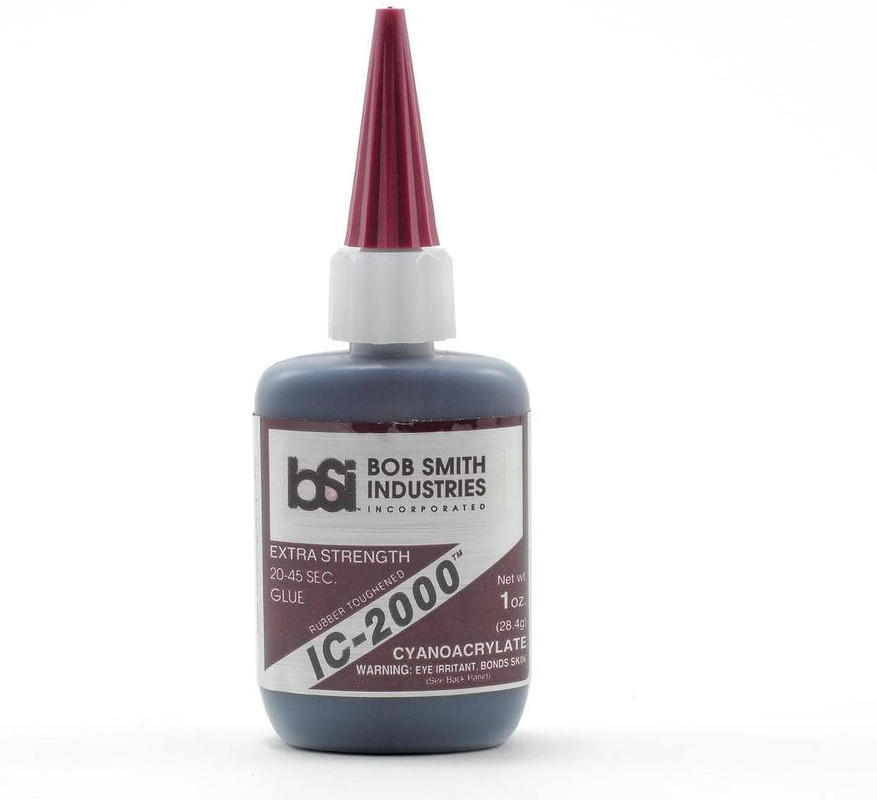

Thunnus Posted May 30 Posted May 30 I've been looking for the perfect filler for a long time and haven't found one. So I use a variety of stuff, depending on the situation including the liquid putties (Mr Surfacer and Mr Primer Surfacer) to the clay-like 2-part epoxies (Milliput and Apoxie Sculpt) and everything in between. Each has its strengths and weaknesses. I've gravitated toward using rubber-toughened CA glue for most of my small to medium gap filling. It's a bit softer than regular CA glue so its easier to sand, sets instaneously with activator but hard enough that you can feather it seamlessly into the plastic surface. You can also scribe over it but it has its limitations, especially if the gaps you are filling are very small. To avoid issues, I typically offset my new panel line slightly off of the filled line so that I'm scribing over plastic, not the fill material. And if you have trouble with fill material chunking off when scribing perpendicular through a fill line, a razor saw often works better than a scriber. This is the CA glue that I use for filling...
