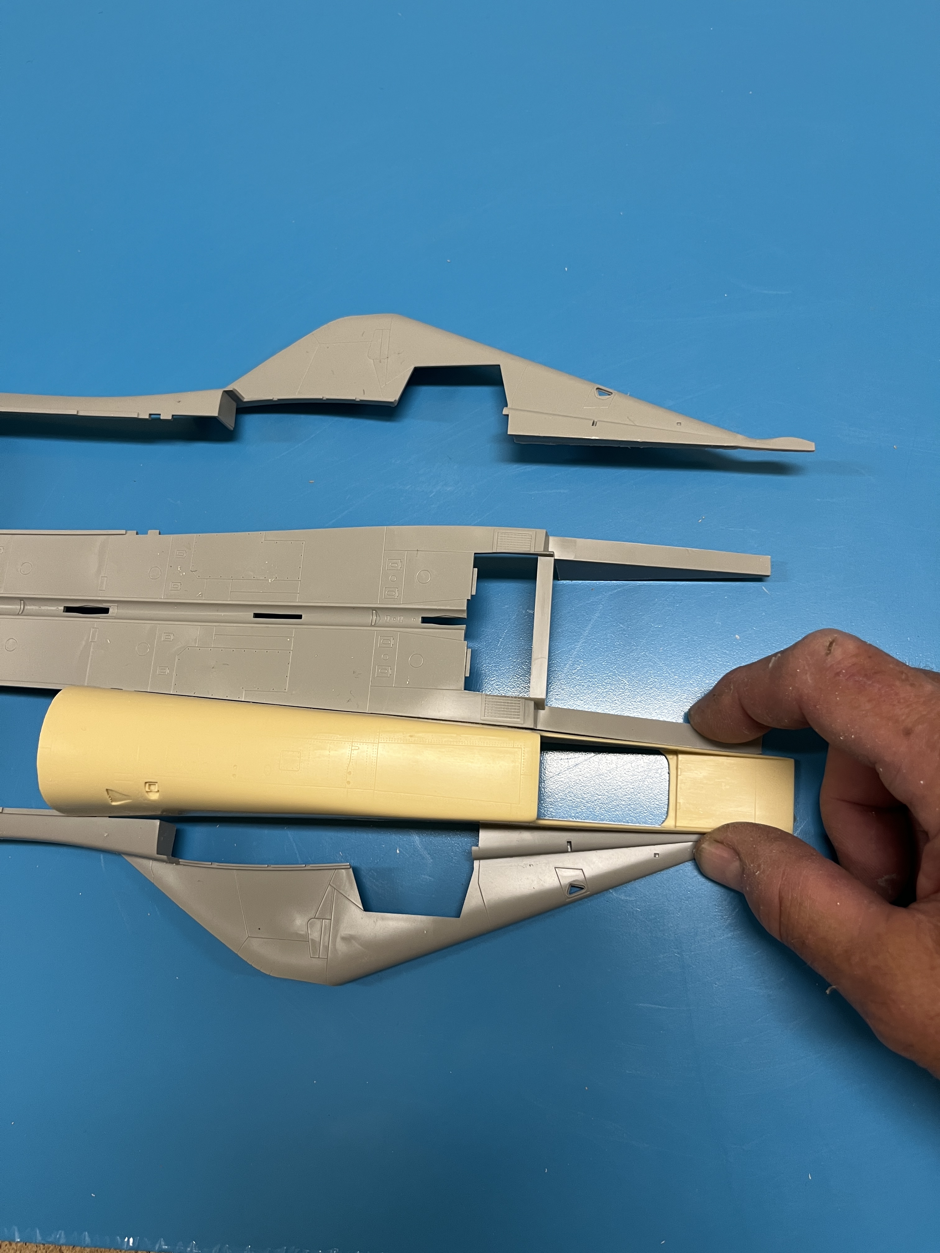

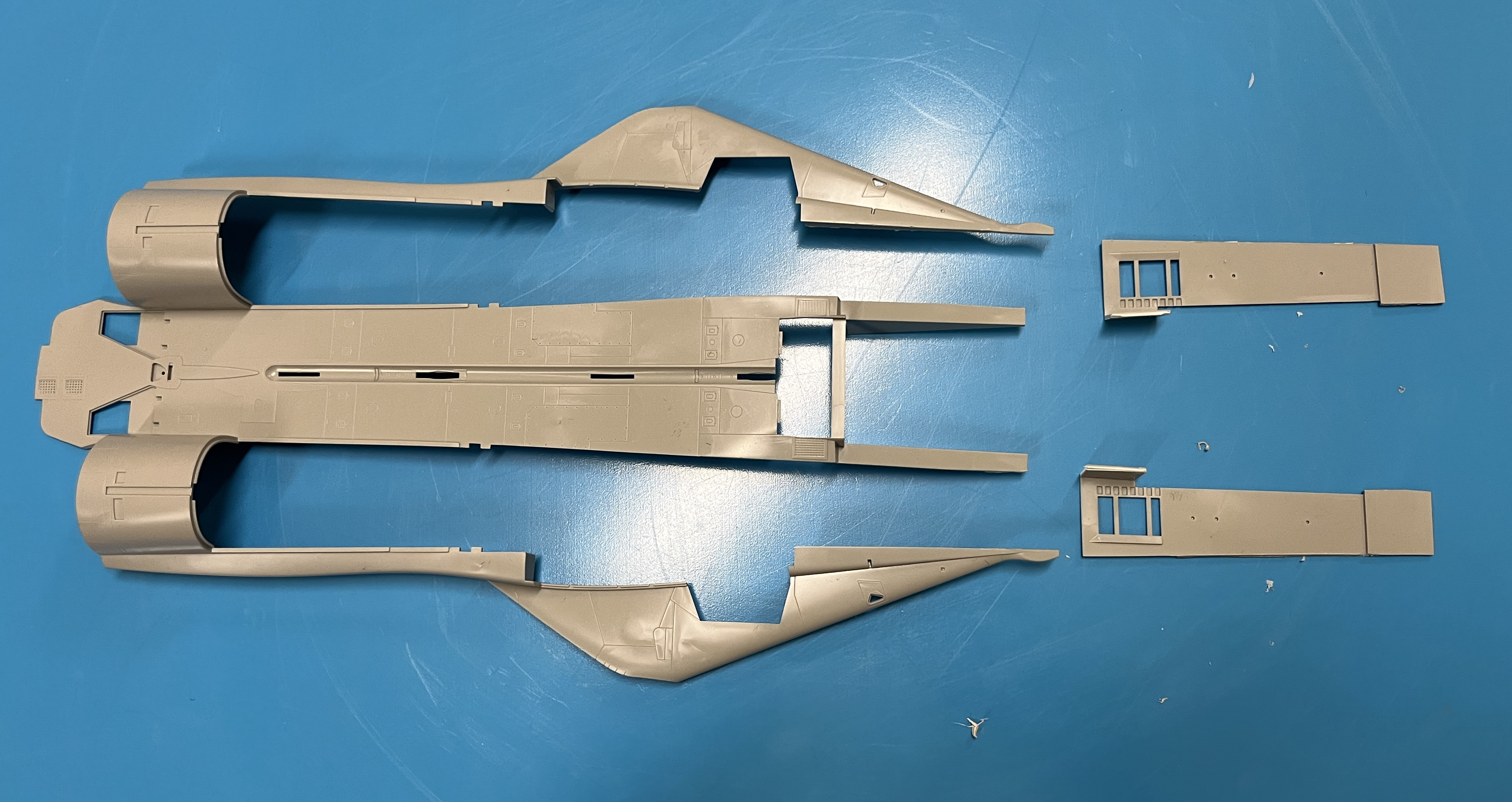

blackbetty Posted June 1 Author Posted June 1 (edited) i started with the intake surgery and glued in the supports with thick superglue for strength Edited June 1 by blackbetty Newoldguy1977, Phantom2, RCPlym and 7 others 10

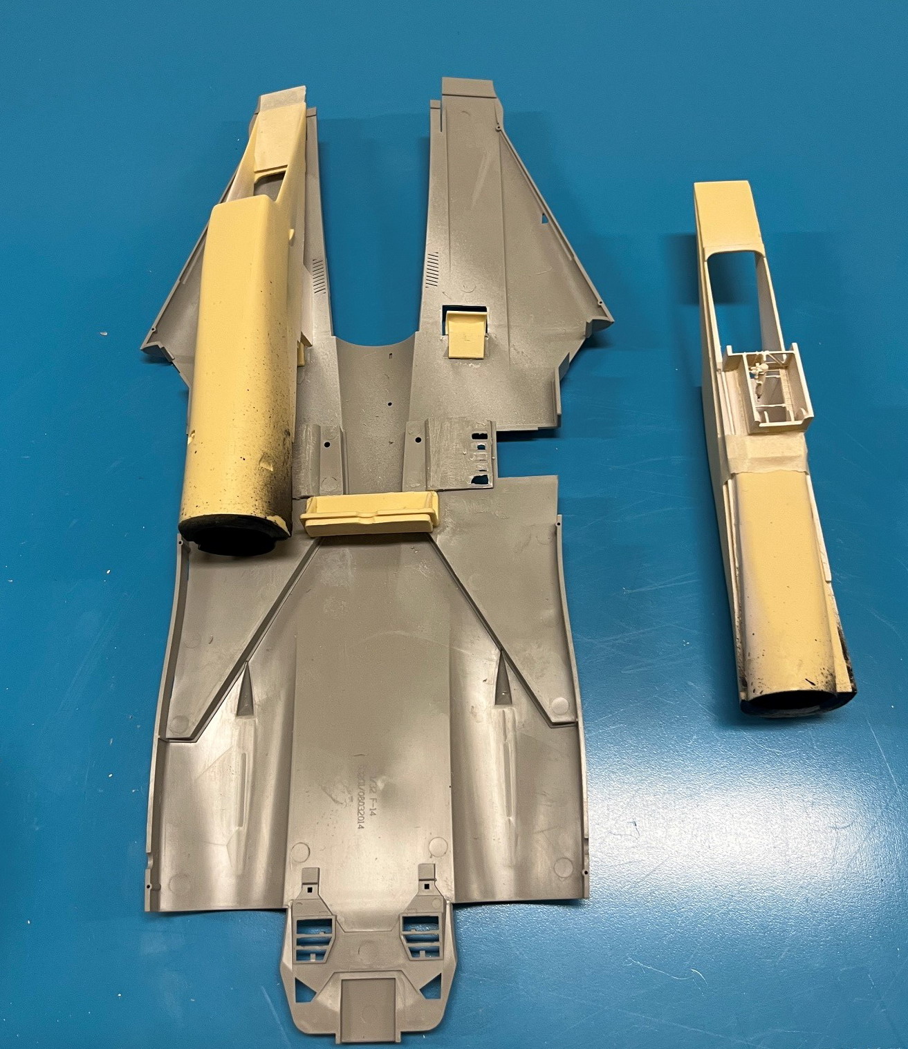

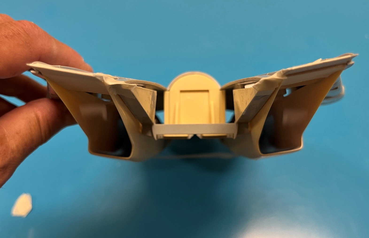

blackbetty Posted June 3 Author Posted June 3 installing the big resin intake is a complcated operation. the lower fuselage is a very wobbly part after one removes the kit intakes, so i attached the fuselage top with tape and used it as a jig. some grinding as per instructions on them is necessary beforehand F`s are my favs, themongoose, geedubelyer and 1 other 4

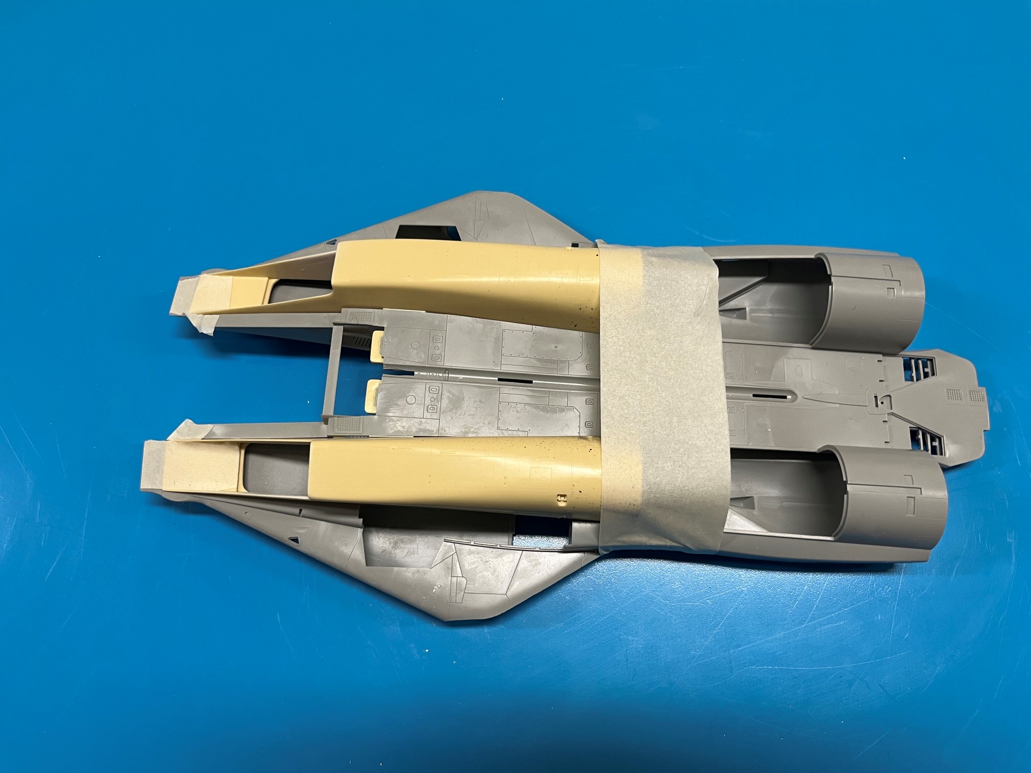

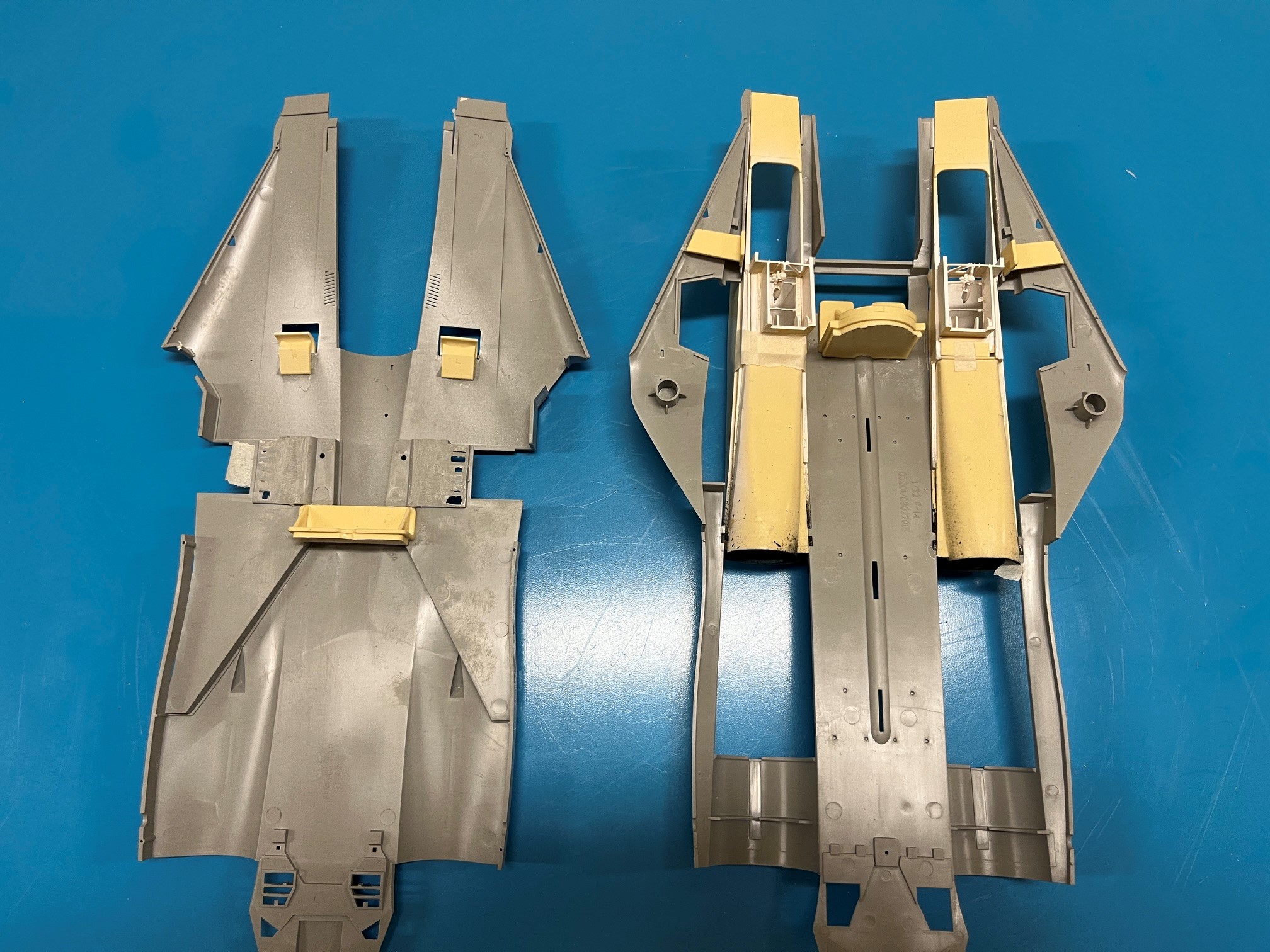

blackbetty Posted June 3 Author Posted June 3 the actuator boxes will be glued to the top of the intakes before sandwiching the assembly between the top and lower part, be careful to not mix up left and right boxes intakes, rear upper part of the intakes and the boxes have been painted white no glue yet denders, Shoggz, Fanes and 3 others 6

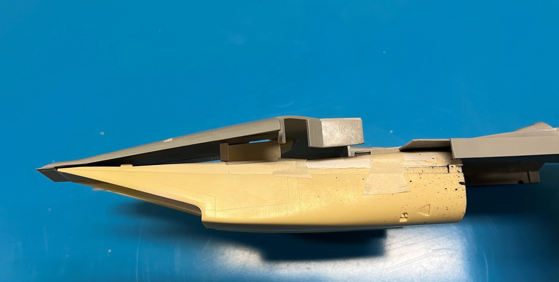

blackbetty Posted June 3 Author Posted June 3 view from the side, fixed with tape themongoose, denders, Newoldguy1977 and 2 others 5

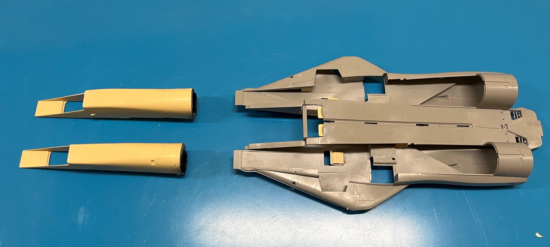

blackbetty Posted June 3 Author Posted June 3 (edited) with the lower part, the small shims (as per instructions) added on the inside, still no glue Edited June 3 by blackbetty Isar 30/07, Shoggz, F`s are my favs and 7 others 10

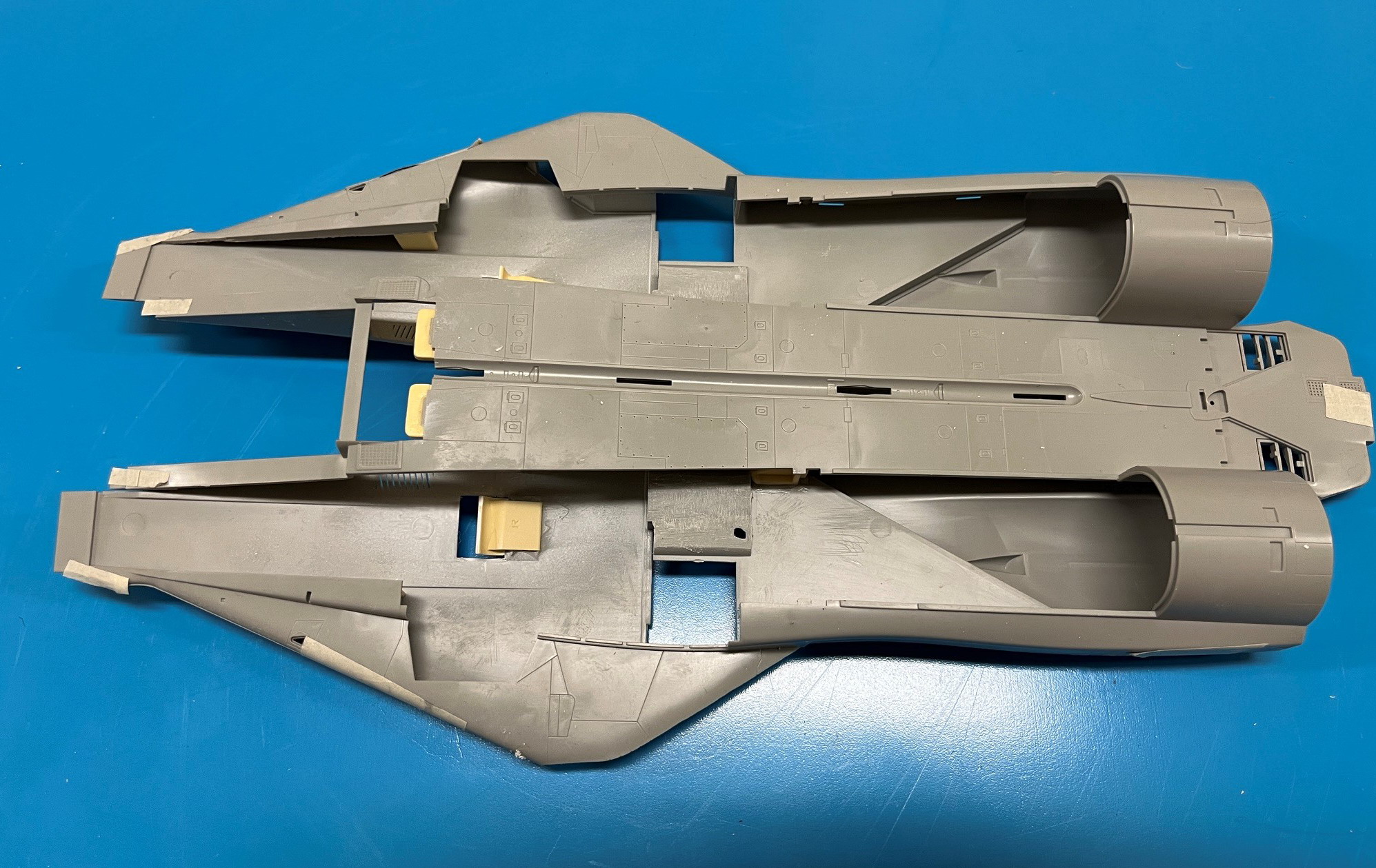

blackbetty Posted Friday at 05:50 AM Author Posted Friday at 05:50 AM the lower fuselage is now glued. i used thin fast acting superglue to attach everything in place and thick superglue to reinforce the parts from the back themongoose 1
blackbetty Posted Friday at 05:51 AM Author Posted Friday at 05:51 AM this view is all that work was for themongoose and csavaglio 2
