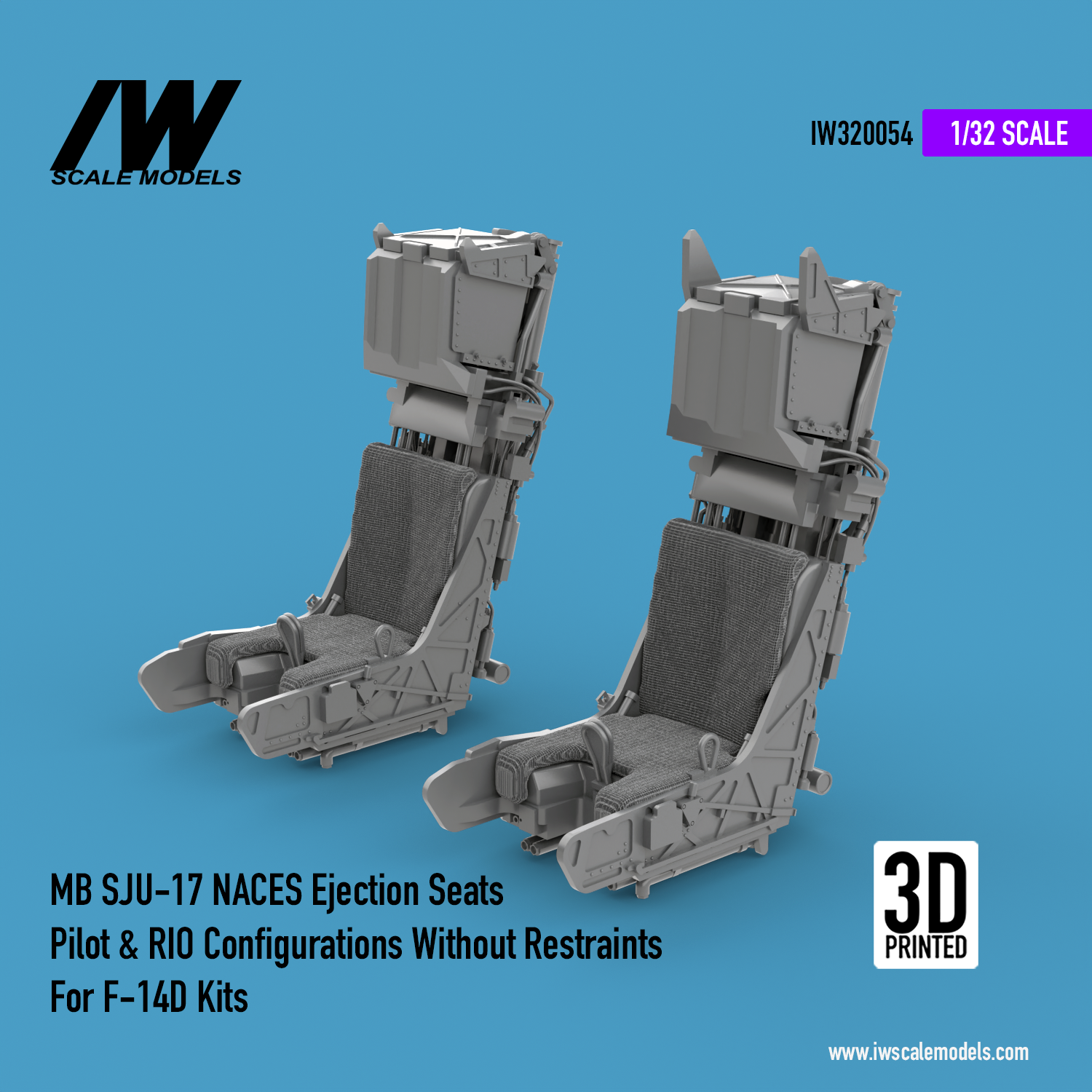

Sadly those nice Aires ejection seats don't fit the kit.  They're a good 2.5-3 mm wider than the kit sets and at least 1 mm too wide for the cockpit tub.  I found a company called IW Models with a new-ish listing for 3d printed F-14D seats that are the same MK14 NACES I need.  I don't know if the Aires seats are too large or if the entire Trumpeter cockpit is undersized, but I took a gamble and ordered a set.  I hope they fit, their 3d renders look incredible.  If not I'll attempt some surgery on the kit seats because they're really just blobs that are vaguely seat shaped.

Replacement seats came in today and my goodness they're lovely.  And the same dimensions as the kit seats so they fit perfectly.  My only complaint is that the ejection handle/loop/thing was filled in.  I guess that's a printing limitation, but mildly annoying that it wasn't a separate part.  I tried to gently open one up with a pin vise but predictably it broke, so I removed them and used the kit's handles instead.

I hadn't heard of IW Models before this but I'll definitely be checking them out in the future.  I also got some exhaust nozzles for the GWH F-15E that's sitting in my stash, they look fantastic as well.  Though I dread handling them without breaking all of those fine details...

One final small detail is whilst the SJU-17 was used on both the F-14D and Super Hornet, the larger canopy breaker “spikes” were a tomcat thing, both forward and aft seats on F/G will have the smaller type as included in those IW seats.

@cairnsy great info!  I am on the hunt for the spare parts from the Growler kit.  I have already started painting the seats but it shouldn't be too difficult to fix the spikes on the rear seat.

The rear seat has had its spikes removed with a razor saw and some bits of sheet styrene adding that will be sanded to (hopefully) match the mini-horns of the front seat.  I went this route because was afraid that sanding and reshaping the original resign spikes would result in them breaking and possibly taking off part of the headrest.
