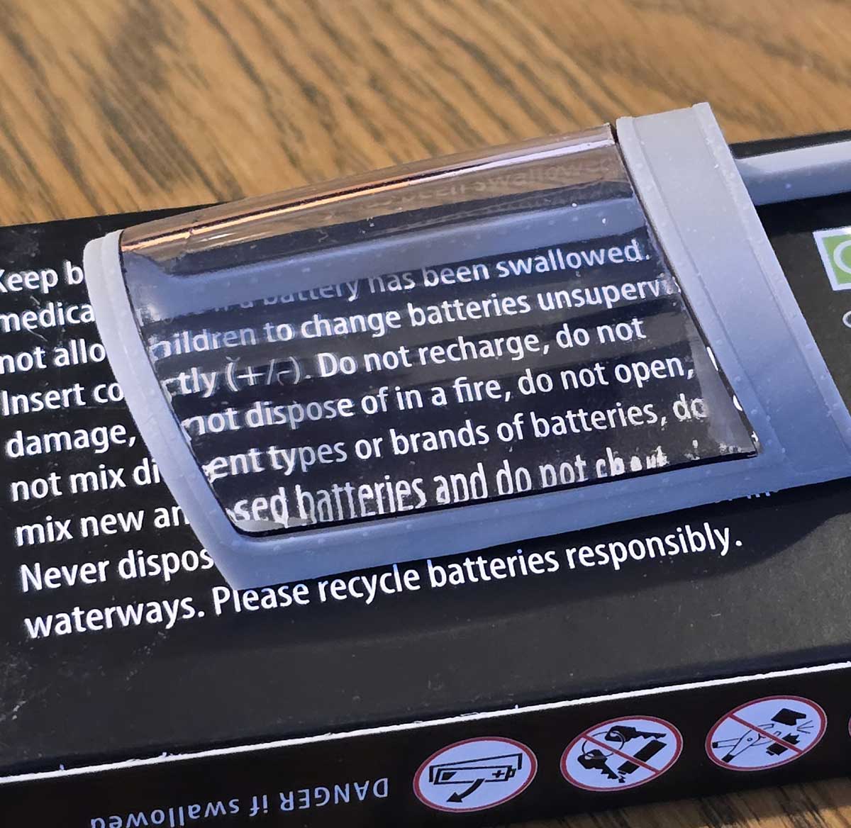

RCPlym Posted April 8 Posted April 8 (edited) 54 minutes ago, JayW said: My question to everyone - what is a really good clear resin? I have used Nova3d high transparency and Resione G217. I dislike both. Formlabs Clear V5 is excellent. I have printed really clear canopies with it. It can, and has, produced optical quality lenses as shown at Formlabs. Also I have tried Inslogic Clear. Very close results to the Formlabs and way, way cheaper. However, as clear results both have given, they suffer with an icy-blue tint on edges when in sunlight. I have tried UV cut varnishes to no avail. Blackening the edges mitigates it a lot, but it is not totally eliminated. In artificial light, there is no sign of it. Image is my first attempt of printing a Voodoo rear canopy. First time I ever printed clear resin... Edited April 8 by RCPlym wunwinglow 1
