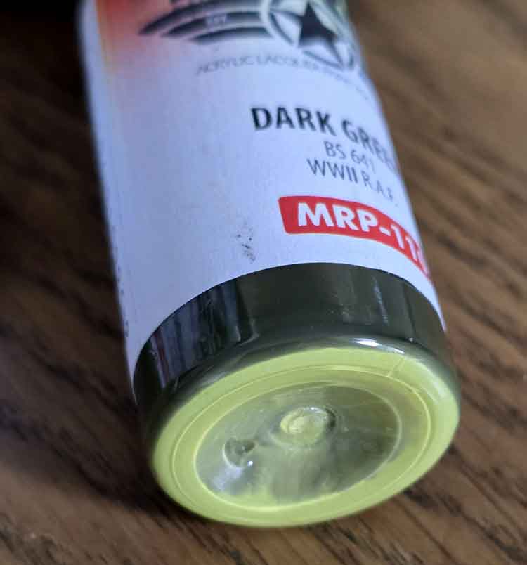

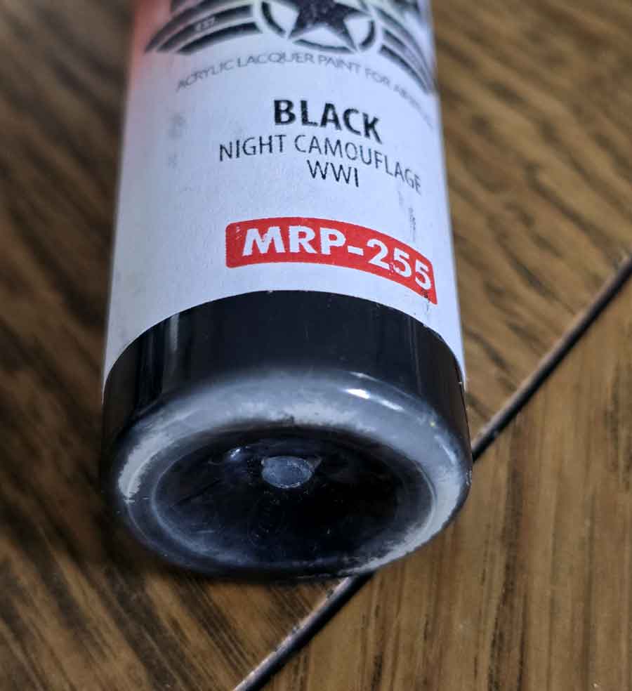

RCPlym Posted March 27 Posted March 27 On 3/26/2026 at 10:55 AM, Maketar Productions said: The pigment settles very quickly, even inside the airbrush during slightly longer painting sessions. I too have noticed this. Yes, the paint has a huge colour range, produces a superb starting finish, but the pigment separating and settling is like nothing I have seen before. I just took out a new, unopened bottle of MRP-255 Black, Night Camouflage and there is a lot of white pigment seriously stuck to the bottom of the bottle. Image is after a good 5 mins vigorous shaking. It was a lot worse prior to shaking. (ball bearings needed methinks!) When airbrushing the green (image below) onto the fuel bowser I am building, I had to stop painting to deal with something for only about 15 mins or so. On returning, I gave the airbrush a quick squirt on card and continued on the model - and lo and behold a spurt of a creamy yellow patch arrived on its surface. Now, to me that means the remaining colour in the cup is no longer it's original intended colour. For me that's no great issue, but for those that are OCD on colours, that could be a serious issue. Every bottle of MRP I have (well over £150 worth) behave the same - the image is of MRP-110 Dark Green that I last used at 11:30 yesterday evening. No other paint brands I have used has the issue.
denders Posted March 27 Posted March 27 Well, every paint type has its quirks to deal with. I've used MRP (most), Hataka, SMS, Tamiya, and RC. I'm not sure I've used any Mr. Hobby. I still like using lacquer based paint over water/alcohol based paints. I find that most/all lacquer paints have the settlement issue and require extra shaking if they've been sitting for weeks or months. I've also found that once they have been mixed up well after sitting for long periods, if I'm using that particular color several days in a row, it mixes up rather quickly. MRP are thinned more than the other brands, there is in reality less pigment in the mix, so I believe that the settling is more easily noticed. And the paint lines with more pigment in them, if they aren't then thinned like MRP, take more of an effort to clean out the airbrush too. Everyone has their preference.

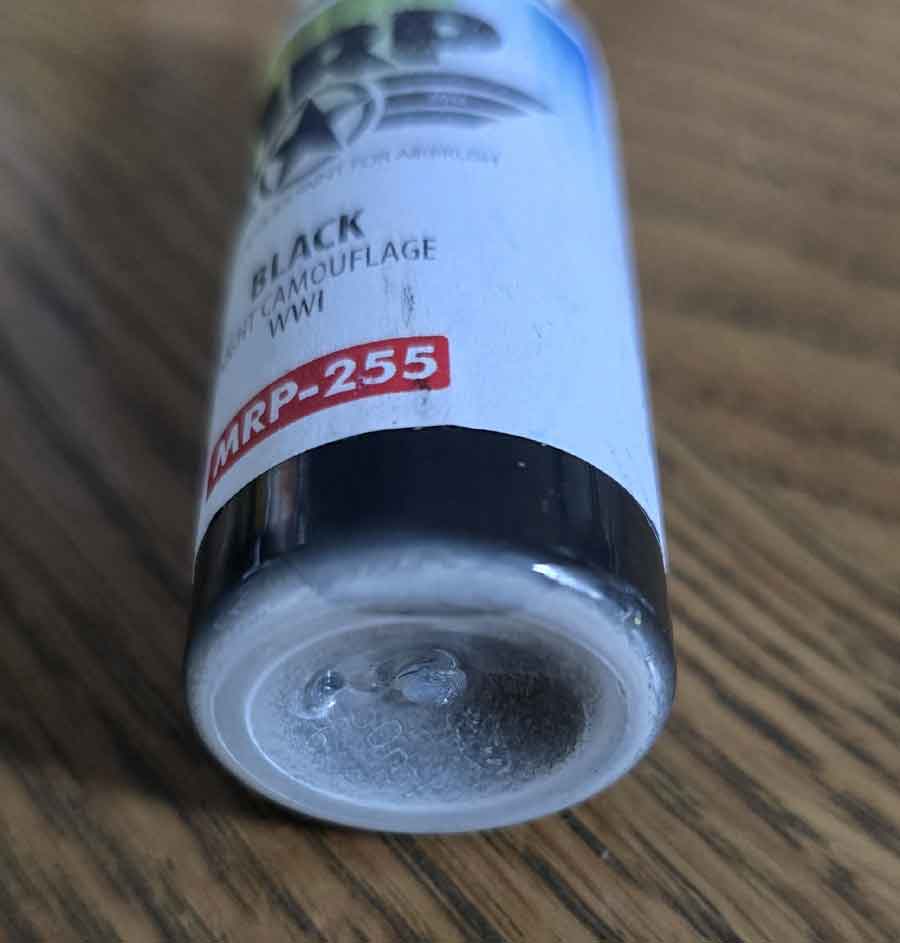

RCPlym Posted March 27 Posted March 27 Same bottle of black just over 3hrs later. I shook the living daylights out of the bottle until all the white had gone and then let it stand. That is normal for this stuff?
denders Posted March 27 Posted March 27 (edited) Yup! It won’t take as much effort next time. If next time is not a month from now. Remember, there’s more thinner in the bottle than you’re used to in other paints. Edited March 27 by denders
RCPlym Posted March 27 Posted March 27 57 minutes ago, denders said: Yup! It won’t take as much effort next time. If next time is not a month from now. Remember, there’s more thinner in the bottle than you’re used to in other paints. The paint separates in minutes - read my post above where the creamy yellow came out of the airbrush after it sat for about 15 minutes. That will have caused colour change from the paint remaining. As an aside, I have used Real Colors Lacquers and thinned them with levelling thinner and that didn't separate overnight. Never has it with Tamiya Lacquer I have used either. I have stainless steel bearings (which I believe were included when MRP was first on the market?) on order to cure the separation in the bottles and lesson learned about leaving the paint in the brush unattended for any length of time... Shame it misbehaves like this as the general usability and finish is great and reading elsewhere it seems the issue is normal behaviour of the paint, plus once I get building properly a bottle won't last a day anyway!!! (Border and HK Lancs will take a few bottles! 🤣🤣🤣🤣 )
