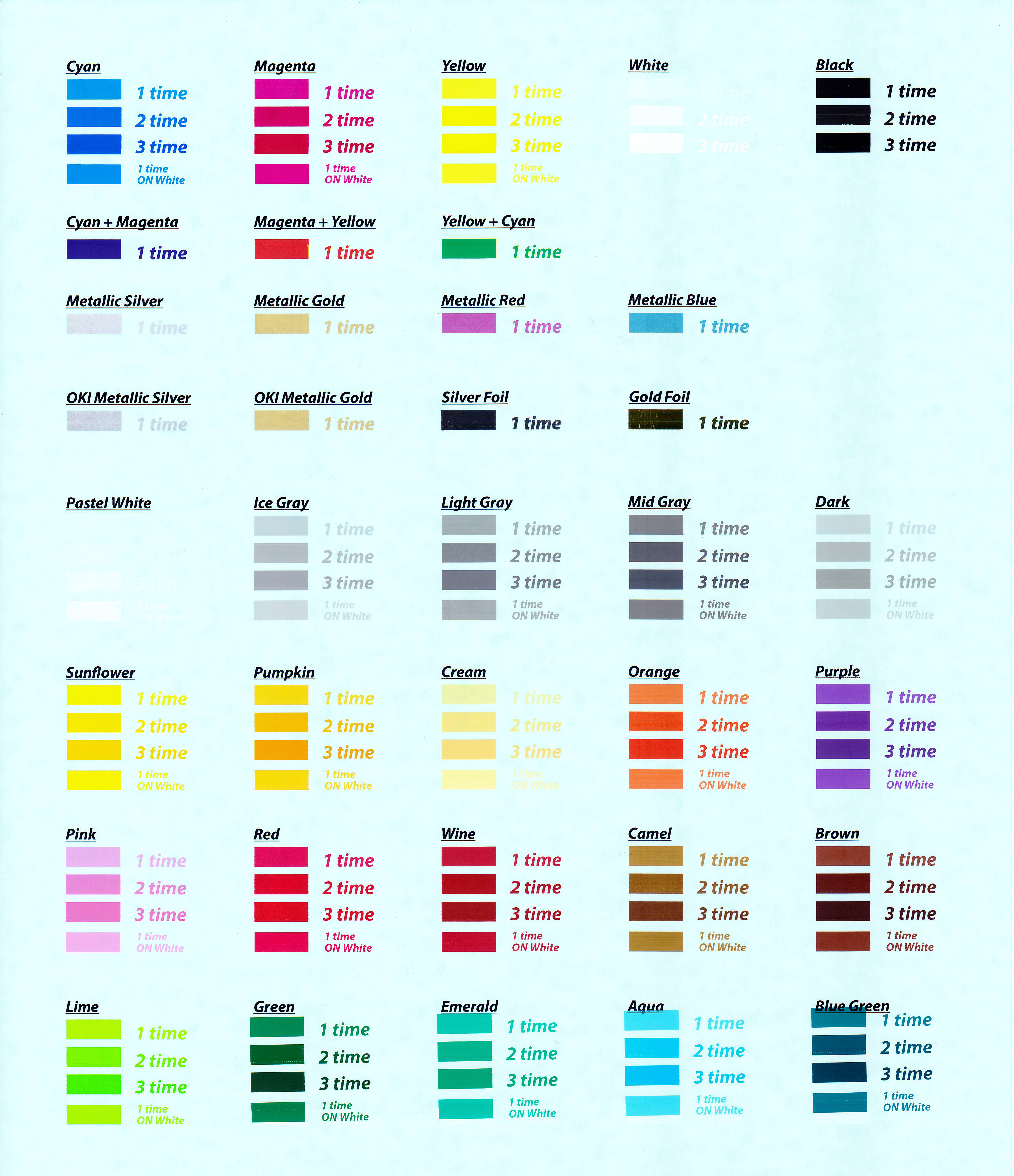

JayBee Posted 14 hours ago Posted 14 hours ago On 3/1/2026 at 4:27 PM, Juggernut said: I design and print my own decals using Adobe Illustrator and an ALPS printer which will print white, silver, and gold in addition to the 16 million range of colors common to other printers. The Achilles heel of the ALPS printer is that the color mixing is not internal to the machine. It “dithers” the five colors in its cartridges to create the desired color. From a distance, 12” or more, it looks fine but up close, you see the dithering. In other words, up close you see the tiny dots of the other colors the printer used to arrive at the desired color. Not good for a decal. You can fool it with some colors but not for most. To solve the "dither" problem the best way is to use the "spot color" option in the printer settings and a 100% black colored artwork For warm yellow, grey and orange and other colors there are different spotcolor ink cassettes available at Elephant Rocket (Japan) Yes, they are expensive, but they greatly expand the possiblities of dither free color prints. All colors are spotprinted on this sheet without dither. In the upper row the typical ALPS inks are used From the middle to the bottom (Pastel White to Blue Green) the Elephant Rocket inks are used. Rainer Hoffmann 1
