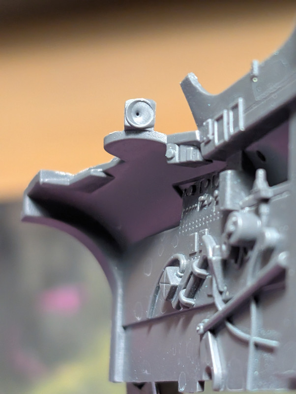

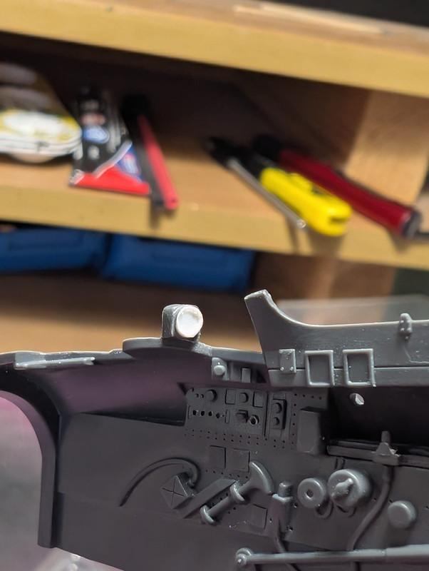

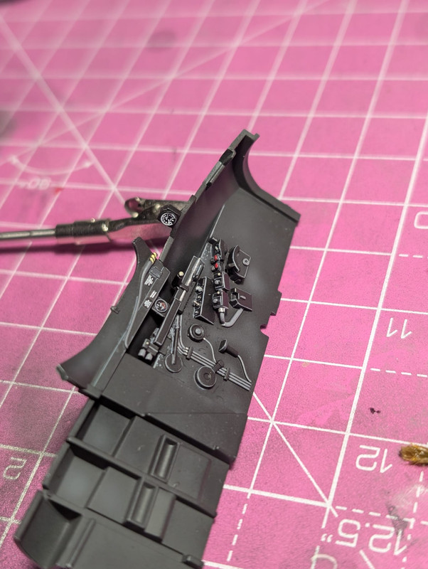

Breaker Posted December 24, 2025 Posted December 24, 2025 (edited) I've made a start on the new Revell Meteor. I've got ups and downs with it so far. The detail is outstanding but some of the molding has required a bit of attention. I've got sink marks in some awkward spots and my ejection seat came broken. I was struggling to figure out how I was going to paint a black on black cockpit, so decided to fully complete a sidewall to set my process up for the rest of the pit. That's almost entirely kit, there's just two ANYZ style switches added in one area where I felt it was lacking a bit. I'll update with some other photos shortly. Edited January 4 by Breaker Anthony in NZ, GMK, Victor K2 and 14 others 17
geedubelyer Posted December 24, 2025 Posted December 24, 2025 Crikey. That looks good. You've done a splendid job of picking out those details. Thank you for being the trail blazer on this kit I've been looking forward to seeing how it builds up. Eager to see more.

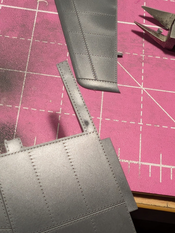

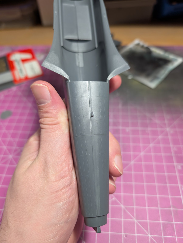

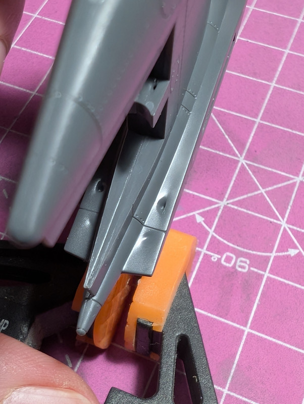

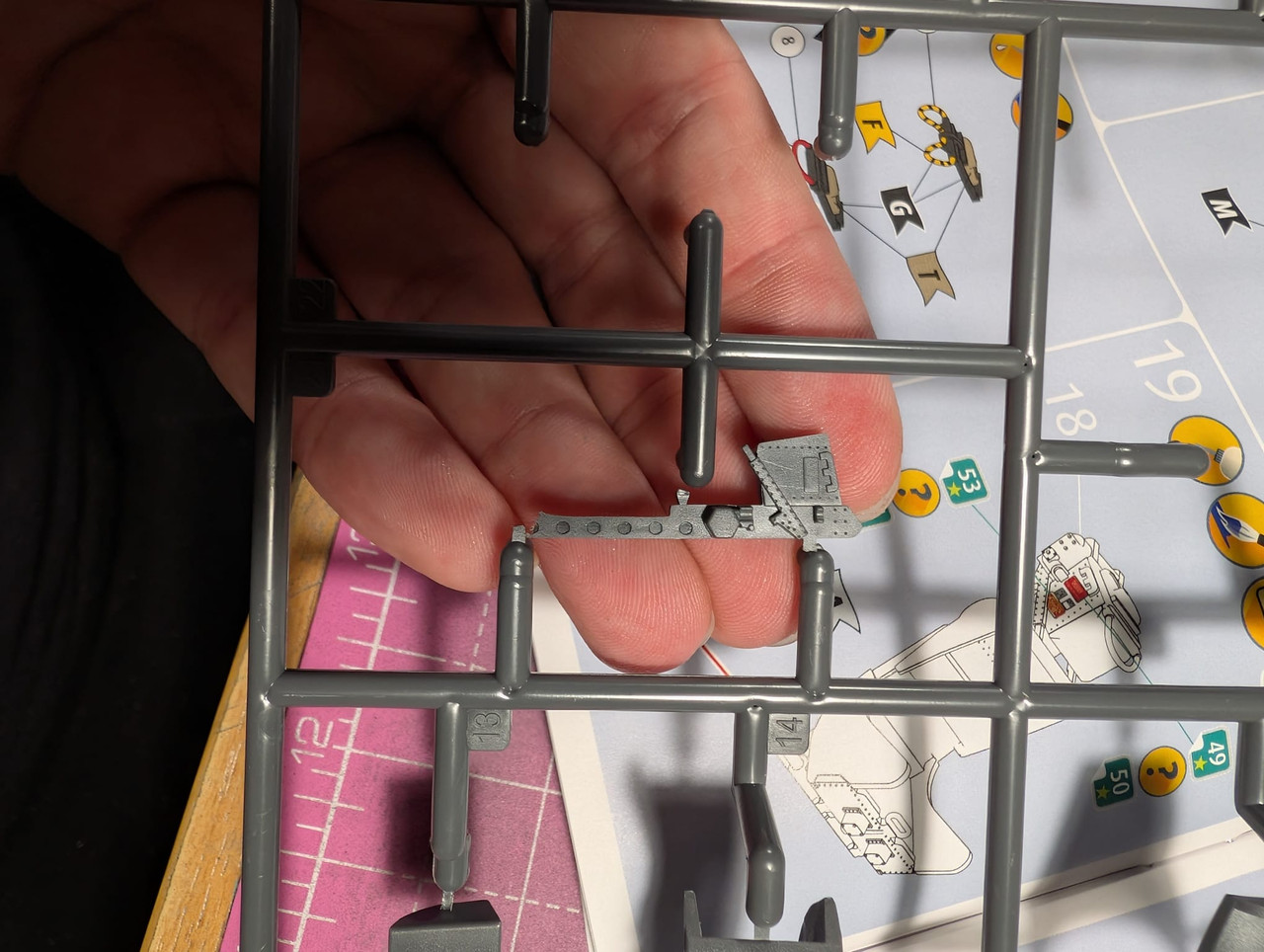

Breaker Posted December 24, 2025 Author Posted December 24, 2025 Somewhat awkward sink mark in the cockpit. This occurred on both side but the s'board side was the worst. The two fuselage halves have a heavy seam to fill and a mold line to remove. Underside of the tail has very heavy sink marks. Broken ejection seat - This isn't short shot, so I assume mine got damaged at the factory as there was nothing in the bags. More sink marks. Shoggz, denders, LSP_Kevin and 7 others 9 1

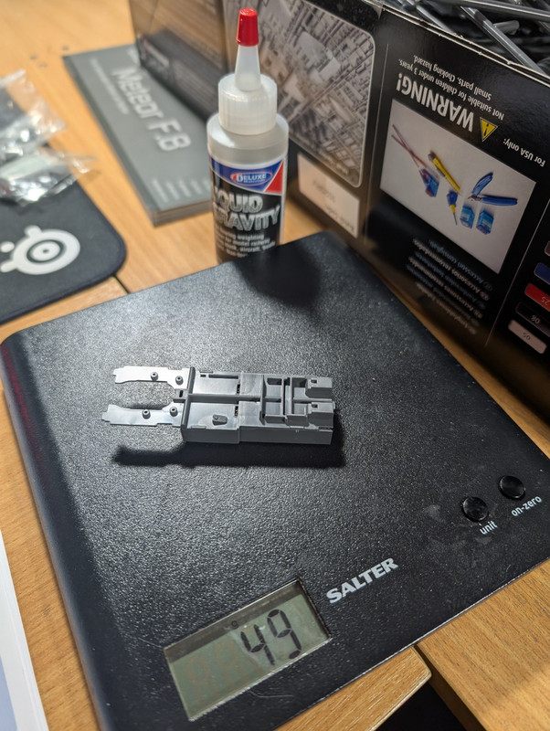

Breaker Posted December 24, 2025 Author Posted December 24, 2025 Revell give you a compartment to add nose weight under the cockpit which is appreciated. Filled to the brim with liquid gravity gives the required 50 (ish) grams. I repaired the sink marks with some punch work and made a new dial and bezel to just glue over the top. I've also drilled some holes for some more switches to give a little bit more pop. You can see how nice the detail is of the cockpit is, miles improved on the HKM offering. Iain, denders, Landrotten Highlander and 6 others 8 1

RCPlym Posted December 24, 2025 Posted December 24, 2025 It certainly appears from the multitude of sinks on the runners to sub-runners in addition to the actual parts, there has been insufficient packing of the mould. Schoolboy error on whoever setup the press. Landrotten Highlander 1

RCPlym Posted December 26, 2025 Posted December 26, 2025 On 12/24/2025 at 6:31 PM, Breaker said: More sink marks. I have just had a quick look at the areas you found sinks and can confirm mine is exactly the same. That does indicate a very well operating press as it is reproducing the issue reliably, so the problem is with the injection profile. Without seeing the tools, I am definitely leaning towards ever so slight underpacking pressure and insufficient cooling to 'close' the gate - another quarter to half a gram on the larger frames where the parts live (the smaller frames don't suffer from sinks) and five to ten sec additional cooling would do the trick and not introduce flash. geedubelyer, Breaker, Uncarina and 1 other 4

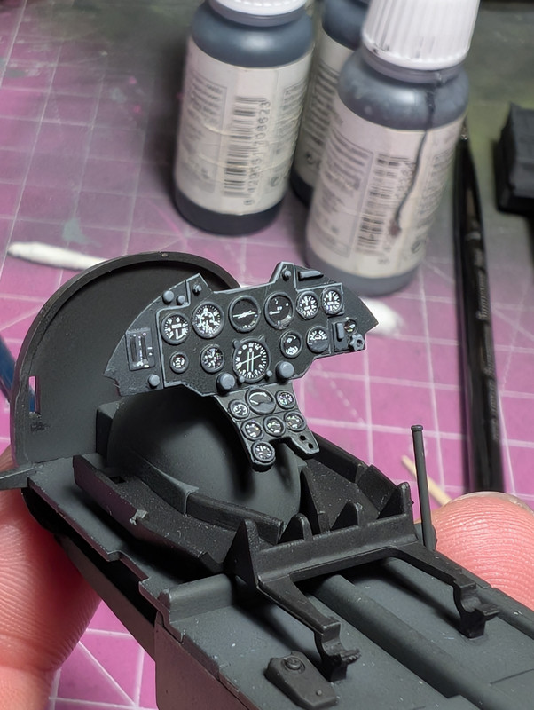

Breaker Posted December 27, 2025 Author Posted December 27, 2025 Revell give you two options (three in the limited edition) for the instrument panel, 1 big decal or individual dial decals. Eduard also have their pre-print photo etch in the limited edition but I hate pre-painted stuff like that, so it's stayed in the box. I'm very impressed with them. They've settled beautifully, fit their positions very well and there's a lot of detail in them. I've added two Anyz nuts to the top of the panel and I've drilled a couple of other switches out ready to receive them. I do think the big knobs either side of the compass could have done with a bit more detail but it's not the end of the world. I may add some levers to the left side of the panel and maybe some other ANYZ switches in a couple of locations just to give it some pop. I've also started using this flat coat and its possibly the best I've used. Waterbased, no smell, no mixing, easy clean up and dead flat for very little effort. geedubelyer, SwissFighters, LSP_Kevin and 15 others 18
