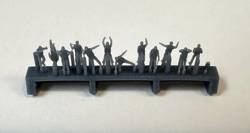

Phil Smith Posted November 25, 2025 Author Posted November 25, 2025 (edited) Got these little guys from ION - "Modern US Navy Carrier Personnel & Pilots." These are great - 3D printed and...wait for it...they are 3D. Easy to paint. Not so easy to glue into place 😃 Edited November 25, 2025 by Phil Smith Polecadt, Iain, Model_Monkey and 15 others 18
