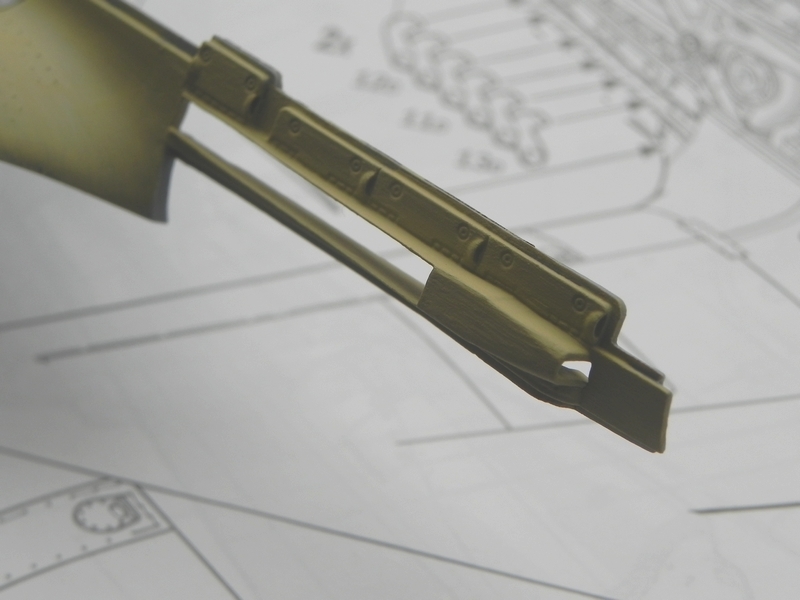

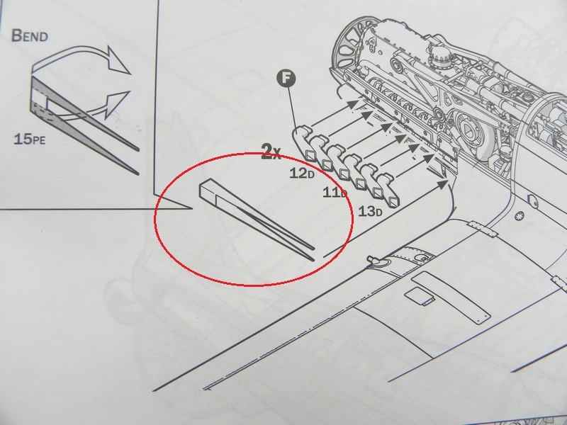

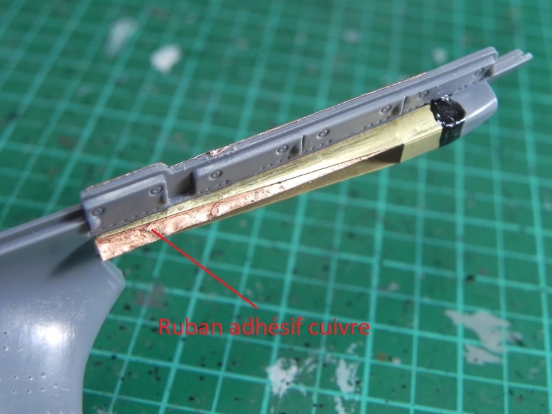

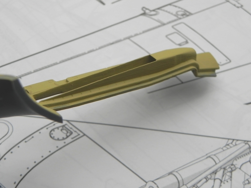

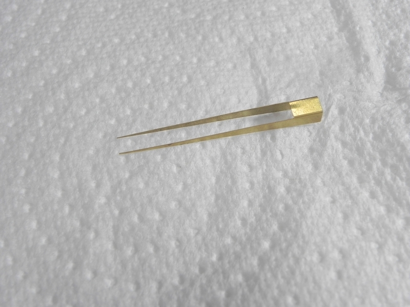

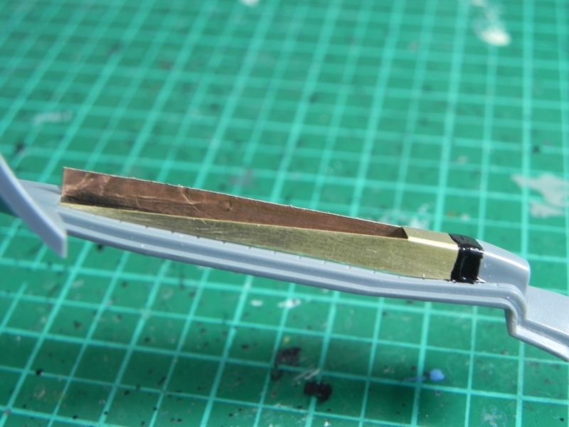

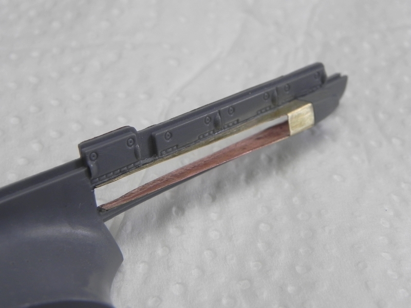

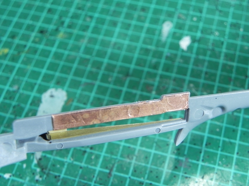

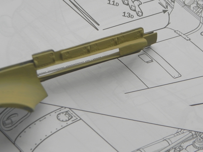

PEYSSON Gilles Posted November 19, 2025 Author Posted November 19, 2025 On 11/14/2025 at 11:42 AM, dutik said: Incredible! What is your real job? Brain surgery? Regards - dutik On 11/14/2025 at 12:29 PM, dennismcc said: Fabulous detail work, way beyond me but great to see. Cheers Dennis On 11/16/2025 at 9:42 AM, nmayhew said: truly wonderful work on a truly awful kit!! There's one on ebay for less that £70, and the 205 is on sale at Jadlam for £69, but the more i read the build reviews, the more i think they should be giving these away, not charging close to what i can get a Tamiya Spitfire for Gilles your detail work is superb - Italeri doesn't deserve you! 🙂 Nick Hello my other friends ! I'm very happy to read your kind messages too 🙂 Sorry for the late reply and my absence from LSP, but in all confidentiality, I am currently spending a lot of time in hospitals due to some health issues ! Nevertheless, I have been able to work on installing the “flame arrestor” on the exhaust pipes. See you soon for the next step guide. Take care. Best Regards Gilles Mal_Belford, Greif8, scvrobeson and 13 others 16

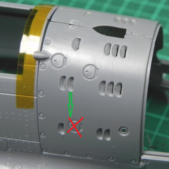

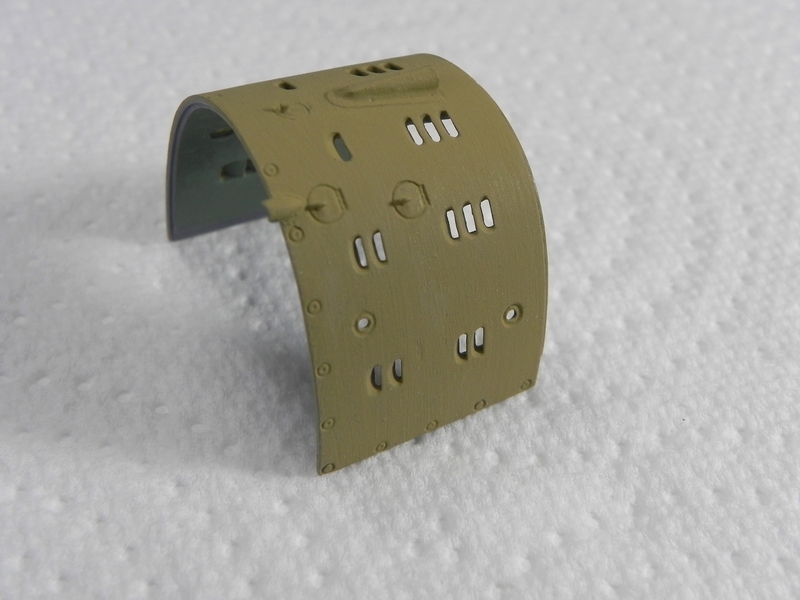

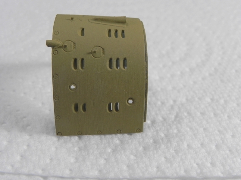

PEYSSON Gilles Posted November 19, 2025 Author Posted November 19, 2025 On 11/6/2025 at 6:59 PM, baffozac said: Hello, great work on the louvres, but : This part of the cowl isn't that of a 202 but that of a 205. Italeri copied the one from Vigna di valle which is'nt completely authentic, the spinner is also not authentic. To correct this part of the cowl, you have to delete this panel and engrave at the place another louvre. All the best ! Good evening everyone I have finished modifying the engine cover. Thank you Baffozac 👍 I hope that is correct because not easy to do ! About the propeller spinner, I am aware of the problem, but I will keep the Italeri one as I have no other choice. ........ at this time !!! Have a good night and Best Regards to all. Gilles scvrobeson, Greg W, TankBuster and 12 others 15
Dpgsbody55 Posted November 20, 2025 Posted November 20, 2025 That's a very neat solution to mounting those exhaust shields. Nice work. Hope you make a speedy recovery. Cheers, Michael

Greif8 Posted November 21, 2025 Posted November 21, 2025 First - I wish you a great report on your health issues GIlles, I will keep my fingers crossed for you my friend. The flame surpressor is fabulous work, from paper on the instructions through perfectly constructed and painted, wonderfully skilled work! And a perfectly seamless engine cover as well, great bench session! Ernest
