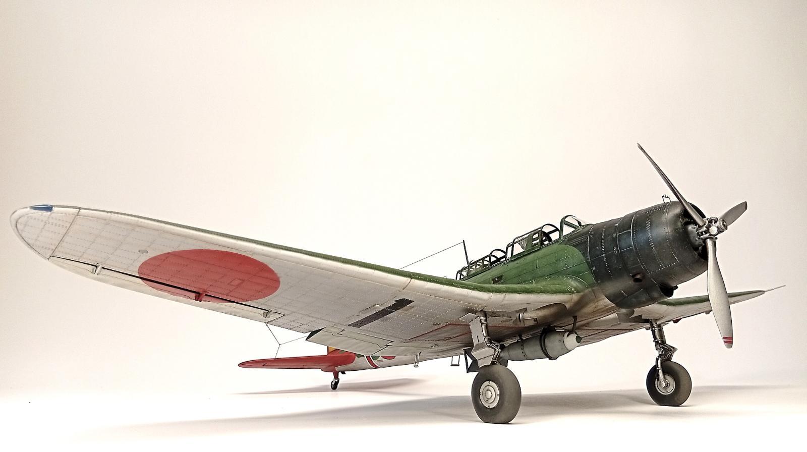

scvrobeson Posted April 24 Posted April 24 Very shiny! What did you use for the gloss coat on it? Matt Sasha As 1
Sasha As Posted April 24 Author Posted April 24 1 hour ago, scvrobeson said: Very shiny! What did you use for the gloss coat on it? Matt Matt lak used this one. The varnish is quite thick; I’d say you need to thin it down to a ratio of one part varnish to three parts thinner. It leaves a decent dry film, and with two coats you get a practically perfect gloss. There’s a little secret. For the second coat, I add more thinner than in the first. It dries to the touch quickly. After a day, you can apply decals, wash, etc. It’s resistant to abrasion and scvrobeson 1
Sasha As Posted April 24 Author Posted April 24 I applied some decals. I liked them; the thin ones adhered perfectly to the surface. denders, RCPlym, Gazzas and 7 others 10
Sasha As Posted April 24 Author Posted April 24 I never managed to find out whether there was a badge on the rear section of the fuselage. In many cases, it had been painted over. I only transferred it to the engine cowling. Whether the area beneath the cockpit canopy was painted in the interior colour is also unclear.

RCPlym Posted April 24 Posted April 24 5 hours ago, Sasha As said: Matt lak used this one. The varnish is quite thick; I’d say you need to thin it down to a ratio of one part varnish to three parts thinner. It leaves a decent dry film, and with two coats you get a practically perfect gloss. There’s a little secret. For the second coat, I add more thinner than in the first. It dries to the touch quickly. After a day, you can apply decals, wash, etc. It’s resistant to abrasion and Is it a lacquer type paint? Thin with Mr color etc. levelling thinner? Sasha As 1
Sasha As Posted April 24 Author Posted April 24 2 hours ago, RCPlym said: Is it a lacquer type paint? Thin with Mr color etc. levelling thinner? Yes, this solvent is ideal. RCPlym 1

RCPlym Posted April 24 Posted April 24 12 minutes ago, Sasha As said: Yes, this solvent is ideal. Super! Looks to be a safe and nice finish. Sasha As 1

Gazzas Posted April 24 Posted April 24 That is a beautiful sheen, Sasha. And the decals laid perfectly... looking very crisp. Sasha As 1

Sasha As Posted May 9 Author Posted May 9 Construction is complete. Thank you to everyone who followed the process and helped out however they could! Coming soon to the “Ready for Inspection” section. easixpedro, denders, LSP_K2 and 14 others 16 1
