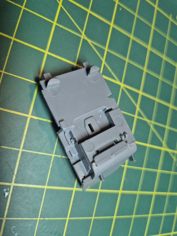

monthebiff Posted July 26, 2025 Posted July 26, 2025 I've been waiting patiently for this one to arrive and when I arrived home from work I was very happy to find it had been delivered so time to clear the bench and get cracking I have a couple of AIMS decal sheets with K-4's on but in the end decided to go for one of the kit options First things first and I have to say the instruction book is just beautifully done with nearly 50 pages printed on really good quality paper and a joy to read, However I was extremely disappointed that this is my third Kotare kit purchase and my third kit to include a damaged/ torn instruction book Very disappointing as it's a high end kit and they seem to have an issue with the bagged sprues catching and ripping the pages. Come on Kotare how about bagging the book with the decals as this is really not good a d takes the shine of unboxing a new kit I have paid my hard earned for! The first few steps cover the decals positiong and painting of the cockpit and are very clear and concise And so on to cutting some plastic and I've got to say it is exceptionally well done with a similar cockpit build sequence as the ZM G-14 which is no suprise since it's from the hand of the same designer. First up is the pilots seat pan with moulded belts and what an impressive piece of moulding it is, super thin with excellent detail and fits the cockpit rear bulkhead like a glove I won't be using the patt with the moulded belts as my painting skills are not up to the job so will use a set of HGW belts The cockpit is a very simple build with excellent fit and minimal parts with some seriously finely moulded details And I can confirm it looks even better with a coat of paint. This has been very well worth the wait, very well tought out and so far a very enjoyable build. Regards. Andy Fanes, dutik, Martinnfb and 41 others 42 2

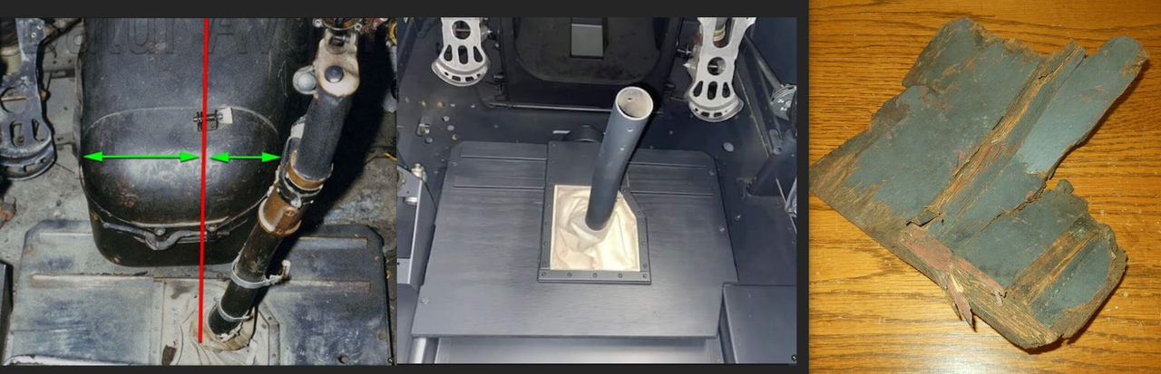

Mark P Posted July 26, 2025 Posted July 26, 2025 FYI...if you opt to weather up the cockpit, the seat pan on the Bf 109 K was made of wood, not metal. Mark Proulx monthebiff, nmayhew, Uncarina and 9 others 9 3

monthebiff Posted July 26, 2025 Author Posted July 26, 2025 5 hours ago, Mark P said: FYI...if you opt to weather up the cockpit, the seat pan on the Bf 109 K was made of wood, not metal. Mark Proulx 4 hours ago, Martinnfb said: Thank you for reminding me Mark followed by a great shot from Martin. The kit parts are pretty good compared to that picture. Regards. Andy denders, Martinnfb and BloorwestSiR 3

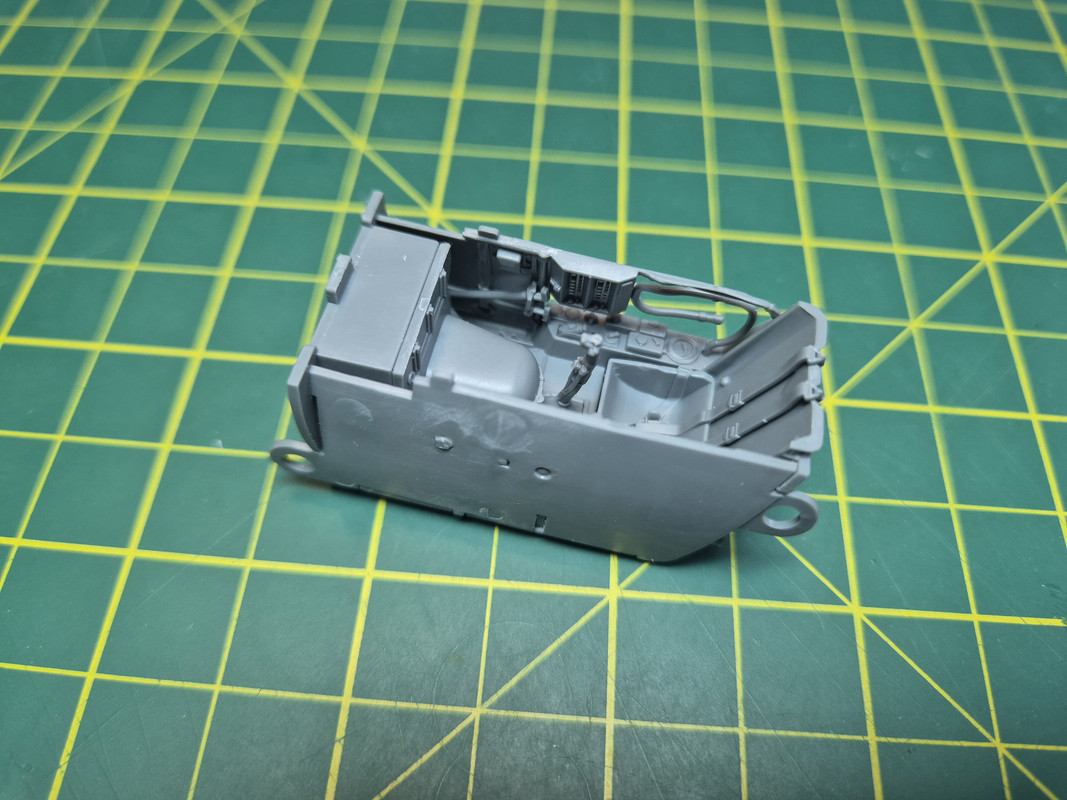

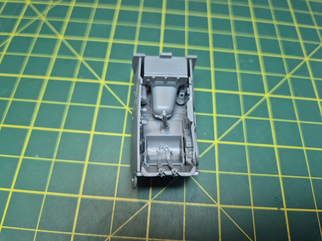

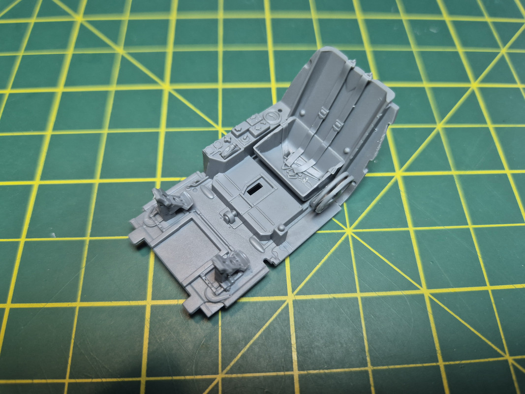

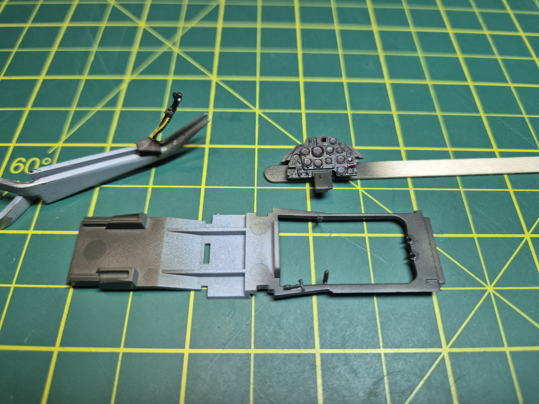

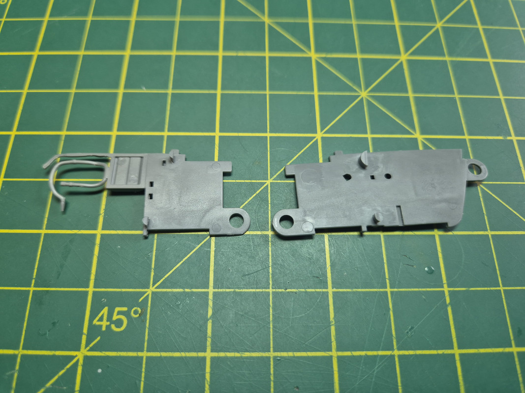

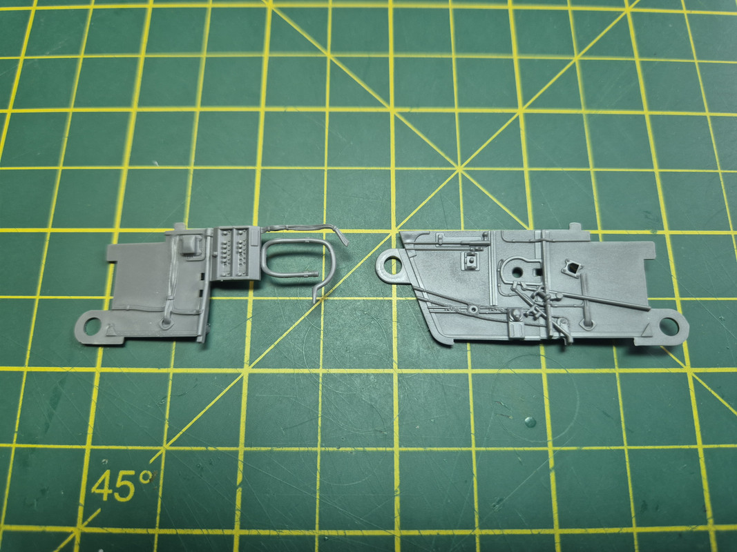

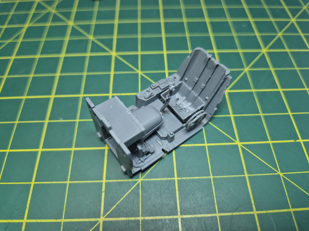

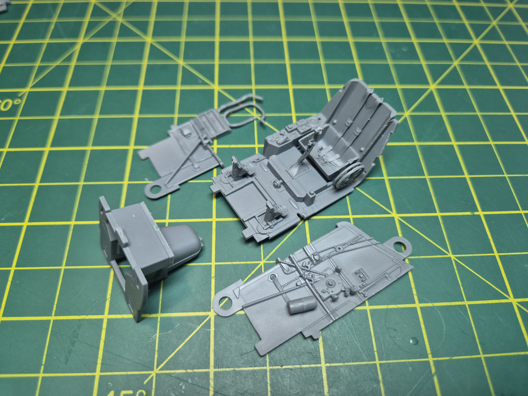

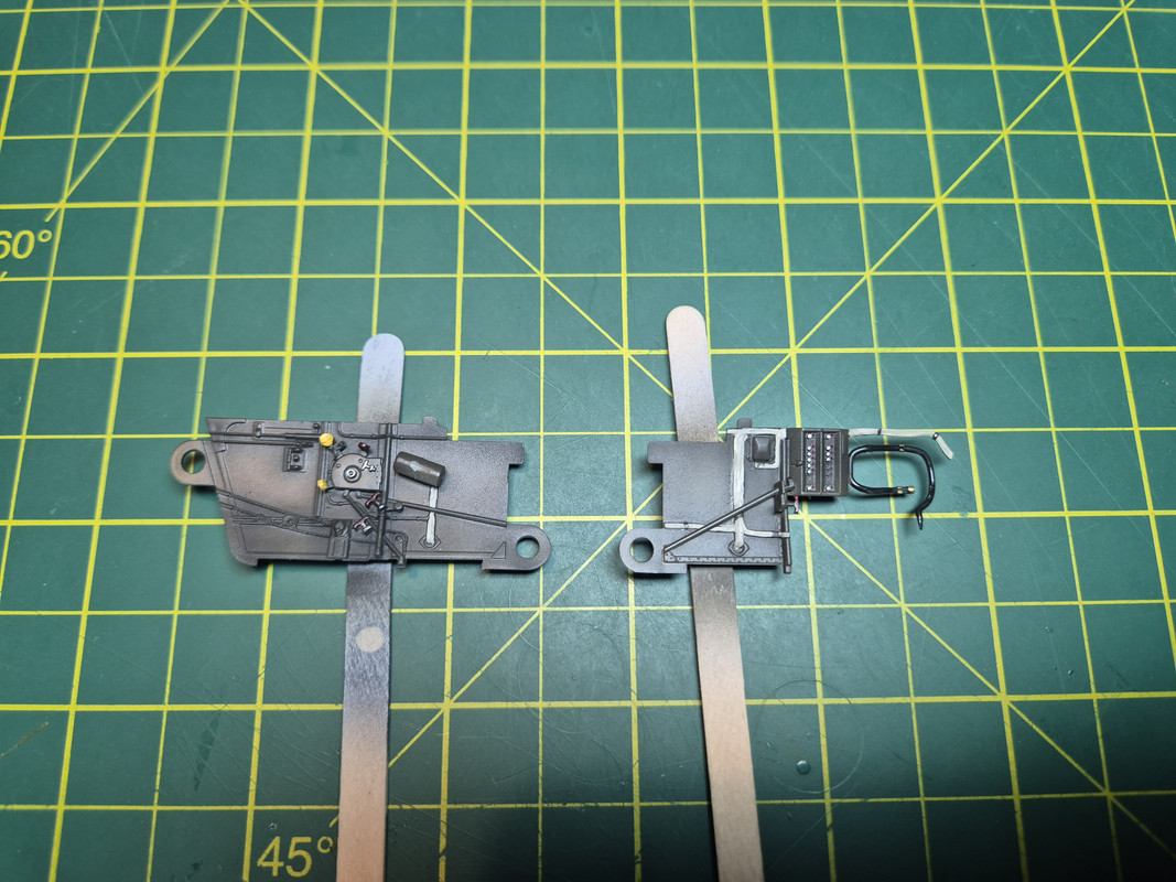

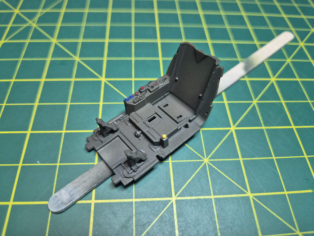

monthebiff Posted July 26, 2025 Author Posted July 26, 2025 So some more done and a test fit of the cockpit main components Fit is excellent and one thing I've noticed compared to their Spitfire kits is the tolerances are not as super tight and makes for a very nice build so far. One quick thing to mention is there are some substantial molding stubs that need removing front the back of each cockpit sidewalls and floor which is not mentioned in the instructions Managed to get some colour on and initial painting completed before gloss coat, decals and weathering I've used AK Real Colors RLM66 (Late) on this one which I've used a few times before on some late war 109 builds. Regards. Andy TAG, scvrobeson, FW190A-5 and 32 others 34 1

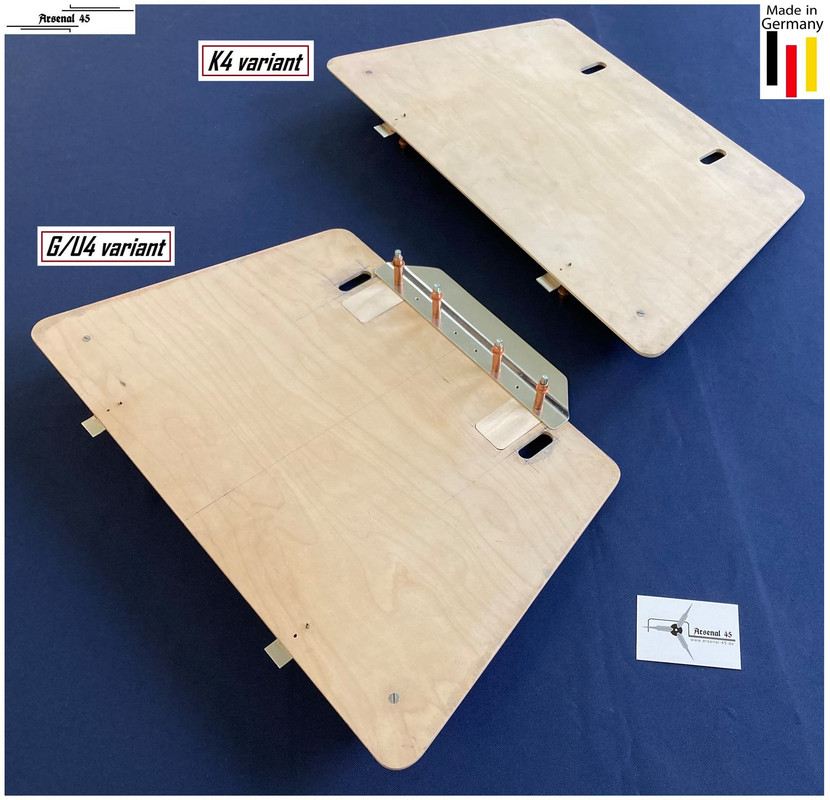

Antonio Argudo Posted July 27, 2025 Posted July 27, 2025 very nice start, to keep in mind also plywood were the rest foot floor and the pilot's compartment door denders, D.B. Andrus, Uncarina and 9 others 12
monthebiff Posted July 27, 2025 Author Posted July 27, 2025 2 hours ago, Antonio Argudo said: very nice start, to keep in mind also plywood were the rest foot floor and the pilot's compartment door Thank you Antonio, was aware of the floor being made of plywood but not the door as well. Regards. Andy Mal_Belford, Martinnfb and Antonio Argudo 3

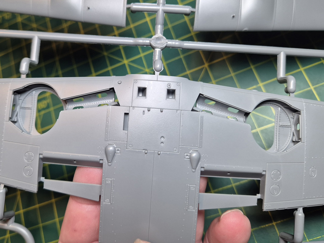

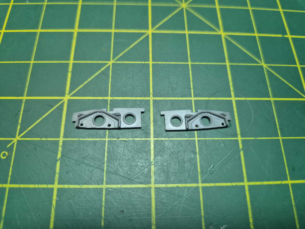

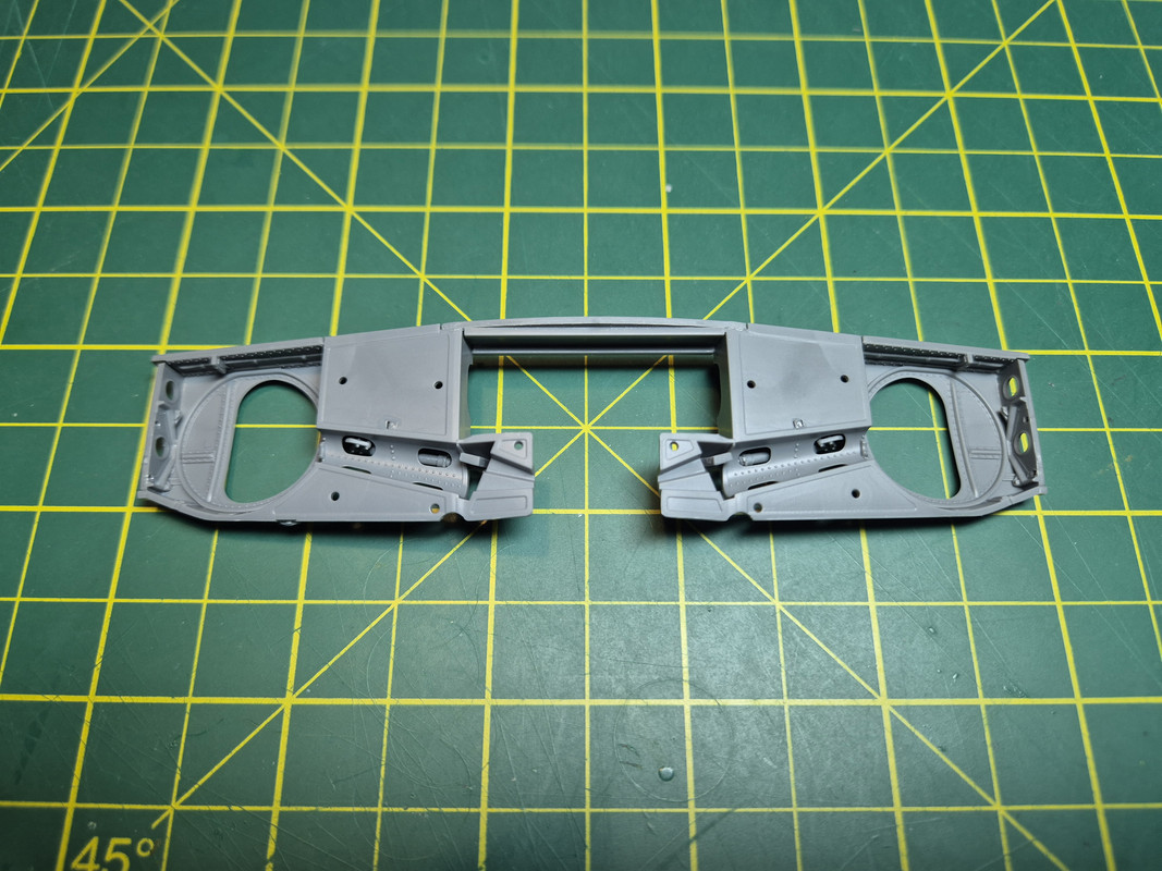

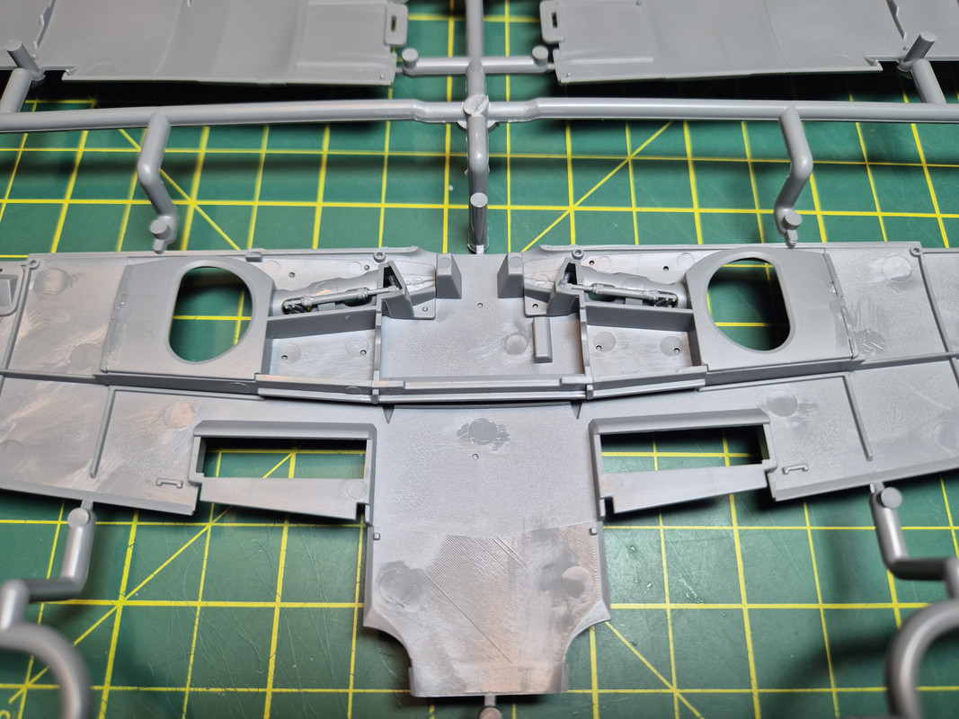

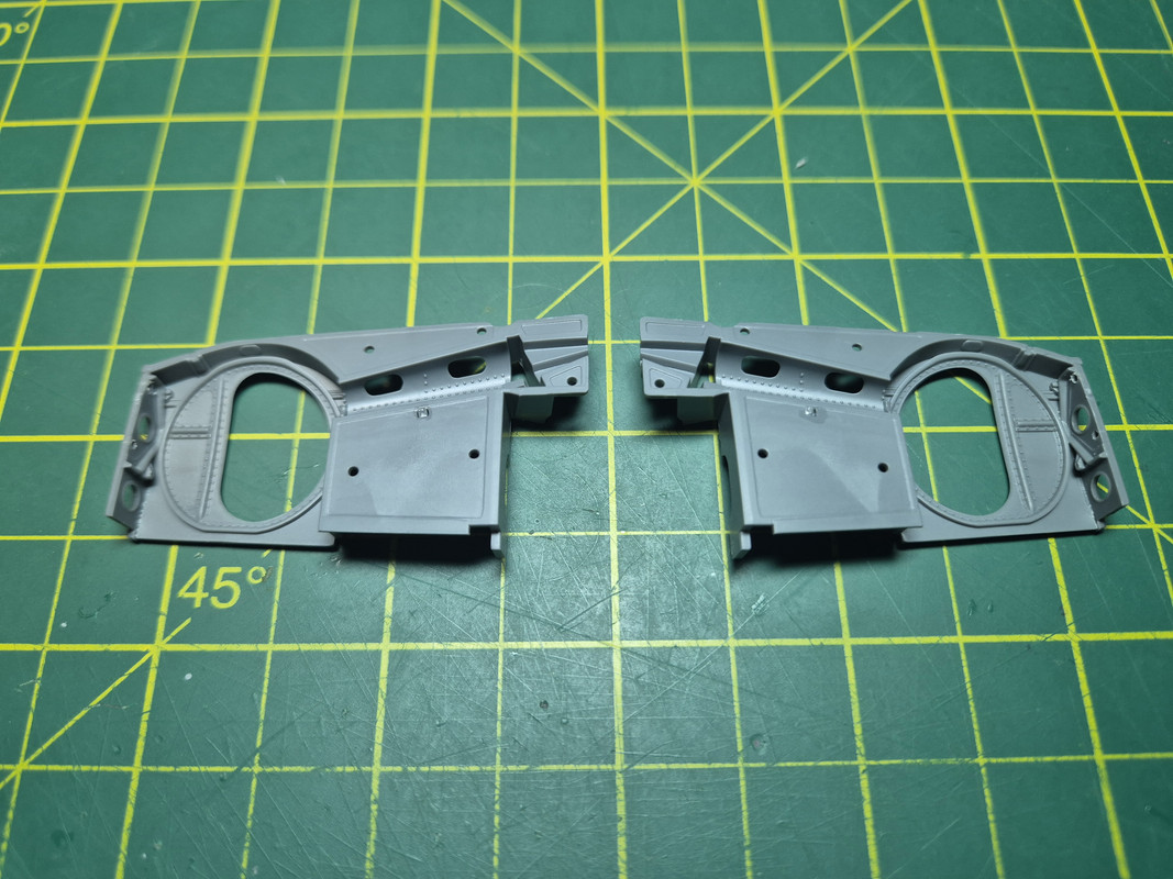

monthebiff Posted July 27, 2025 Author Posted July 27, 2025 I'm really liking the way Kotore have tacked the wheel wells on this kit and kept part count very low a d si ole to build with lovely crisp detail thats just 2 parts with outer wall being the second part, you need to open up 2 holes in each which is for the undercarriage doors The more I look at the sprues the more I see the way they have engineered in extra potential for many more varia t releases down the way just as on the Spifrire range from them. The wheel wells then attach to the wing spar which then just drop in to place on the lower wing Very simple but very effective, and then a view from below Very much enjoying this build so far and I really do hope Kotare expand their range of 109's in the future as the K-4 is magnificent. Regards. Andy Greg W, LSP_Kevin, Paul in Napier and 25 others 26 2
