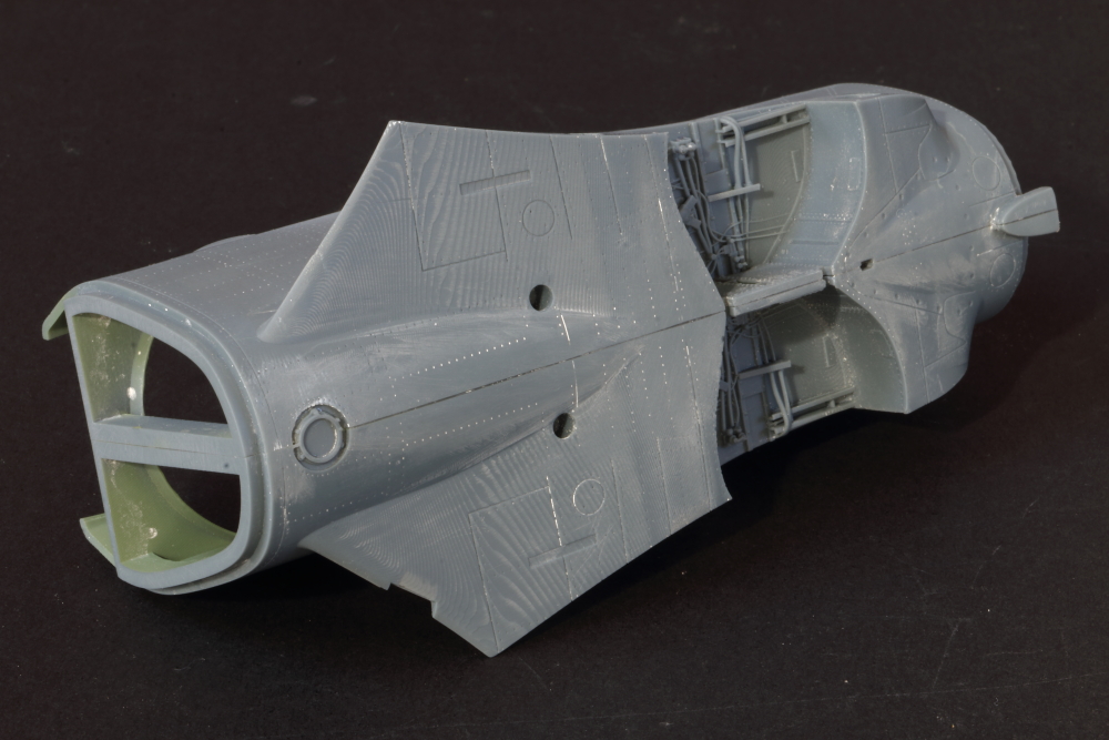

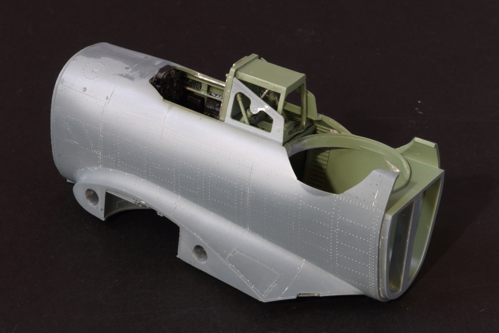

Iain Posted September 12, 2025 Author Posted September 12, 2025 Thanks both - all down to Peter's excellent design skills and eye for detail. I've just done the 'colouring in'... 😁 You could add a bit more plumbing if you really wanted to - but you wouldn't really see it. Fuselage halves now bonded - so another update tomorrow, perhaps. Iain geedubelyer, Greif8 and LSP_Ray 3

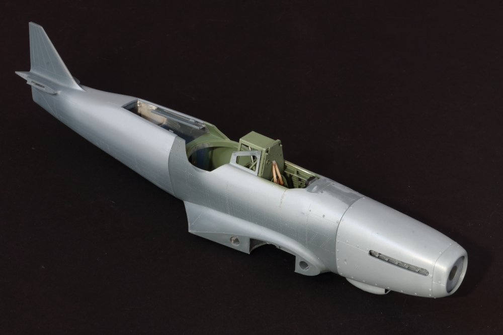

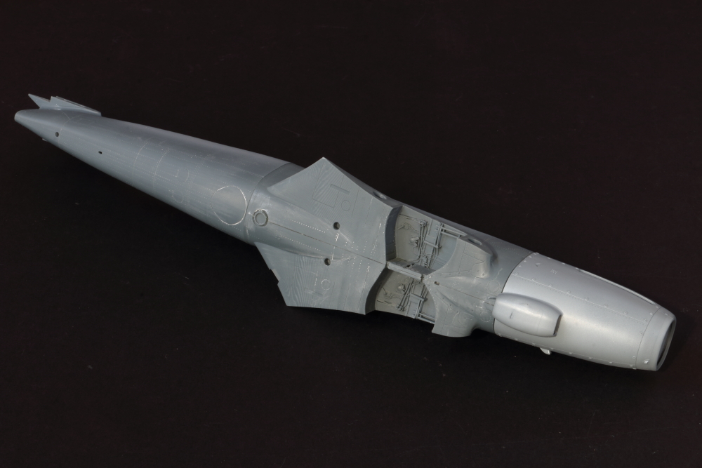

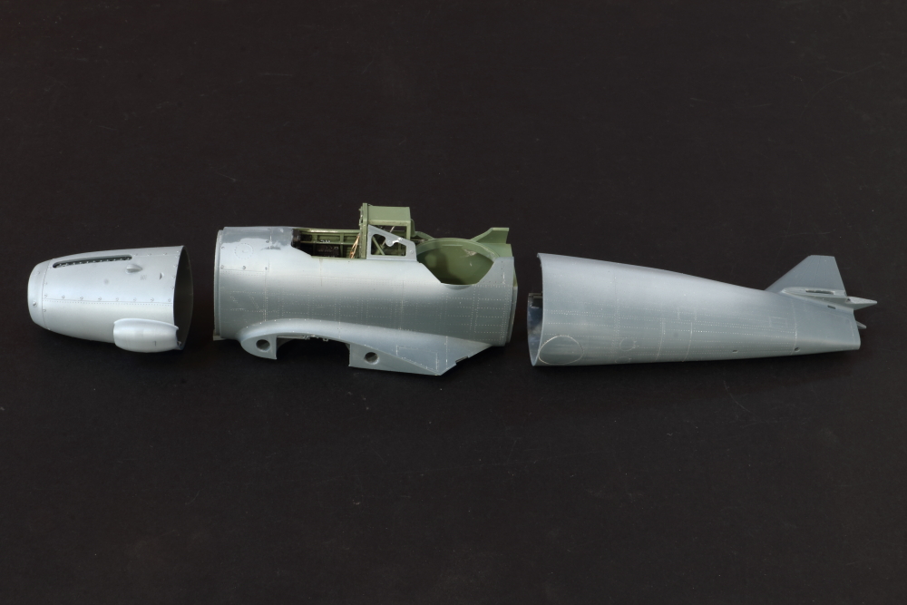

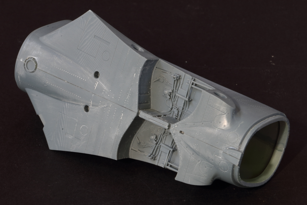

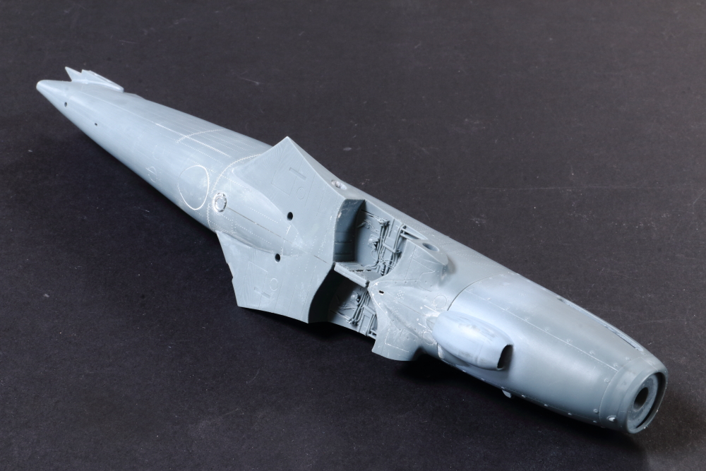

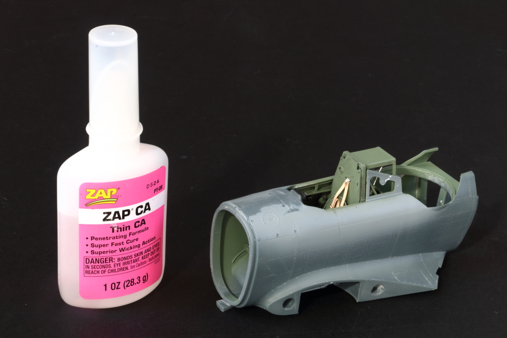

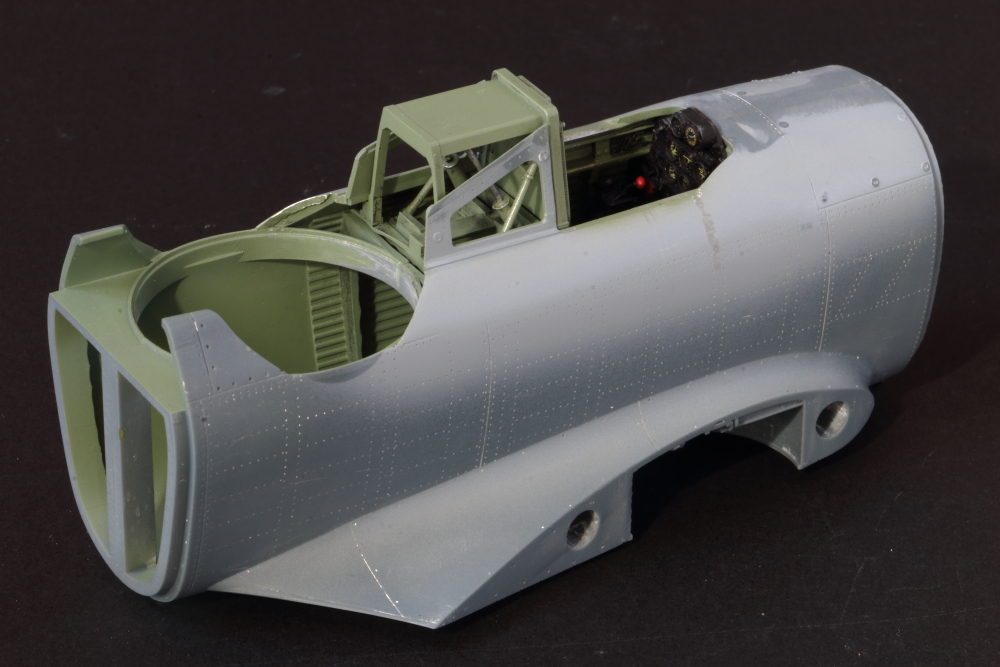

Iain Posted September 13, 2025 Author Posted September 13, 2025 Today's episode is brought to you by the letters Z, A and P - my weapon of choice when it comes to bonding resin parts... The two central fuselage halves have gone together beautifully: I very carefully aligned the two components under a magnifier to ensure everything was in alignment and held together by hand whilst applying 'spot welds' of Thin CA at the corners - so I could re-check alignment before permanently bonding. The Thin CA was then flooded into the joints and allowed to wick through - done in several stages to get the CA proud of the surface and give something to file/sand back into, and ensure smooth joints. A collection of small files, 600, 800 and 1200 grit wet and dry have brought it to this stage: And an important test fit of the cowling and rear fuselage sections - not bonded at this stage - but should be happening shortly... Have fun! Iain Tolga ULGUR, Hubert Boillot, Greif8 and 28 others 31
geedubelyer Posted September 13, 2025 Posted September 13, 2025 Excellent progress Iain. Every time I see one of these being built I have to remind myself that this was the creation of one man and not a multi-national company. You're doing Peter's baby full justice. Well done. Iain and Bonkin 2
dennismcc Posted September 14, 2025 Posted September 14, 2025 Looking good Iain, please tell how did you apply the thin CA to get the complete filling you described. Cheers Dennis geedubelyer and Iain 2
Iain Posted September 14, 2025 Author Posted September 14, 2025 2 hours ago, dennismcc said: Looking good Iain, please tell how did you apply the thin CA to get the complete filling you described. I have a bulk box of bamboo cocktail sticks (3500 in a box) - cut the end to give a chisel point so it holds more of the thin CA - and dip into a plastic shot 'glass' containing some decanted superglue. Then apply into the crack bit by bit until flooded... Then leave for a few hours. 😁 Anything proud of the surface can be filed/sanded back - any CA where it shouldn't be is removed with de-bonder (Propylene Carbonate) and some cotton buds. Iain scvrobeson, MikeC, Victor K2 and 3 others 6

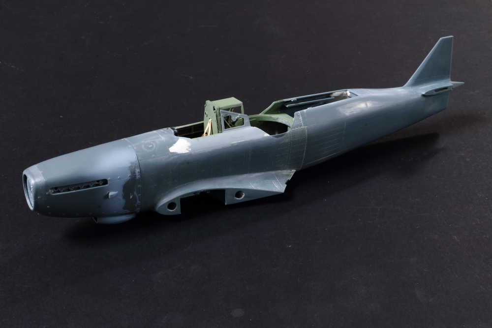

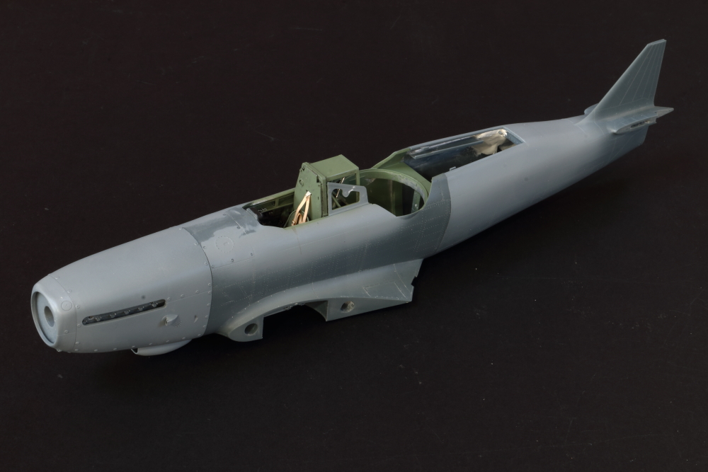

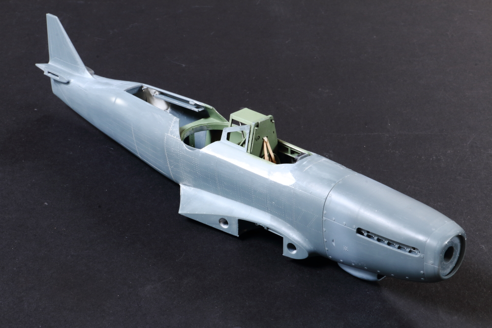

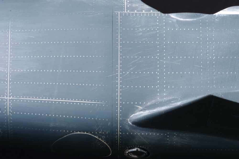

Iain Posted September 14, 2025 Author Posted September 14, 2025 A bit of progress today - after a bit of a disaster last night... Now, I happened to mention de-bonder earlier - really useful stuff if you make a bit of a numpty 'error'. 😉 Well, I added the tail section - having carefully aligned averything - and bonded in place with thin CA. All good. Because of the way the cowling fits over a ridge at the front of the fuselage mid-section - and the fact that you want there to be a visible seam - I elected to use some thick superglue on the inside of the cowling - before pressing home... Within seconds a check from the front indicated that the cowling was now a few degrees 'twisted' when viewed from the front. I won't repeat the language as this is a family show! So - joint flooded with de-bonder overnight - and the cowl came off. Unfortunately the de-bonder hadn't penetrated all the way around the joint and I had some collateral damage to the port side of the cowling section when removing from the rest of the fuselage - about 7 separate pieces worth! 🥵 All had to be carefully repaired this morning and resulting joints sanded back to remove any evidence. This afternoon I've re-fitted the cowling - this time using what I *should* have used first time around: 5 minute Epoxy so I had some 'wiggle' time if alignment slightly out. That'll teach me to not be at the bench when I'm tired/feeling lazy - mea culpa!! Anyhoo - this is where we are now - nose and tail bonded in position - a few battle scars on show - and the joint between the fuselage mid and tail sections filed and sanded: And this is the mid/rear joint - the dark line to the left of the panel line. I've used a small, flat, diamond file to get the surface of the joint flush (works brilliantly with the resin/superglue), followed by wet sanding with 600 - 800 - 1200 Wet and Dry paper. Another quick blast with some 1200 grit to remove those fine scratches and then I'll re-scribe the relevant details. So - some re-scribing work on the fuselage and I can move onto the wings. That's the plan, anyway!! Iain Fanes, dennismcc, Palm-tree and 24 others 27
geedubelyer Posted September 14, 2025 Posted September 14, 2025 That's an important lesson for us all to learn Iain. Thanks for the heads up. 5min epoxy it is 👍 The end result of your trials is looking fine now though. Nice recovery. Anthony in NZ and Iain 2
scvrobeson Posted September 14, 2025 Posted September 14, 2025 Great save Iain, it's looking really great. Matt Iain 1
dennismcc Posted September 14, 2025 Posted September 14, 2025 Great save Iain, it is looking pretty good, and thank you for the CA information, it's something that I will use in future. Cheers Dennis Iain 1
LSP_Kevin Posted September 14, 2025 Posted September 14, 2025 Nice recovery, Iain, and I'm glad to hear that this sort of thing doesn't just happen to me! Kev Palm-tree, Christa and Iain 3
