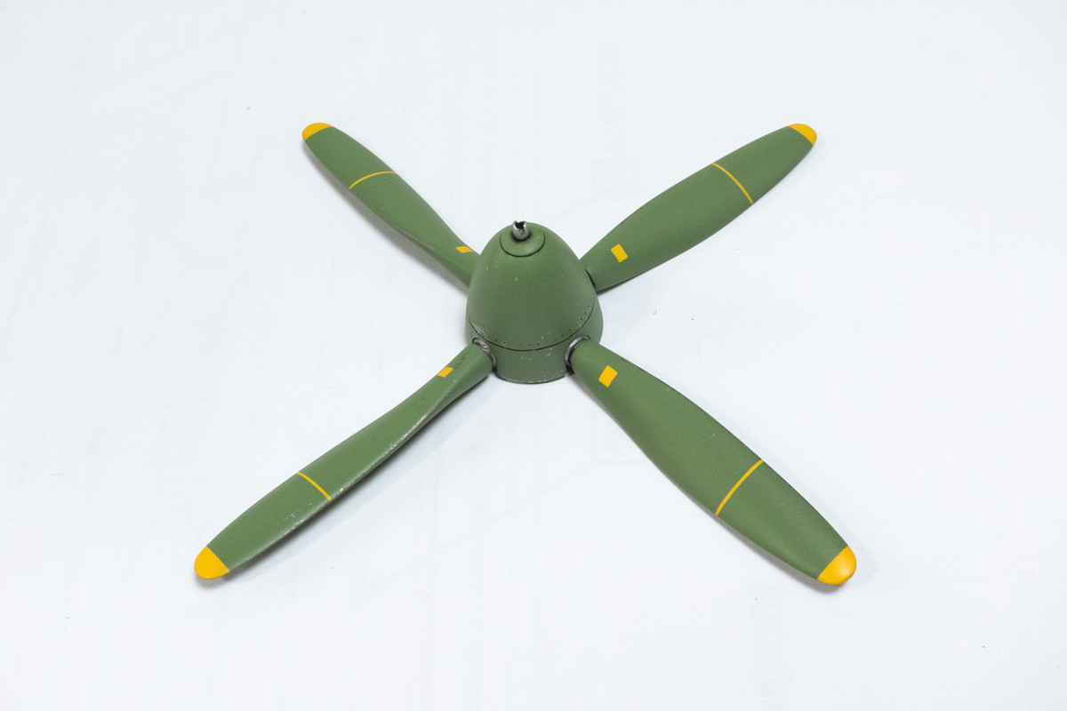

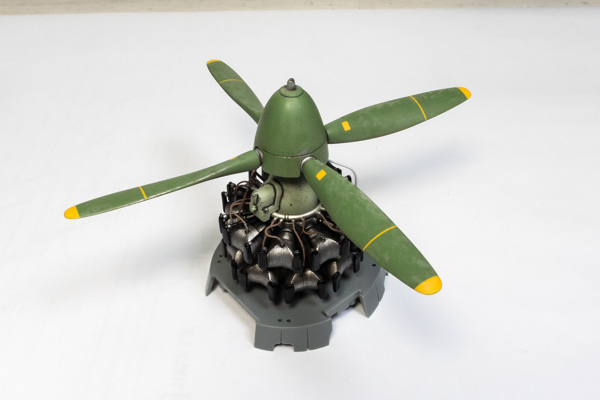

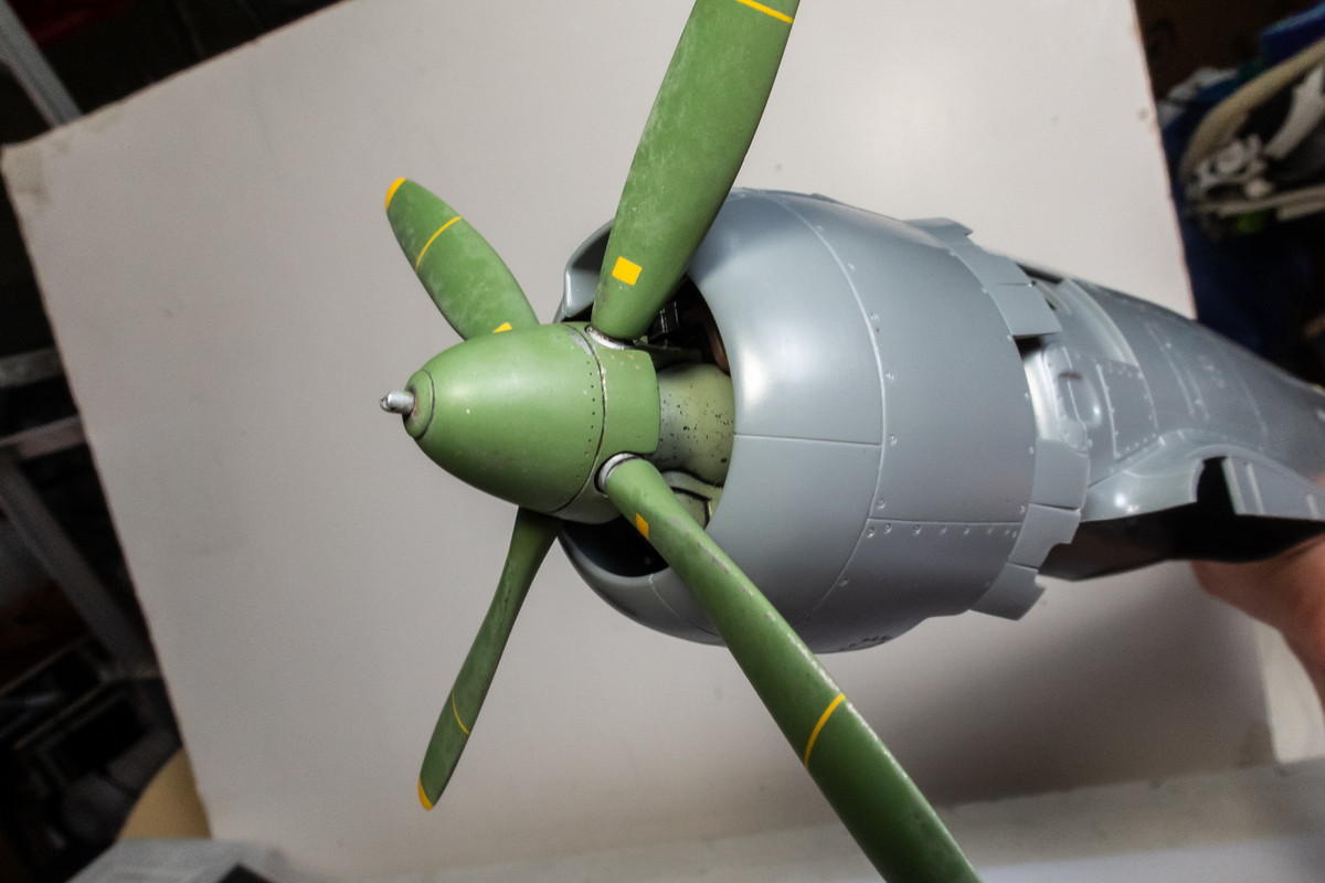

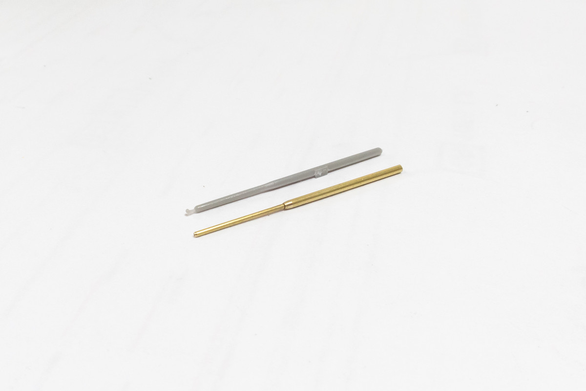

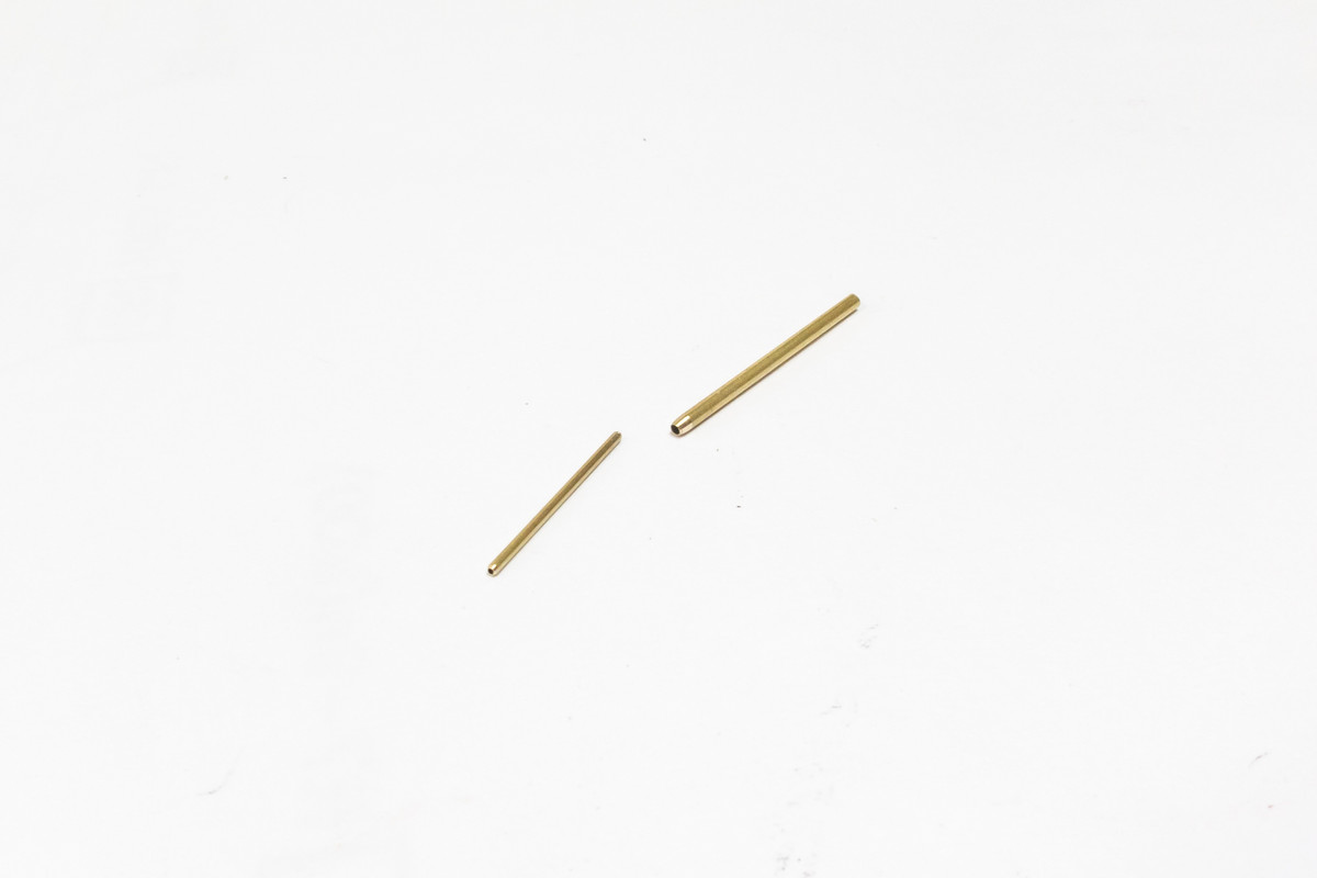

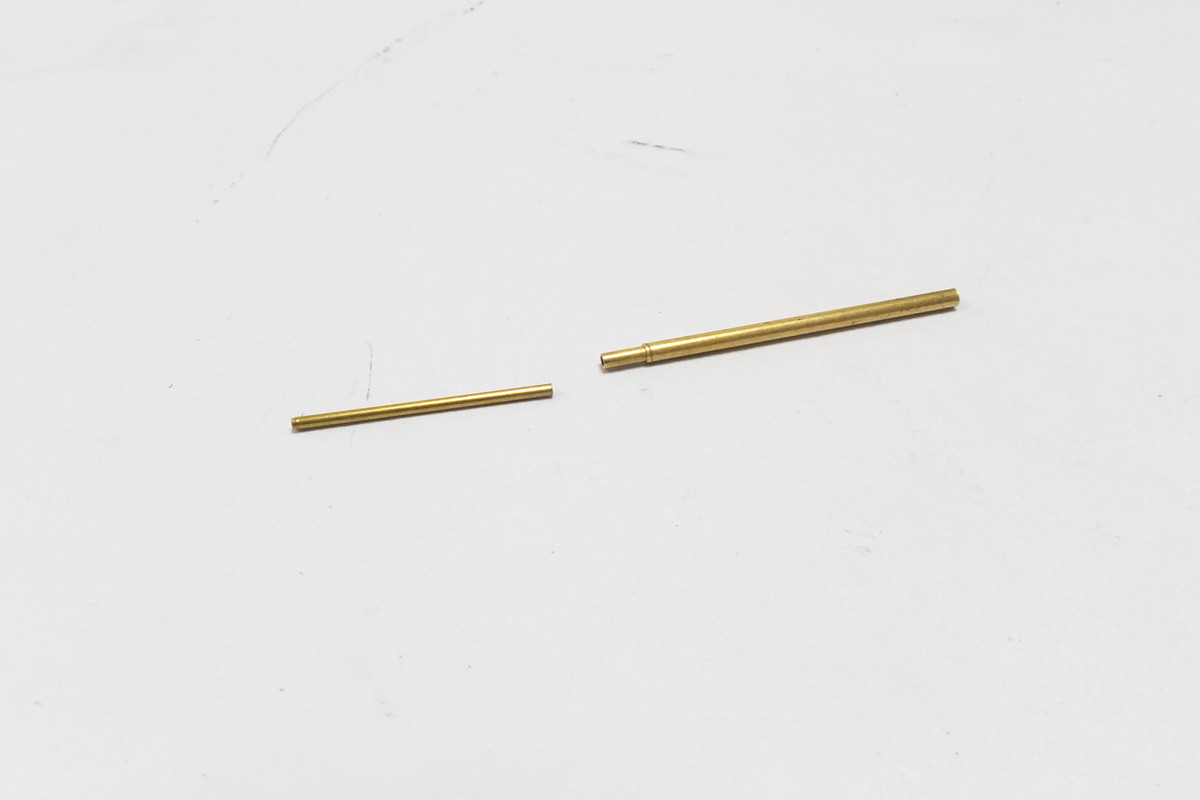

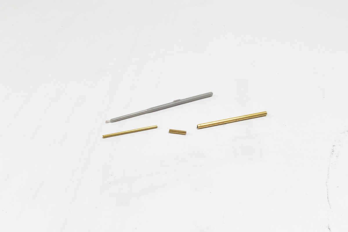

Thunnus Posted May 31, 2025 Author Posted May 31, 2025 (edited) 21 hours ago, dennismcc said: That is so impressive, I have not long fitted and bent all the ignition wires on my Ki 44 but was not happy so I am starting over, so I can appreciate the skill (and patience) that went into youe engine. Cheers Dennis Thank you Dennis! I found it important to use soft lead wire and to make sure that glue connection between the ring and the wires was solid. 17 hours ago, Biggles87 said: Wow!! Thank you! 8 hours ago, scvrobeson said: Sublime work as always John. Always impressed by the precise nature of your work and photography. Matt Thanks Matt! Appreciate the comments! I'm waiting for a new rivet tool to arrive on Monday before I start that particular adventure. So filling in the days with minor work. Like fabricating a new pitot tube using 1.0mm, 0.8mm and 0.6mm brass tubing. The short section of 0.8mm tubing will simply be a sleeve so that the 0.6mm slides into the 1.0mm without play and therefore straight. The ends of the both tubes are beveled by chucking the pieces into my rotary tool and lightly grinding the tip at the appropriate angle on a sanding stick. Instead of using the kit-supplied decals for the yellow markings on the prop blades, I've made a custom mask to paint them. The yellow is a 4:1 mix of Tamiya Yellow and Tamiya Orange. The spinner and blades were painted in the same green color, which was a 4:1 mix of Mr Hobby Aqueous RLM82 Light Green and Tamiya Flat White. Both the spinner and blades have been lightly chipped. I've added an additional joint on the spinner along with some rivets. Painting is done but the weathering is not. Edited June 1, 2025 by Thunnus zaxos345, TAG, AngryJazz_Models and 28 others 31

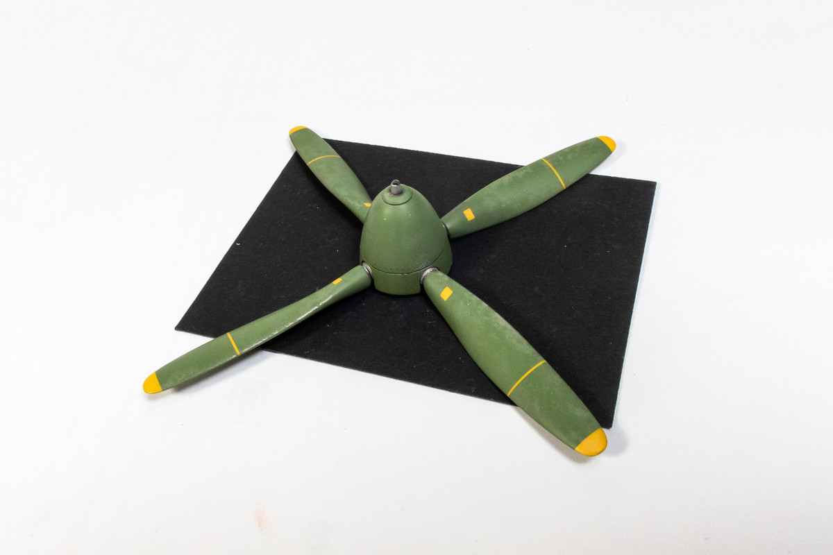

scvrobeson Posted May 31, 2025 Posted May 31, 2025 The prop and pitot look great. What grit did you use while sanding the brass? I need to do something similar on an upcoming project. Always enjoy seeing your paint and weathering process, the prop looks like it's ready to spin up and take off. Matt Thunnus 1

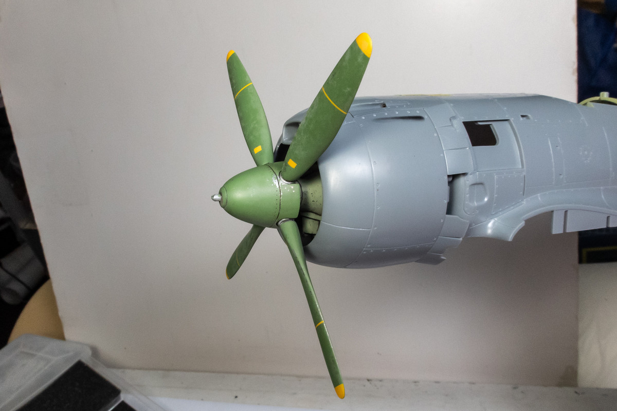

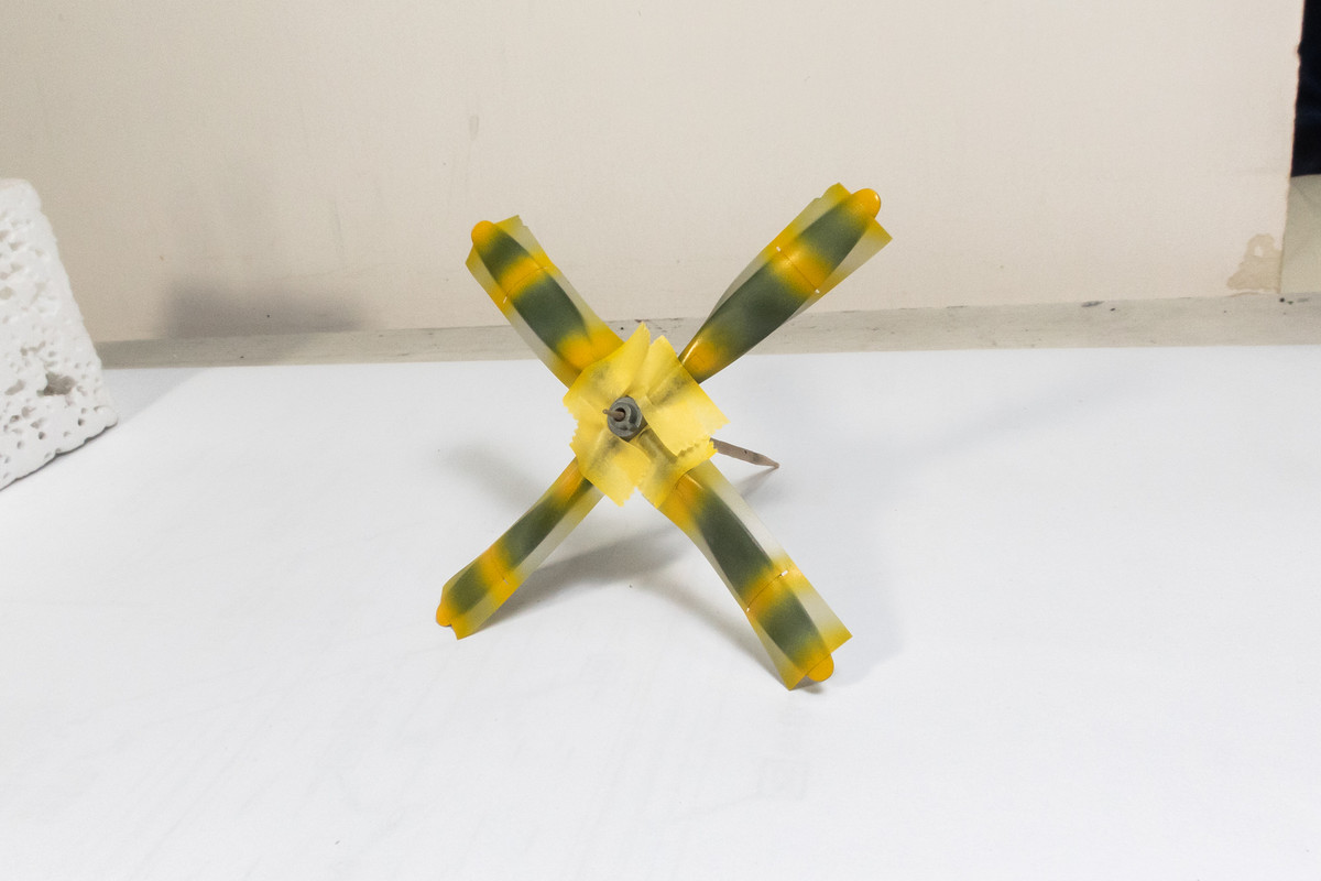

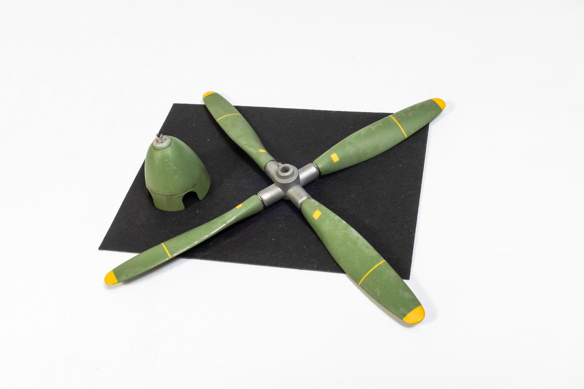

Thunnus Posted June 2, 2025 Author Posted June 2, 2025 On 5/31/2025 at 4:41 PM, scvrobeson said: The prop and pitot look great. What grit did you use while sanding the brass? I need to do something similar on an upcoming project. Always enjoy seeing your paint and weathering process, the prop looks like it's ready to spin up and take off. Matt Thank Matt! I'm not sure what grit the sanding stick was but it was on the coarser side. The prop blades and the spinner have been given some salt weathering. I've also used some pastels to create streak marks on the spinner but they aren't very noticeable in the pics. Landrotten Highlander, mc65, denders and 25 others 28

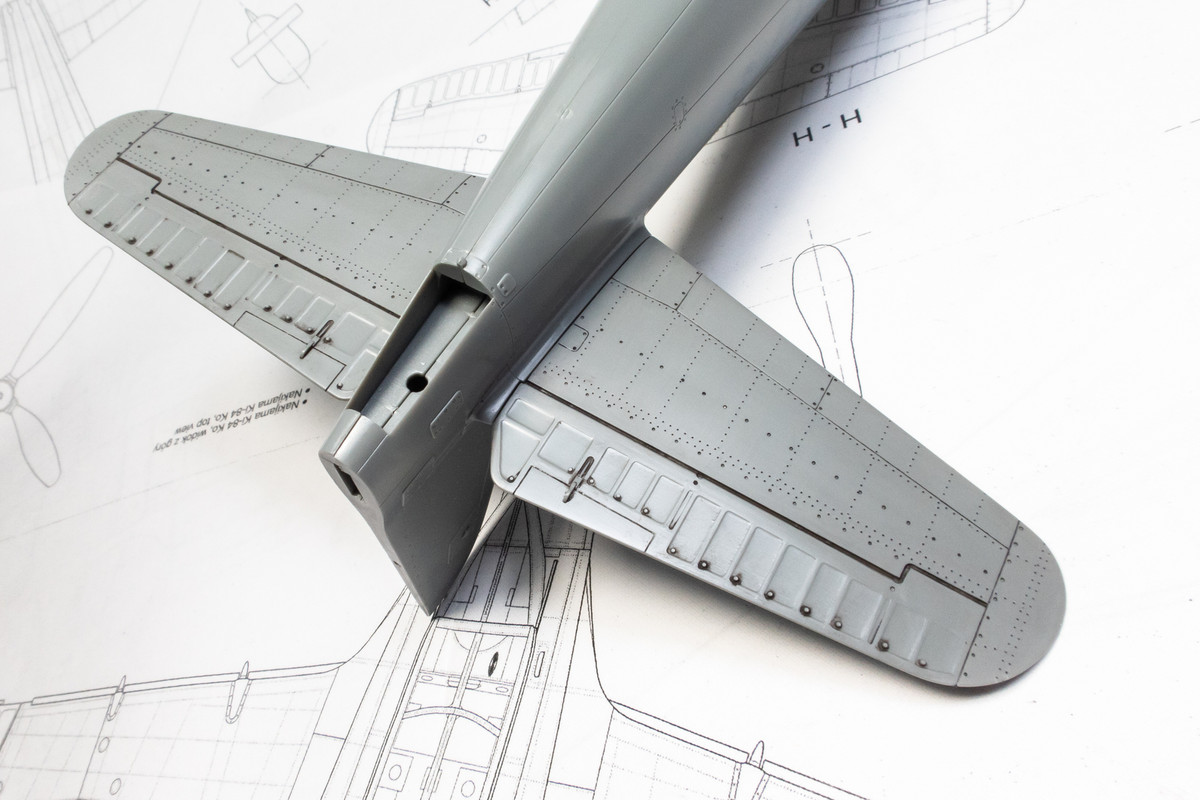

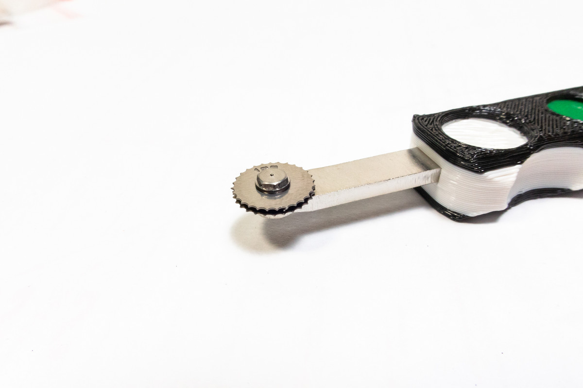

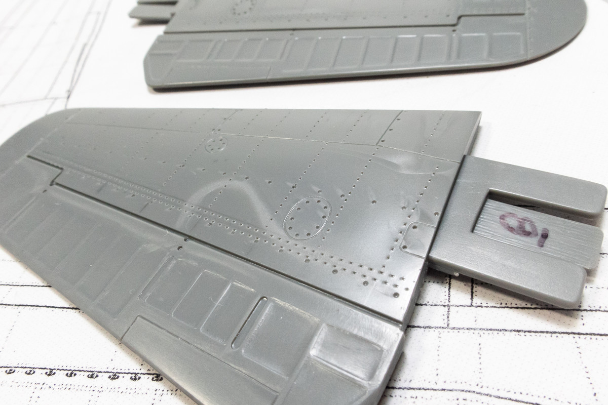

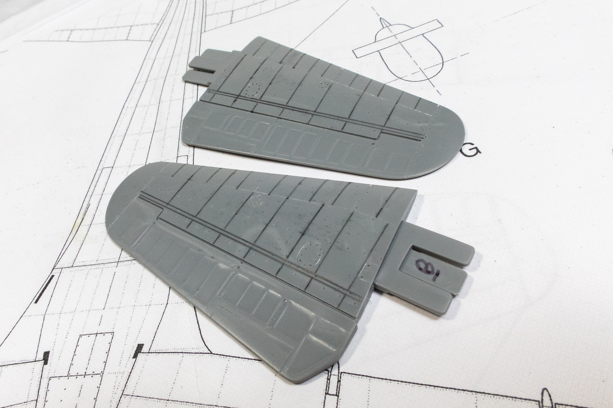

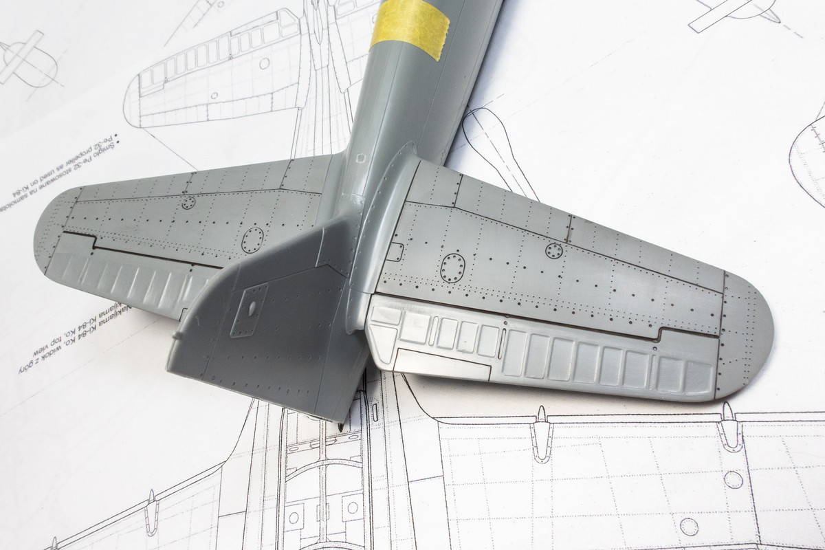

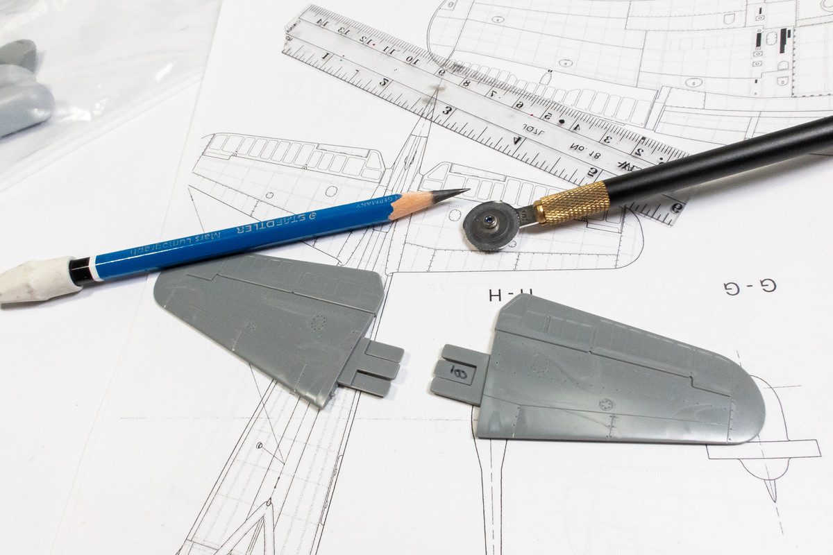

Thunnus Posted June 2, 2025 Author Posted June 2, 2025 I felt a little compulsion to do some riveting so I did the horizontal tail parts. The reference drawings are from Kagero Monograph #18 and the riveting tool of choice is the Galaxy Tools 1.00mm rivet wheel. The rivet lines are drawn onto the model using a soft lead pencil. The rivet lines are made by rolling the wheel along the lines. After the rivet holes are done, the lead is wiped off and the surface is sanded to remove the raised mounds of plastic around each hole. The tail planes are then given a dark pastel wash to check the work. Gazzas, Uncarina, HB252 and 20 others 23

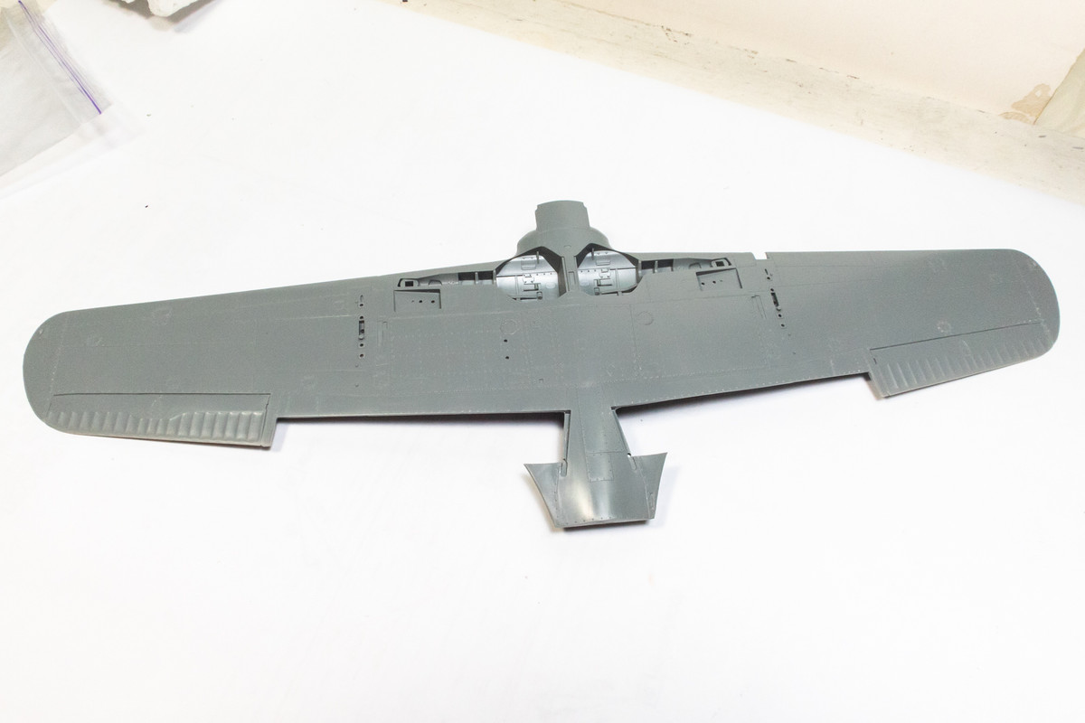

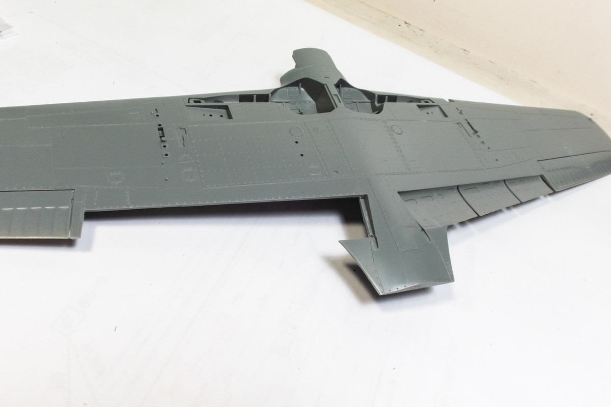

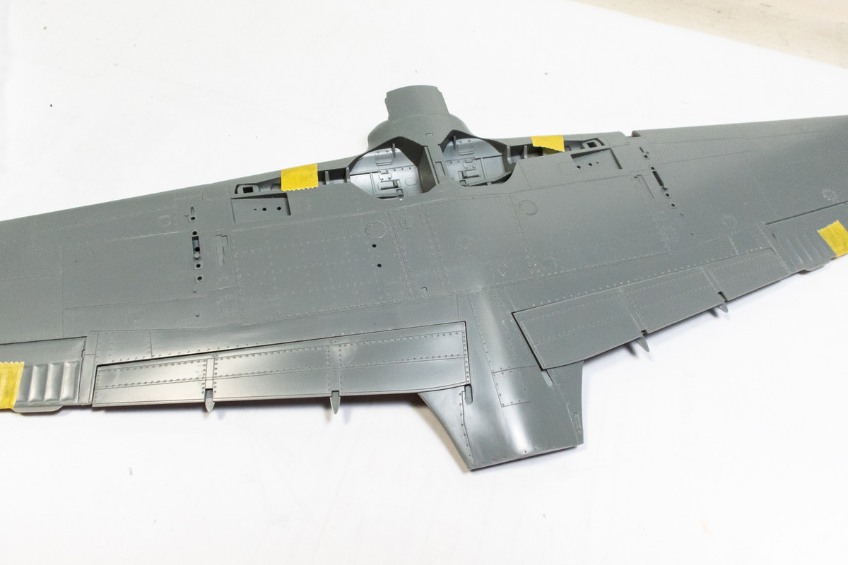

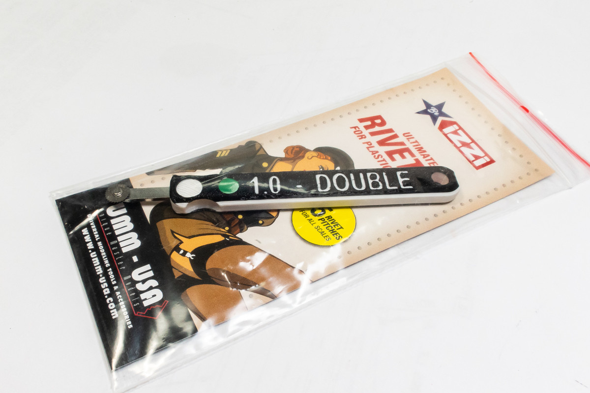

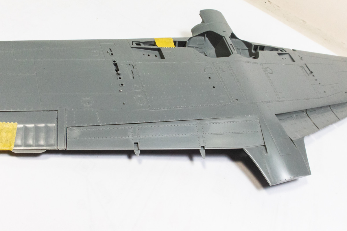

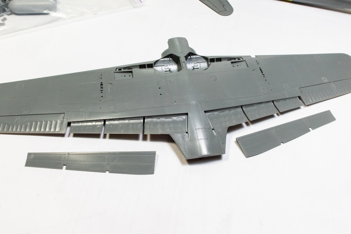

Thunnus Posted June 3, 2025 Author Posted June 3, 2025 On 6/2/2025 at 12:24 AM, alaninaustria said: Damn John, that is some amazing work! Looking forward to seeing this build come together! I really like how you build, weather and finish these masterpieces! Cheers Alan Thank you Alan! 3 hours ago, Shoggz said: You are a painting and weathering Jedi Master John. The force is definitely with you! Thanks Richard! The combat flaps were designed to be posed in the open position so some surgery is required if you want to close them. The flap interior sections on the wing bottoms were carefully cut away. The mounting pegs on the flaps themselves also need to be cut off in order for the flaps to sit flush. The surgery was fairly straight forward and the flaps seem to fit into the openings without too much drama. I may need to add thin shims to the ends of the flaps to get rid of the gaps. The new tool arrived today. As a riveter, this is something I should have had in my toolbox a long time ago. Hopefully, I'll be able to make any double row of rivets quicker and more accurately. The scheme I am planning to do was offered as a limited release by Hasegawa... LSP_Kevin, Troy Molitor, Dennis7423 and 17 others 19 1

Thunnus Posted June 4, 2025 Author Posted June 4, 2025 On 6/3/2025 at 10:30 AM, Kenneth Joy said: Such beautiful work... pleasure to watch you build this! Thank you Kenneth! I'm glad you are enjoying the process! 22 hours ago, Rowdy Rat said: John, Really fantastic work! I’m amazed at the attention to detail and the way you switch between dissimilar subjects without even a hiccup. While there are many fine modelers on this site, your builds (and a few others) are among my favorites and new posts are something I always look forward to. Regards, Stan Falenski Thank you for those kind words, Stan! I really enjoy sharing my builds here and I'm glad that you find my builds useful. 15 hours ago, spyrosjzmichos said: Bloody mighty impressive work John! This is turning out to be a masterpiece! Thank you very much! I was really motivated to crank out an update on the riveting for the wing tops but I hit a snag when I found out the wheels on the double row rivet tool are not "synched". They rotate independent of each other, which is not useful to me in this situation. I tried a stop-gap measure of leaking some CA glue into the wheel but that didn't have much effect. So I'm going to take it apart and glue the two wheels to each other. But the hex nut on the tool is really small and I've had to order a small socket wrench. The tool is due from Amazon tomorrow so the riveting will have to wait! AngryJazz_Models, zaxos345 and Shoggz 3
