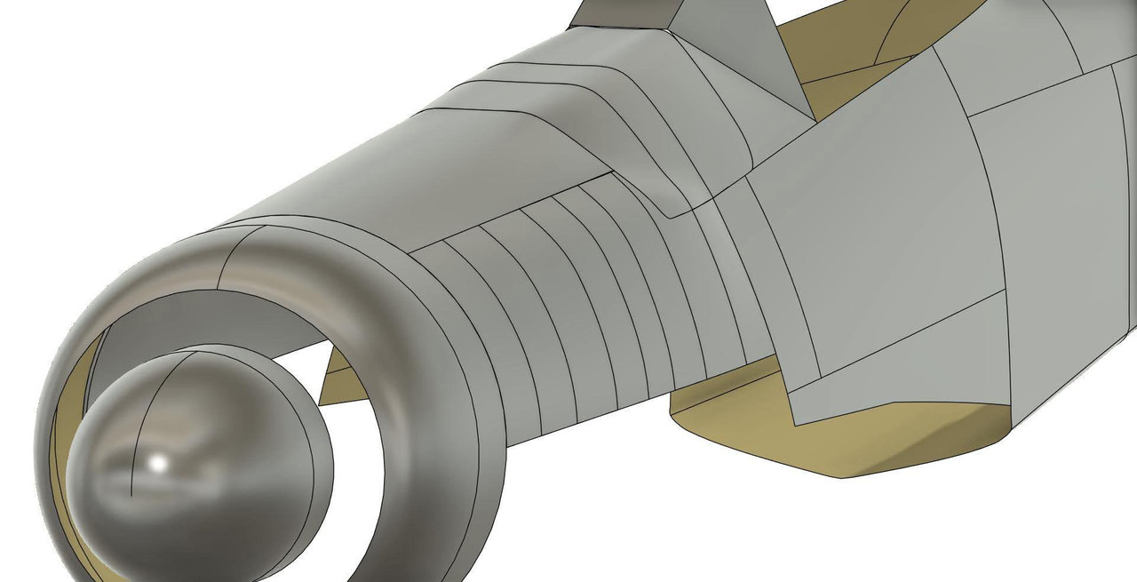

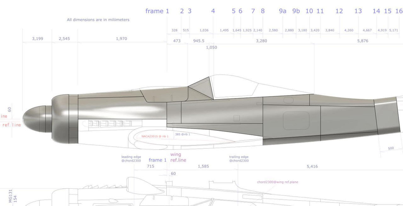

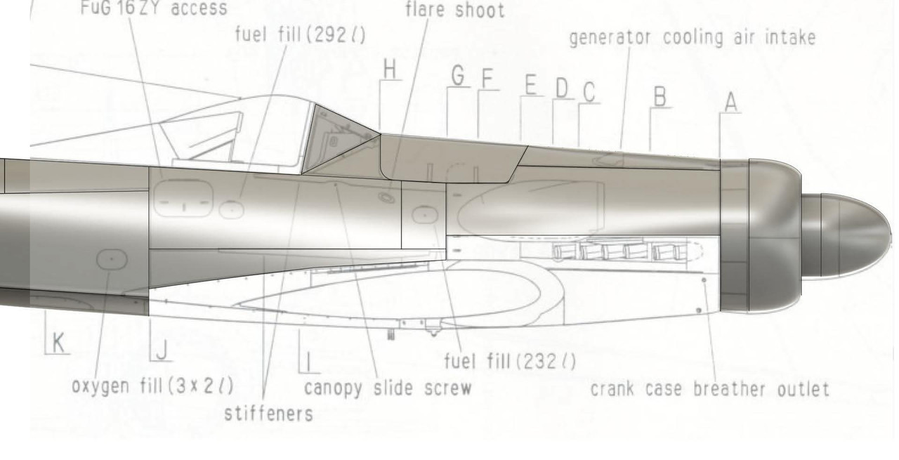

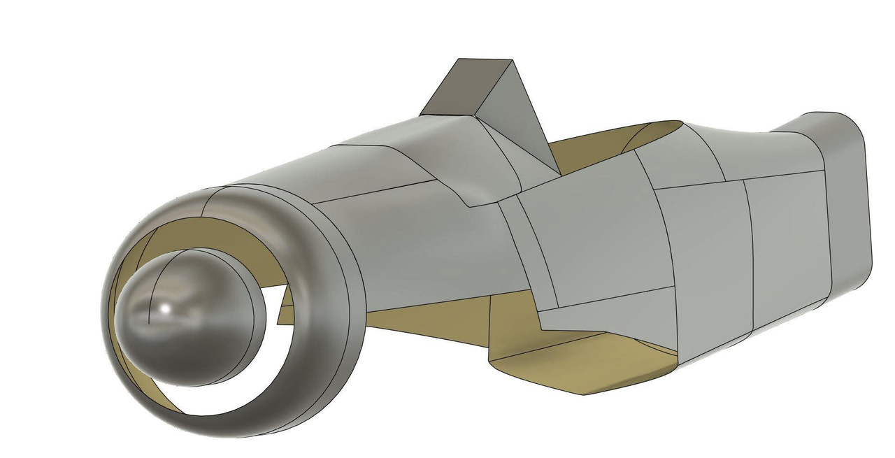

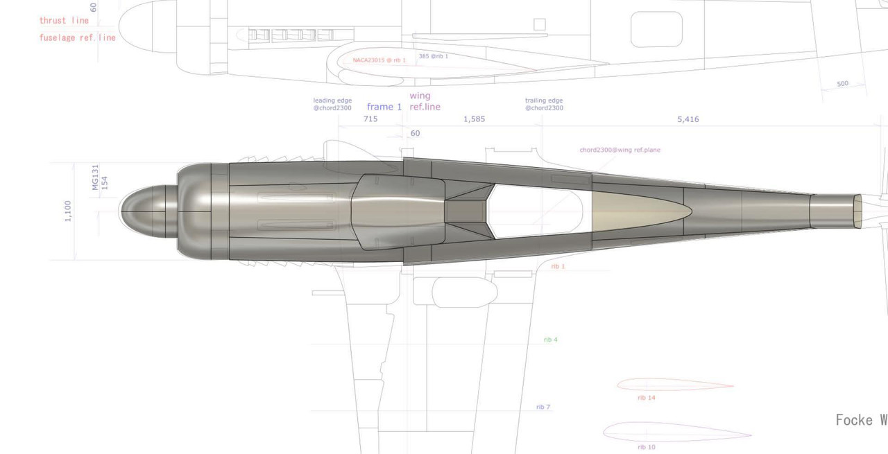

Thunnus Posted March 31 Posted March 31 Our favorite mad scientist, Mathieu, has posted on Facebook very interesting CAD work on a possible new D-11/D-13 conversion for the 1/32 Hasegawa kit. Quote In the unrelated, but relatable subjects, I ask for your opinion on the side bulge cowling of the D11/13 sub variants. From my understanding, the bulge was introduced to accept the larger engine bearers underneath. The bulkhead being the same profile (to confirm?) and the top hinge being at the same place (to confirm) the bulge will only « deform » the inner portion of a D9 side cowl, with the perimeter being still in the same relative spots. Asking because the cross sections from the Eagle files 02 book gives « interesting » results when cross referenced with the rest Lofts created using the excellent J Temma profiles, and Shigeru Nohara drawings from various publications. Cheers Modelboy, Tolga ULGUR, Stefano and 16 others 16 3
nmayhew Posted March 31 Posted March 31 yes i saw this - very cool indeed the Hassy D kit has been all over ebay at pretty decent prices (generally sub £45) so i have picked up a few i was trying to persuade him to do an upgrade / plug and play type replacement for the rear of the engine area which you can see up through the landing gear bay but sadly no dice i think he will be including wing changes where appropriate hopefully this will be a good seller for him once complete Martinnfb and KiwiZac 2
thierry laurent Posted March 31 Posted March 31 With regard to plan discrepancies it is just required to keep in mind that Jerry Crandall had direct physical access to the full size airframe and took a lot of measures several times. So, even if the other plans were made by people I'm generally trusting, I think that in that specific case I would first give the edge to the Eagle files plans. KiwiZac and Kagemusha 2
Paul2660 Posted March 31 Posted March 31 Why not just make the full fuselage halves? If I am reading correctly this conversion would mean cutting the lower half around the engine cowling off the Hasegawa kit to match to the conversion? Cutting always removes material that can’t be replaced. But also cutting Hasegawa plastic is not easy. It’s a very hard plastic. Not like Revell. The EagleCals cockpit set requires cutting on top and that was a mess for me. The conversion looks like it has all the necessary additions around the engine mounts. Just a thought I realize anything is better than nothing. Paul Paul in Napier, KiwiZac, cbk57 and 2 others 5

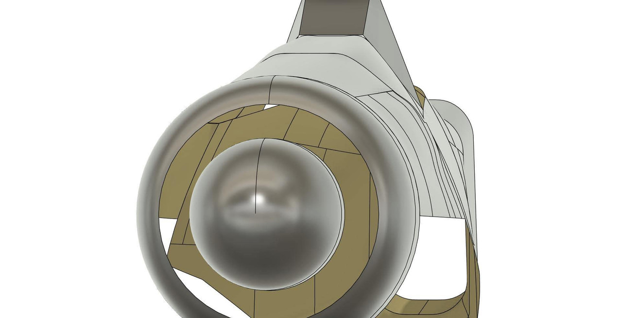

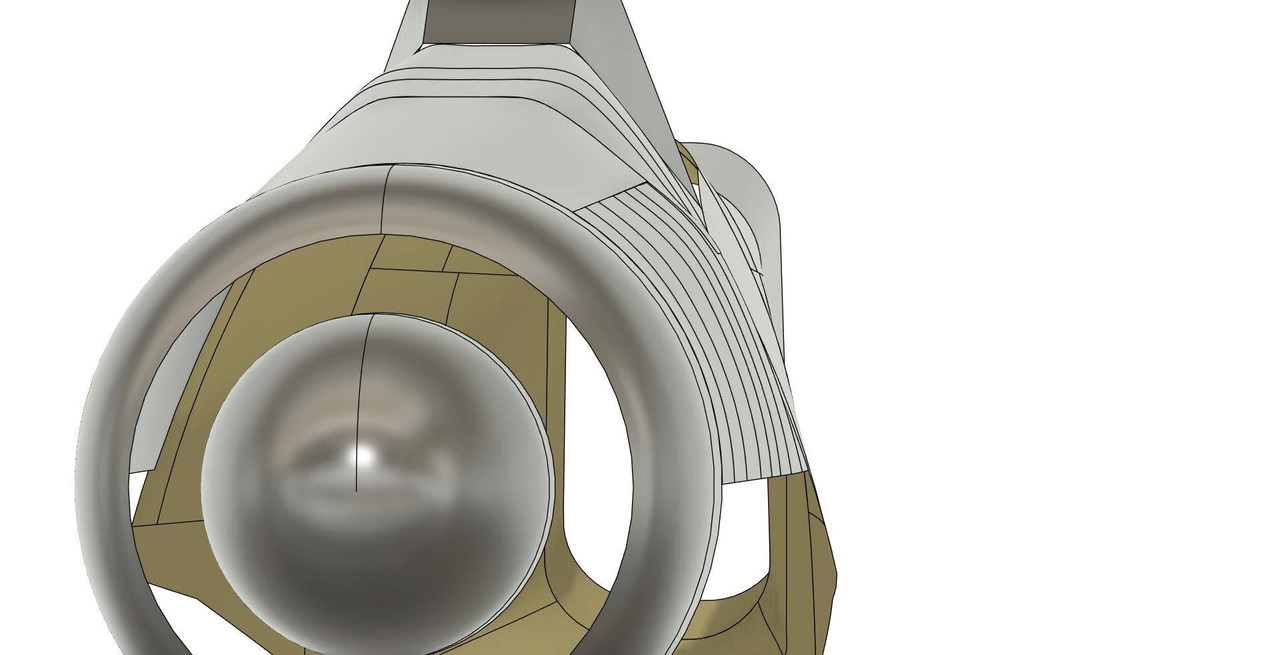

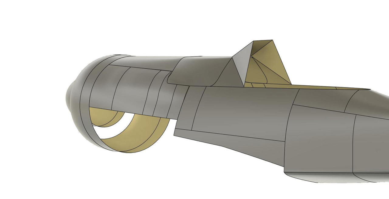

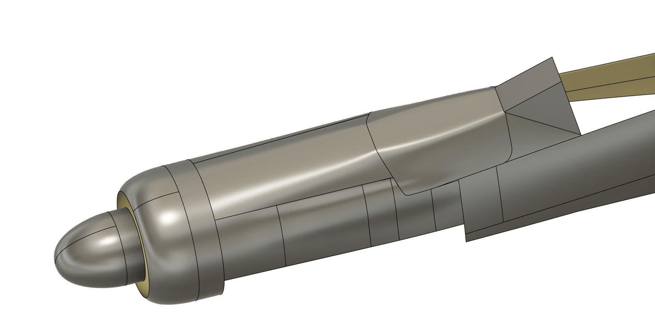

Thunnus Posted March 31 Author Posted March 31 Latest update... Quote With a more blended bulge lower transition, down to the panel limit. This seem to correspond more to the pictures, even if some cross sections says otherwise. Next stop, the supercharger intake. Rampenfest, D Bellis, Martinnfb and 3 others 5 1

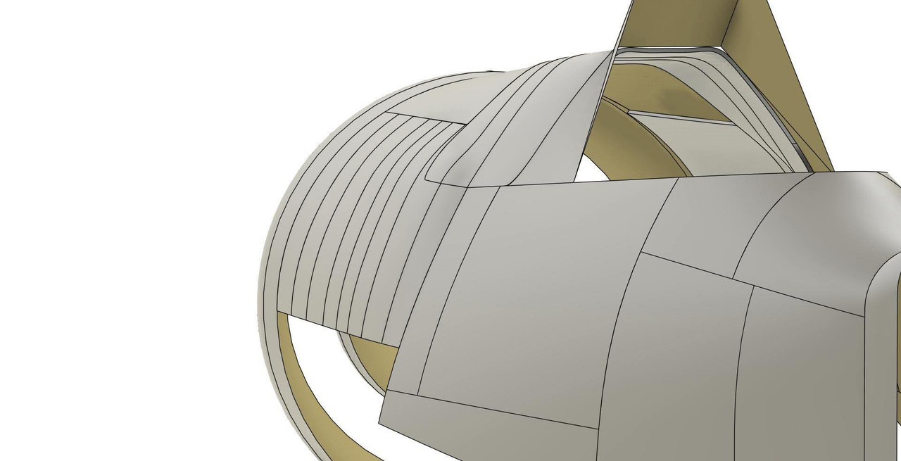

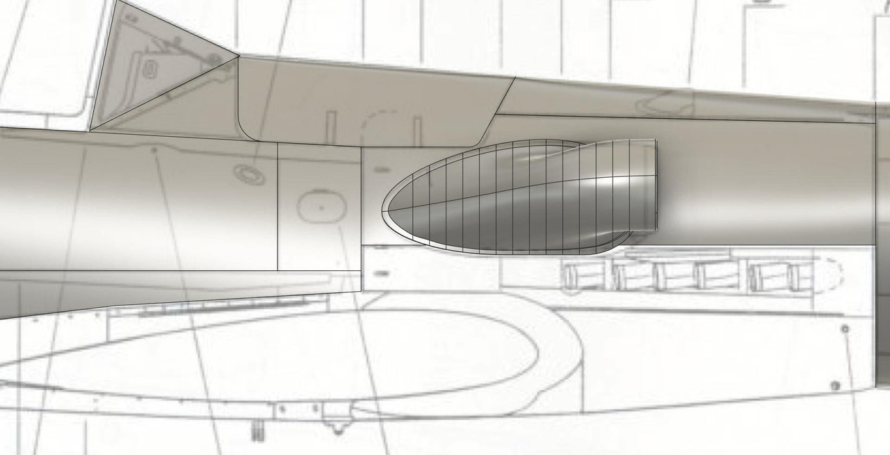

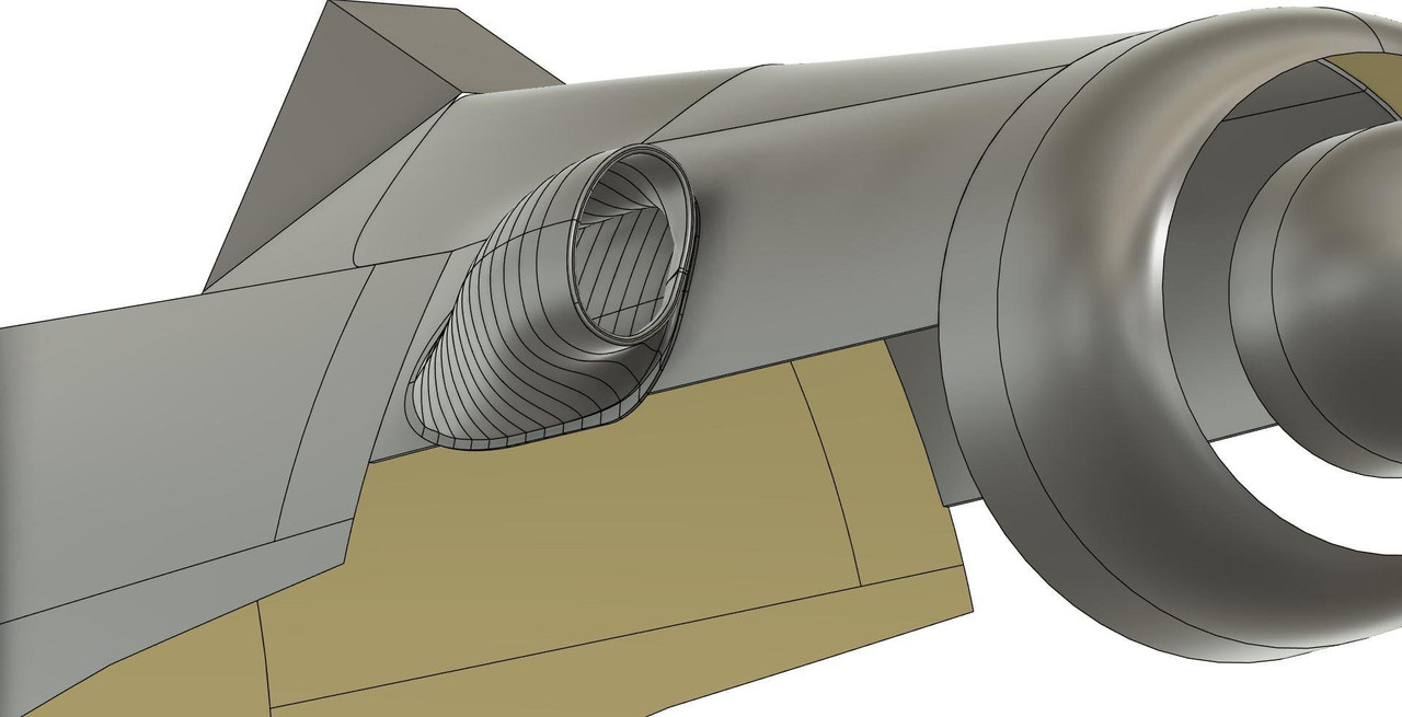

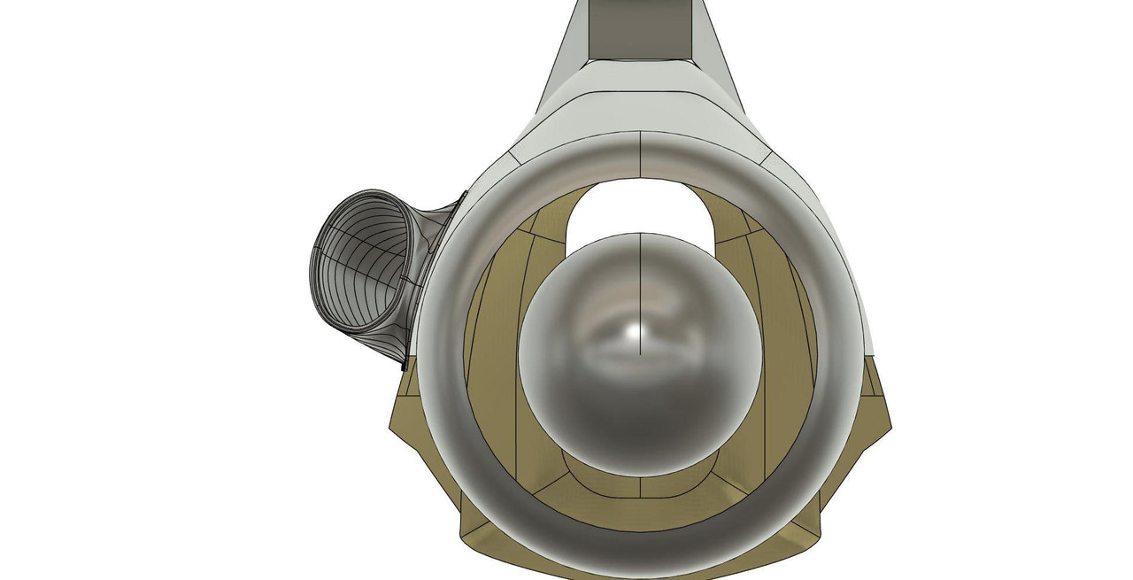

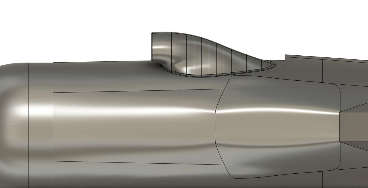

Thunnus Posted March 31 Author Posted March 31 For those not on Facebook... Quote Here is the tricky intake up to your opinion. A few cross sections from aero detail 02, a lot of picture gazing, and the analysis of what exists already in scale models. And of course, discard anything coming from the restored warbird, the actual intake is some kind of a place holder waiting for an accurate reproduction. I believe the intake is very similar to the one fitted on the Ta152, but the mating is of course adapted to the Dora panels. One important factor, the mating itself is different on the upper side/lower side. Coming quite straight almost perpendicular on the lower side, while the upper side is a lot more curvy and complex. I’m quite happy with the actual rendition, but it’s not set in stone so speak up if you spot anything. Regards Mathieu LSP_Kevin, D Bellis, Model_Monkey and 4 others 5 2
